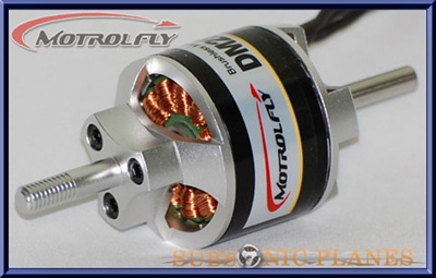

MOTROLFLY DM-2820 Brushless motor series are for RC Airplanes 50 to 115 ounces depending on model type. Check below for more details or click the link to the PDF down load for all information for each Kv in this series.
The PDF will open in a new window so you don't loose your spot.
All motors come with an X mount for mounting the motor to the fire wall, pre soldered 3.5mm gold connectors, and a 6mm Hub prop adaptor; collet style prop adaptor sold seperately for behind fire wall mounting (use with FM-60 to FM-80 depending on prop and voltage).
Hold cursor over picture for zoom.
motrolfly, motorfly, motrofly, brushless motors
* Weight: 152 grams
* Stator Width: 30mm
* Stator Height: 20mm
* Motor Width: 39mm
* Motor Length: 37mm
* Hub Length: 30mm
* Hub Shaft: 6mm x 22mm
* Motor Shaft Size: 5mm
* 12 tooth 14 magnet DLRK
