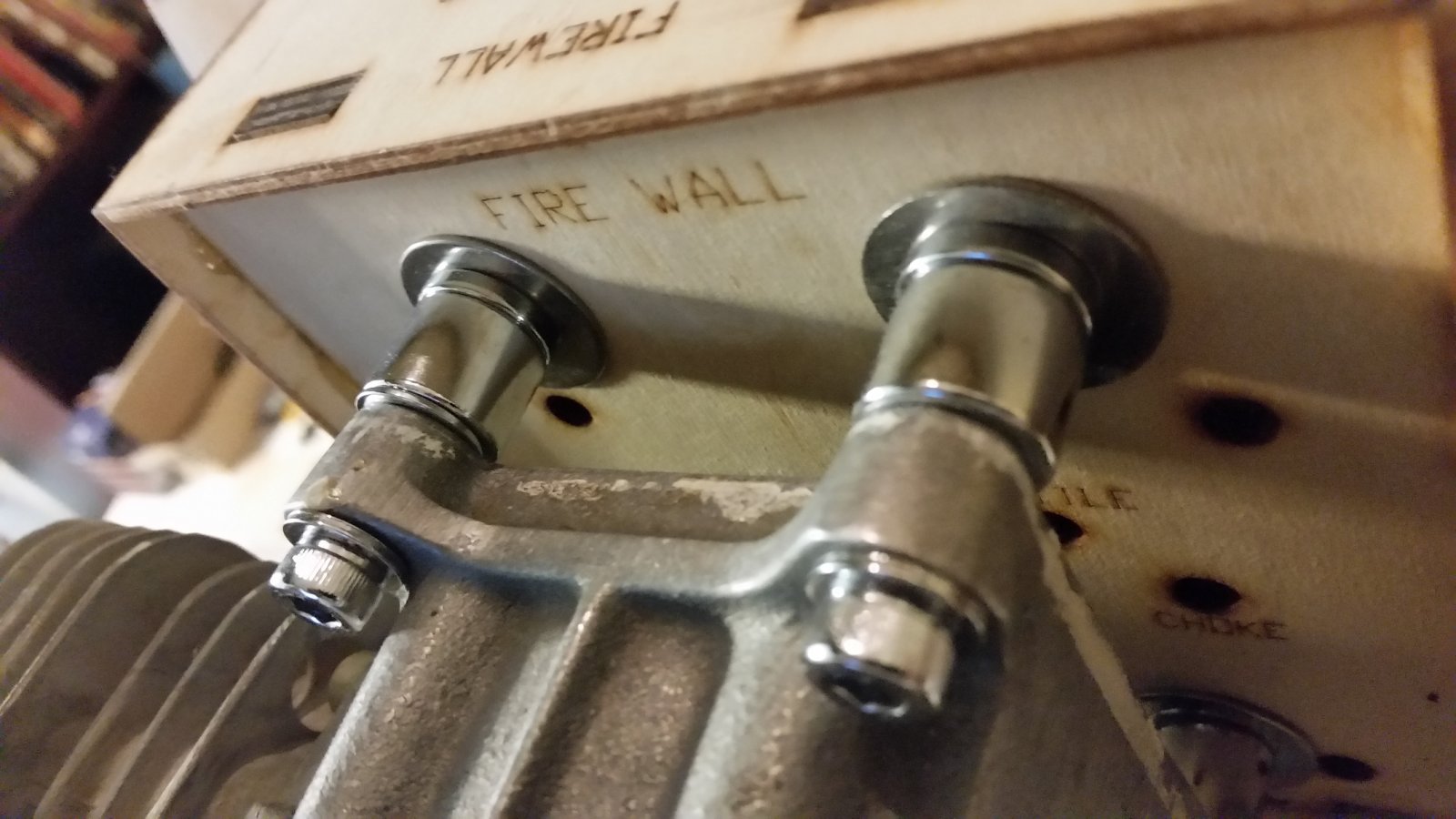

Just make sure you get the angles on the standoffs correct you do not want to twist your motor block.

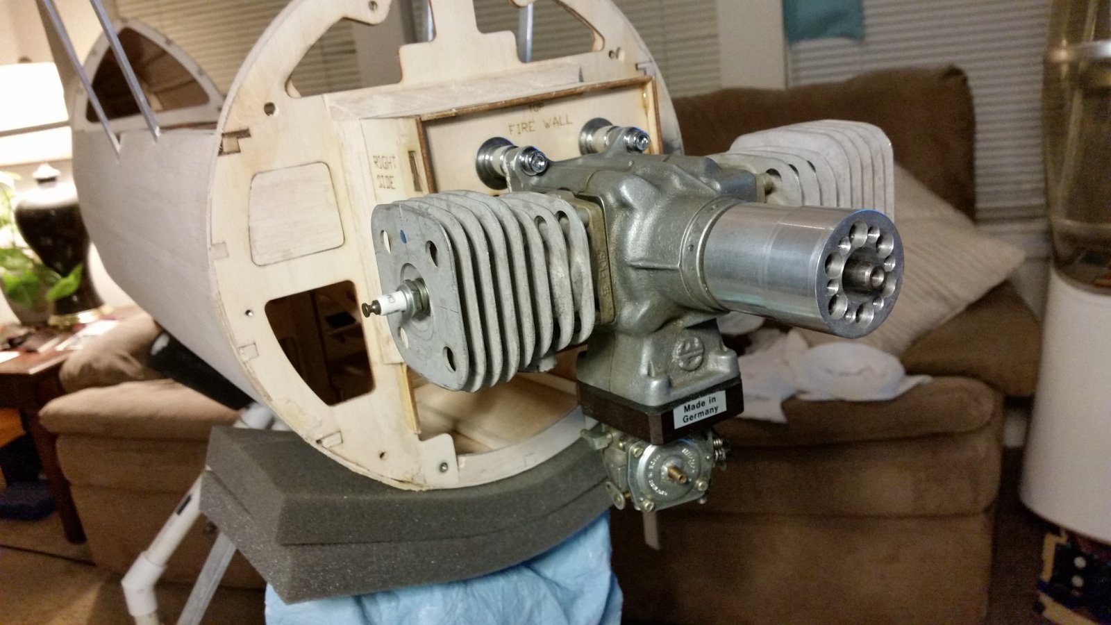

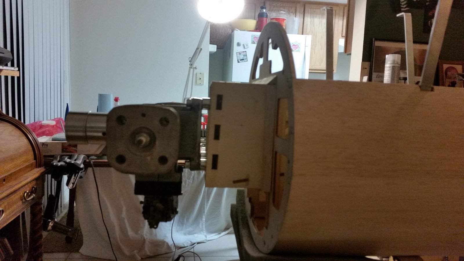

Very sound reminder. Thanks... Got that covered. I re-adjusted the "up" thrust angle to just about 1 degree up. If I need more, I can always dial it in very easily. As for "right" thrust, I typically won't mess with what is designed. But this had an extreme 3.3 degrees right thrust. I reduced it to an even 2.0 right thrust angle. D & B Supply has really great stuff. From Tygon fuel tubing, to bolts to a variety of supplies I faithfully use. They have different styles and designs and different materials for spacers. My favorite is the "Chromed" hardened steel. I can get them in lengths of 1/4", 3/8", 1/2", 3/4" and 1". Plus they have very cool chromed steel washers too. If I need anything longer on standoffs, then I will order them. But for this application, I feel they will do quite adequately.
Once I had the correct measurements for the spacers (standoffs) A real simple and quick placement on the firewall, drill the four holes and bolt that sucker down.

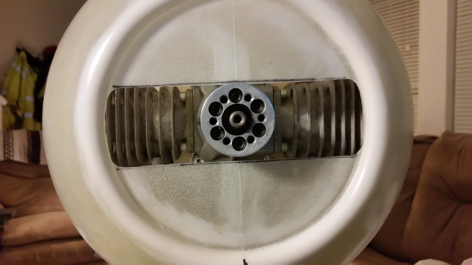

A test fit of the cowl was a pleasing site when I discovered my hole in the face of it was pretty close to perfect. I knew I would have a little minor fine adjustments once the "dub twin" was mounted. That is why I didn't cut it completely out. Now that I have the motor mounted, I can finish the final angle and cut on the cowl opening.

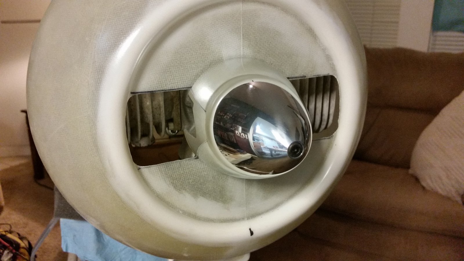

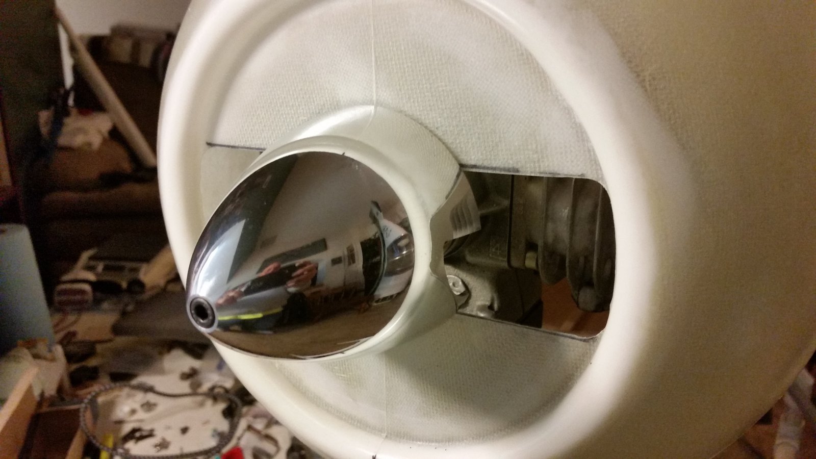

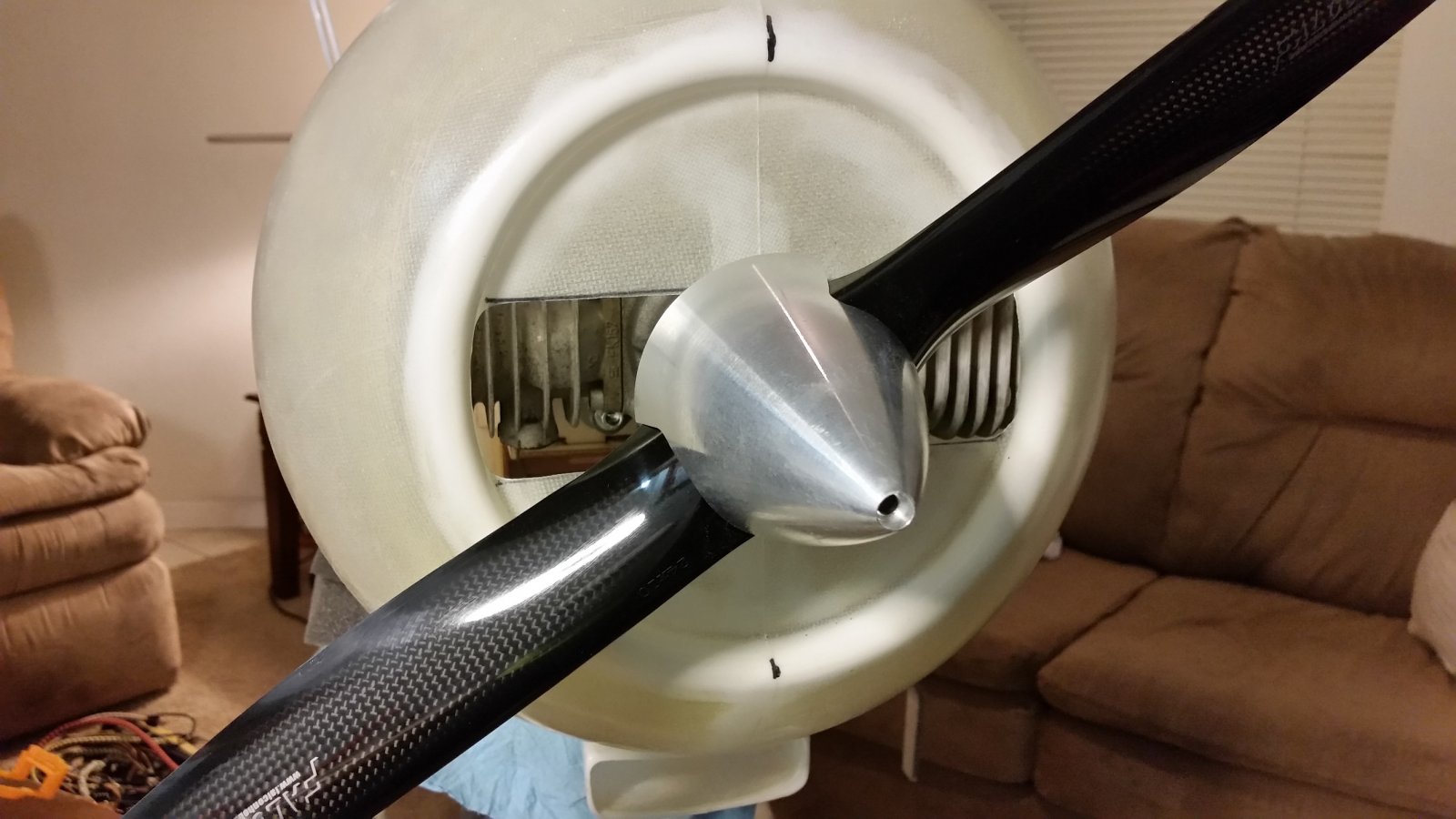

I placed the Ultimate styled spinner up to the cowl with the 24x10 Falcon. It looks...eeeah, Ok...but I really like the more rounded "bullet" style spinner. What do you guys think?
I am happy with the adjustments I have made to the engine thrust angle. I am actually happy with the progress of the Pitts. Here is that evil word again. "Covering". Perhaps this weekend? I hope so. I really don't forsee any further hold ups.
The rounded bullet type looks better.

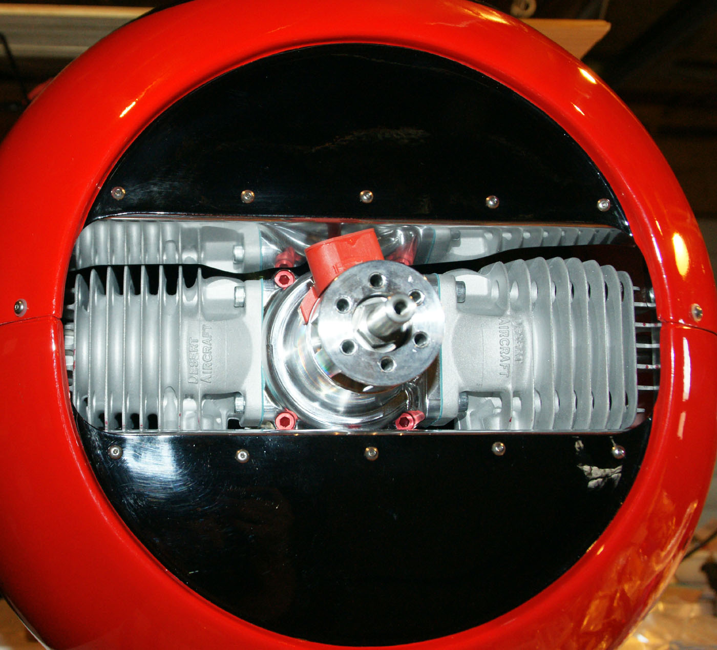

As a side note: I took a peeksy at B and E graphics website. I was so pleased with the Yak graphics I got from them I figured they would have what I was looking for. Yeppers..... @Pistolera will not be the "ONLY" one with a Radial look alike. Hee hee.... I actually have to give Earle credit for this one. His photo reminded me the front of the big round cowl is going to need some dressing up. Hell, I may even....yeah....why not? I am going to order one the correct size for my Sukhoi too.

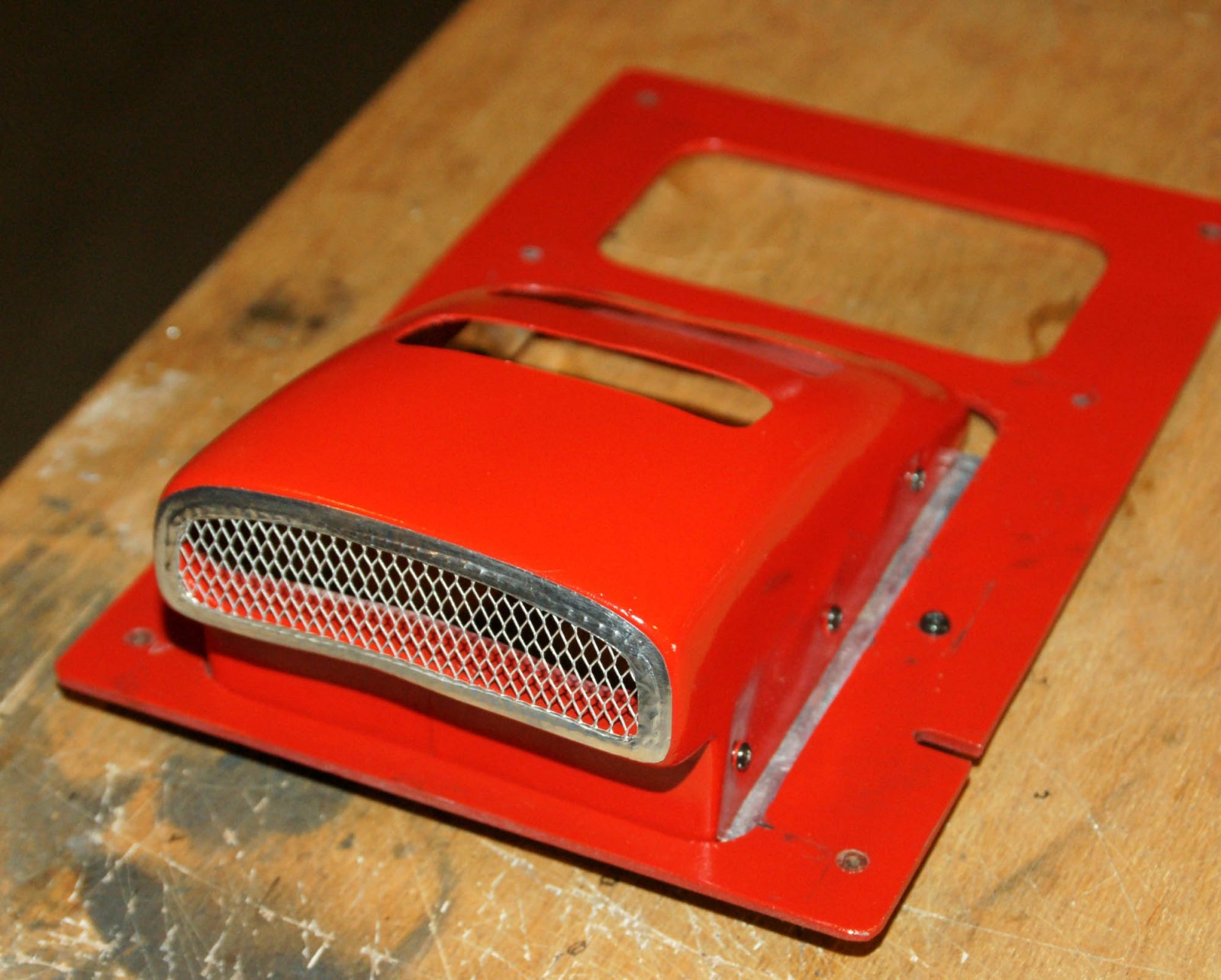

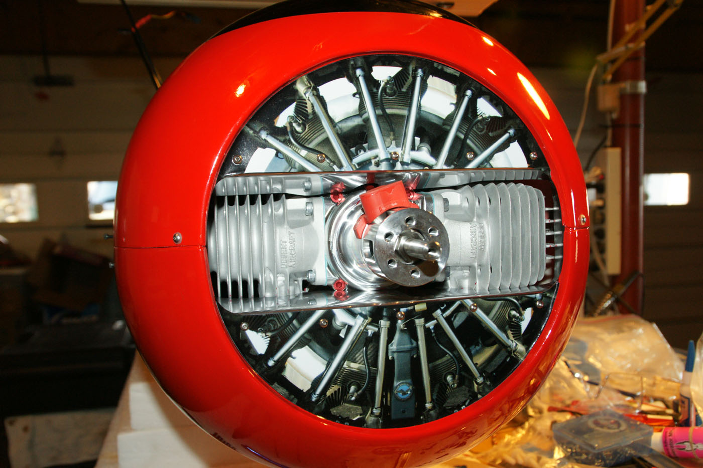

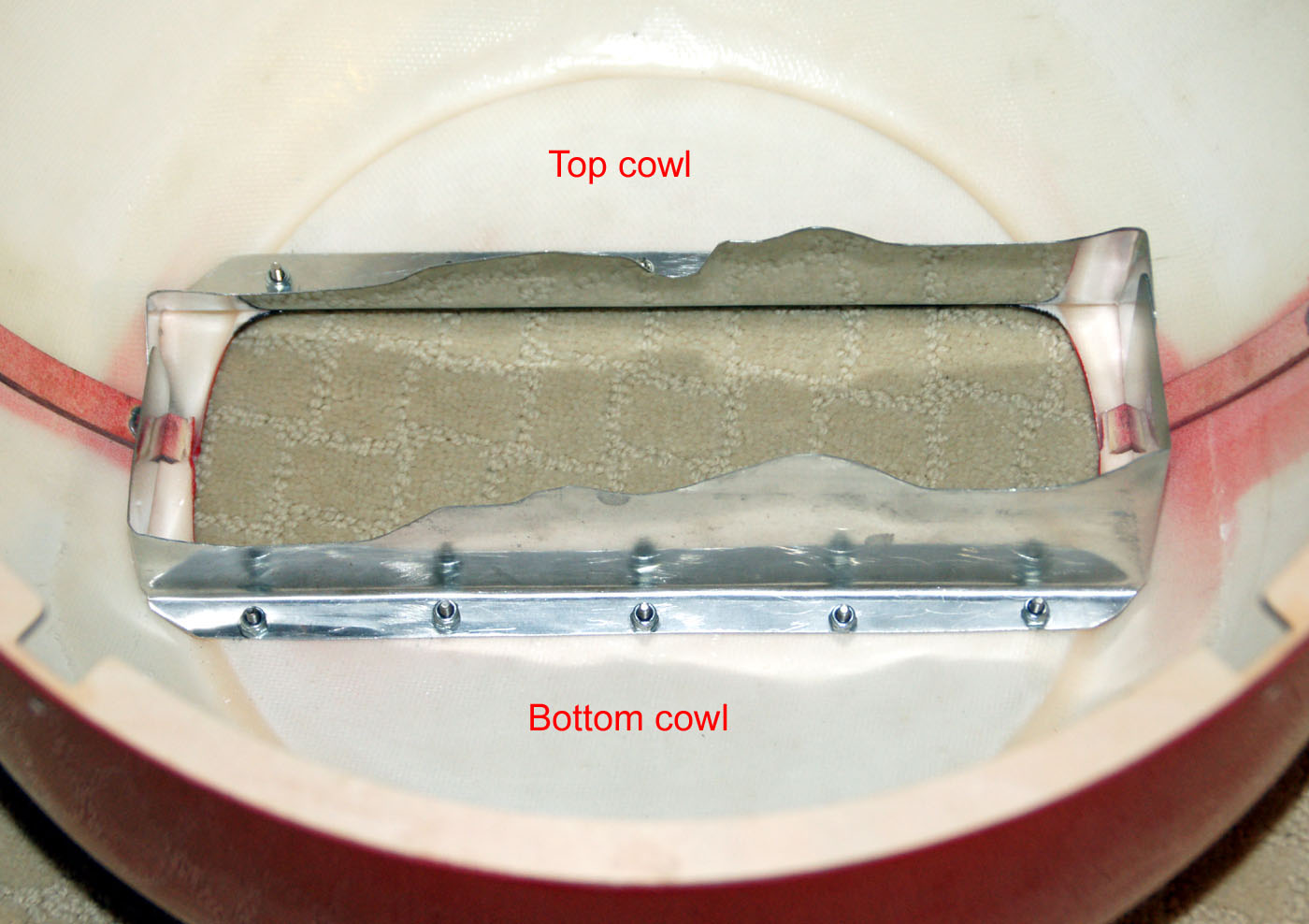

Hard to beat that B&E Graphics Pratt& Whitney radial!!! On the scoop....I cut two crosswise slots on the back of mine so the air essentially just flows thru it. You can just make out the rearmost one in this pic. The rectangular opening behind the scoop is for the exhaust.
