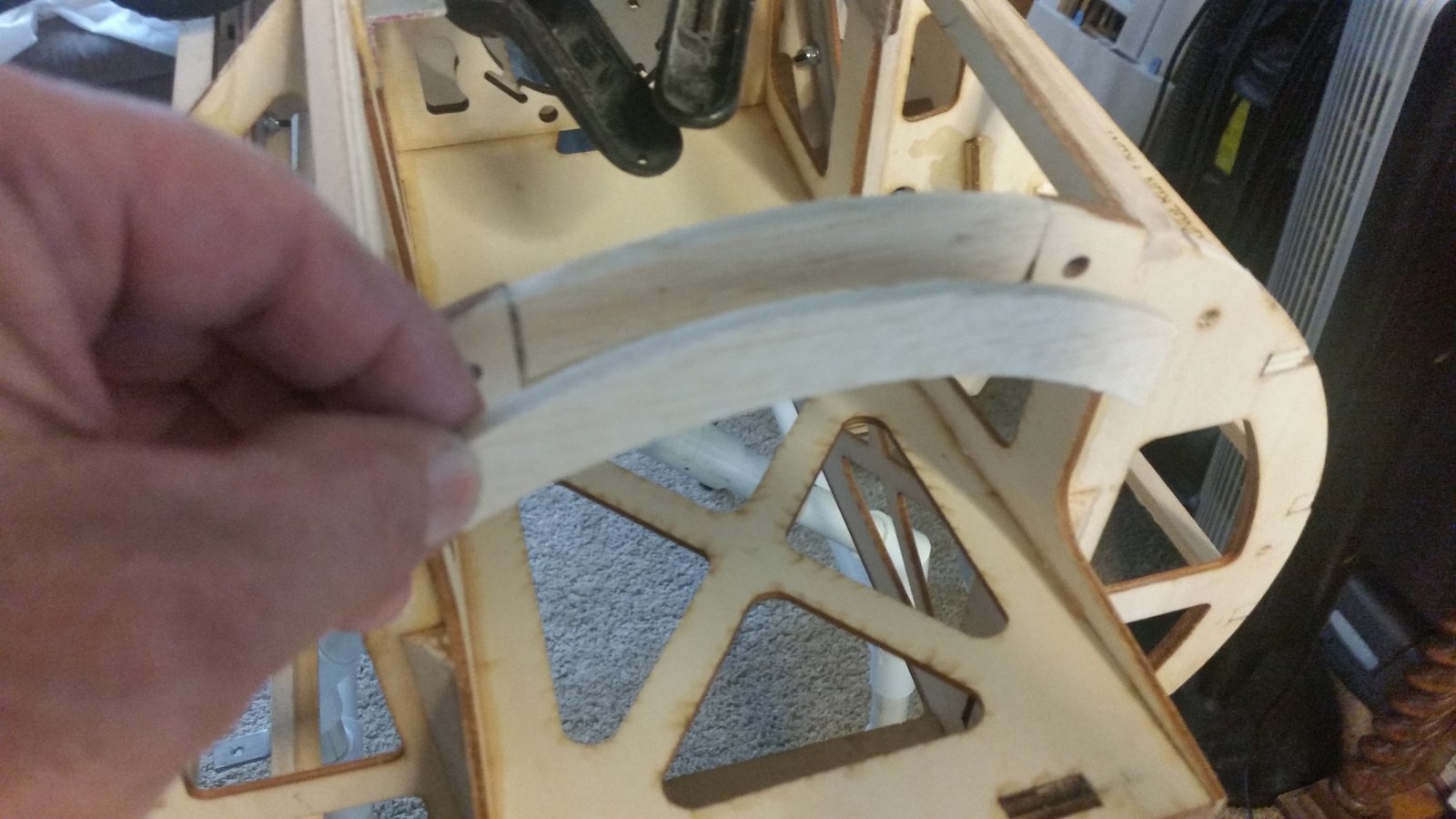

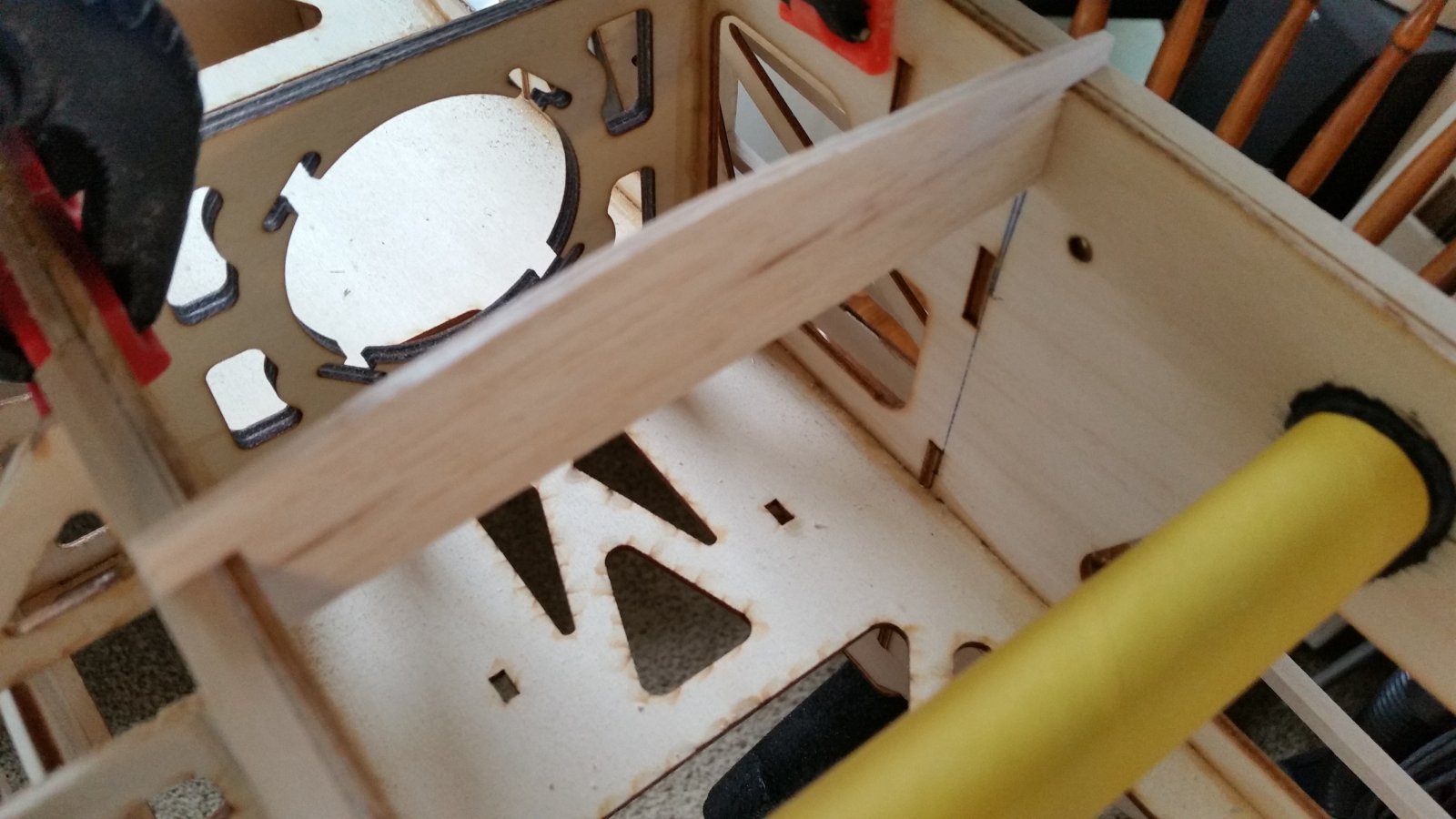

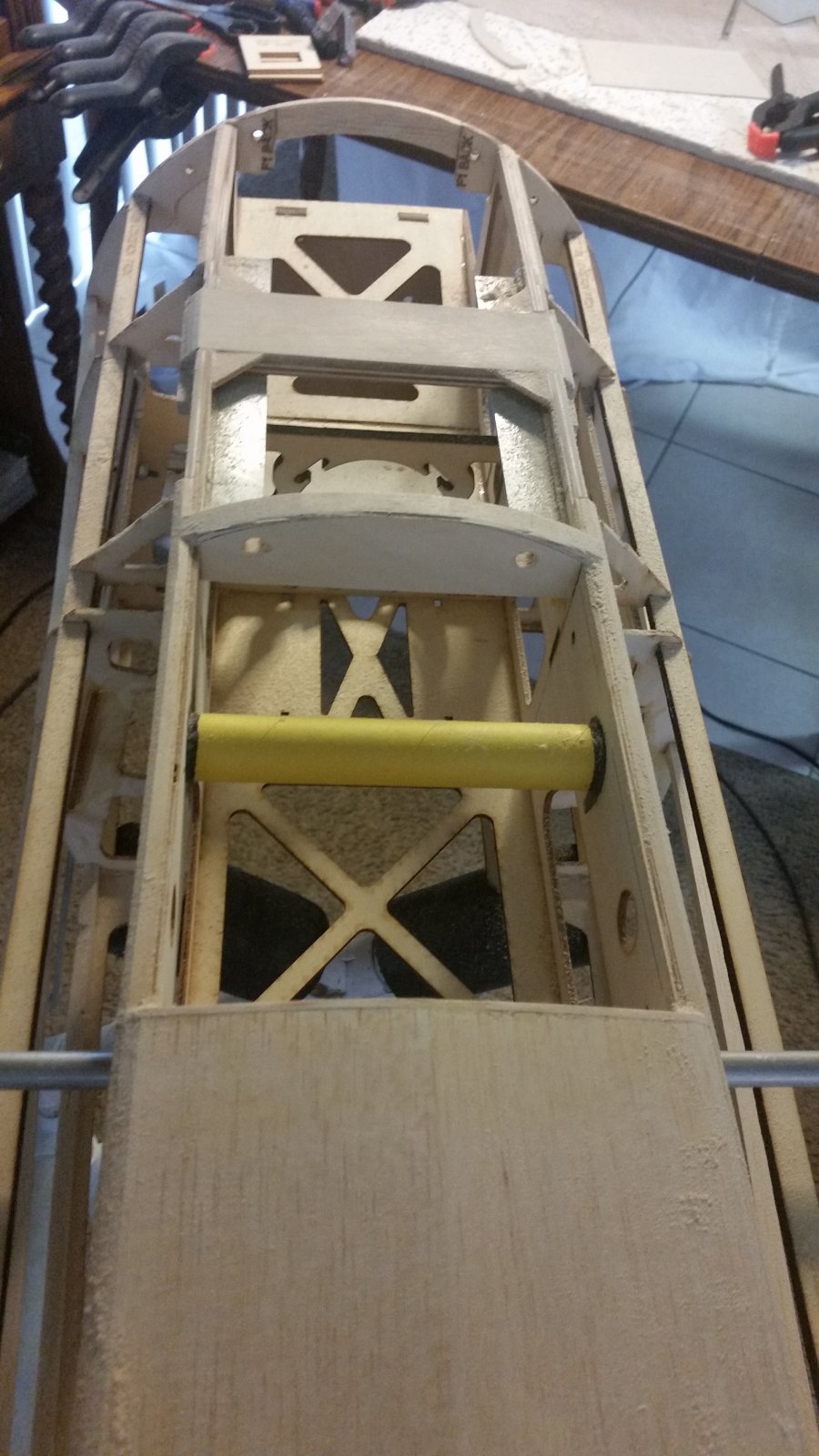

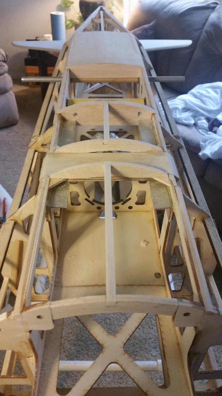

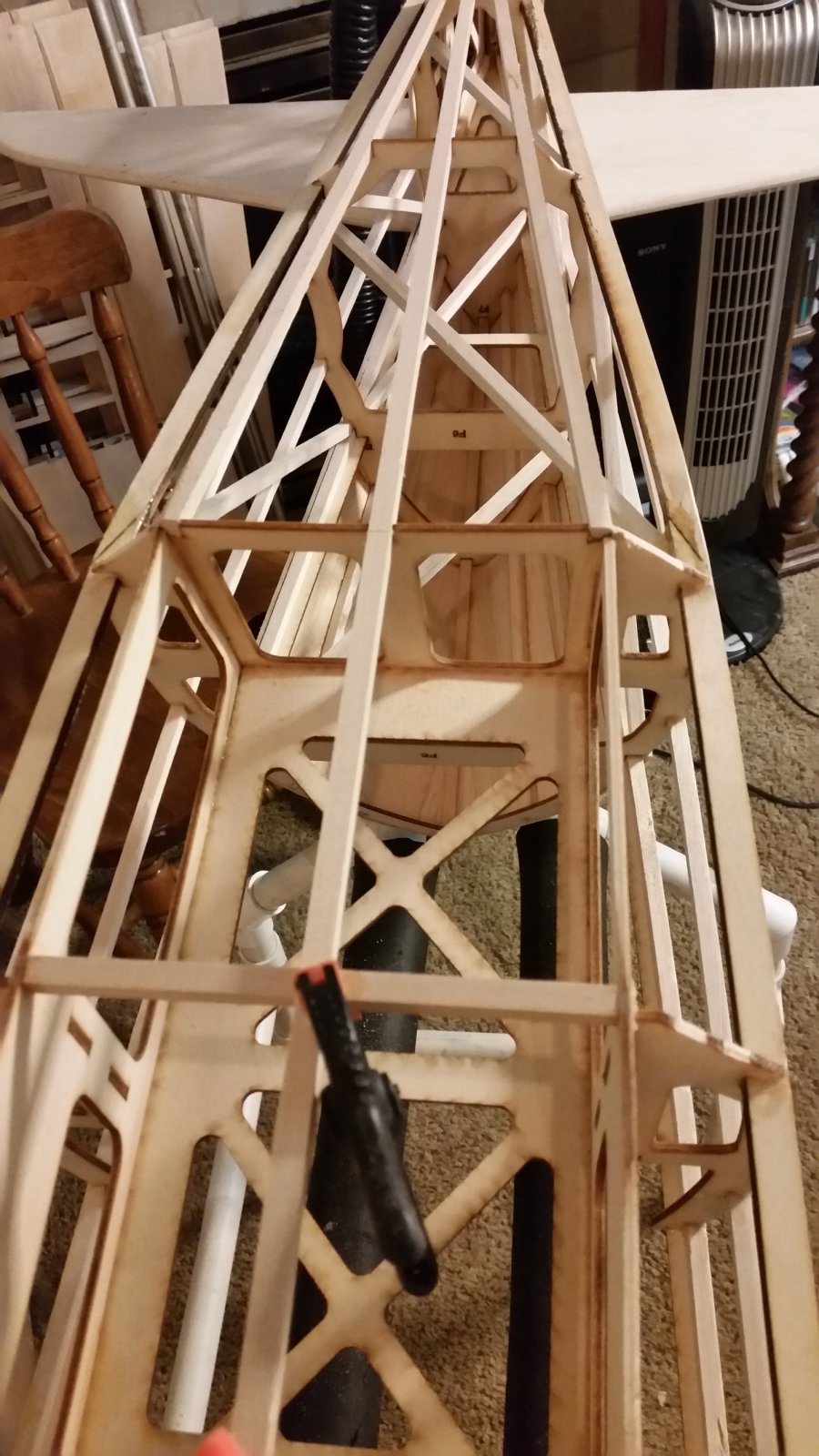

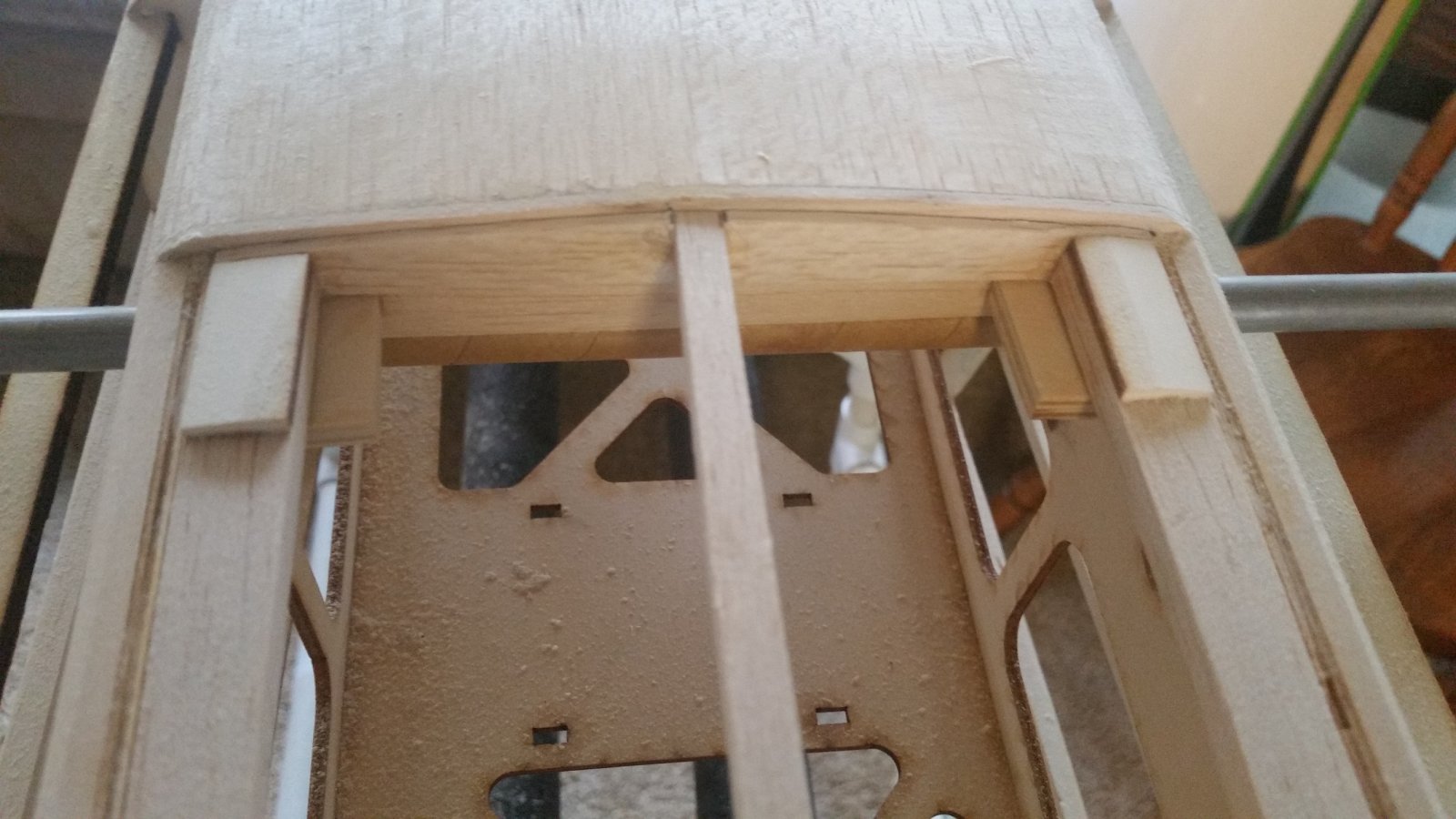

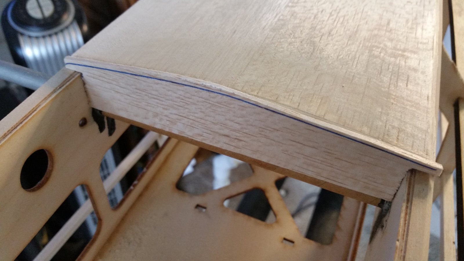

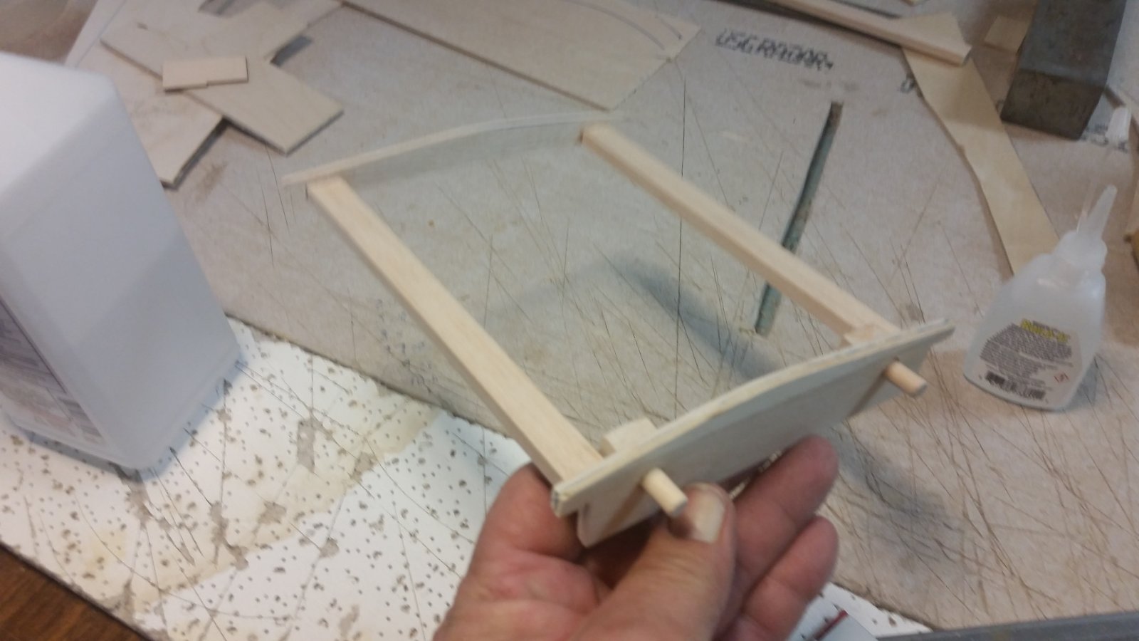

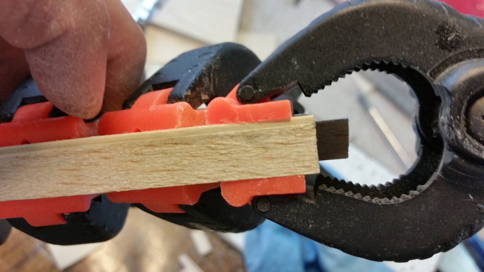

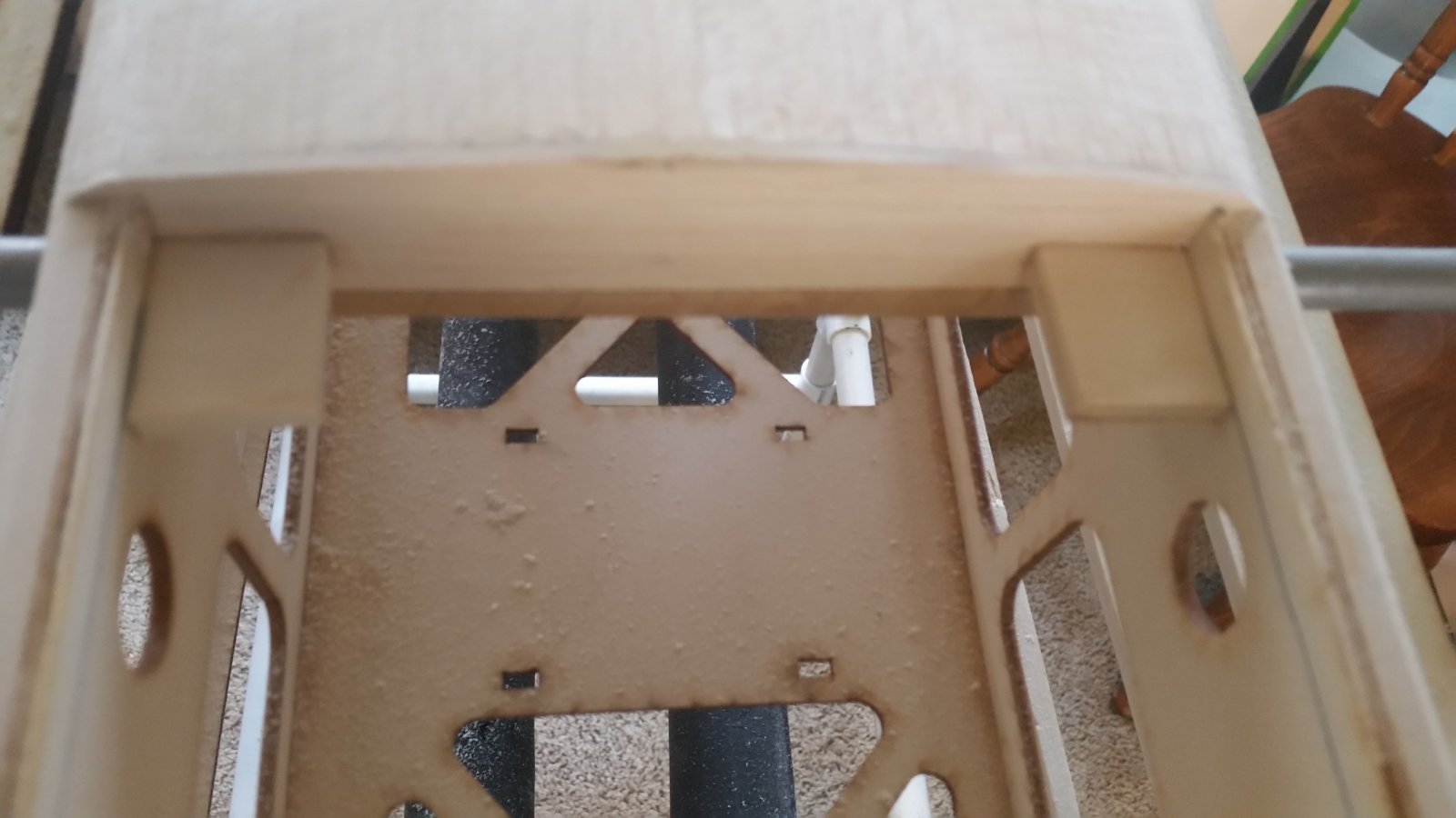

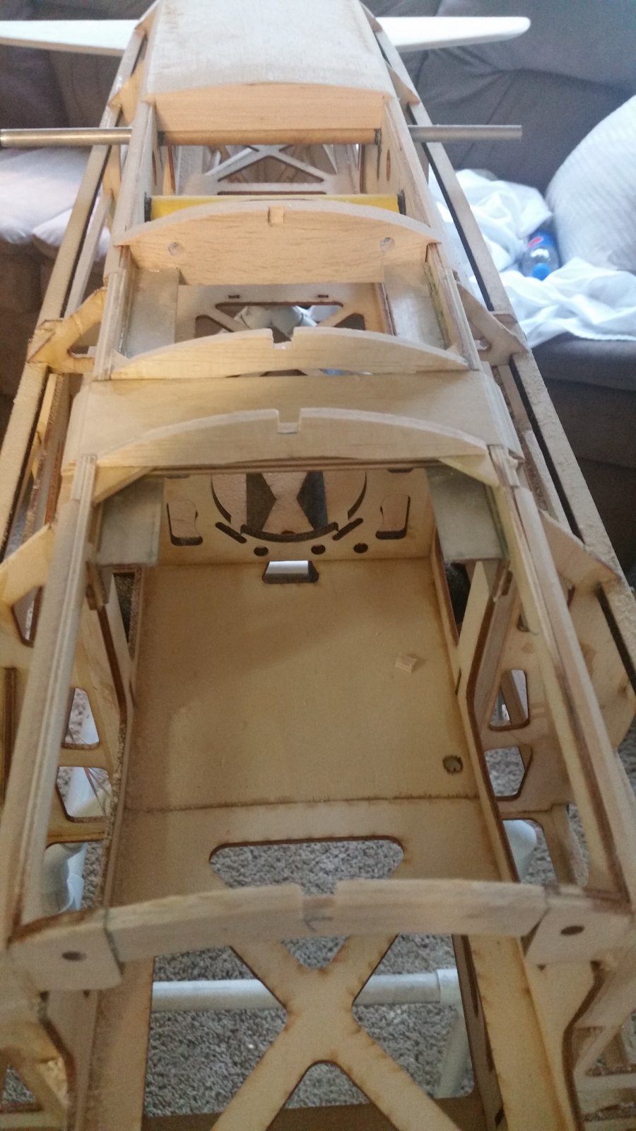

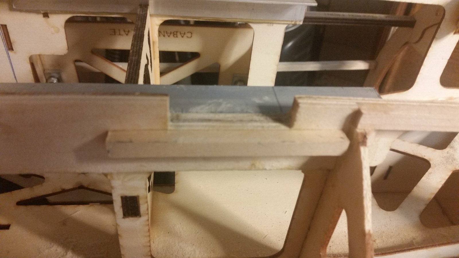

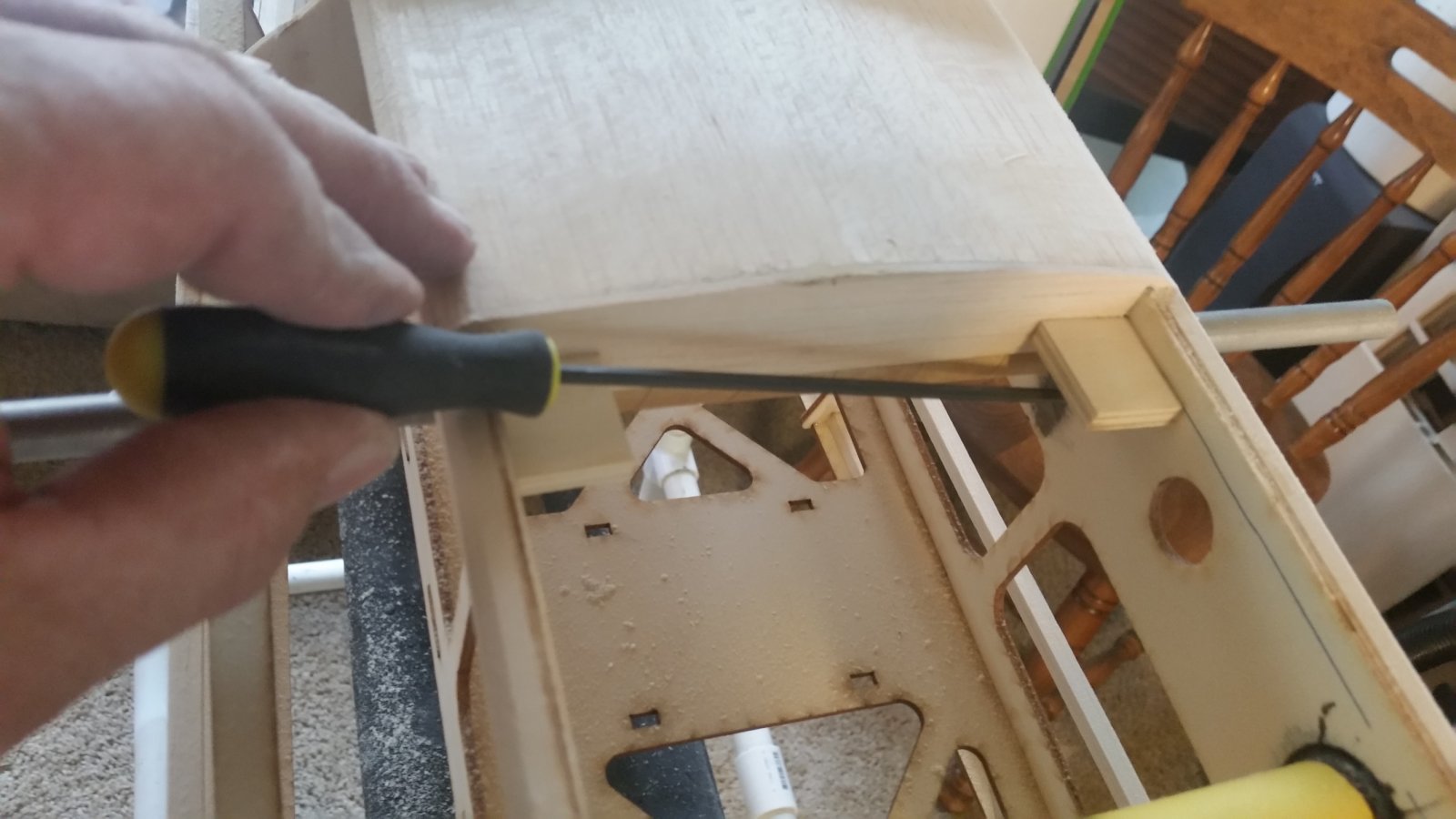

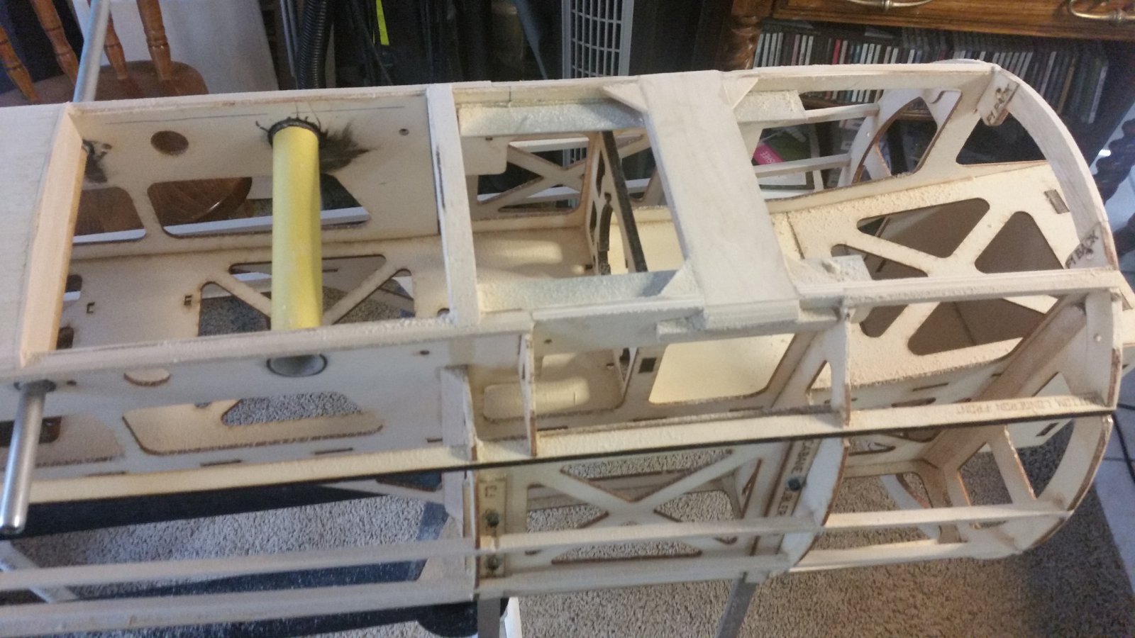

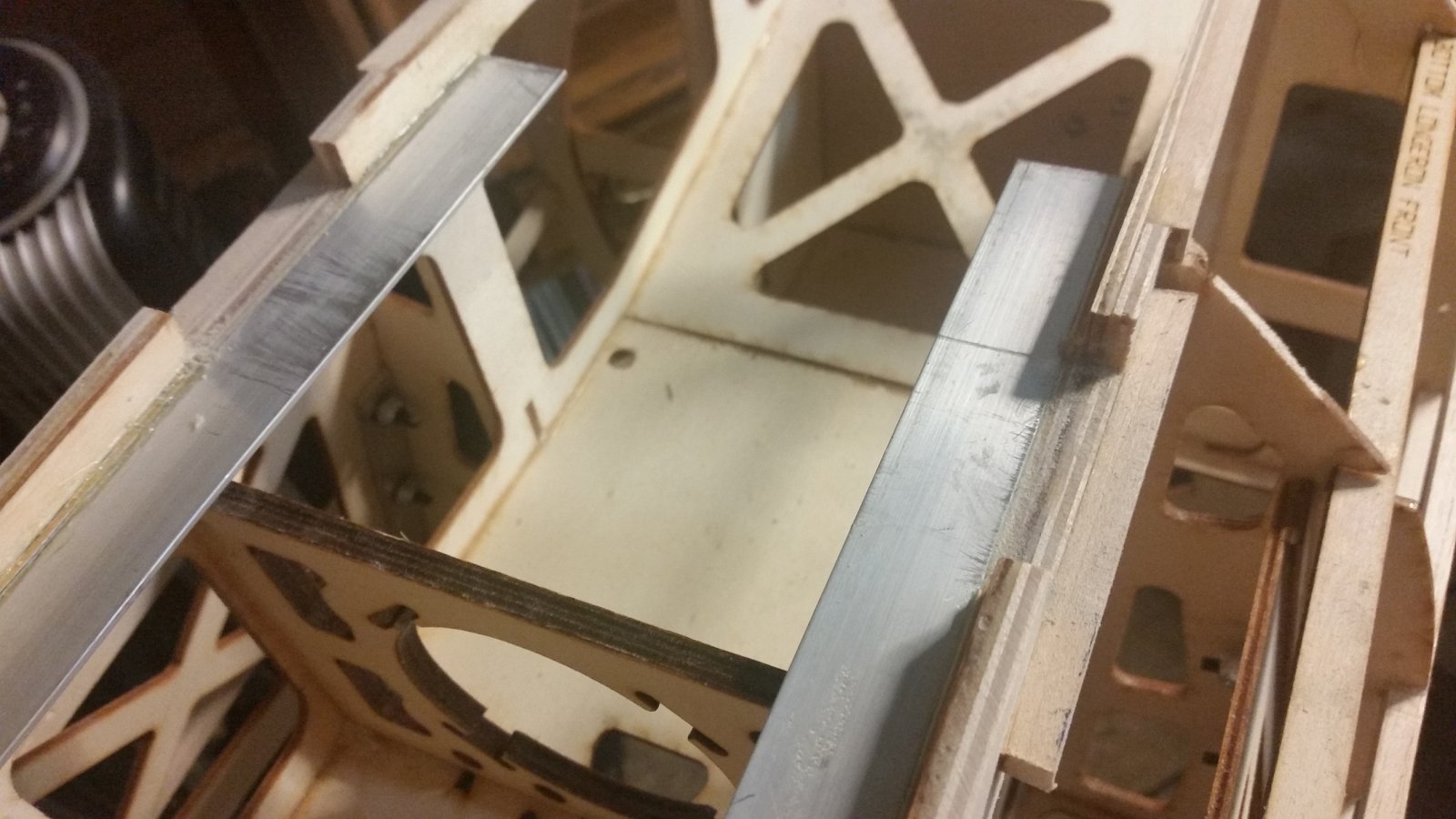

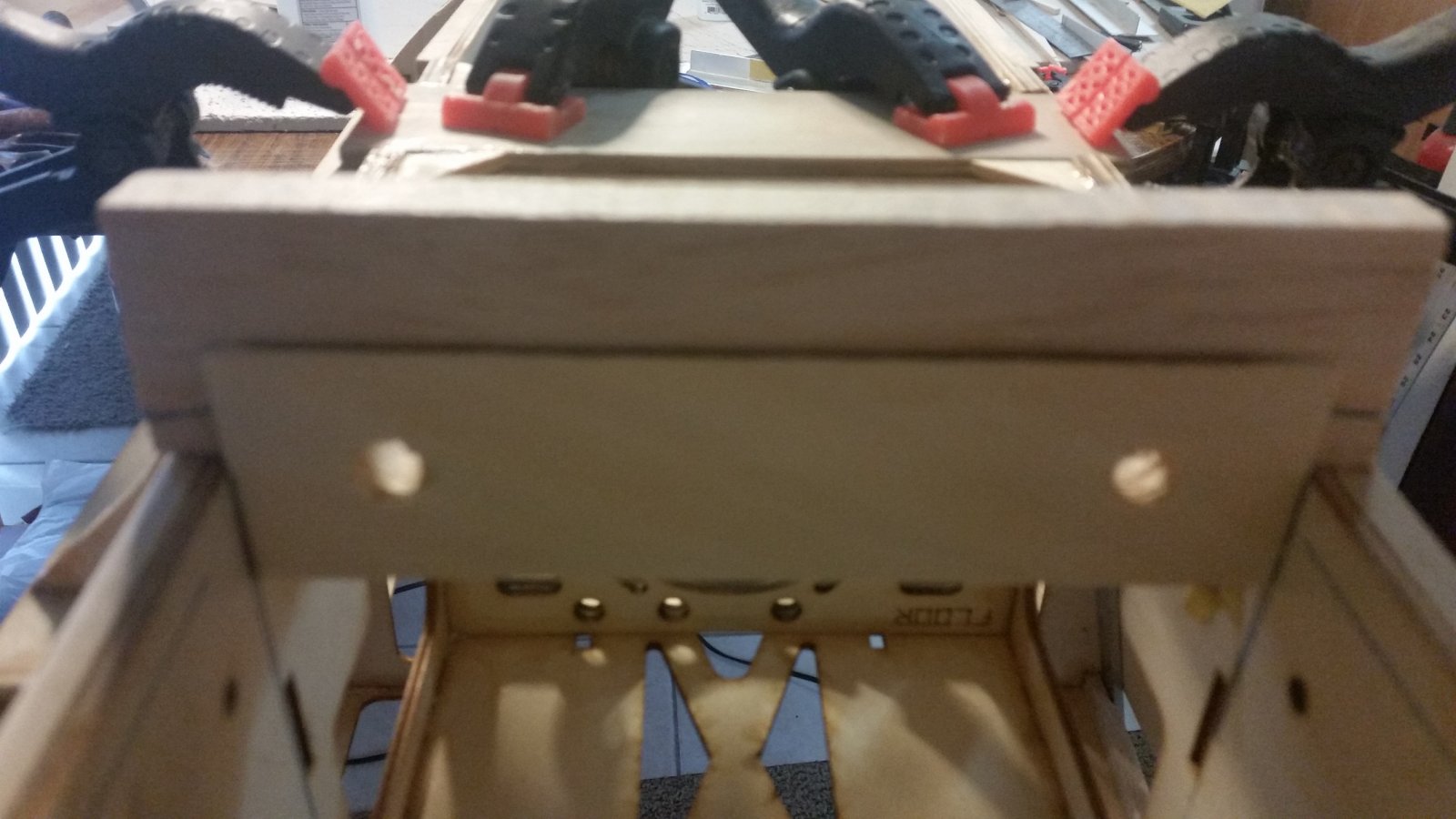

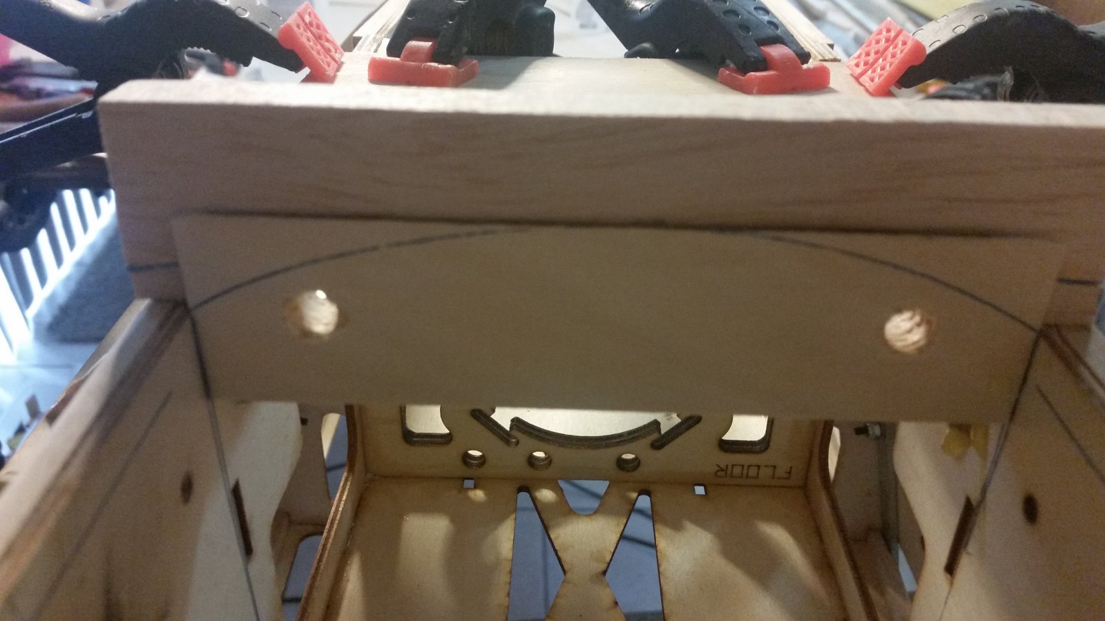

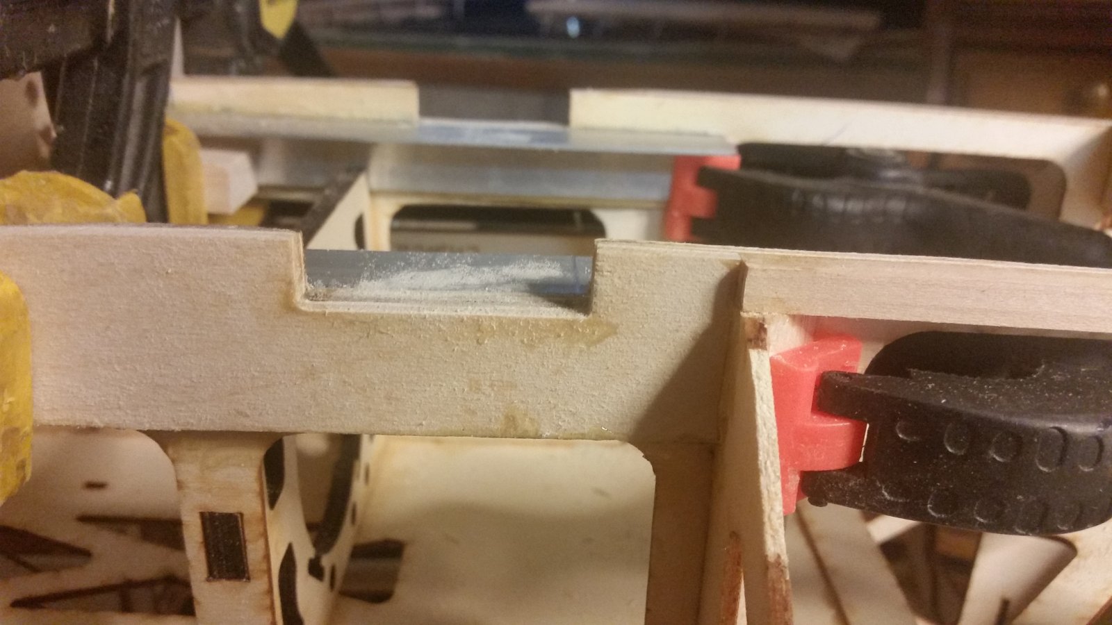

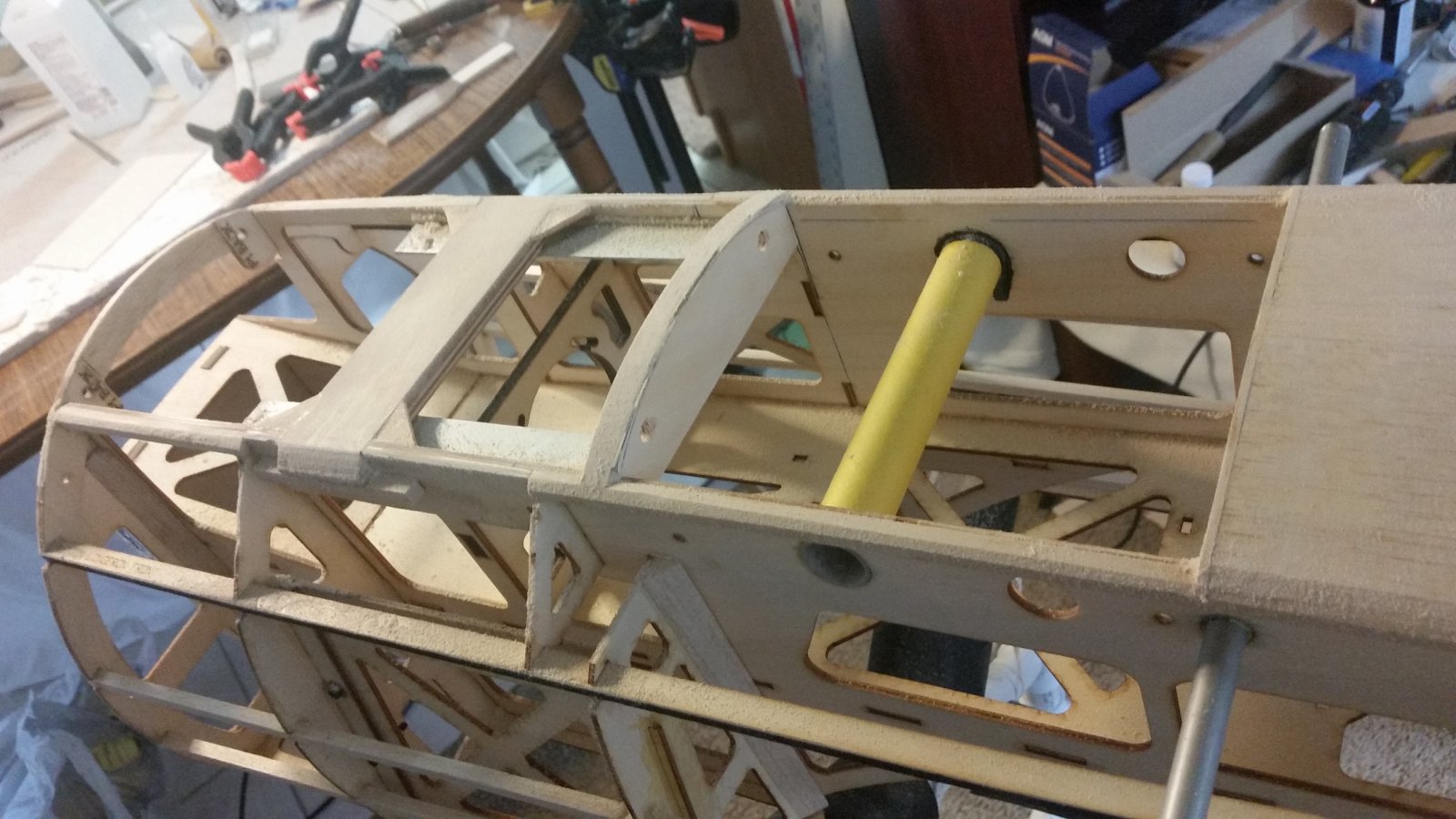

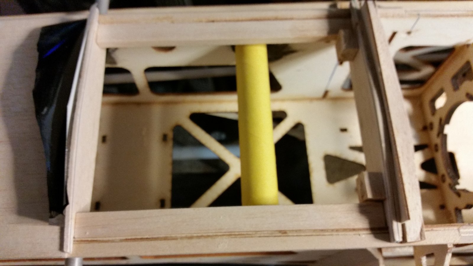

Photos from yesterday. Started with extending the belly stringers to allow structure for the intended belly sheeting.

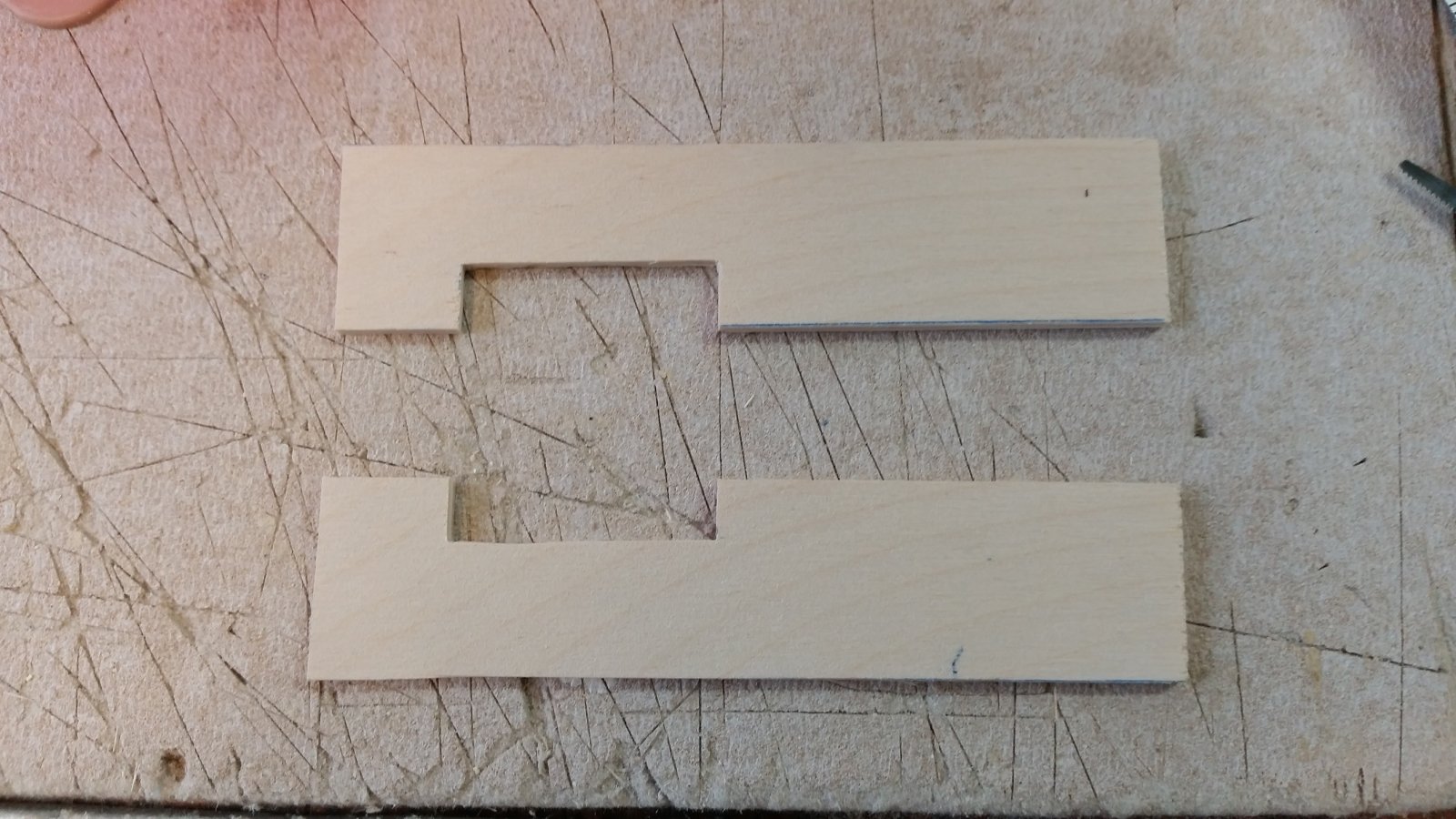

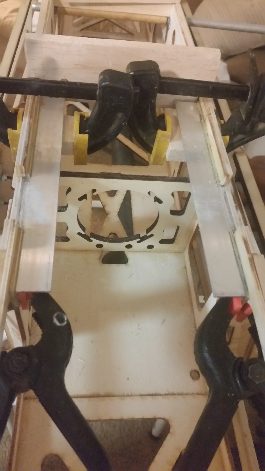

Landing gear plate doublers.

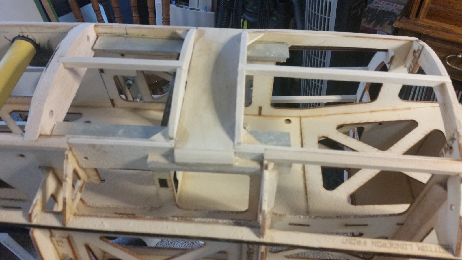

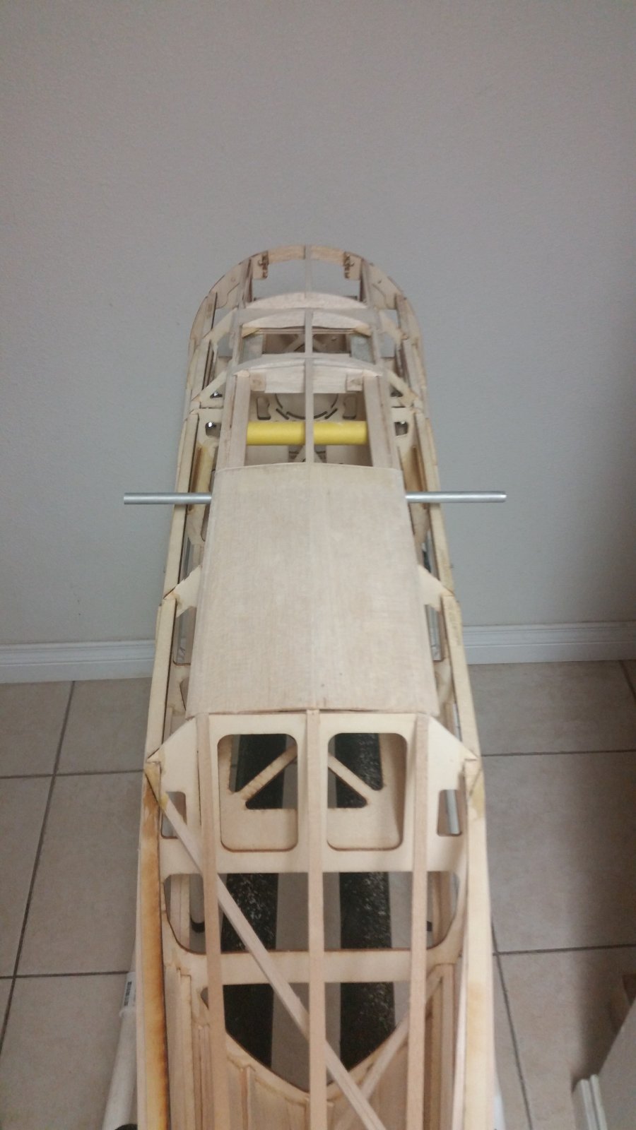

First section of belly sheeting in place.
Rough cut outs of the fuse belly formers.

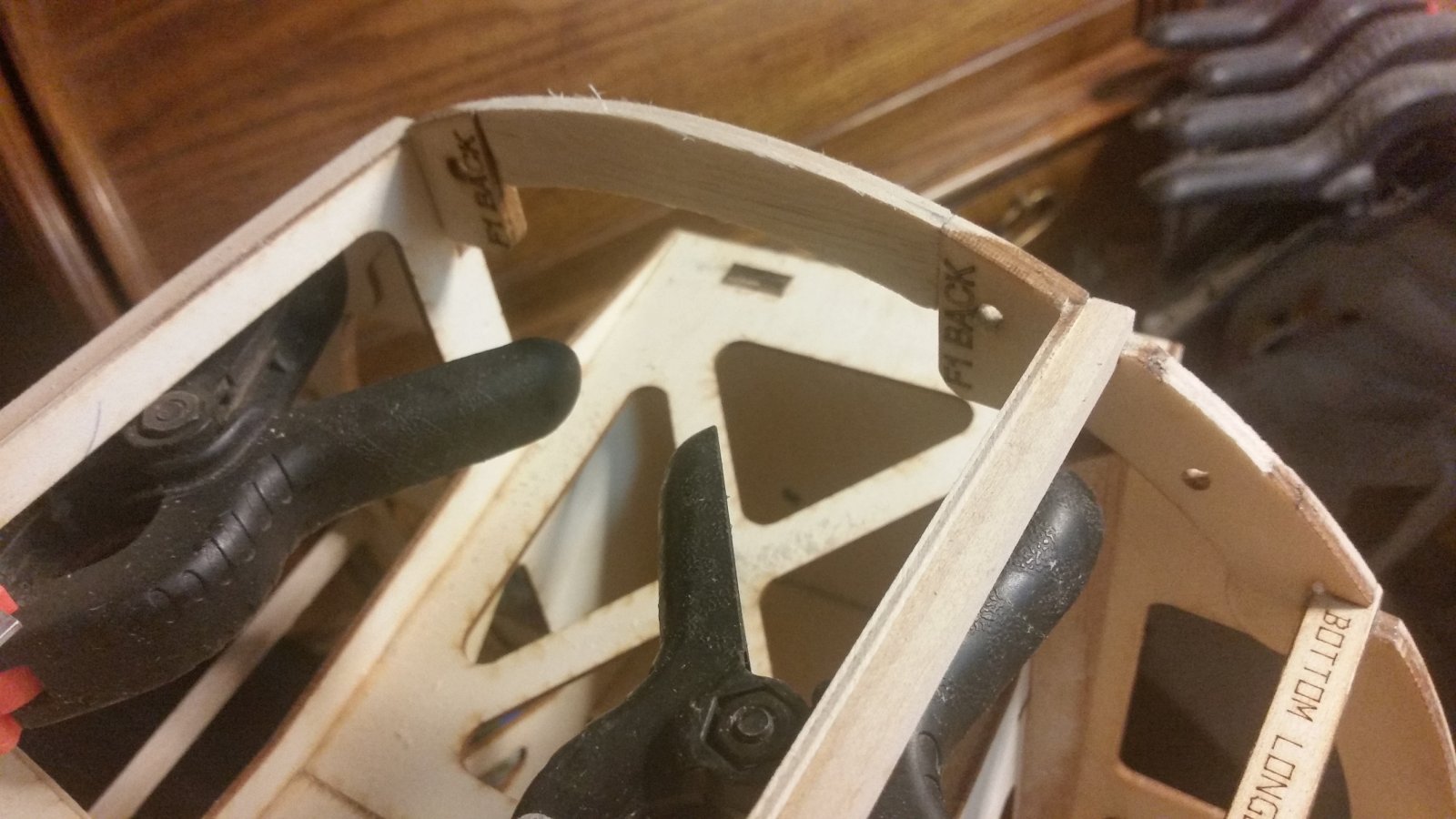

Building the bulkhead for the dowel retention plate.

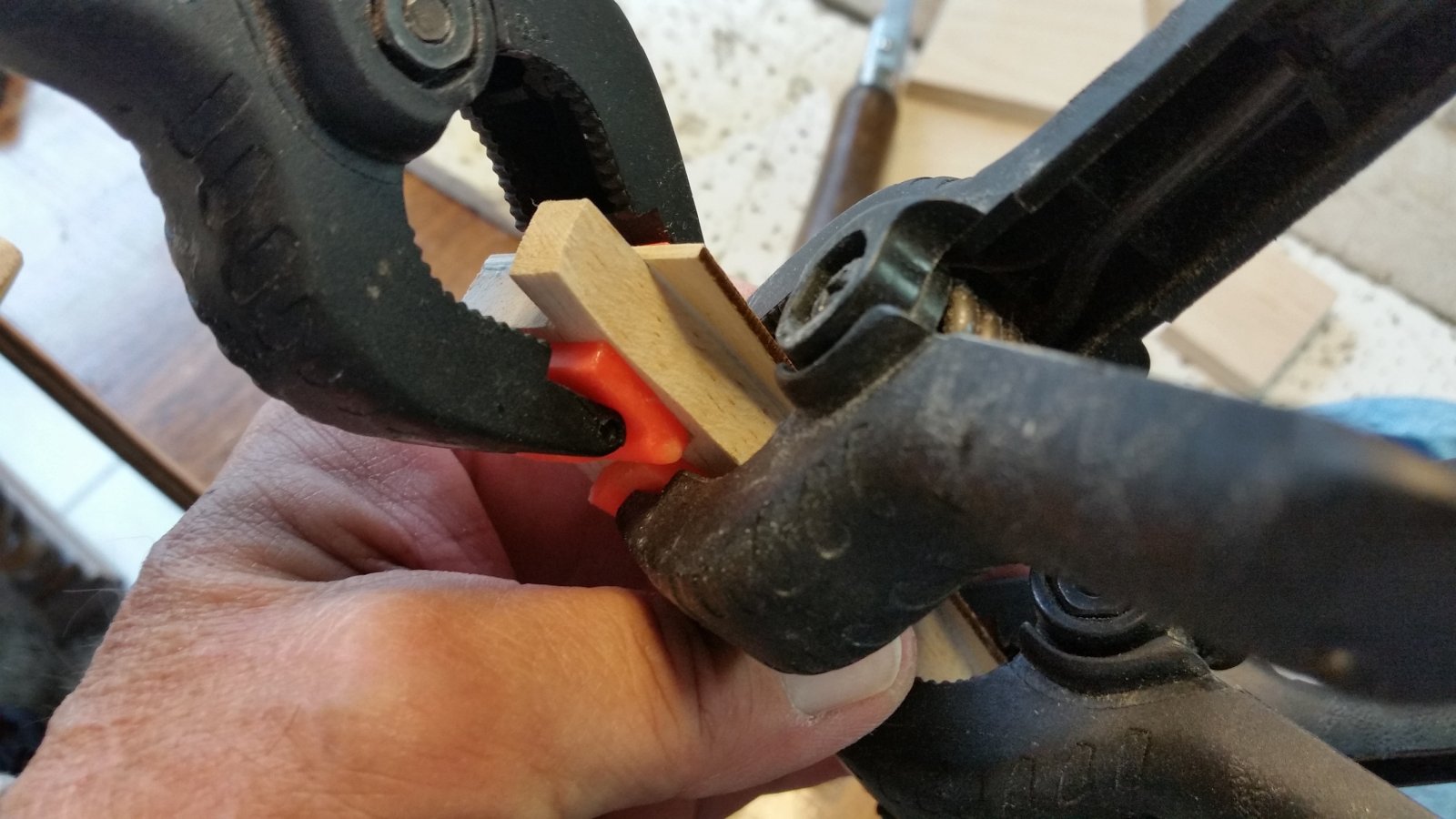

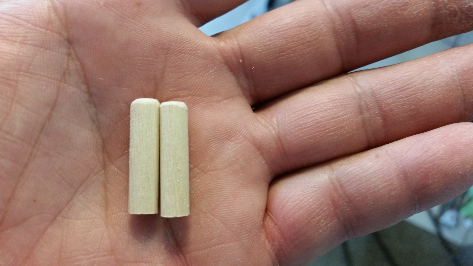

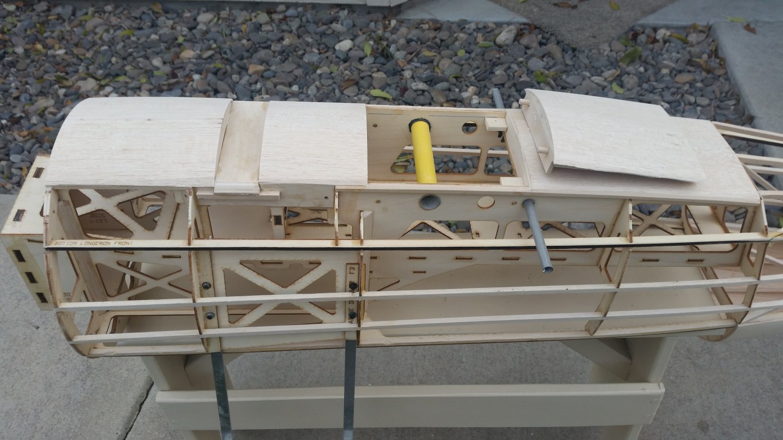

Belly hatch hold down dowels.
Framing up the removable belly hatch.

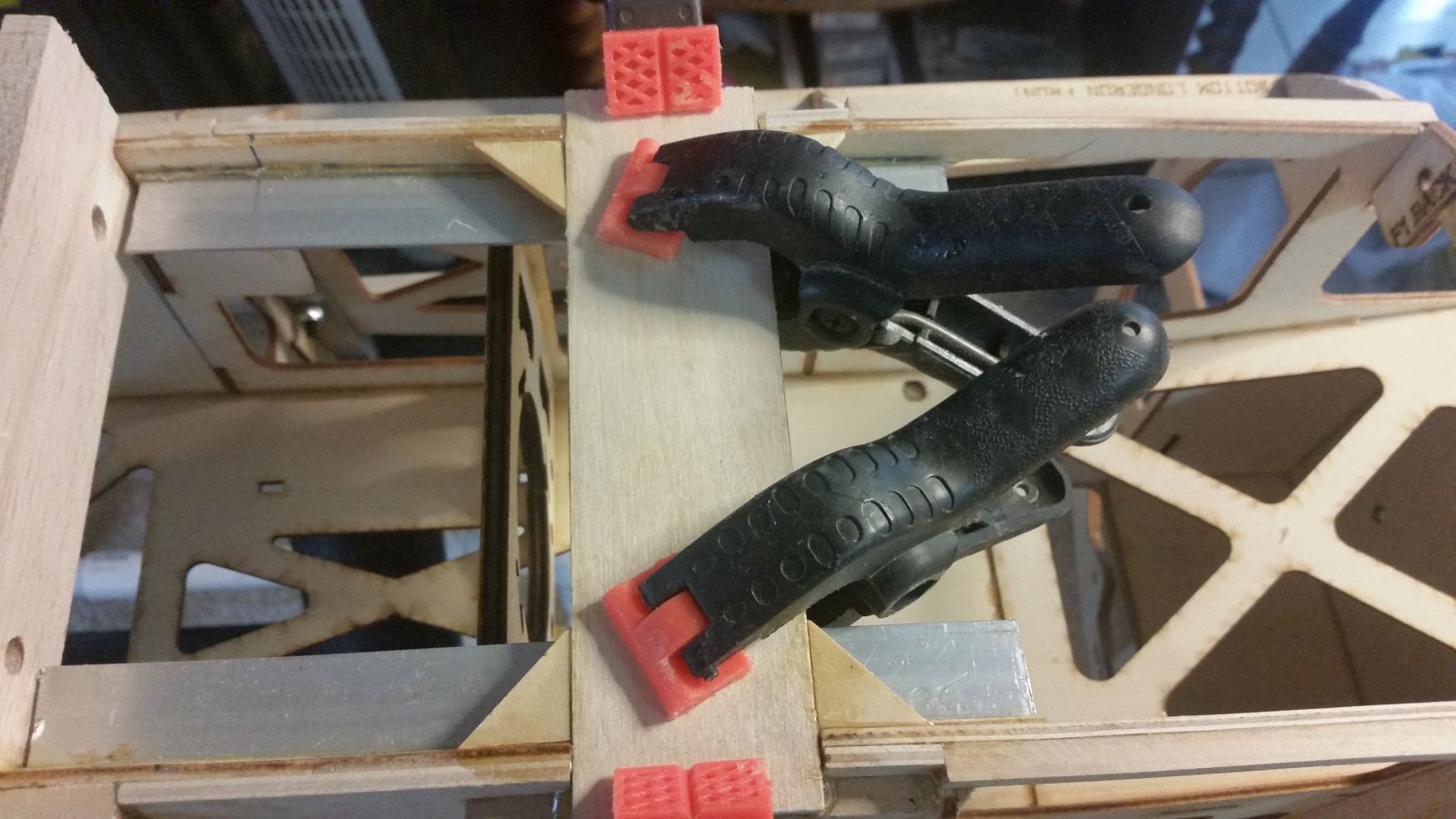

Doublers epoxied in, angle braces in place.
F1 former addition.
Now ready for the landing gear plate.
Pretty much what I had accomplished up to this morning. More photos on the way.

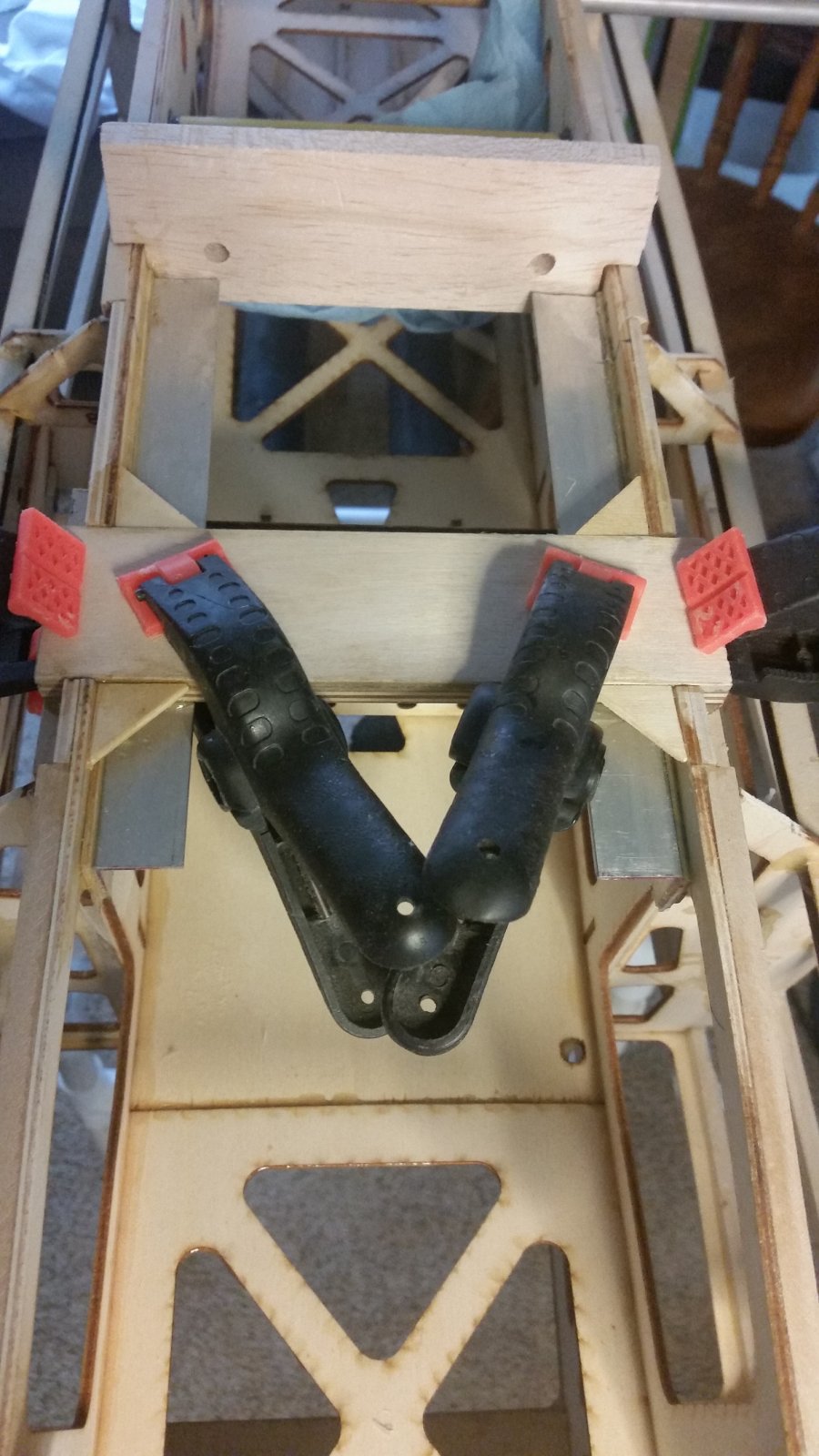

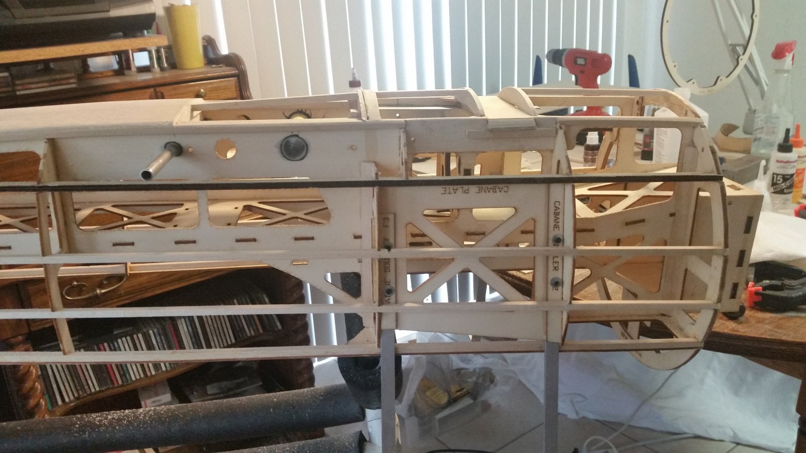

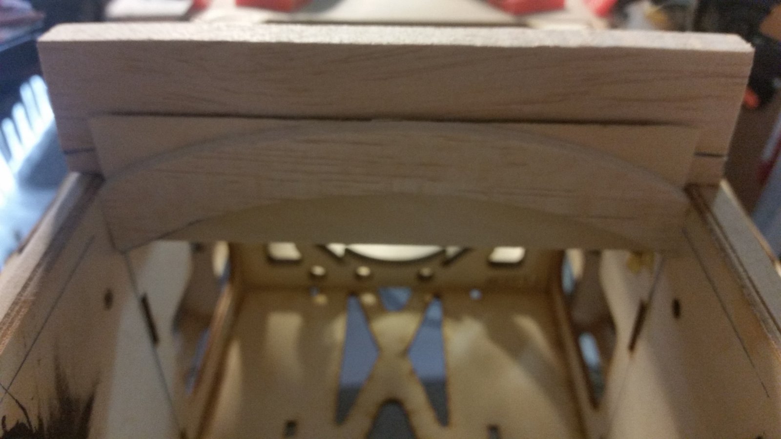

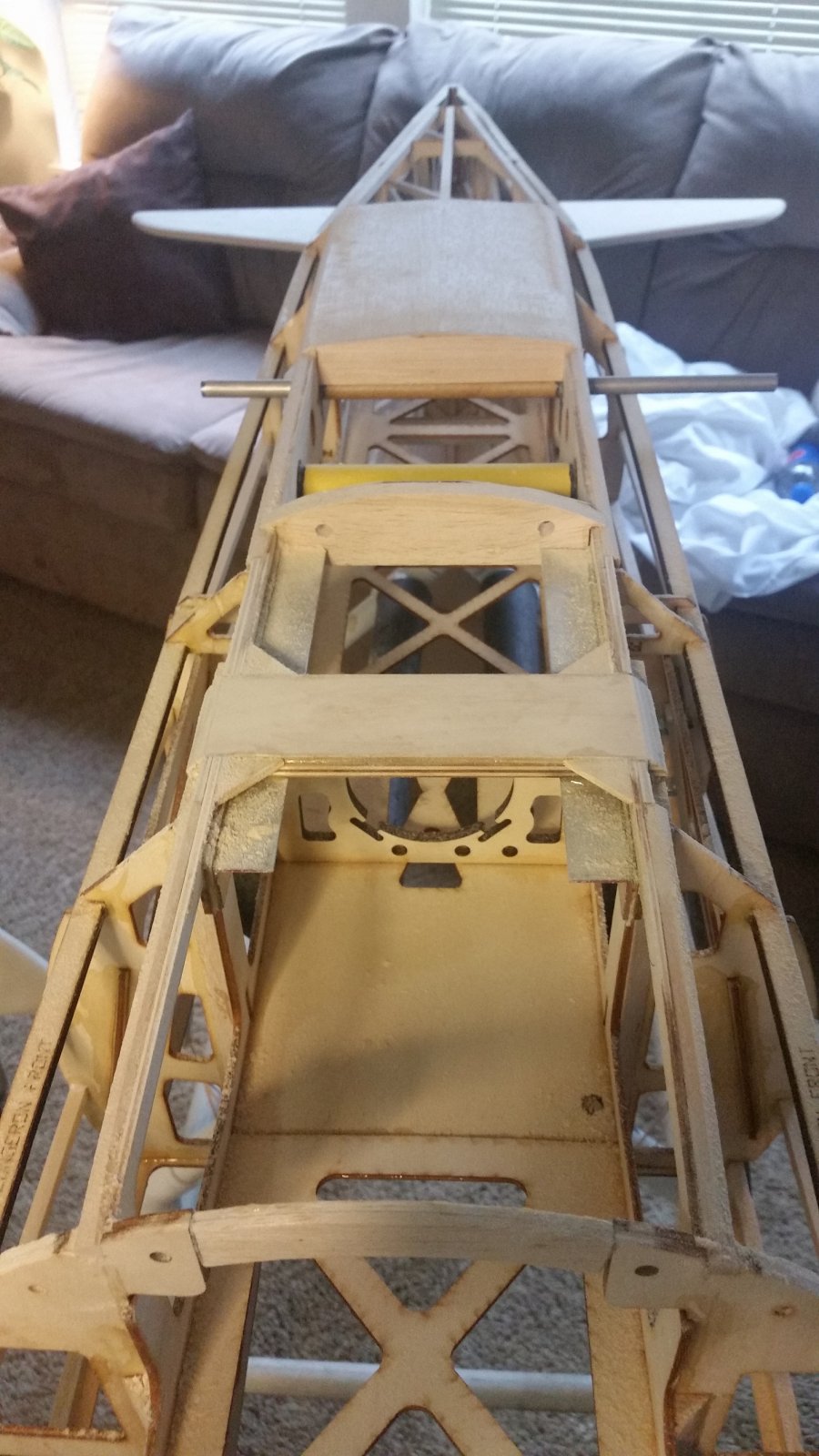

Todays progress was much more fruitful. I got quite a bit done and am now pretty much ready for sheeting on the remaining portion of the fuse. I have done a "LOT" of scratch building on this Pitts. Mainly because there were certain things that I just didn't like. Other things because I wanted it to look nice. Both on the ground and in the air. I still don't feel I have done this plane justice. There is "SO" much a person can do to it, but at the risk of weight for the size, it just isn't practical.
Today I started with getting the landing gear plate epoxied into position and clamped down. Then started measuring, cutting and placing formers for the belly sheeting. I tried to stay as minimal and as light as possible. I would have added more stringers but really don't feel they will be necessary. All total, the weight I added from the formers and belly sheeting will probably not go over 6 ounces. Not really a lot but not much I could really do from the way the fuse is designed. I just really didn't want a big open gaping cavity in the bottom of the fuse.
I may start sheeting the fuse tomorrow. I am so close to having this built now, I just don't want to stop. My eyes are crossing tonight, so I am calling it good. It's getting closer now. Won't be too much longer before I am ready to start covering. Other than the servo rails for the wings, they are completely done and ready to be covered.

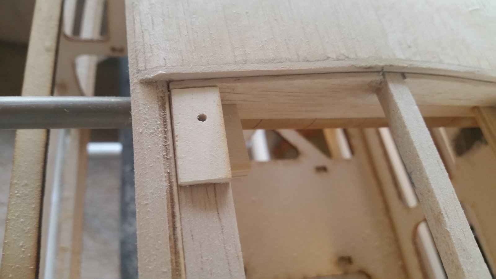

At one point in designing the removable hatch and hold downs, I was concerned if I would have enough room to get the lower wing rear bolts in. After a quick check of angle, I discovered I will have plenty of room so no worries. The rest of the photos are pretty much self explanatory.
I am actually pretty excited of how the belly turned out. I think it will really add to the appearance of the plane and my even enhance the flying characteristics over just having an open gaping hole in the bottom of the fuse as originally designed.

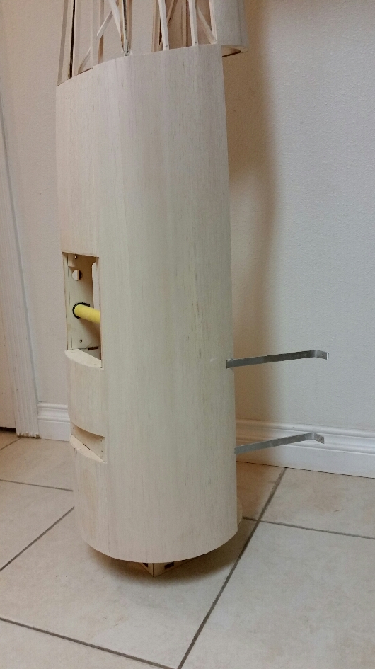

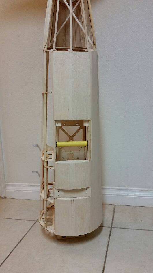

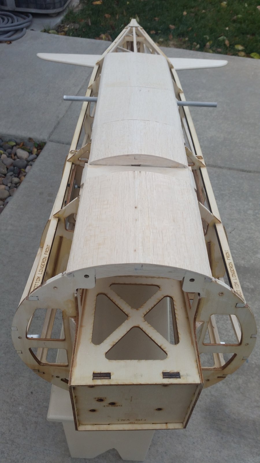

So here is the plan for the Pitts. Tonight...going back to bed. Hee hee. Tomorrow after work, I am going to get at least one side of the fuse sheeted. Then hopefully the opposite side on Wednesday. That will leave basic final sanding and prep work for....yup, covering this weekend? I really enjoy covering. This one should prove to be very interesting.

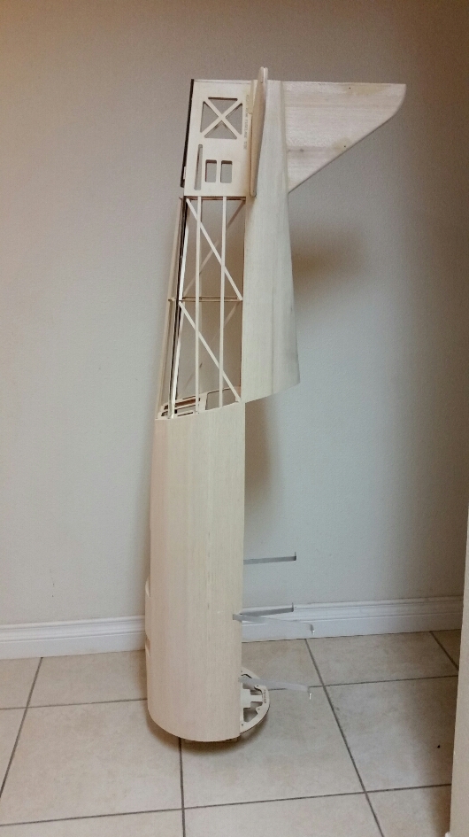

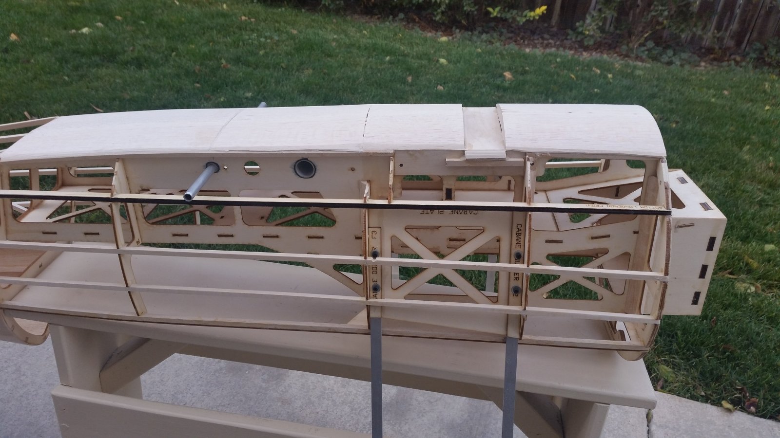

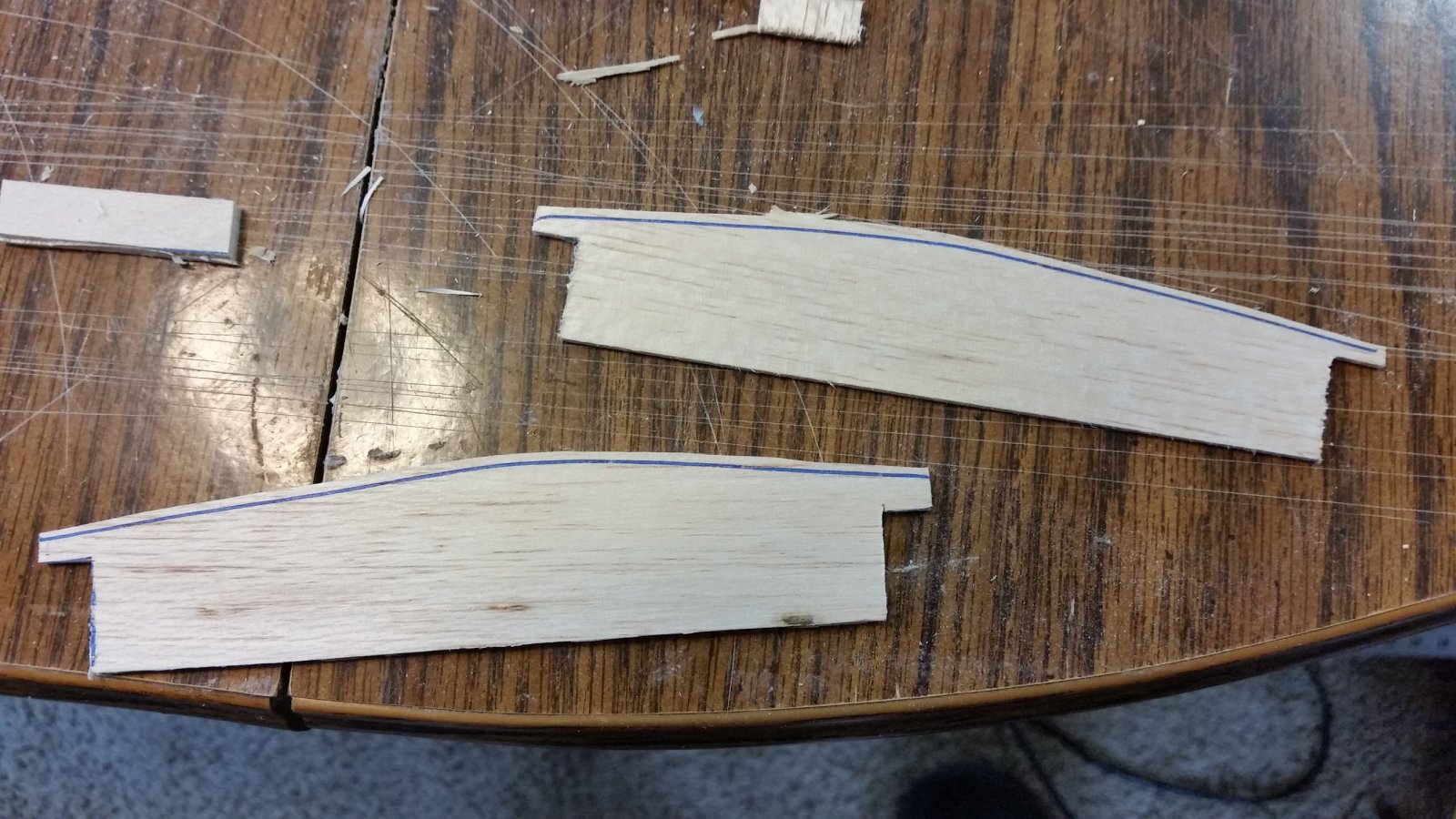

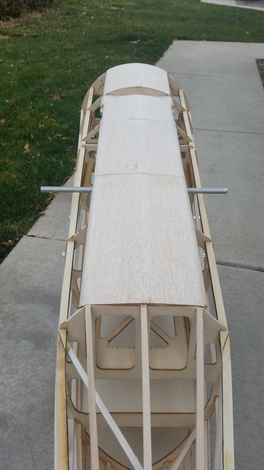

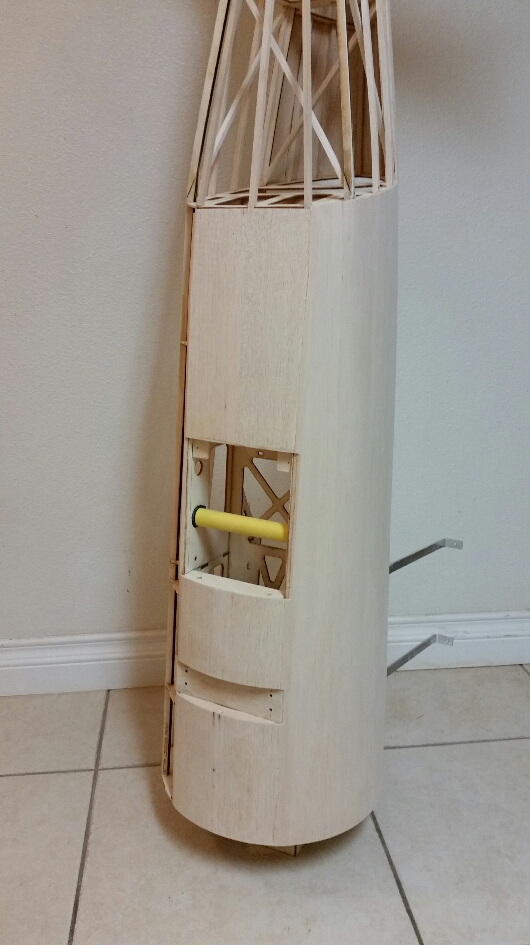

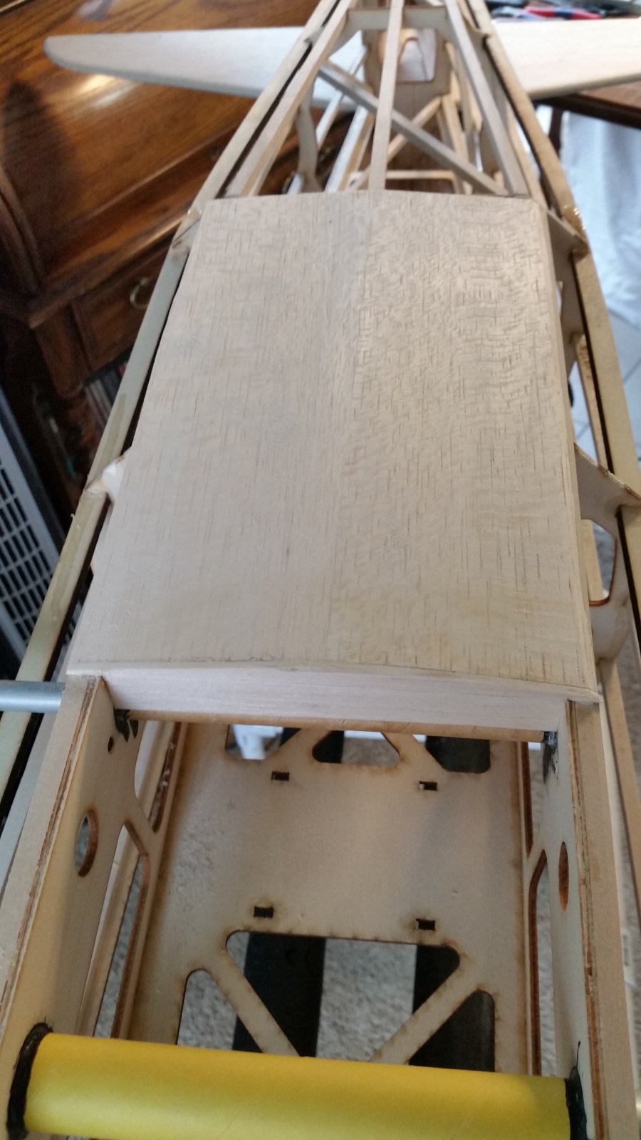

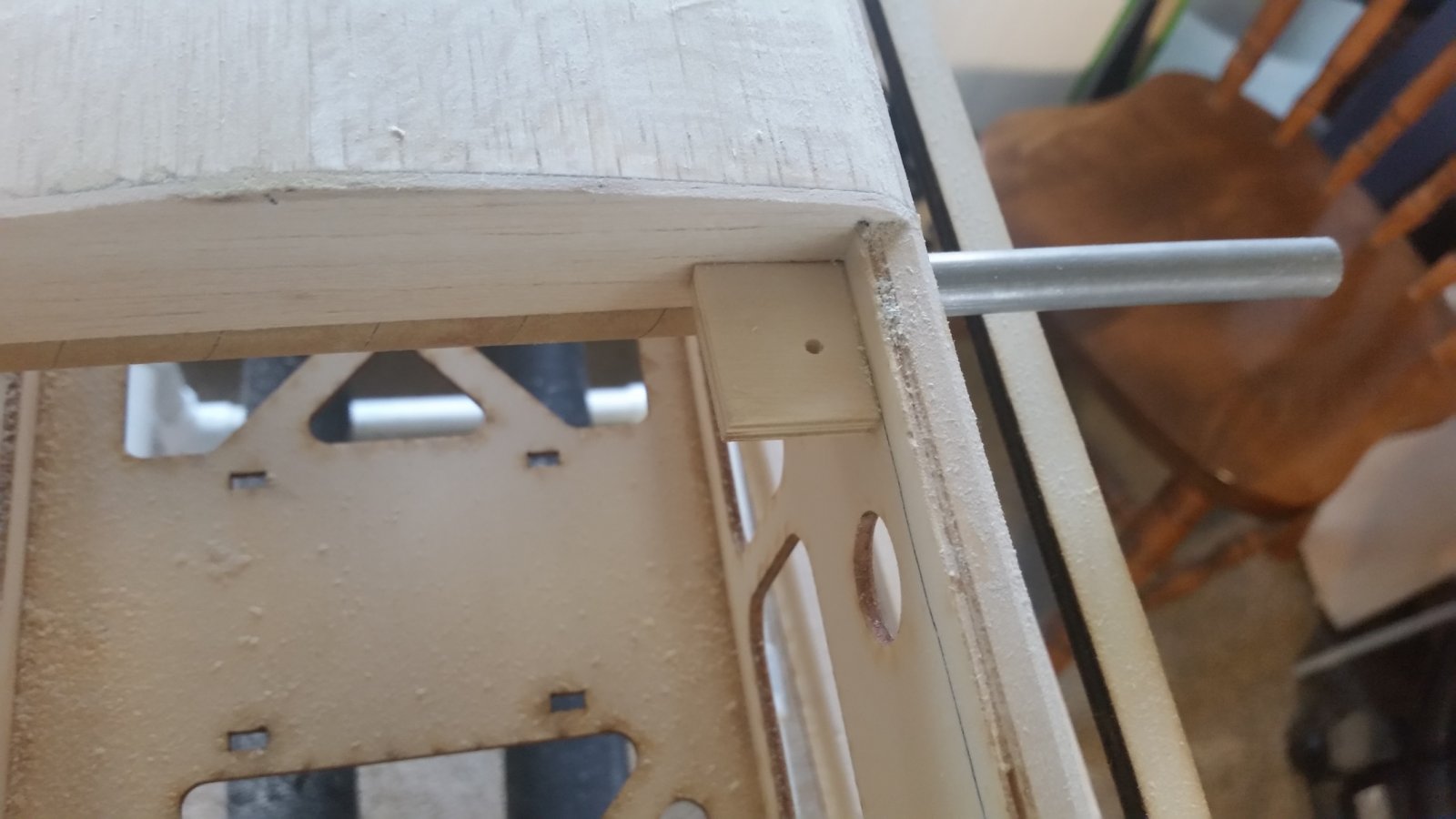

Tuesday night and I've been able to get the right side of the fuse sheeted. It actually went much quicker and way easier than I thought it would. About three hours total from the time I edge glued the right fuse skin, glued it to the fuse, and then a quick sanding to knock off the rough edges. If I'd known it would have been this easy, I'd not have put it off. It turned out pretty good and only a little more minor sanding and it should be ready to cover.

Tomorrow I'll knock out the left side sheeting. Then final sand and do one more final test fit before I start covering this weekend.
