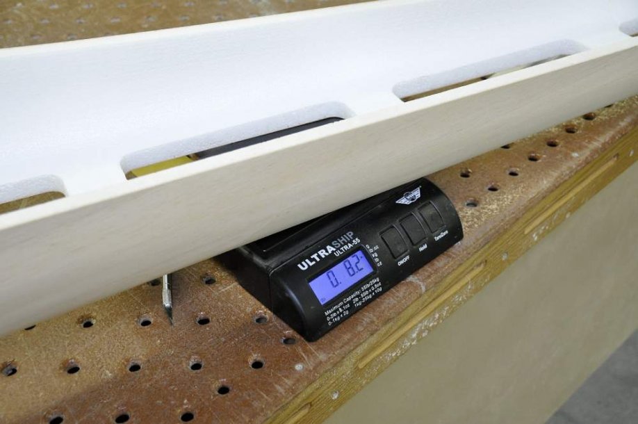

I'm still undecided on my motor, it will either be a DA100 or a DLE120. Post some pictures when you start setting the pipes up, I might like to put them on mine too.

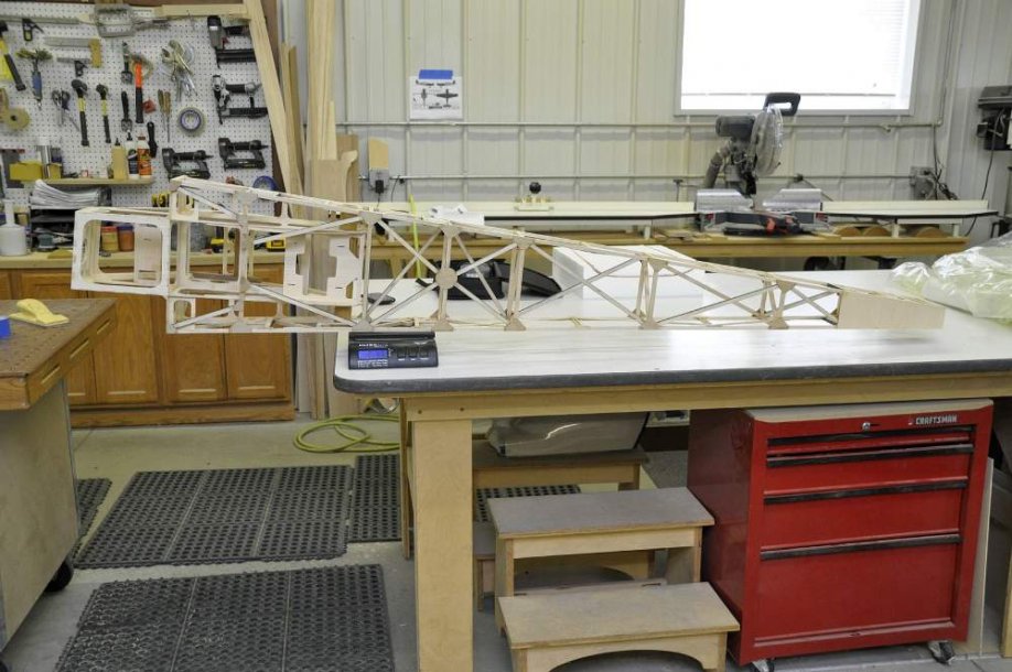

I will have to weigh my fuse but I think i was just under 3lbs too.
I had planned on using one of my DA's but I'm a little concerned about the shaking thing. I decided this project deserves a new engine so I just got the GP and will put it in one of my planes for about 20 - 30 flights and start breaking it in.
Good to know we are close on the weight.

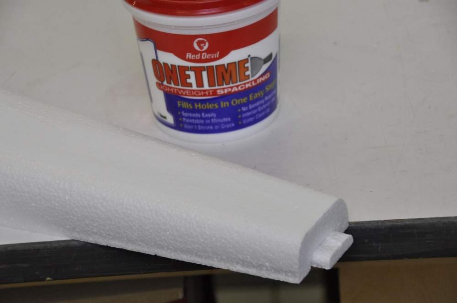

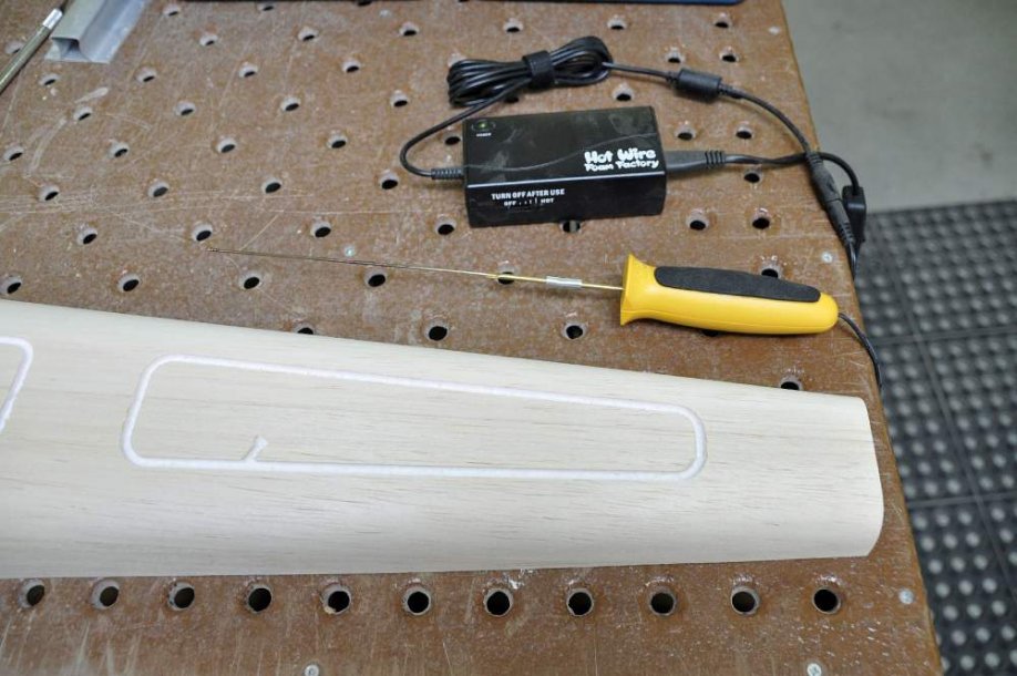

Yup, Lightweight spackling works perfect. Just fill it, smooth flat and let dry for several hours or overnight. It adds no weight. When I scratch build my 42% MX we hand hotwired the belly pan and most of the pumps and sags end up on the sides. Having it in the middle is actually very very nice the way Rick's machine cuts it. It also prevents the "bow" that you normally get on the side where the wire exits the foam. It's hard to describe but when the bow cuts in one pass the middle of the wire lags behind.....the way his does it allows the middle of the wire to catch up. So, other than a divot, the rest of the part is way better. Let's call it.....lesser of two evils.
Spats
OK totally makes sense now. That's a difficult maneuver to overcome I would guess when cutting the foam. It so small but I was just worried with the vacuum it would really pull the balsa down.

Looks like mine was 2lb 6.5oz but mine was before the gear and engine box were updated on this last run.

I'm sure it doesn't matter, but curios, how does the spackling absorb the resin when sheeted? does it carry through into the foam?
Terryscustom
I didn't do any tests, but where it is at does not really matter much. I've used the spackling in other places and know that it absorbs liquid pretty well, but not sure about thicker resin. As a matter of fact after sheeting I cut out all but the last few inches out anyway:

Nope the resin won't absorb through the spackle to the foam. If it did you used to much resin to start with. The cured sparkle area should be as strong or stronger than the foam you are gluing to. In doing small shallow areas is not a problem but would not recommend doing half a wing.
