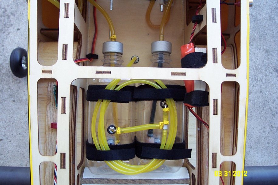

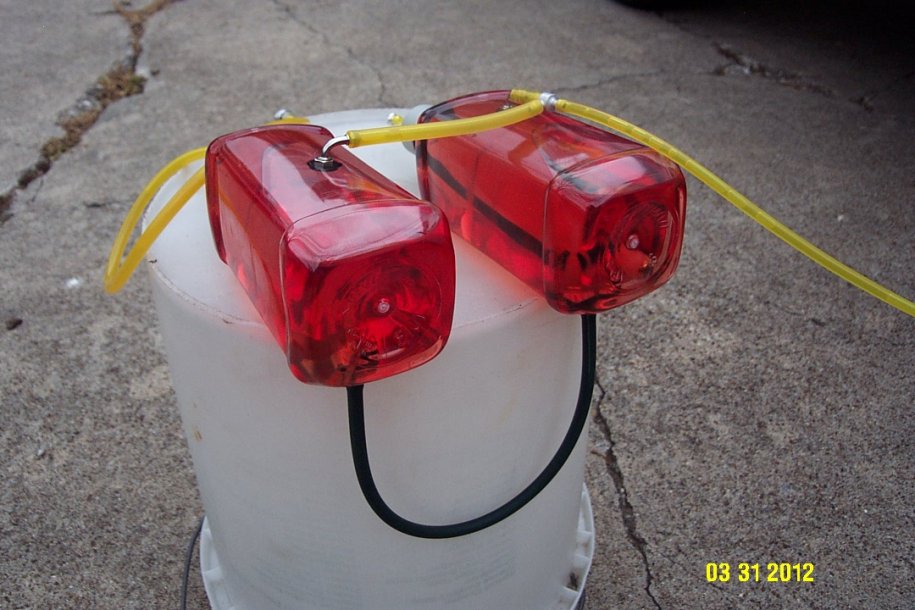

    I'm building a 1/3 scale super cub, and I'm thinking instead of having my 1 liter fiji bottle fuel tank sticking into the cockpit I was thinking about daisy chaining 2 500ml fiji tanks together up forward so that they're not exposed into the scale cockpit.
    Does anyone have any advise or expertise? or photos?

  4. I ran dual 500ml Fiji's on my Yak for a while. I think I have pictures and can email them to you.

    That would be awesome if you have pictures! Do the tanks feed as a "Y" to the engine?

  7. Bottle on the left has the fill line. Bottle on the right supplies the carb. The tank level is equalized via the bottom connection between the two tanks. This setup worked great but is somewhat slow to fill.
    dhal22 and fencelake like this.
