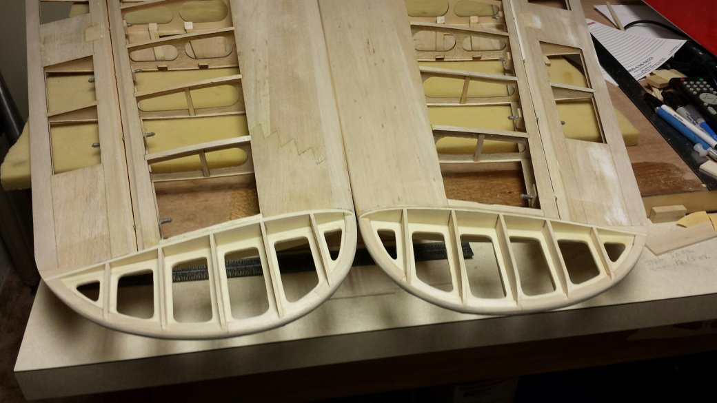

These are Aeroworks Yak 54 wings that I added a custom tip to for a project I'm working on. They still have the stock hinges glued in in this picture. The blocks are too narrow to just move the hinge over.
