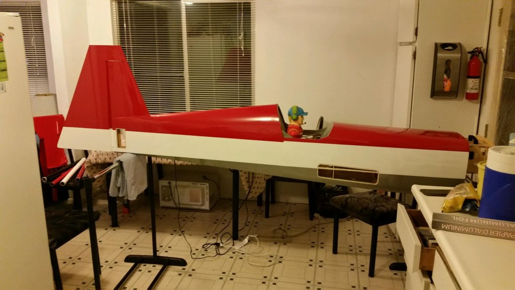

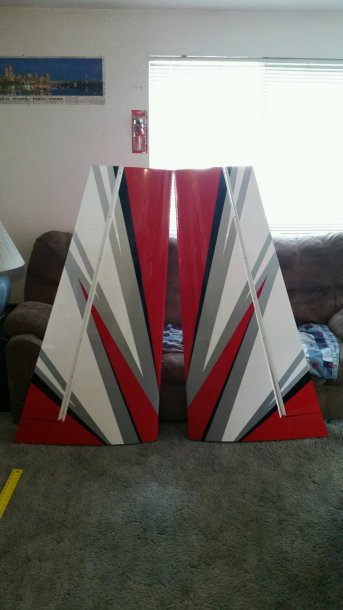

I must agree....there was a time of old that Ultracote and Monokote alike had issues. Especially since the EPA stepped in and forced them to make a change to the adhesive. But I do think it has gotten better recently. Maybe new developments. My son, @Shayne Epley is an absolute Monokote die hard fan. I on the other hand will never use anything other than "GENUINE" Ultracote. Not the cheap stuff some people call Ultracote, but the good stuff. I have seen seam creap. But there is a very easy way to keep that from happening. When covering, I overlap at least a minimum of 1/4". As well as if I know the seam or edge is going to be at a corner or an edge, a simple fold over then capped will absolutely stop that creap. Another thing too that might help, when wrinkles appear...as they always do, I will use firm pressure at the seam while gently heating to remove wrinkles. It is very true the Monokote has more brilliant colors.... And I have seen some really awesome covering jobs with Monokote. My son has recently been doing a complete recover on his 43% PAU Edge 540. Apparently the covering didn't like staying down and started peeling off after 40 flights. Including wings, front of fuse...everywhere. Soooo...off with the original and on with new Monokote. I must say he is doing an impeccable job. I just can't acclimate to the stuff.
