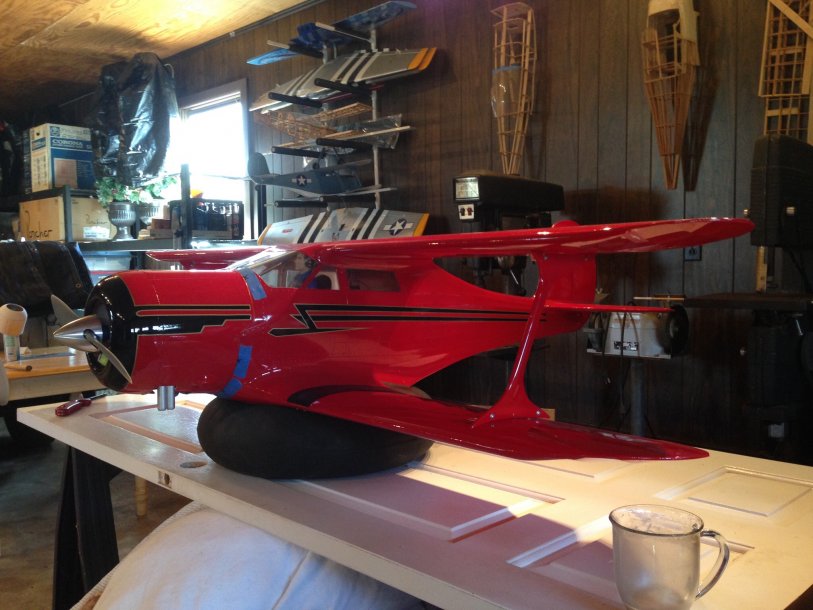

Completely unrefined...but it works.
Combination of a brace drilled slightly larger than the crankshaft and a 7.50 x 10 tube, coincidentally from a full scale Staggerwing. Have hundreds of these on hand.

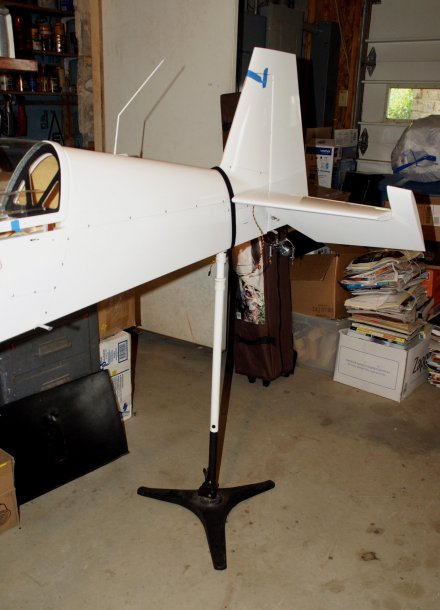

i'm dealing with a shop that is about 11x14 so I i'm trying to find something that will sit on the bench when I work on the plane.
maybe it's time for some copper tube and fittings?

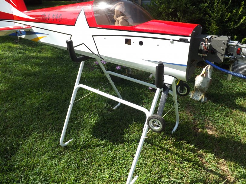

Bart a friend I help give me this stand, I have no clue who makes it, but it's nice. It took me 2 years to finally take it, as I thought it was for small planes, till I saw @Phil.Griffin post a pic of his, and saw that it was adjustable. I quickly ran over and picked it up. maybe Phil knows where to get em.
EDIT: I now see @Ohio AV8TOR already posted to link to this stand

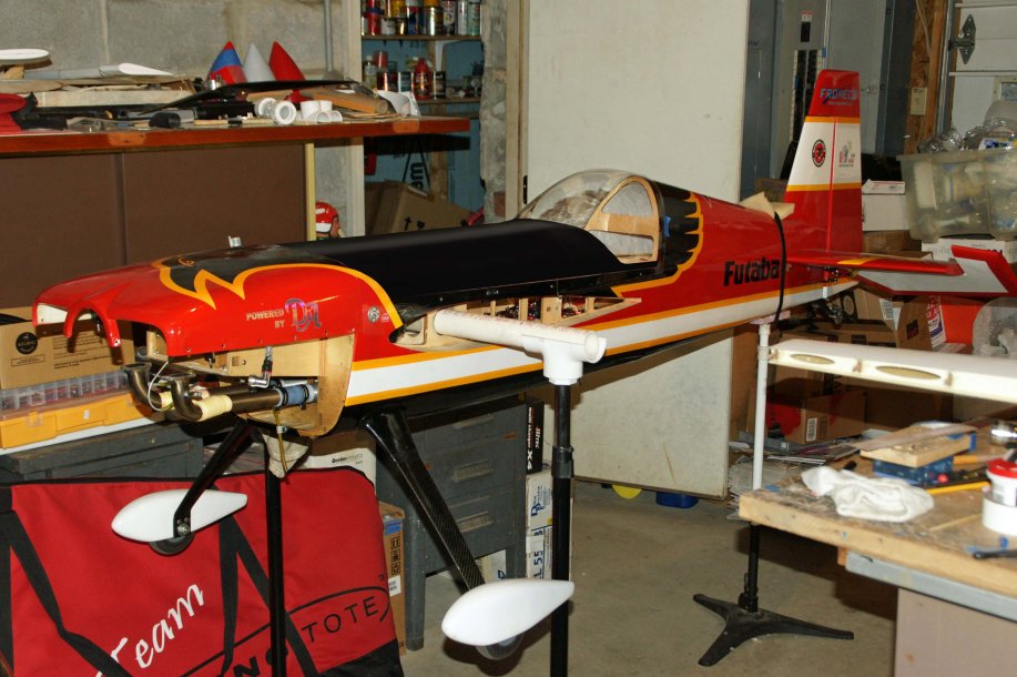

I used something like that (PVC) till I got this other stand, lasted long time, not quiet as stable, but worked.

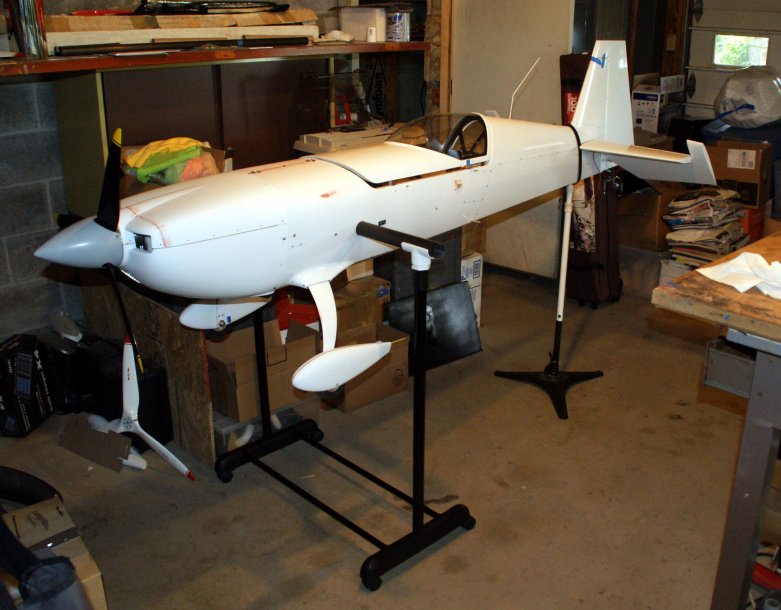

Here's my stand....have a total of about $12 invested. It's an adjustable clothes rack from Wally World. Added some PVC fittings on top of the verticals. Then slide a PVC pipe (or your wing tube) thru the fuse. I support the tail with an old music stand (freeby).
On my 35% Krill I can flip the whole plane over while in the stand. I can't do the Raven with the wheel on as they are too wide to go thru the verticals....otherwise it would do the same thing. Just make sure you have ceiling clearance for the tail.
Makes it easy to move around in the shop as all 4 wheels are full caster. just pick the tail up a tad and roll it.
