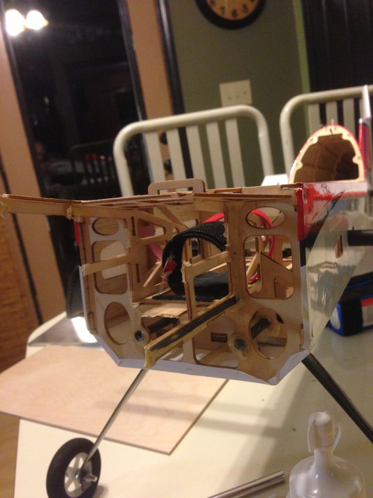

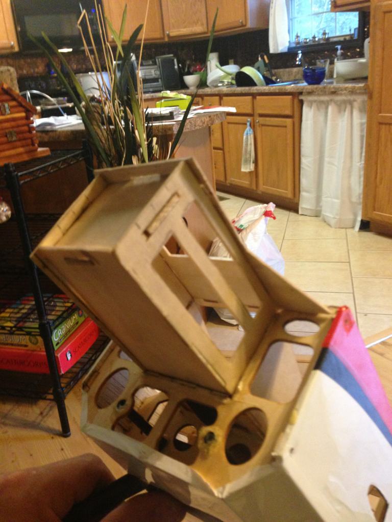

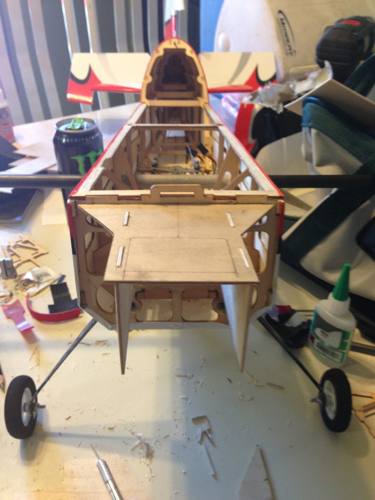

Before:
quadracer

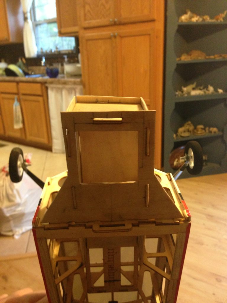

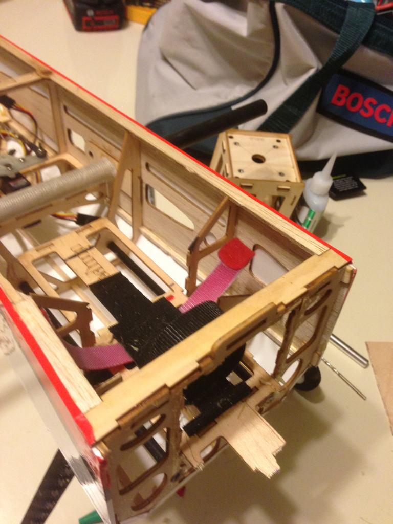

More "before" pics:

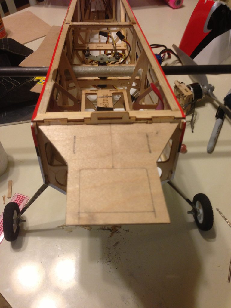

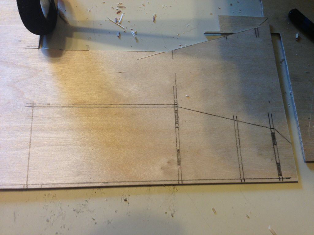

Laying out the top plate

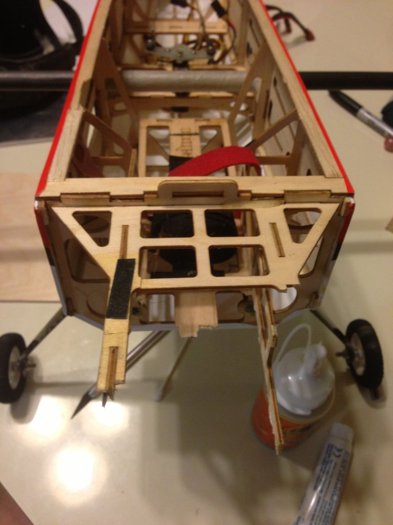

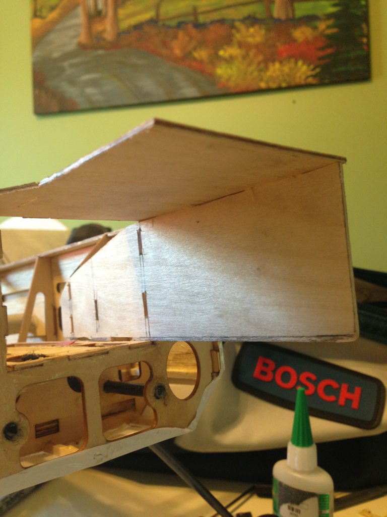

Dry-fitting the left side
Making sure the top and side mesh together well

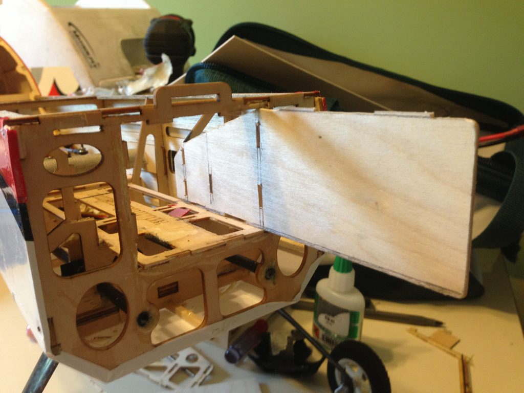

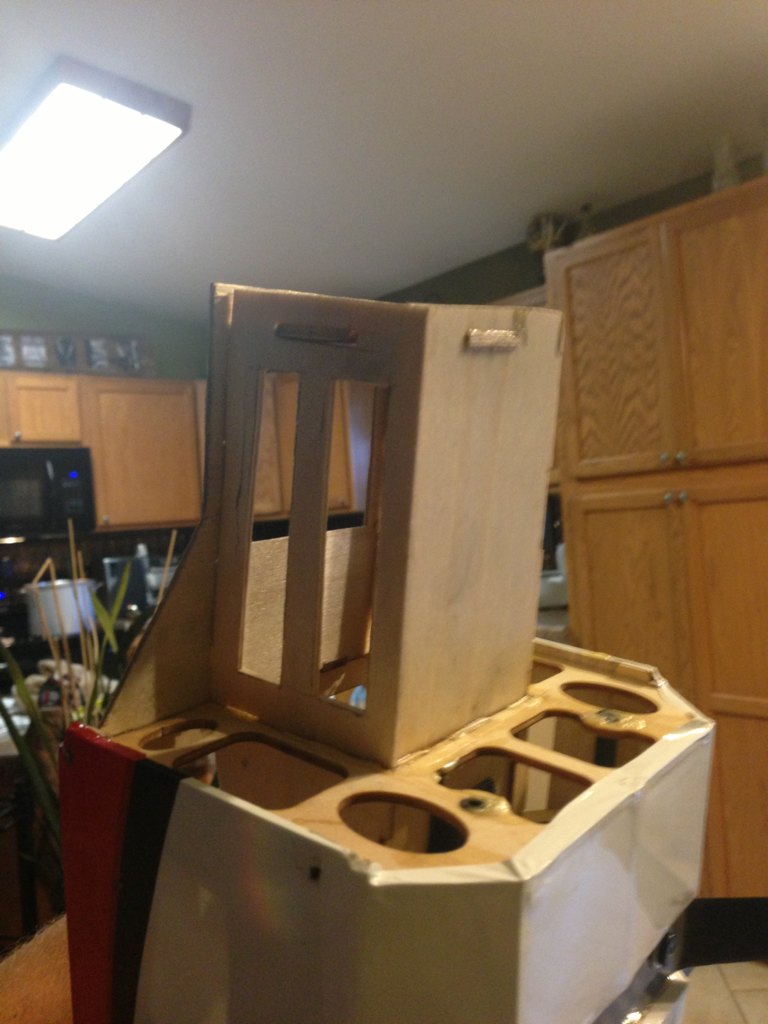

Right side plate layout
Dry-fitting top and sides
quadracer

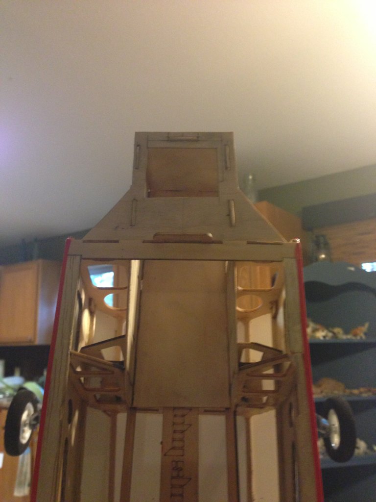

I only replaced back to the third former, since most of the load (on my setup and battery location) is centered over the first and second formers. Hopefully I'll get to fly it tomorrow and report back with good news.
quadracer
Finally got time to remaiden it a few minutes ago, 2 clicks of elevator trim and she was flying just like before! (Sans cowl, and with a busted up canopy..)
