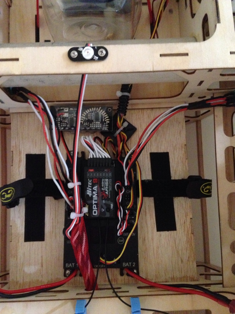

For all the flights that I had Savox in my 104, I had a single SB-2231 on the rudder. Worked perfect.
Just my advice, but on a big plane like this, I personally like a power box. Wolverine is perfect for 50-60cx (where I have them).
I'm using a RCCSKJ Power Board on my 104 and it works awesome.
It's got a really cool adjustable voltage output, and a digital display that shows your batts voltage, so you know if you need to charge or fly.
You can get one at [MENTION=2470]RedwingRC[/MENTION]
