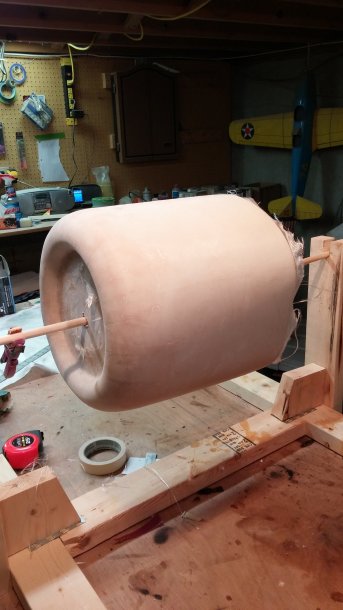

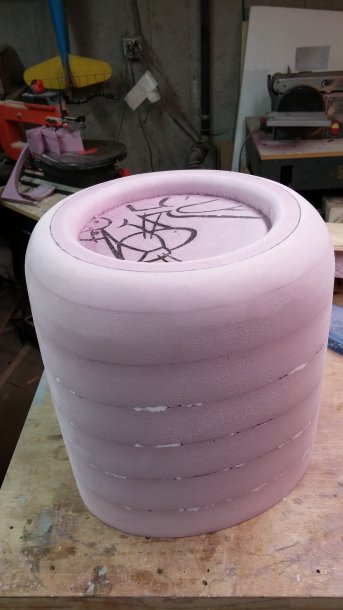

I wasn't able to find a cowl so I made a plug out of pink foam. I then covered it with Ultracoat light and waxed it 3 times. I'm laying down 3 layers of 6oz cloth using west systems epoxy. I'm lightly sanding between layers. I hope this works because I really don't want to do it again.
