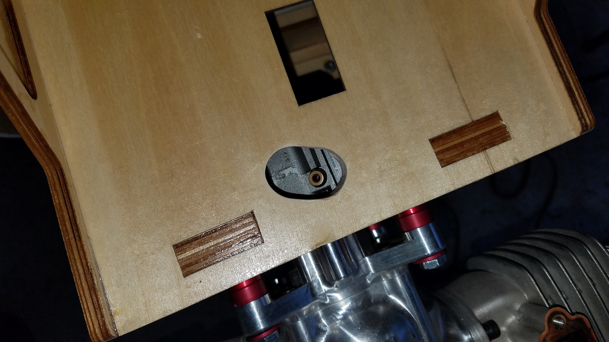

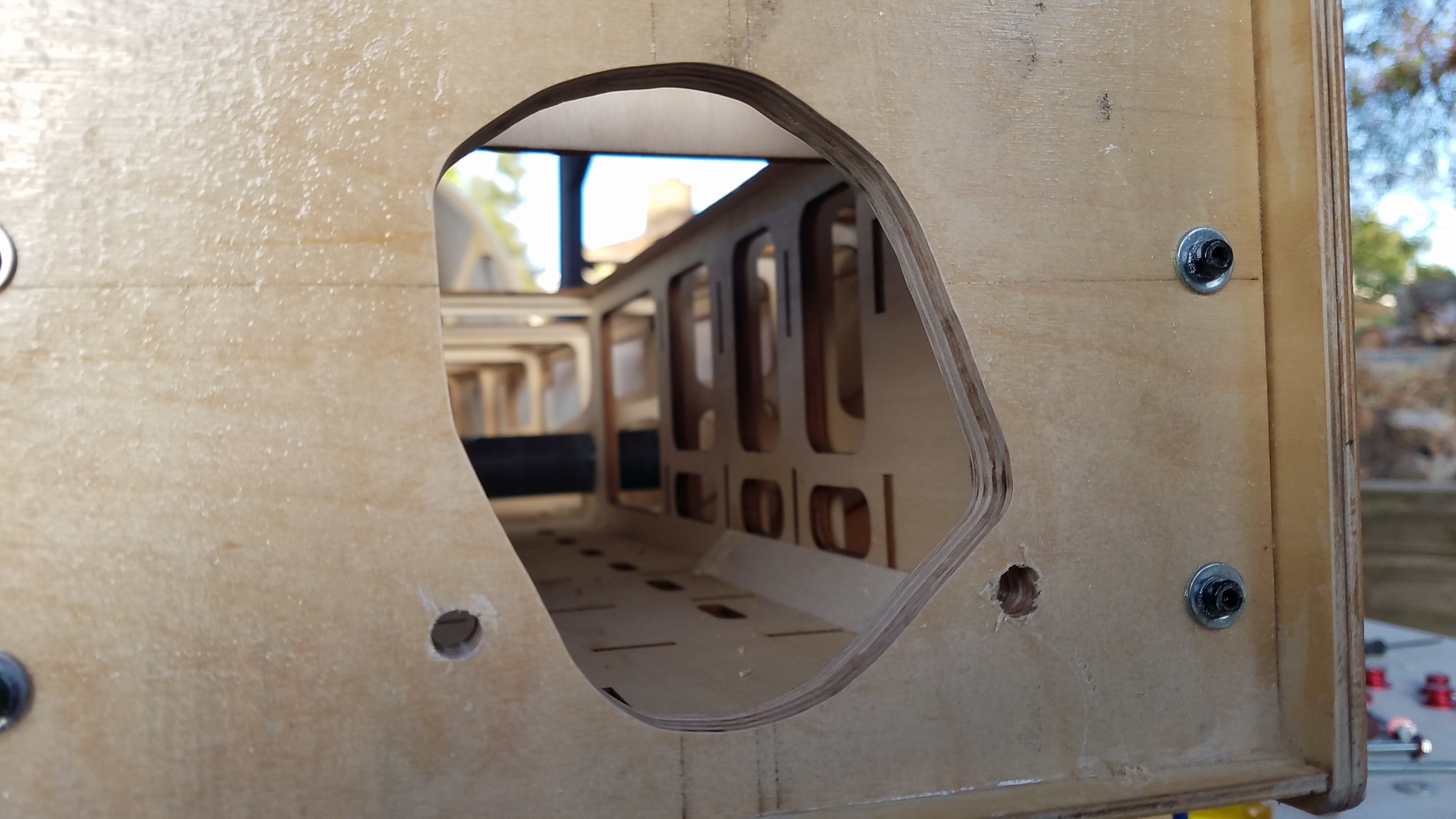

The carb hole is all cleaned up. The miracle dremel drums make quick work of polishing the imperfections.
Since the carb is inside of the motor box, the only way to access the fuel line is to cut another hole on the bottom side for the fuel inlet access. There's probably some scientific method to accurately find the exact location that you will need to cut, but I used the tried and true TLAR (That Looks About Right) method. As it turns out I was off by about half an inch, so I had to elongate the hole slightly.. :oblong:
Just more weight savings :cool:
You could just do some extra dremel grinding and cutting and throw most of that extra wood away :cool: :D
Remember @Terryscustom Laser pointer trick for marking holes in your cowl for the high and low speed needles. I'm sure it would do the trick for the fuel line location as well.
Xpress
The theory is sound, however the laser pointer trick works because you can actually see the needle locations beforehand, and point the laser right on them.
With finding the hole for the fuel inlet, it's a complete guess as you can't really see exactly where it's at prior to drilling a hole. Now that I think of it I probably could've drilled a tiny pilot hole first...
