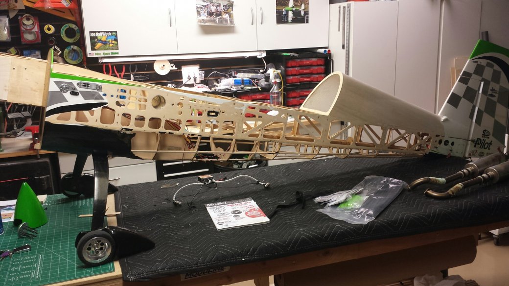

I started pulling some covering off before I had it fully disassemble just to get look at some old repairs. Taking the covering off is a slow job. You cannot just rip it off or it will take some wood with it and then there are the spots where it is melted into the wood. Be prepared for surprises :eek: after doing this enough times I have learned just how shocking it can be. I have come across areas that I have no idea how they were holding together. I was hoping to get most covering removed but due to a ANOTHER GP engine problem I need to replace an engine on the plane I plan to fly at the @Joe Hunt event in a couple weeks. I am so tired of getting a GP engine back from repair just to have another one go bad. I decided tonight I am replacing ALL my GP engines with ZDZ's in the next two months. Sorry to vent but I am so frustrated:devil::devil::devil:

I know the feeling man. When I restored an old kadet SR for a buddy the whole thing just about fell into a bunch of pieces when I pulled the covering off. Not sure how it stayed in the air.

I've been using my heat gun religiously to remove covering. Heat a corner, lift with hobby knife, hold gun about three inches from covering making paths back and forth and that stuff just lifts right off in complete sheets. No fuss, no muss. Even the melted into the wood covering comes right up leaving zero covering. Ultracote seems to come up better than Monokote, but both lift away. Just a thought in case you had not tried this.

I should have said using the heat gun makes it easier. When I really get into the removal I will be using it. It does cut down on the work.
