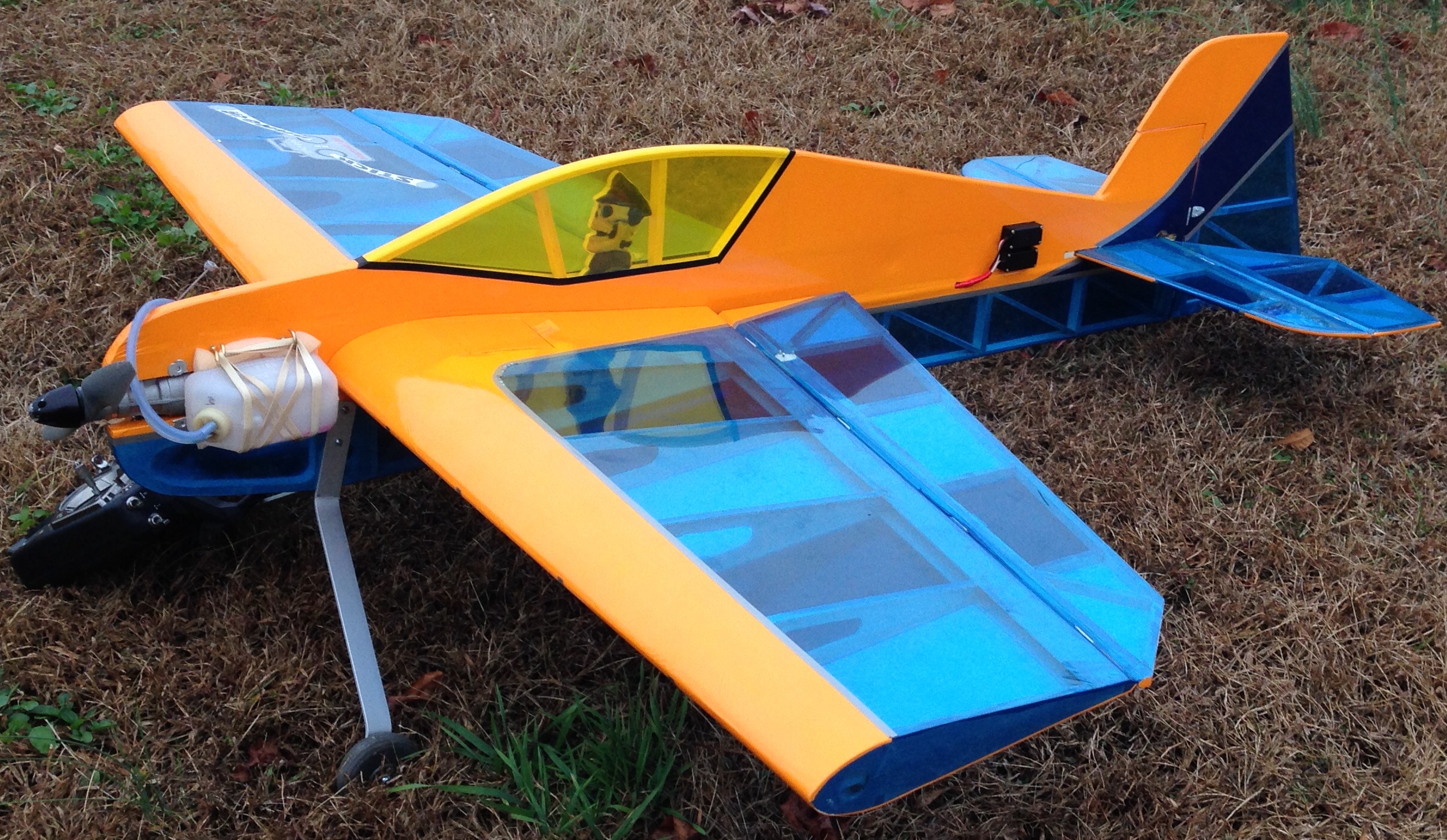

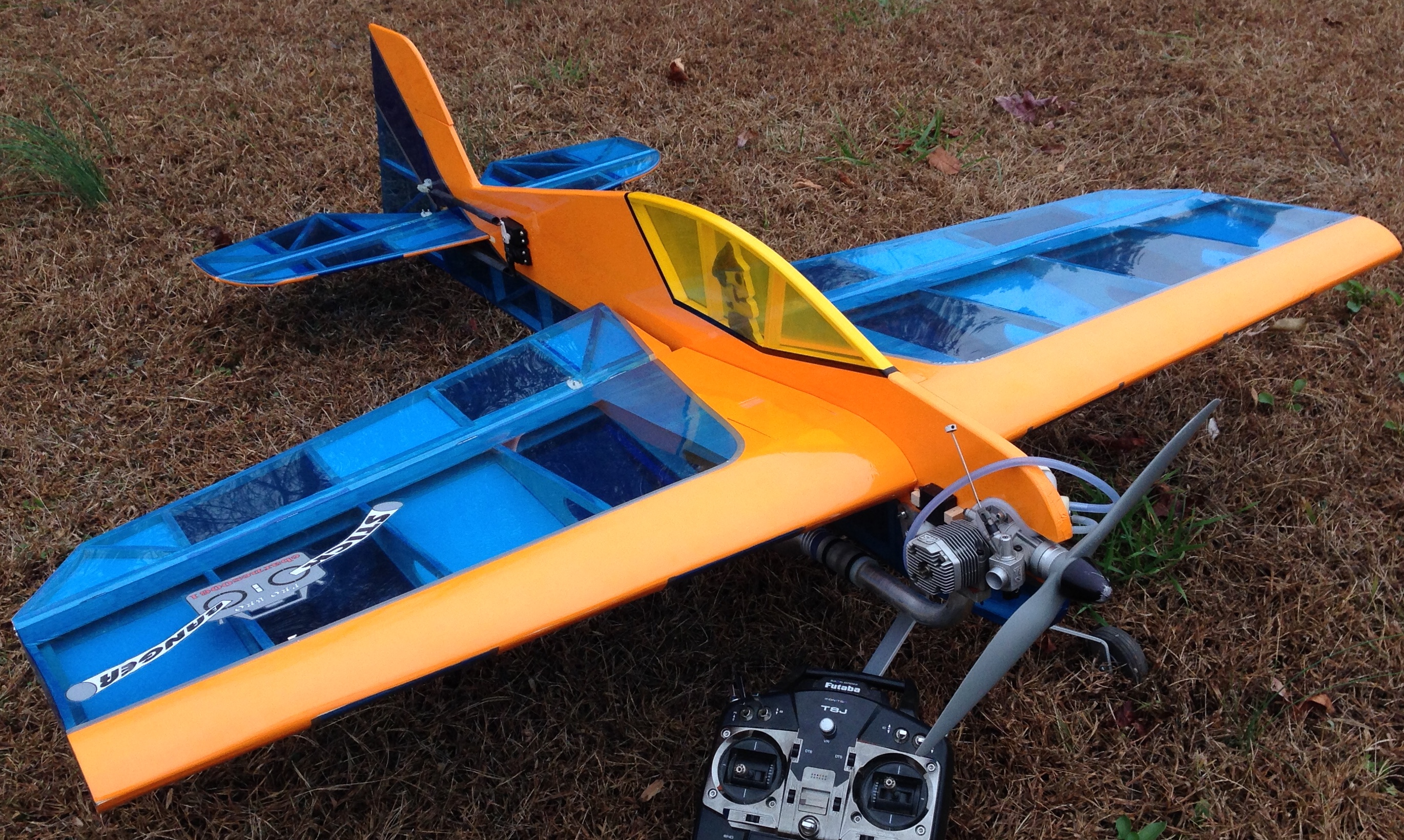

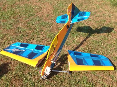

I plan to rebuild the wings for my sbach45 profile after they came off in flight on the maiden. Then I'm going to design and build a profile Super Chipmunk. Will be based around an OS 46ax with a tuned pipe for power.

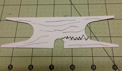

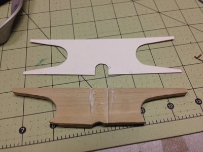

Poor build on my part. It is designed as removable wings and uses a joiner block instead of a wing tube. Joiner block was supposed to be made of 1/4" ply. I didn't have any ply so I made it out of 1/4" hardwood and under the load of a snap roll it quite literally snapped. I might have saved the other wing and not had to hard of a landing but the one wing that came off had my flight battery in it so the plane went in at WOT with a OS 55AX with a pipe powering it. best said she was humming along at a pretty good speed. Here is a link to the video and some pics of the joiner block and where it failed.
