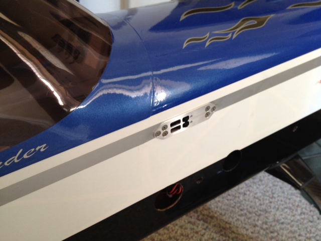

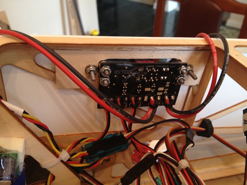

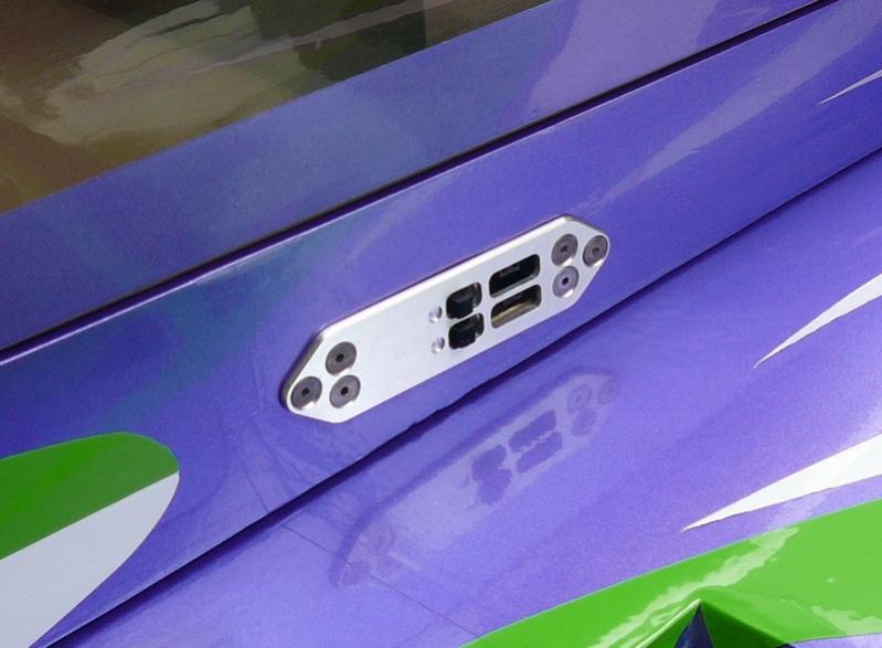

For those finding building a battery share device more than they want to bargin for or don't trust their soldering should look into a Wolverine Switch. Lots of great feedback on GiantScaleNews. It is 2 solid-state 'fail-safe' style Switches, bright LED on lights, 2 simple Charge Jacks, and advanced battery redundancy (sharing) circuitry and you can order it with however many open receiver slots are open. I am using 3 receiver power inputs with it on mine.

Thanks. I did add one more from my 87" SHP. The inside view was taken during my build but I have since placed some 1/8" foam that has a stick back on the back of the circuit board. Probably not needed but seemed exposed to me.
