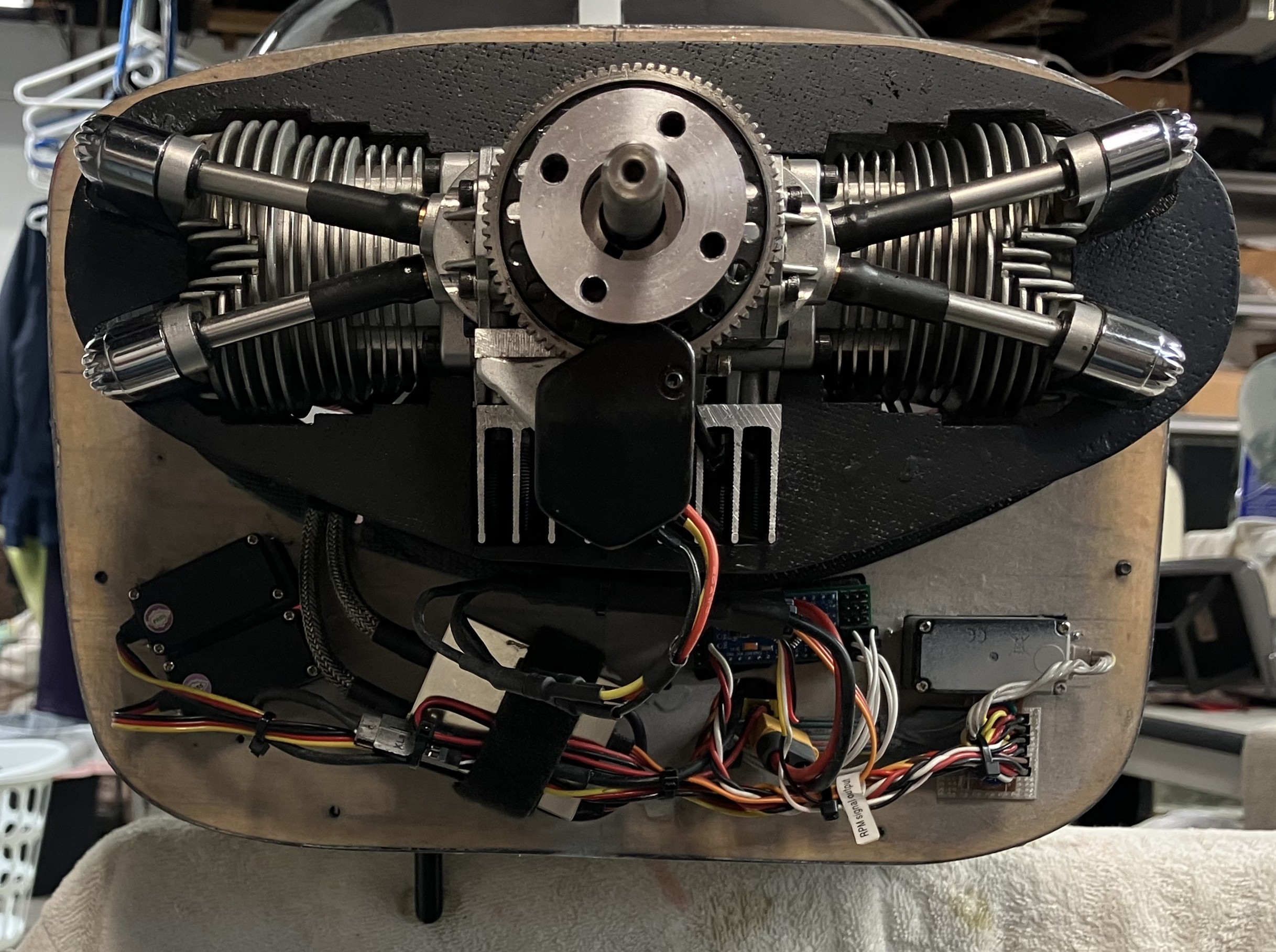

Just thinking out loud the acrylic enamel paint I used was cheap but possibly heavier than aircraft paint. I may use Aerothane or Ranthane on the next one. For the white I used a white sealer and the plane was covered in one coat, I left a bunch of orange peel that could been flowed out on a second coat, the orange peel was color sanded and compound polished. I have a note on the wings stating painted 16.5 ounces but I'm sure just what I said!
The starter adds weight, probably 8 ounces considering the battery and controller.
The redundancy bus adds weight guessing 4 ounces but It allowed the receivers to be moved outside the carbon fuselage.
The full interior and dash adds weight.
At the end of the day just build as lite as you can and hope for the best!
