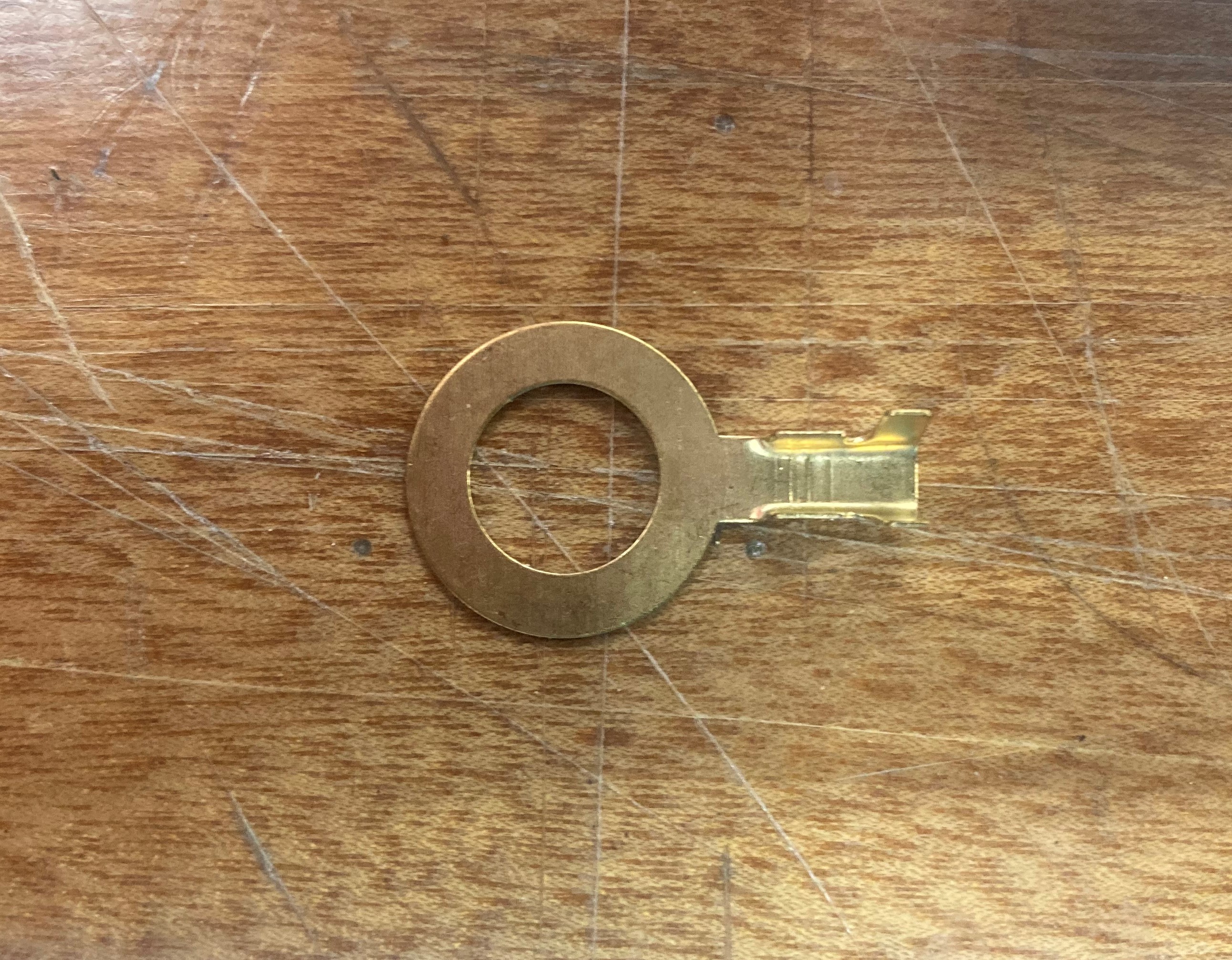

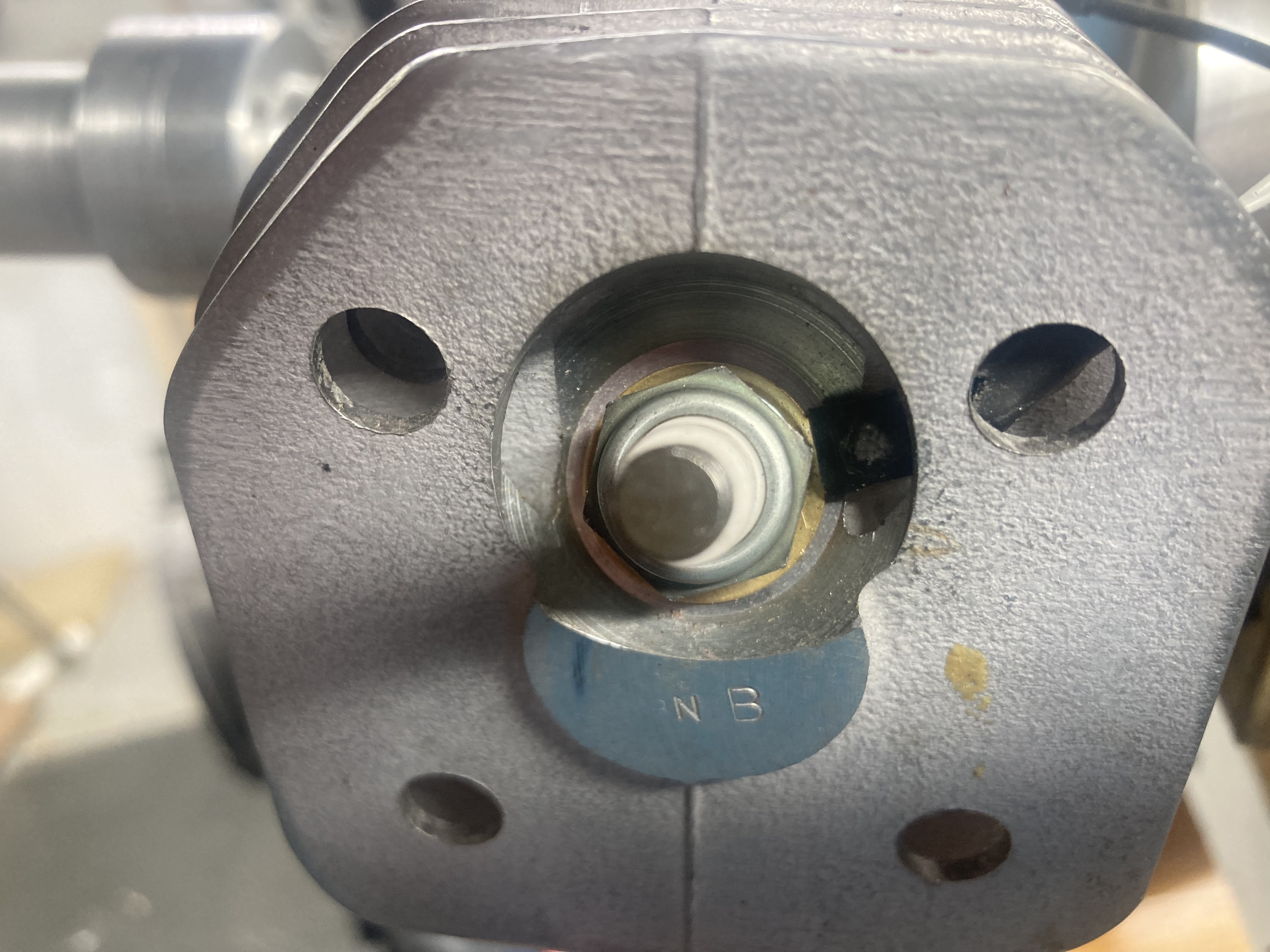

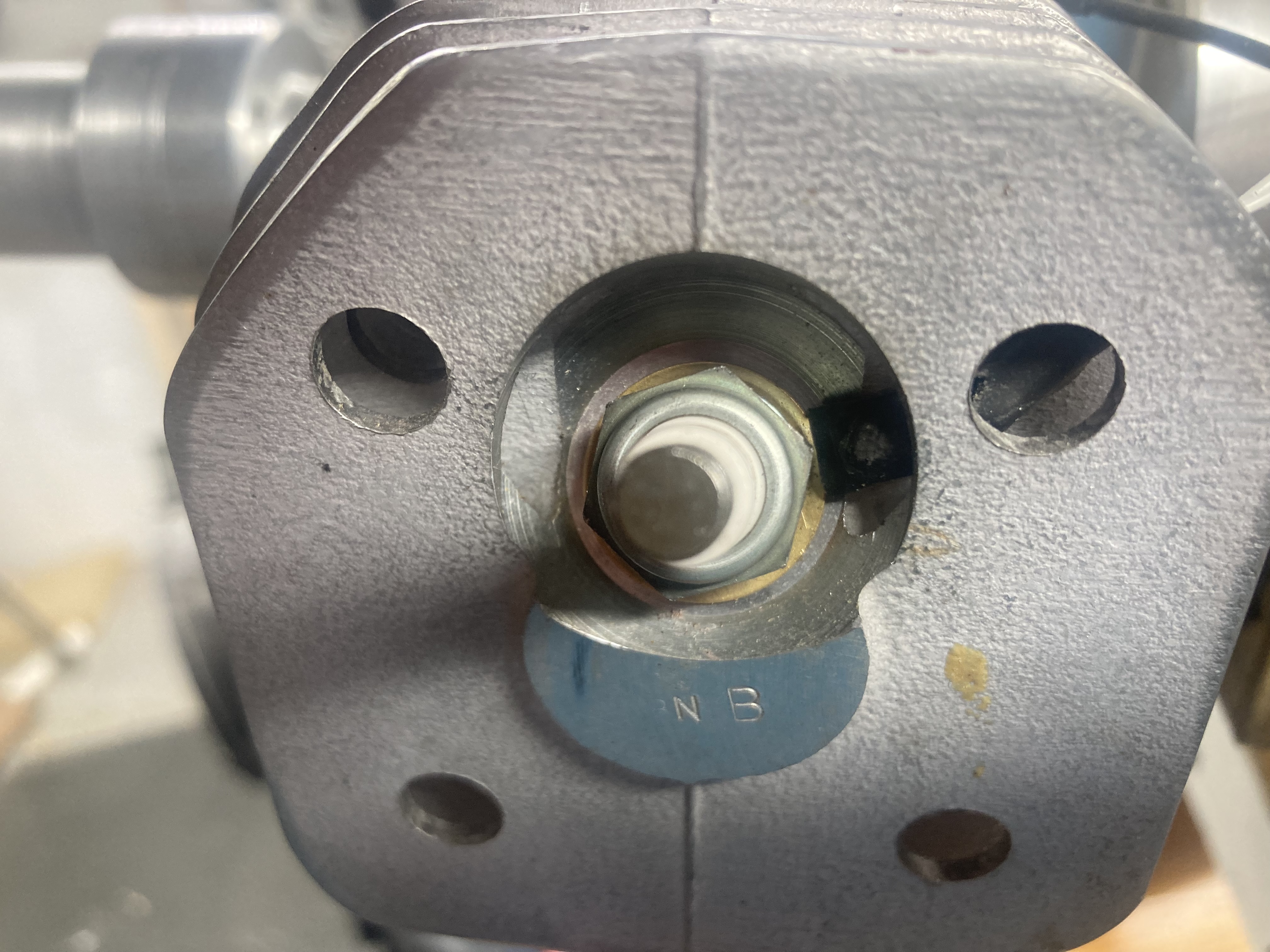

What changes? It's all there now. The lug below accepts a CM6 plug, the thermistor bulb are crimped in the lug and a little heat shrink tube and you have plug indication. For 1/4"-32 plugs I use a 10-12 gage 1/4" lug. How many temps do you need? You can daisy chain FrSky SP-RPM RPM/Temp sensor to get as many as you need, two temperature sensors per device, you must change the channel so that each device is unique. I have both plugs monitored and will measure incoming and air leaving on the plane I am currently finishing up. The sensors were in the Cherokee

I'd be curious to know who makes your ring style temp sensors? I fabricated my own just like Tony mentioned above and they work just fine. Something the radio manufacturers won't tell you is how simple those probes really are. They want you to think you have to use OEM parts in order to get that special magic only they have. Bottom line is the probe is most likely either a K or J type. That dictates the wire type which should be maintained all the way through the circuit. But I'll wager every radio stops the different wires at the plug.
