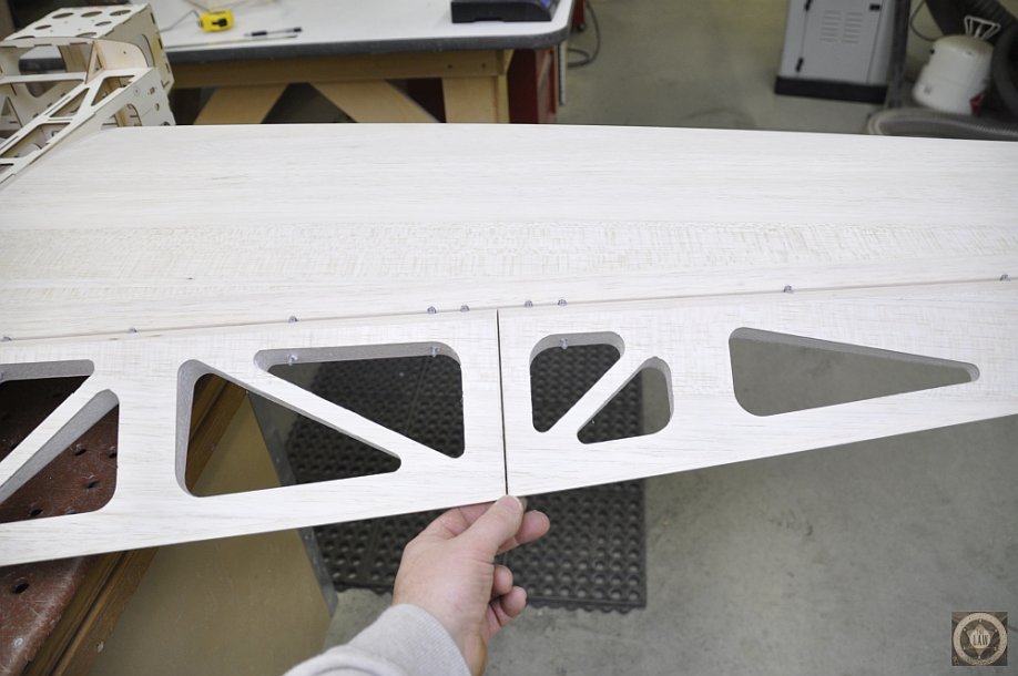

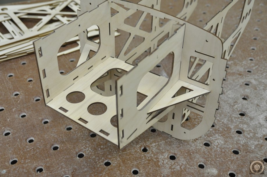

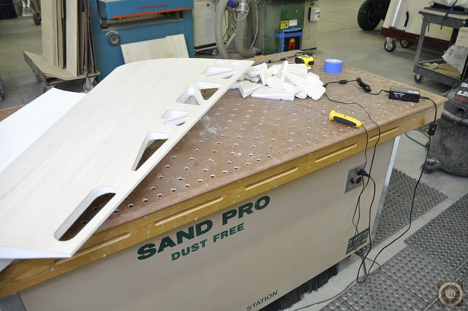

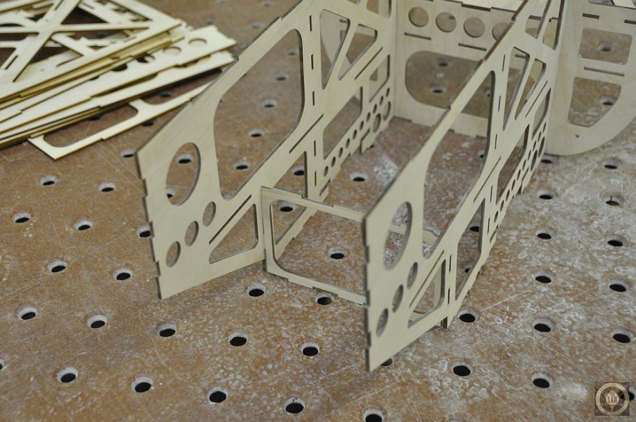

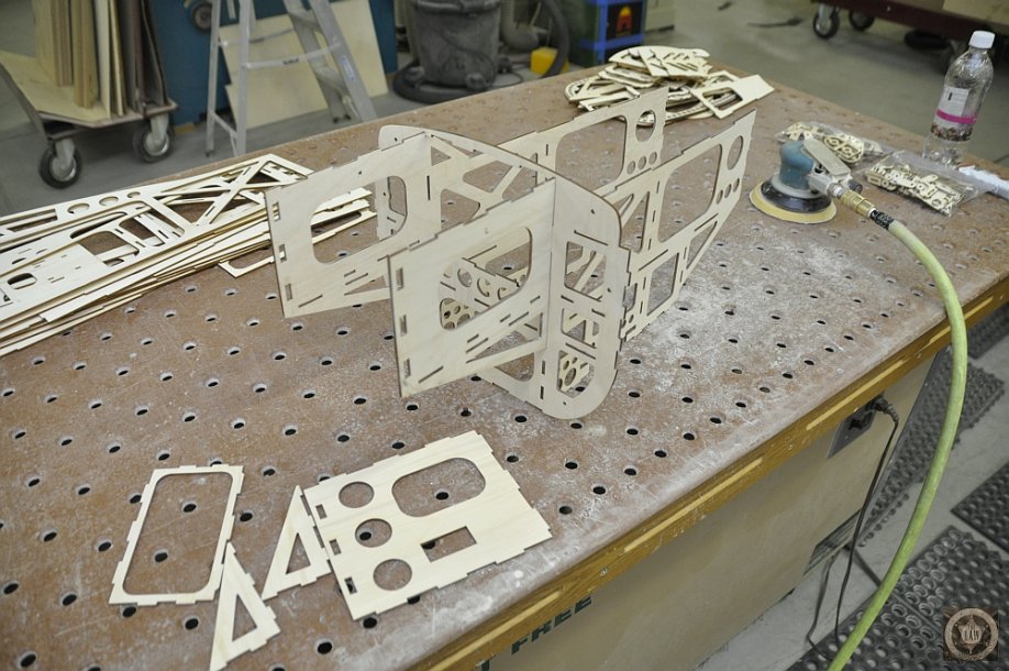

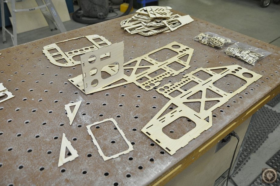

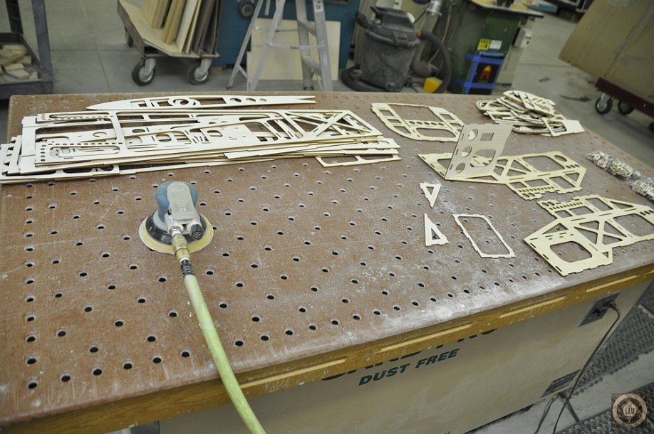

As mentioned back at the start of my build, the birch parts are slightly thicker and require just a little sanding to fit properly. I sanded both sides and then hit the taps on these parts until they all fit together perfectly. The parts shown in these pics are the main parts that should be pre-fit before starting to assemble. All of the lite ply parts will fit in the slots without sanding.

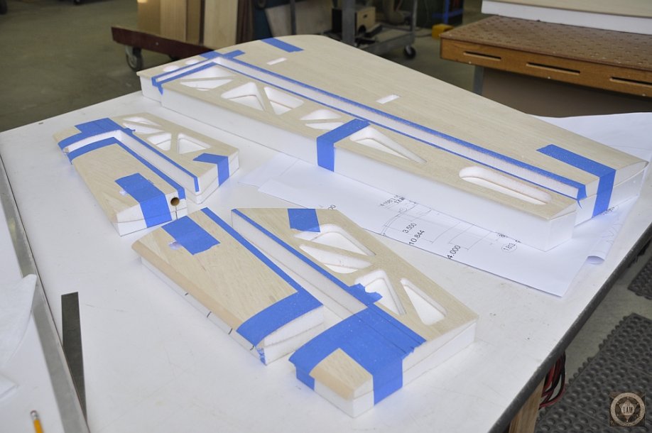

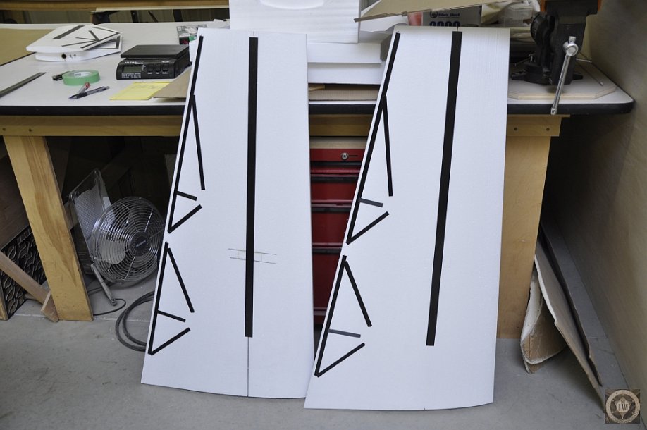

Good man, you'll love the vacuum system!!! I do hope you'll post a few pics along the way on the Hyperlite thread! I started the thread when the website just started so I did not do a lot of description, but here it is: http://giantscalenews.com/threads/fibertech-hyperlite-slick-sort-of-build-thread.157/

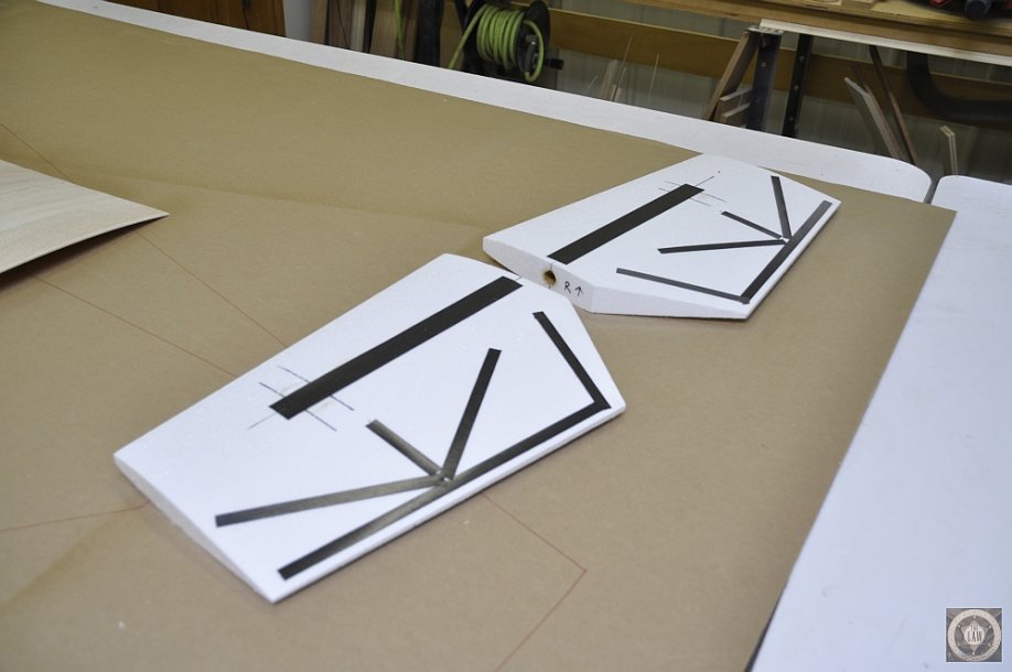

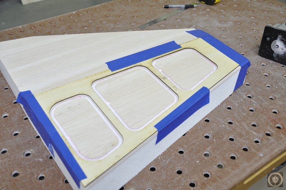

I did some carbon layup on there but here are some pics form my Viper #3 build from last summer. What I use is .007 unidirectional carbon from here: http://www.acpsales.com/.007-Unidirectional-Carbon-Fiber-Laminates.html You can either install it with resin at the same time as sheeting or you can install it with wood glue and during the vacuuming resin will be drawn around the backside of it. Check out page 38 of this thread where I start the sheeting process and talk about the carbon and how I use it. http://giantscalenews.com/threads/viper-st-100-120cc-scratch-build-it-continues.884/page-38
Here are a few pics from the yellow Viper, I plan to do this again on my next build as well since the first tests have been performing great.
