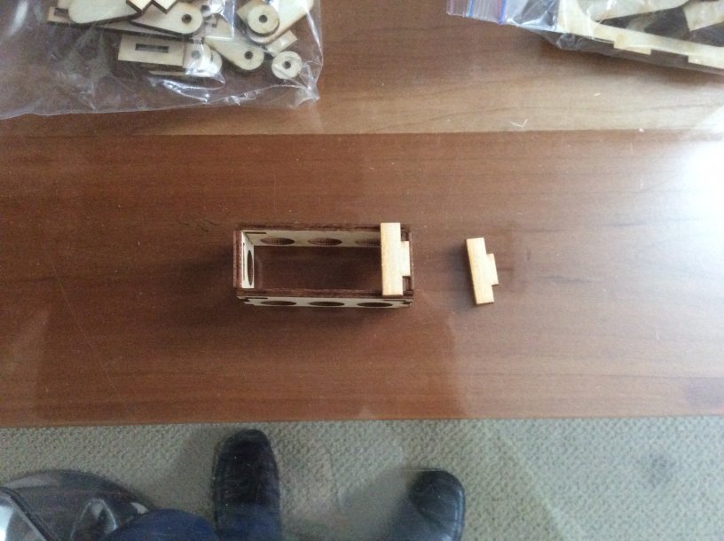

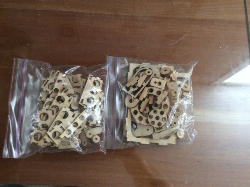

@Terryscustom could you please clarify this for me. Started doing some minor assembly on the V-St. The two attached photos show 2 bags of parts. Would like to build the servo boxes just to get started on something. Shown on the second photo is the box put together from the one bag but not glued. Laying on top is a piece of plywood shaped like a "T" from the other bag does this T go with the servo box. Or does it fit in another location. Tanks.

Terryscustom
Yes, back in the thread I show the boxes assembled and you should put some tri-stock under that portion for the servo screws to go into as well.
Found it for you but I encourage anyone building the plane to read through the thread, I took pictures of every conceivable part of the assembly: http://giantscalenews.com/threads/viper-st-100-120cc-scratch-build-it-continues.884/page-43
Those building the plane, the best place to start is page 21 of this thread. GSN did some switching so some earlier pics were lost and I actually started a second plane at page 21.

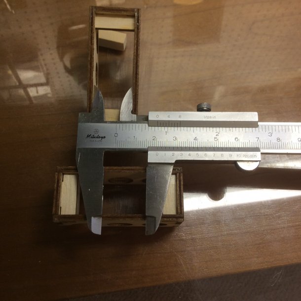

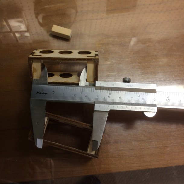

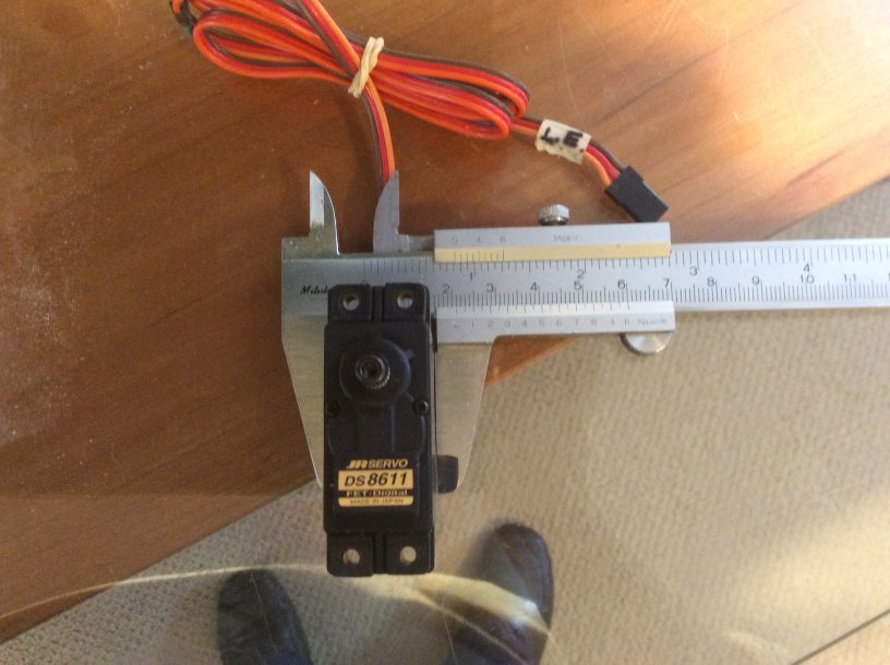

Hi Terry thanks for the reply. Would you be kind enough to help me out as you can see from the attached photos my servo does not fit the servo boxes. Need the box to be 21.3 mm wide they are at 20.3 mm wide. Second the length is 41-mm long and need it to be 42-mm long. Would it be possible to cut me a new set of servo boxes for the plane. Please let me know how much that will be. Thanks.

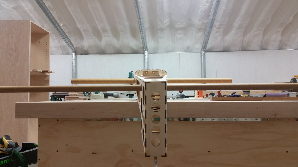

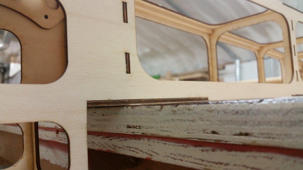

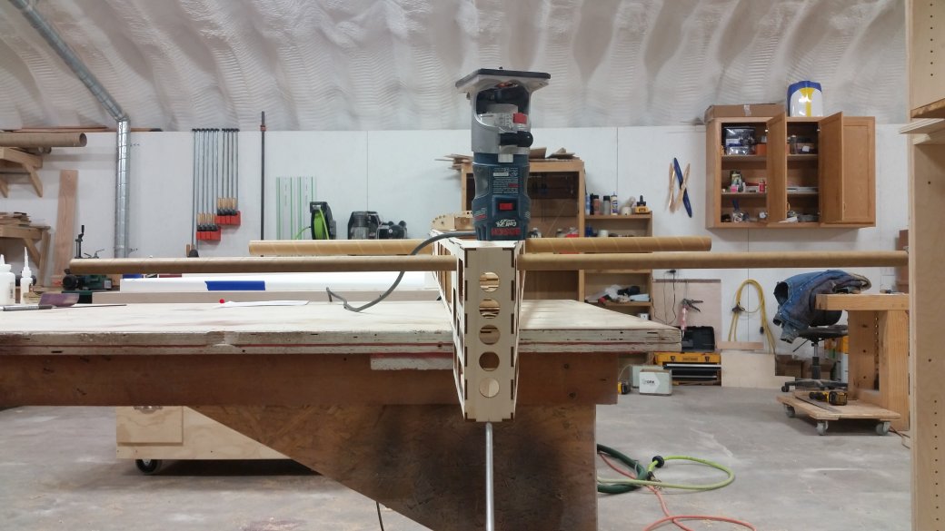

@Terryscustom I was working on putting the wing tubes in and I run into a bit of a problem. I haven't glued anything in yet. I have got them level with the top of the fuse, but when you sight down between the main wing and the stab they are off. I must have a slight twist in the fuselage. When its setting on a table the one corner is raised up just a bit, and when I bring it down to the table than the tubes line up. I tried to get some pics of the problem. Any thoughts on what should be done?
