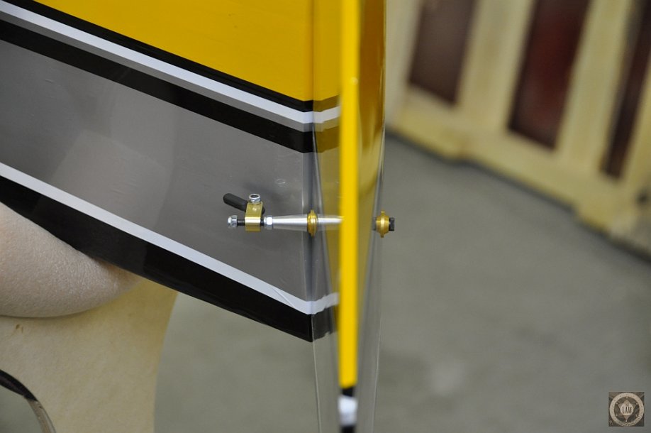

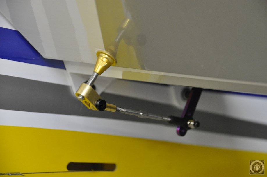

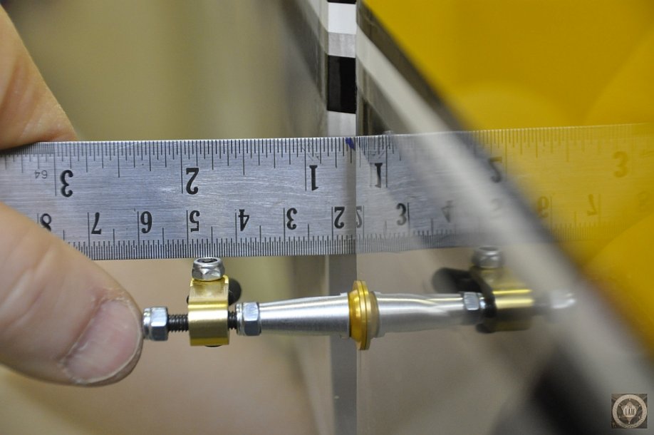

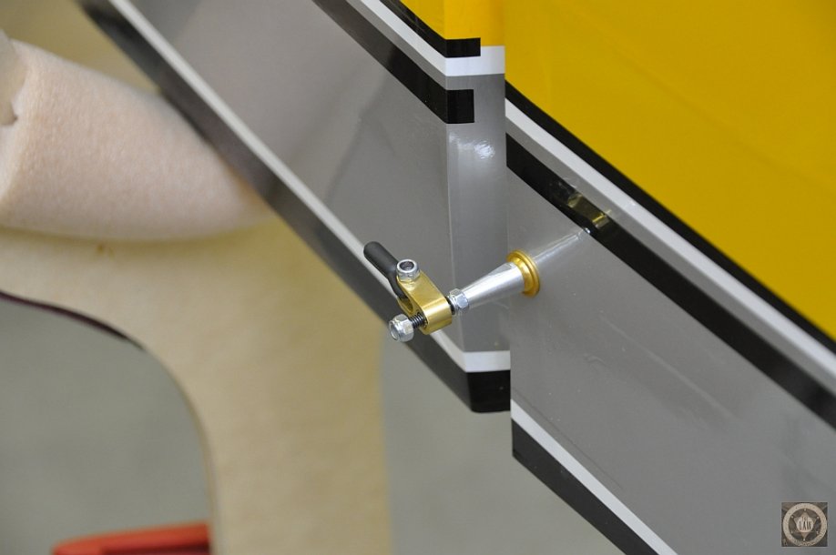

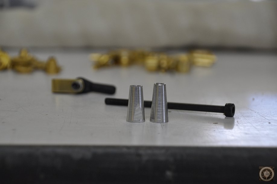

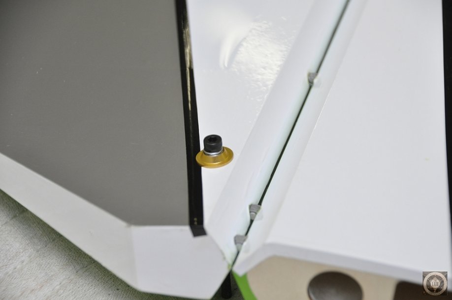

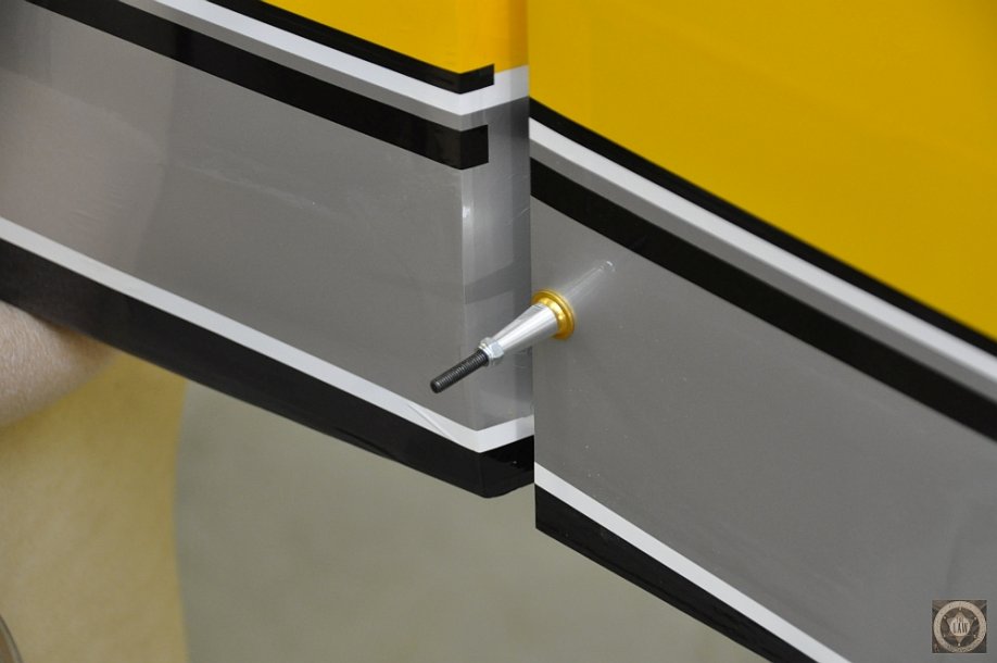

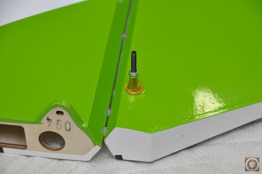

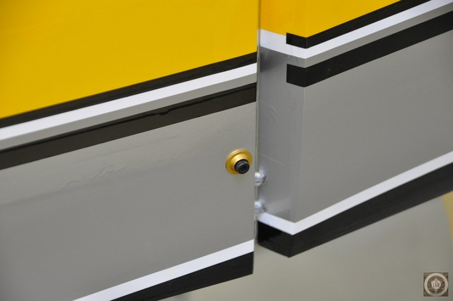

OK, as noted in the video there was just too much to type to clearly describe so please check that out first.
I will note that after shooting the video and installing the hardware I used the following on my horns:
4M x 65 on the elevators and aileron tips
4M x 70 for the aileron roots
4M x 80 for the rudder (if using push/pull config).
Again, this is not necesarilly the "recommended" setup, but it is a bulletproof setup. Please watch the video for options for full details on "stock", "modified" and "full custom" installations and use the one that suites your needs and abilities. They will ALL works great when done properly:198:

here is a few things you can do differently loctite makes a wicking grade thread locker for assembled fasteners
it is very thin you can load in a syringe and dot on stuff that is assembled i love the stuff we use it in industry a ton
also to make a tap you can take and extra bolt and cut flutes in it with a dremel and a cut off wheel ahain something i have done many time to chase threads and will work on soft material or to clean up chewed threads
