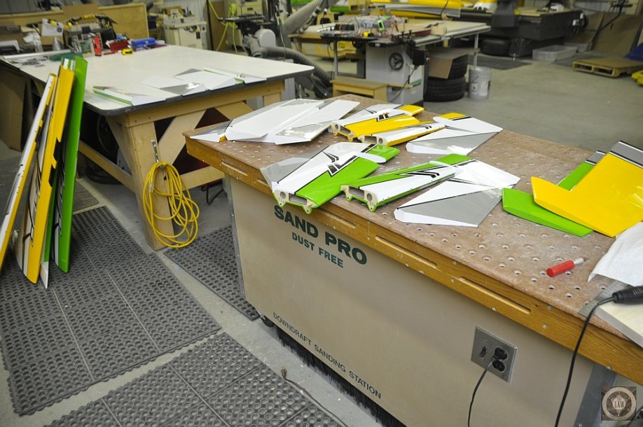

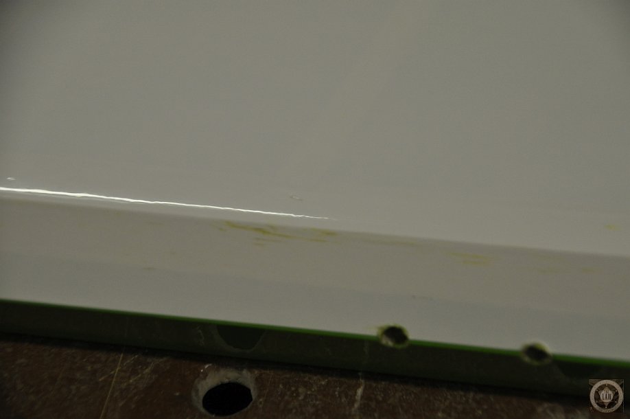

Nothing too exciting on day one of my build(s). Pretty much cleaned the shop up a bit and started ironing. LOTS of ironing.

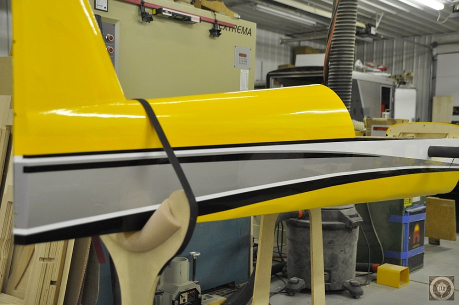

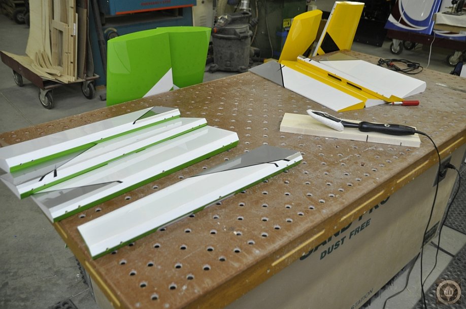

Since pretty much all the stripes are covering over covering it is important to iron over all of these. If there are bubbles, poke them with a brand new xacto blade and iron over them.

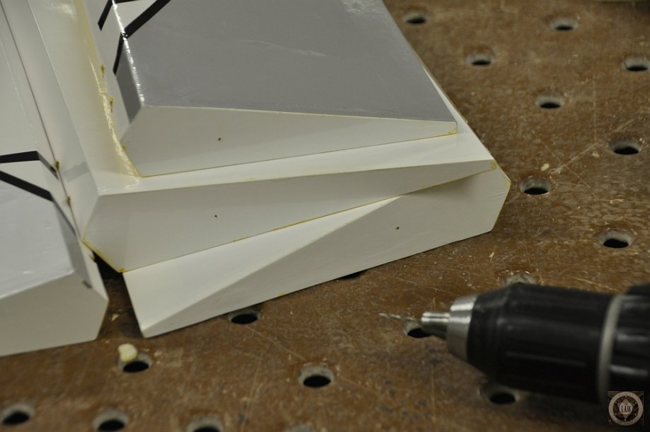

One quick tip is to drill a 1/16" hole on the root side of all the surfaces and on the bottom of the rudder. This allows the plane to breathe and keeps the surfaces from ballooning up in the sun, or when you iron over them.

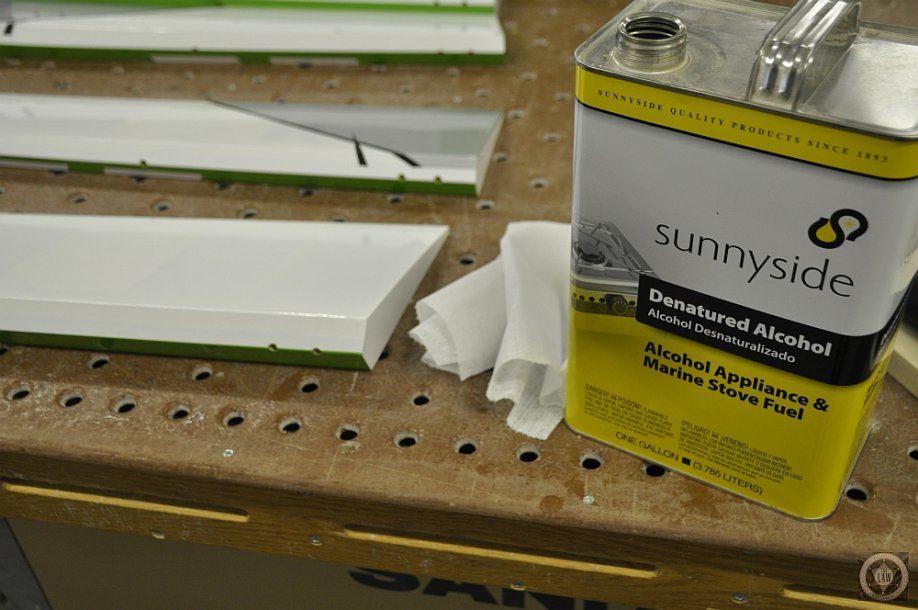

During ironing you will likely get some colors smeared from heating the edges. To clean this up use Denatured alcohol. Acetone works faster but Alcohol will not harm anything and does a great job.
Take your time ironing and you will be rewarded with a great smooth finish.

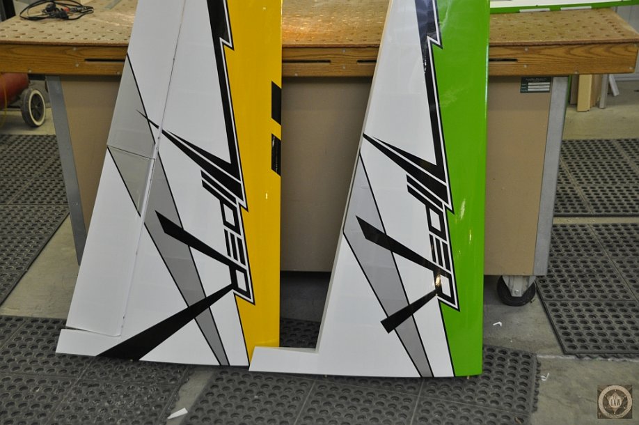

One mod that we made was to trim off the leg of the "R" on the left wing. This is not symmetrical with the right wing and I prefer it without the leg. Greg and I also decided that the white stripes that wrap up around the top of the wings looked out of place so I removed his. It's not so bad on the yellow scheme so I left mine alone for now.
