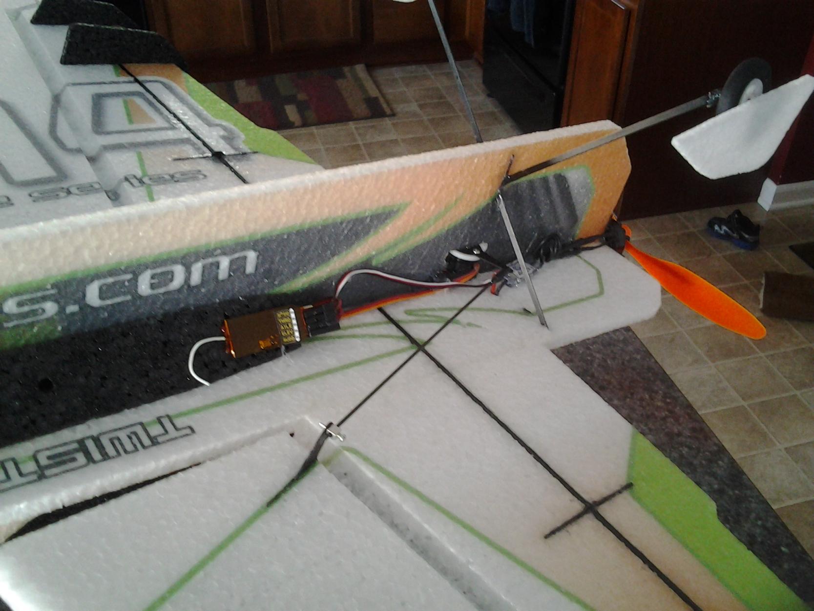

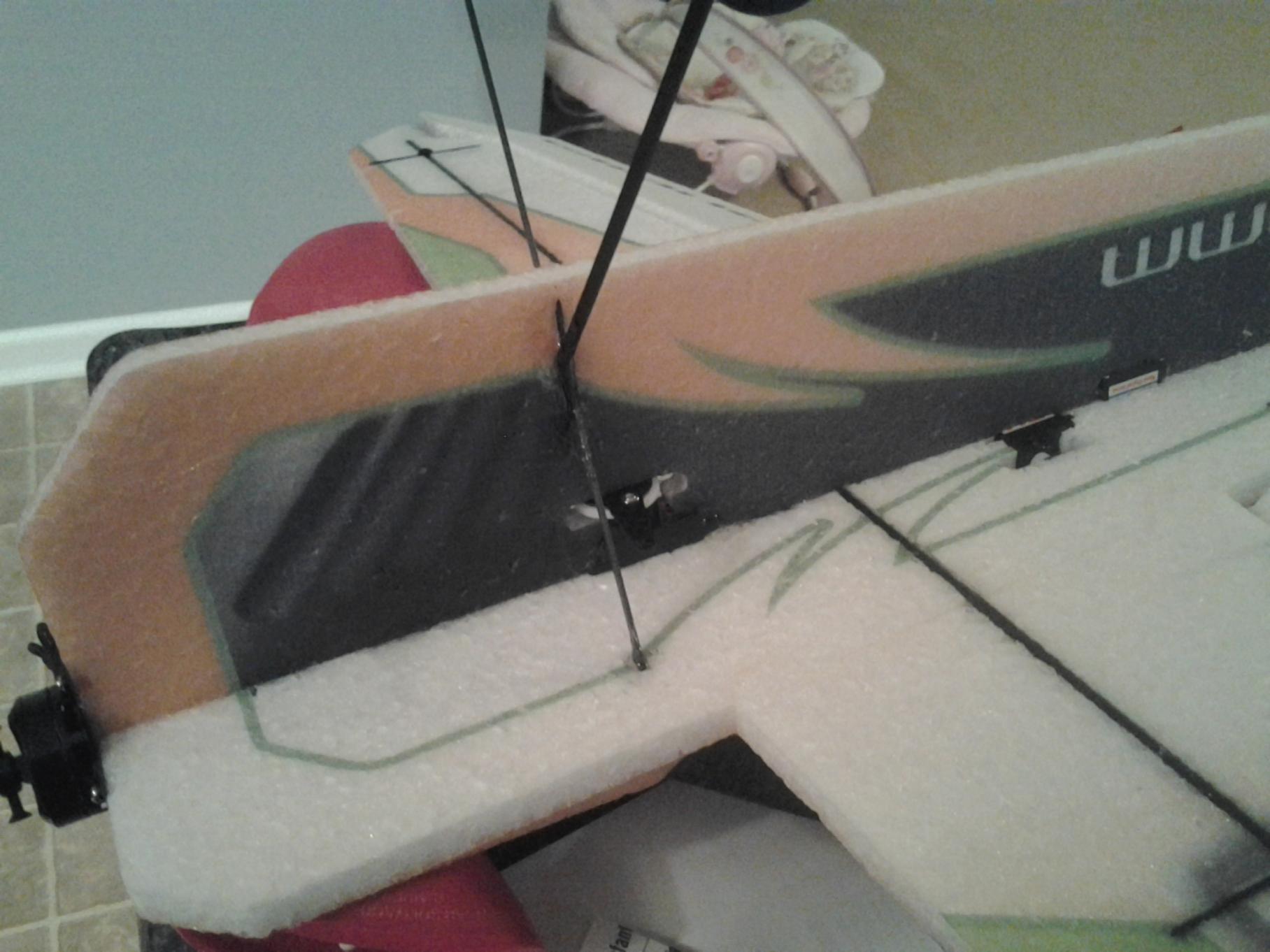

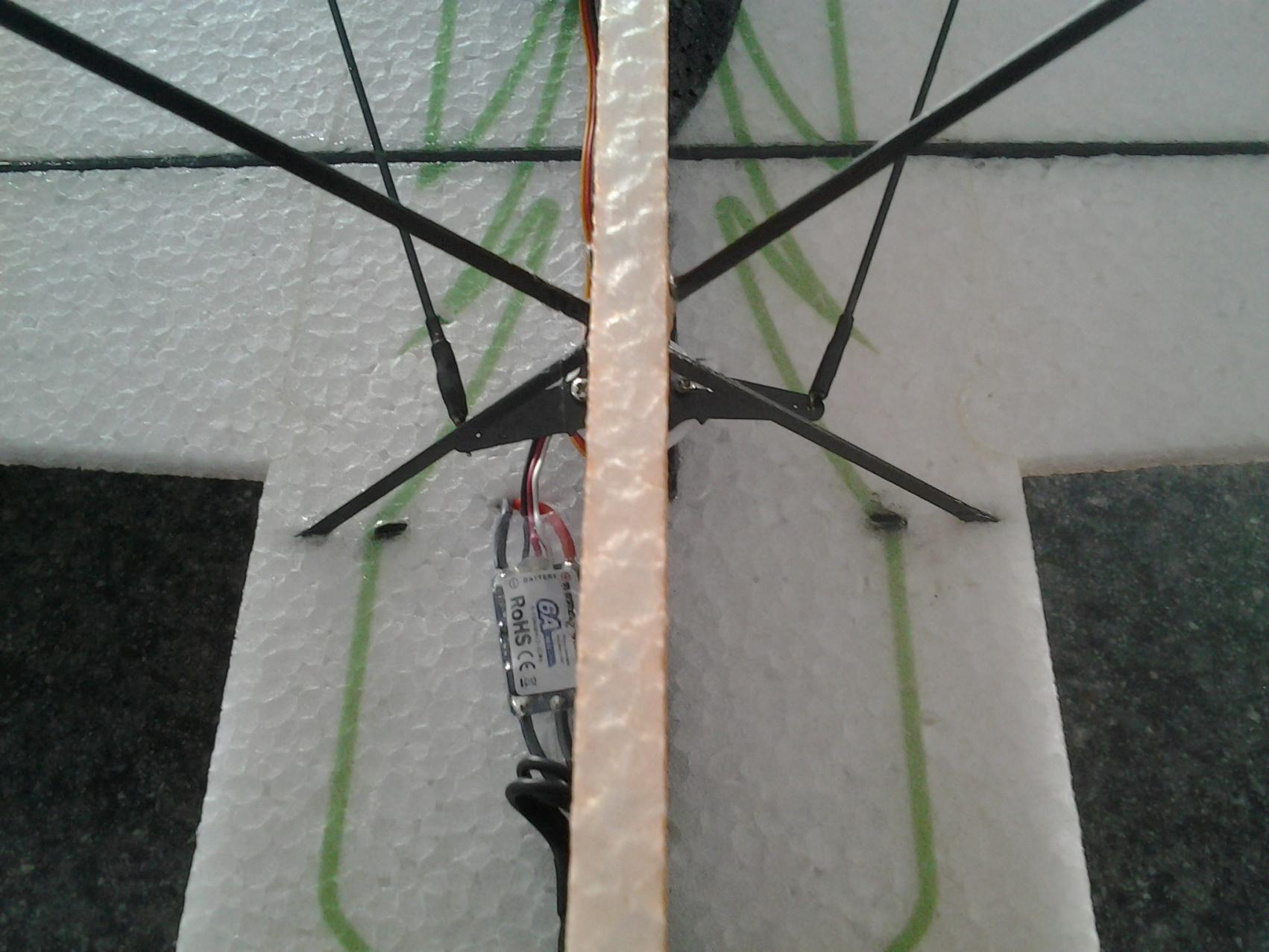

This is the first time I have done the Carbon kit and I really like it. The control horn extensions were easier to mount on the plastic arms because I wasn't worried about breaking or cracking them. This TH plane uses a carbon round stock spar and the lasering in the carbon braces had super tight tolerances which allowed for a pleasantly snug fit. I did have to wallow out the holes a little bit to make it easier for the long carbon spar piece to pass through the center braces. I did this with my hobby knife. It was quick and turned out great.

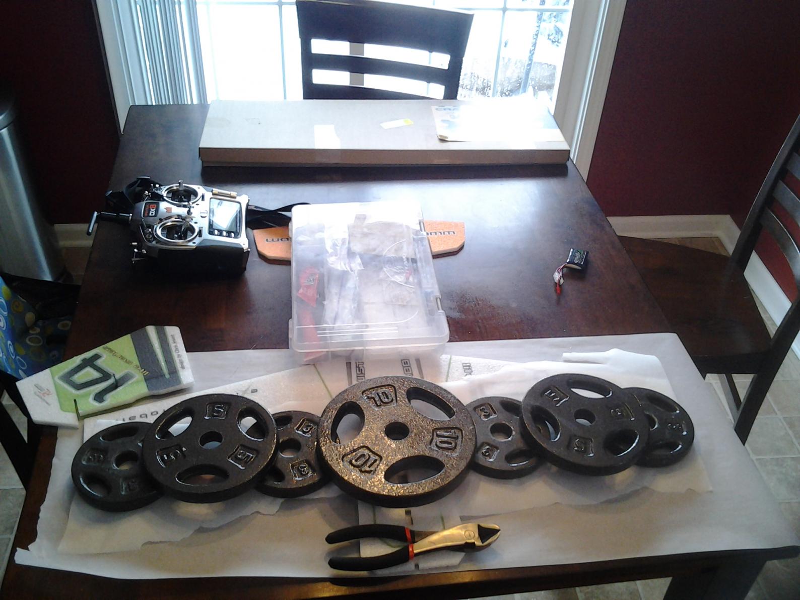

I have flown this plane at a local indoor event and the one I flew had a surprising amout of power on a 2 cell set up. It torque rolled with little or no corrections once locked into a hover and zero coupling in KE flight. I hope my build turns out as good as the on my buddy let me test fly. Here is a picture of my build so far. Weights are holding the spar fllush with the cut outs in the foam. Probably overkill but I had plenty laying around.
