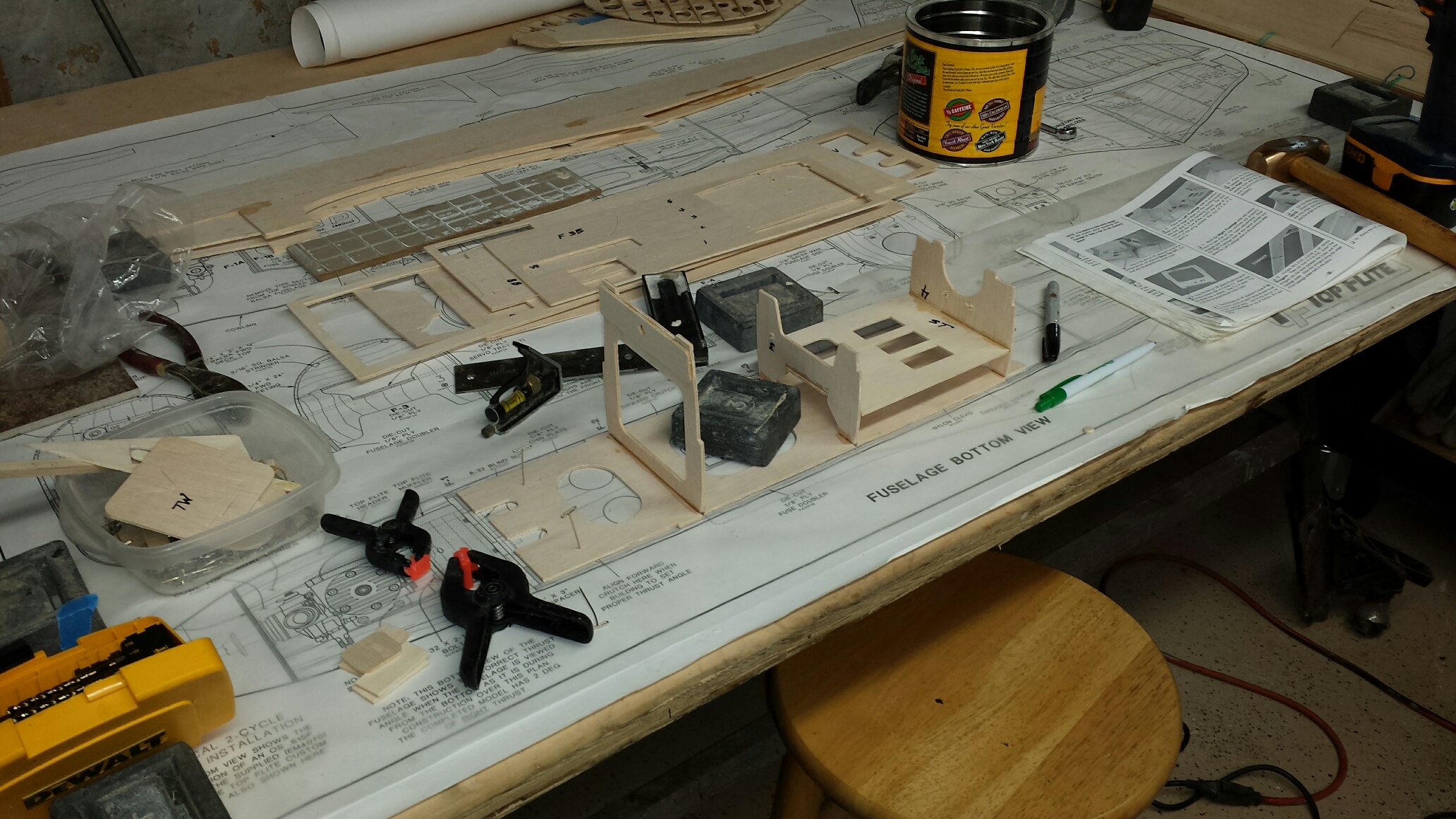

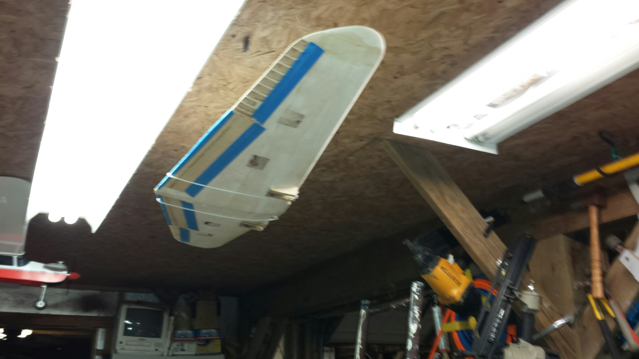

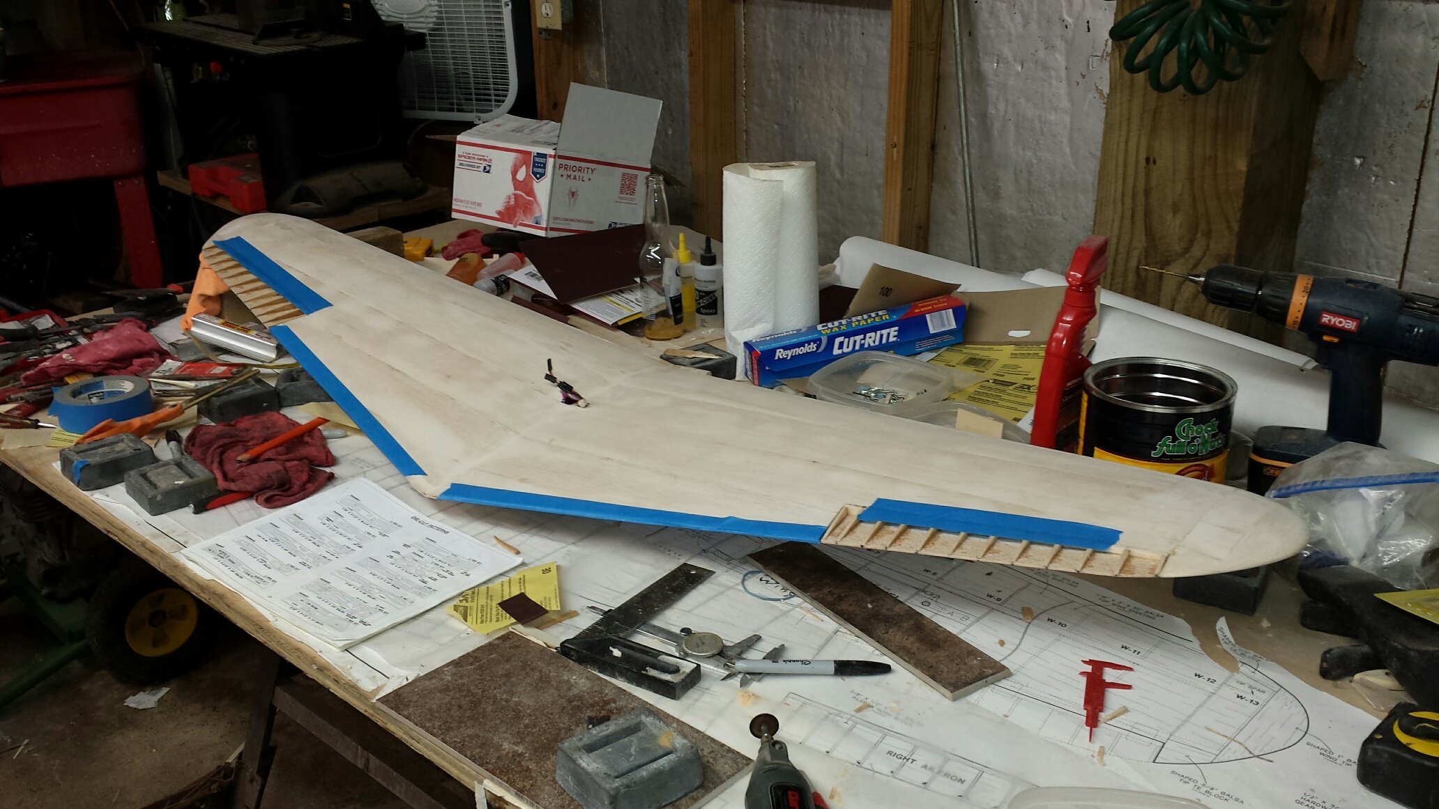

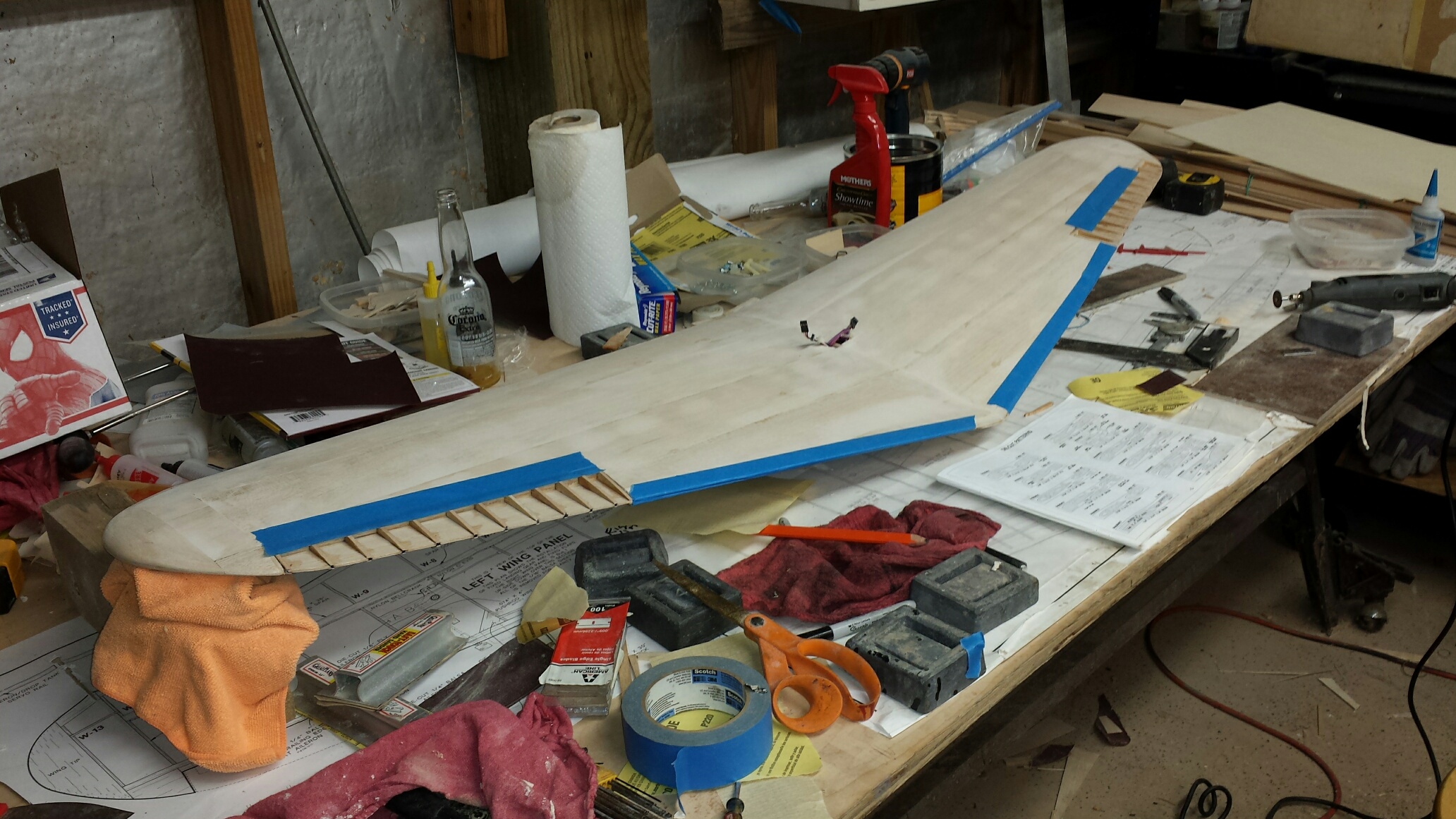

I worked on the plane agout three hours this evening and finished the alerions and formed the trailing edge to match the alerions so that finished the wing. Hung it up to get out of the way and will start on the fuselodge after I clear off the work table and roll out the fuselodge plans. 20141008_212746_resized_1.jpg20141008_220152_resized.jpg20141008_212732_resized_2.jpg

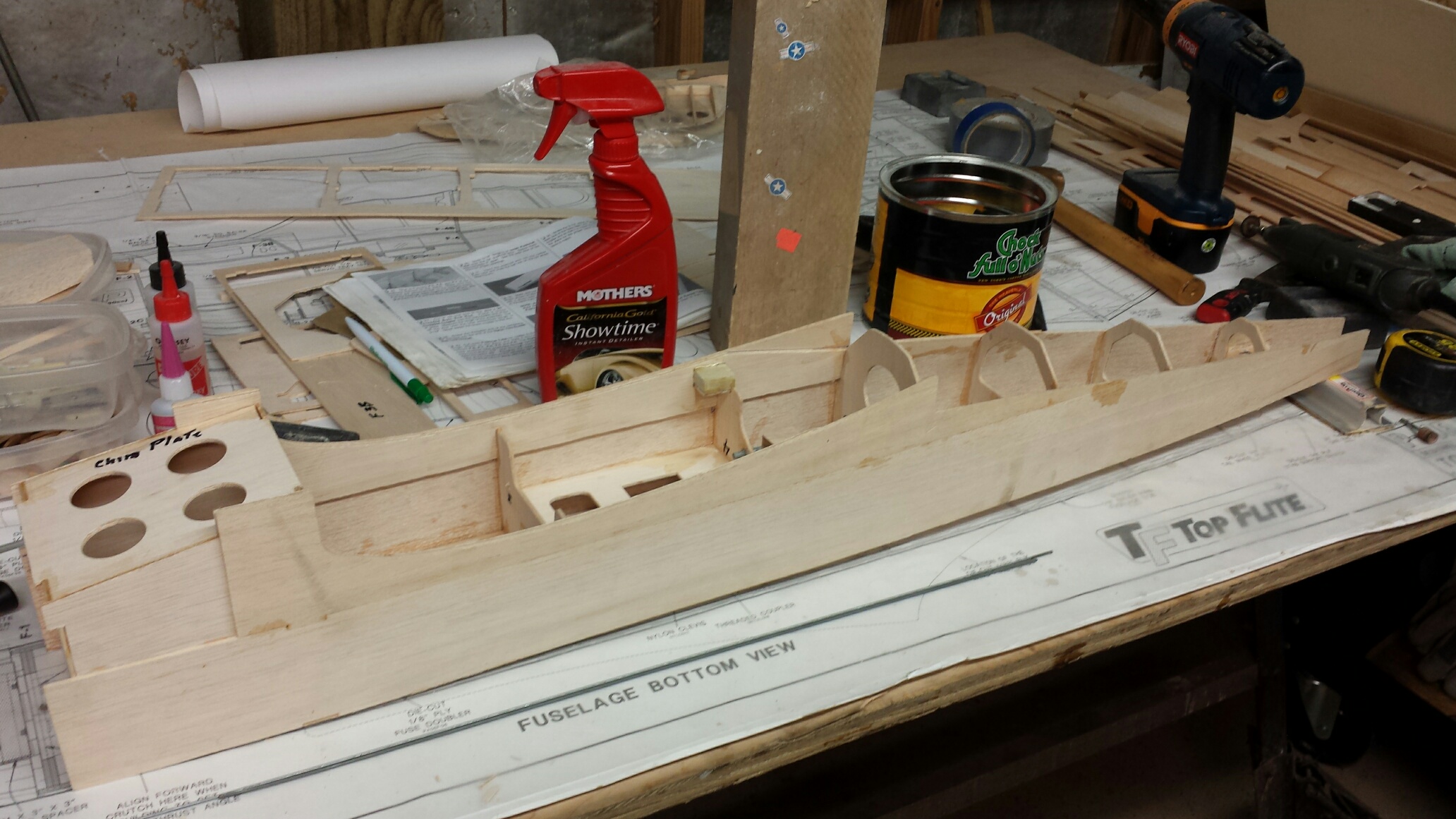

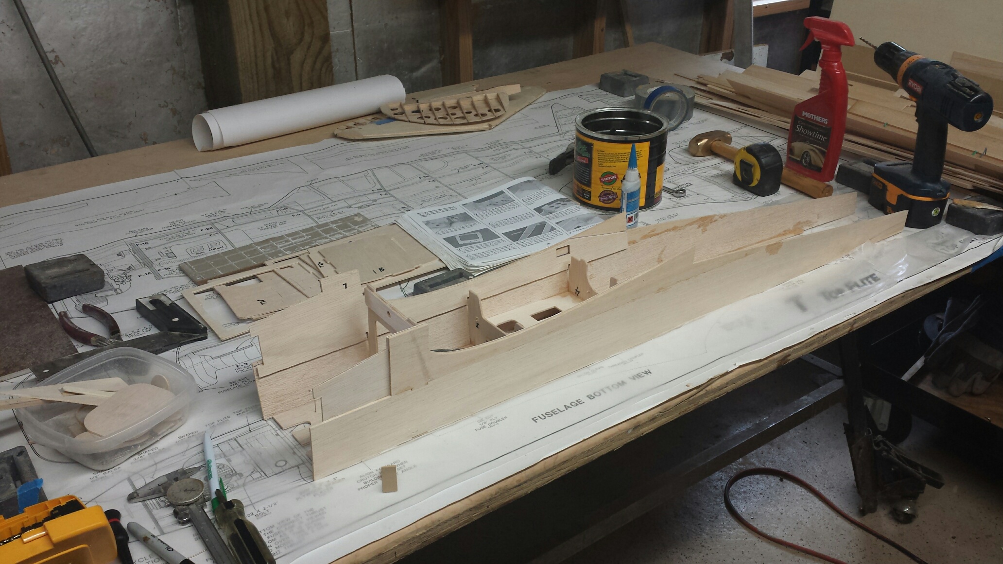

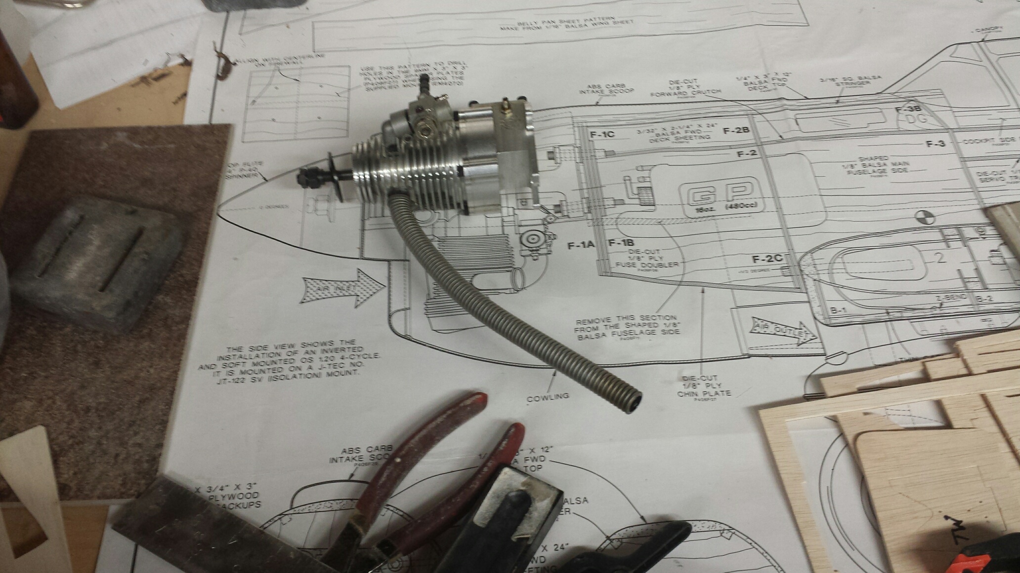

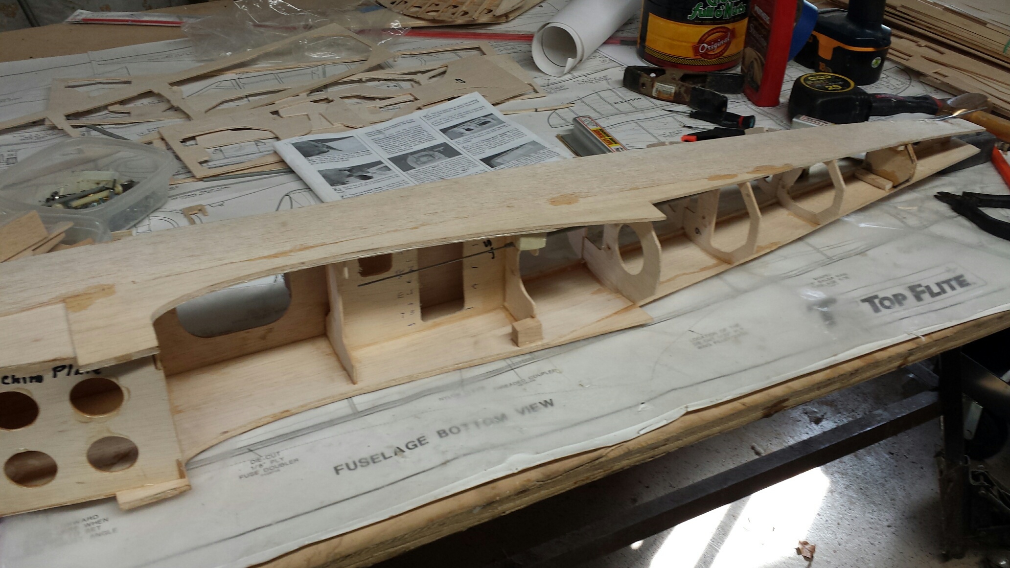

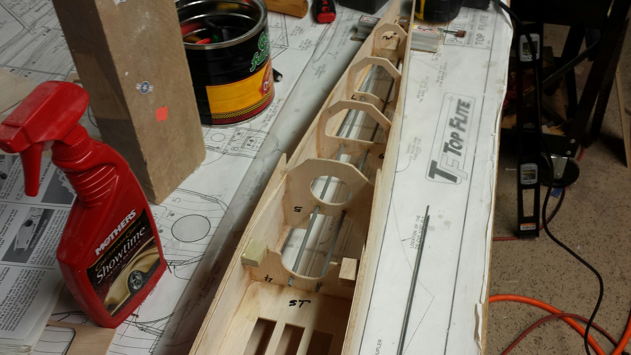

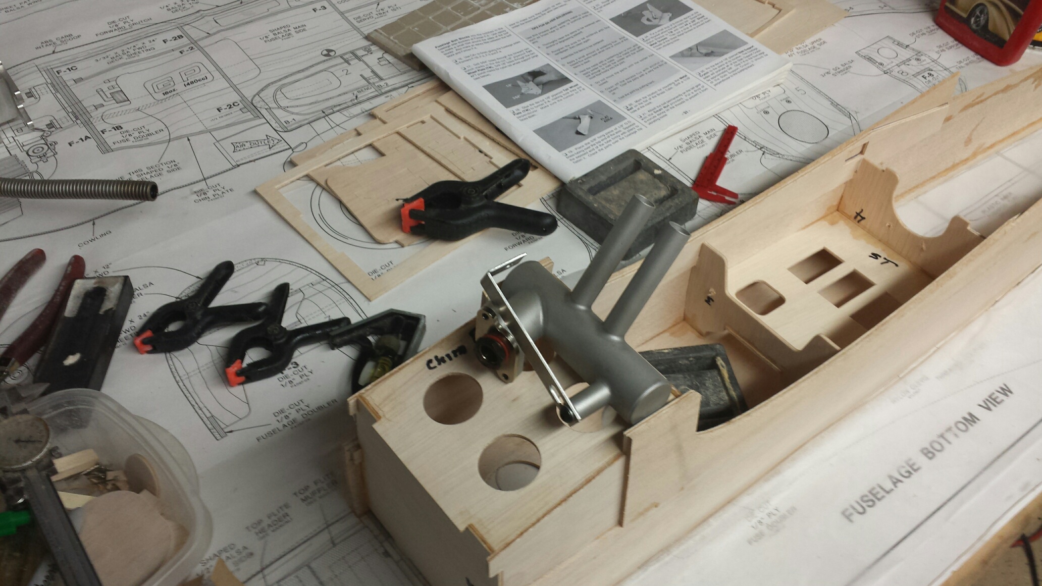

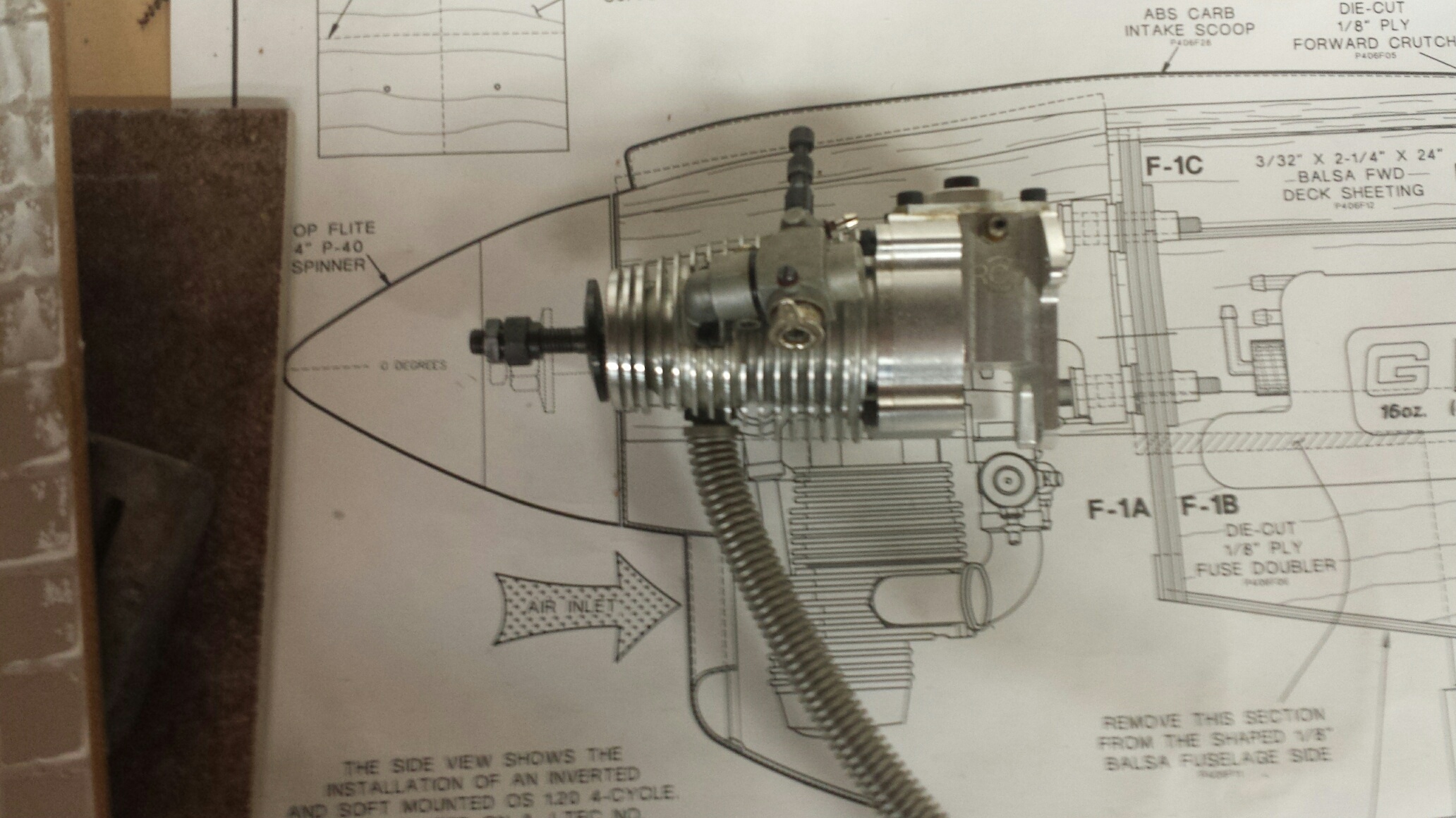

20141010_184721_resized.jpg20141010_175024_resized.jpg20141010_152842_resized.jpgDid a little more on the fuselodge and played around a little with the powerplant I'm going to use and the muffler just to make sure it wil fit inside the cowling and took some measurements from the plans so I can construct an engine mount.20141010_191912_resized.jpg20141010_184730_resized.jpg

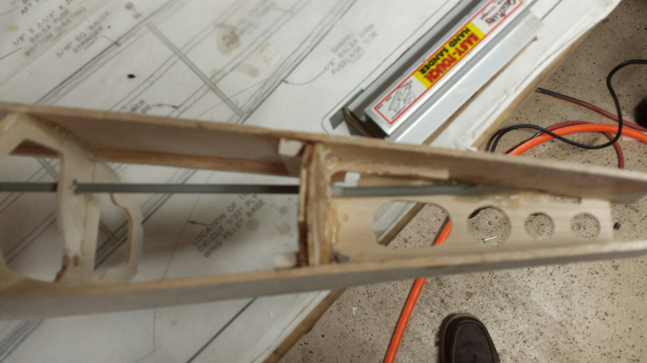

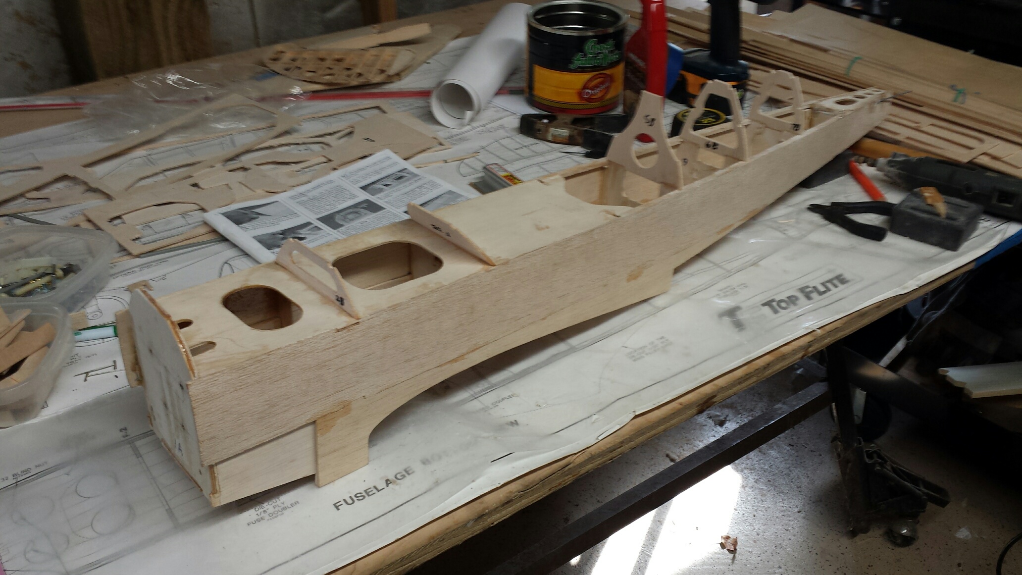

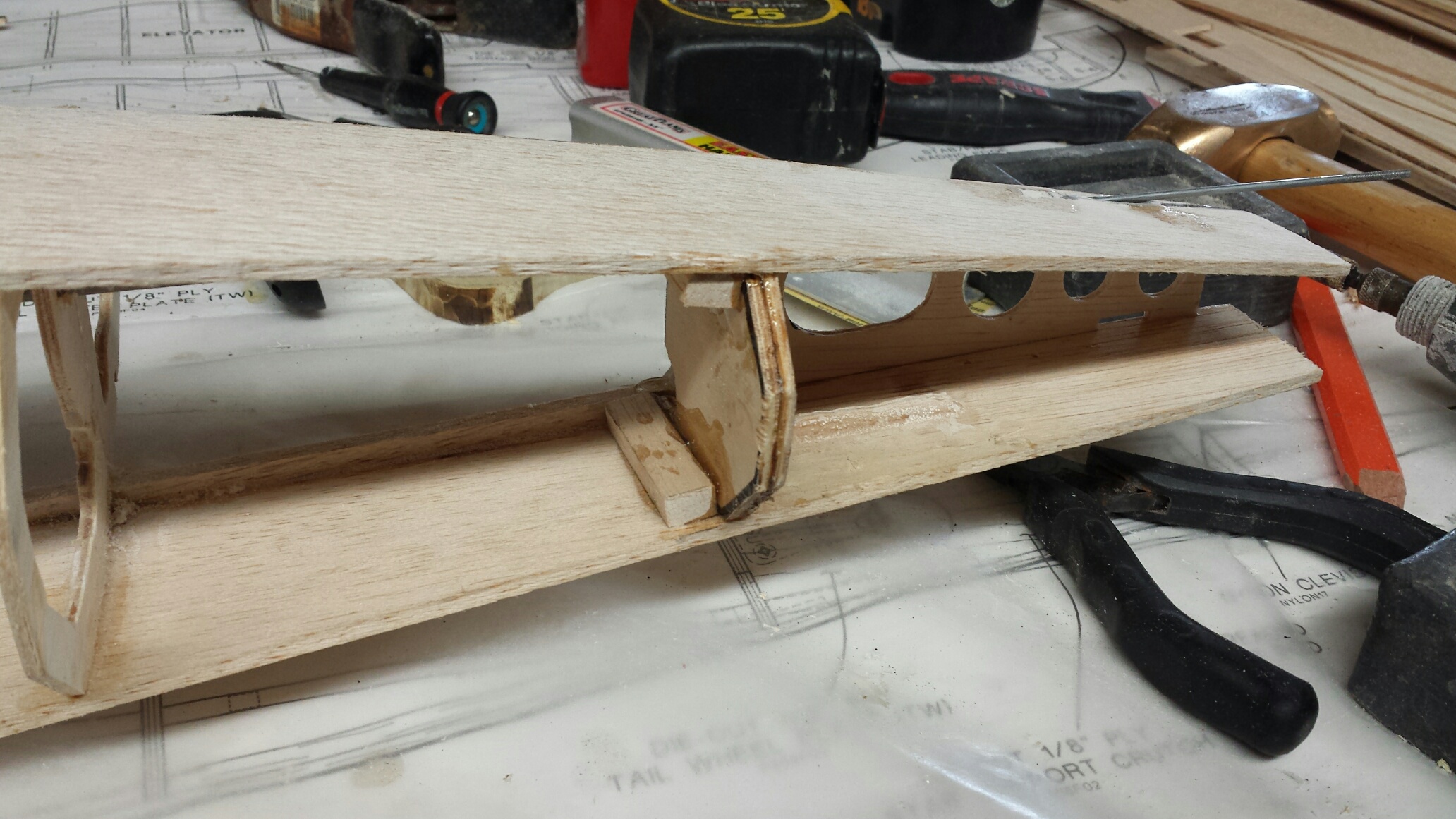

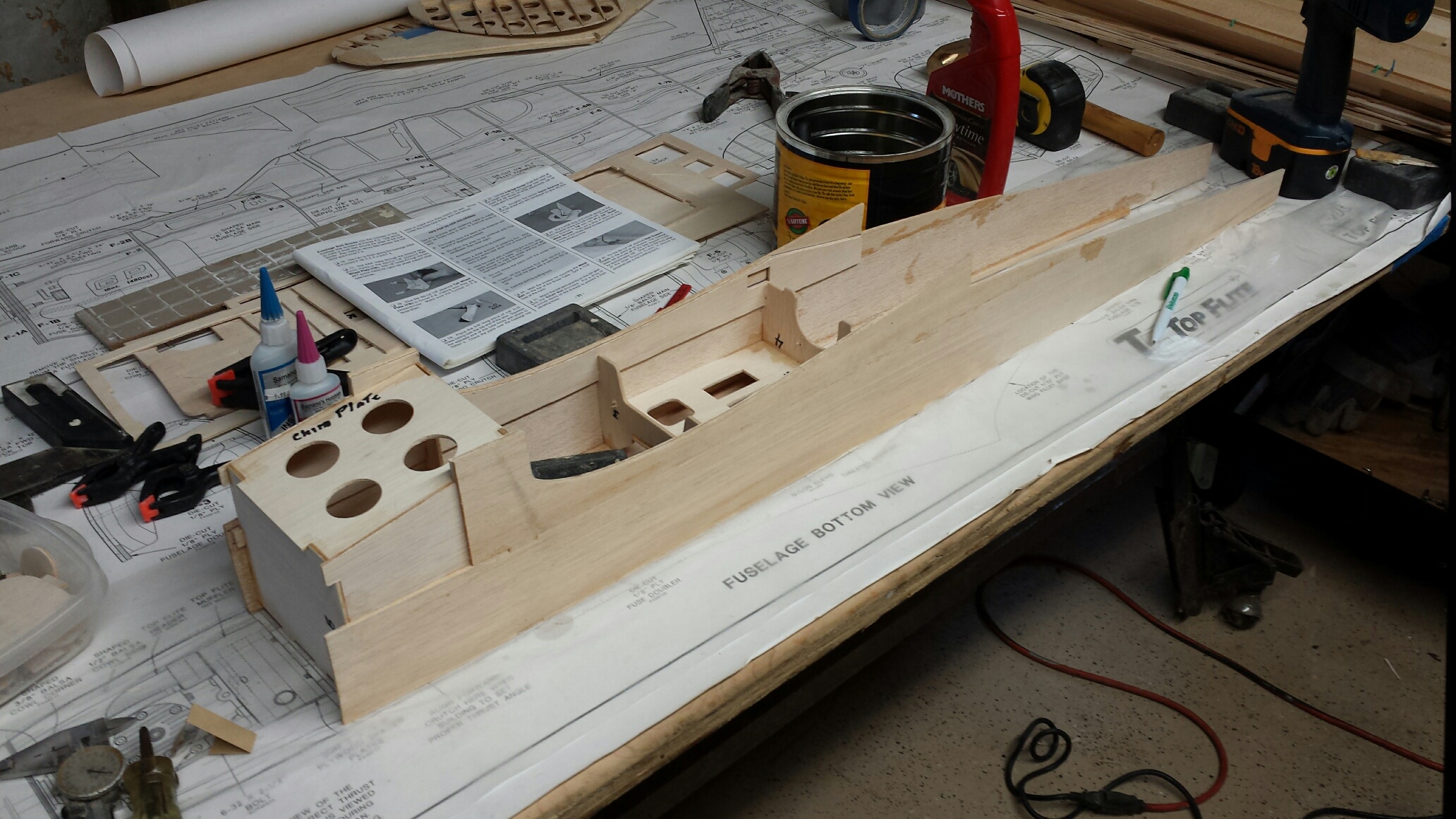

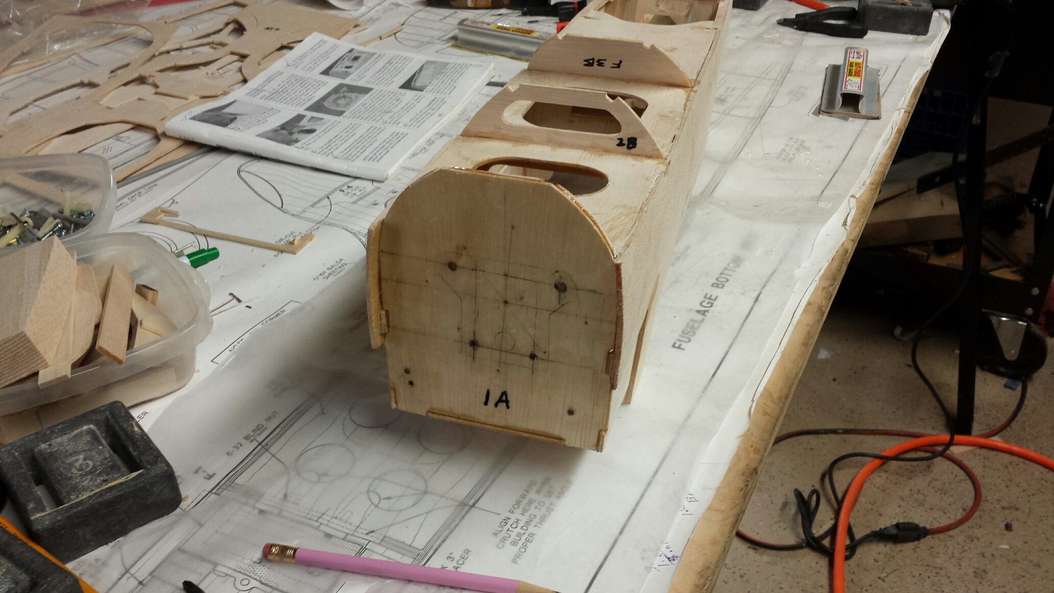

20141017_161429_resized.jpg20141017_161417_resized.jpg20141011_201010_resized_1.jpg20141017_161429_resized.jpg20141017_161651_resized.jpgWell disregard the last post I am able to continue a little furthur and did a little more yesterday and today inclufing setting up the engine to mount and doing some more stringer work along with renforcing the tailwheel stringer to accept the retractable tailwheel. I decider to use a Turnigy tailwheel instead of a Robart because the robart is just to wide and would create more problems including how to mount the air cylinder. This one is electric and all self contained and I can Y it off the main gear air retract servo.20141017_162916_resized.jpg20141017_161728_resized.jpg
