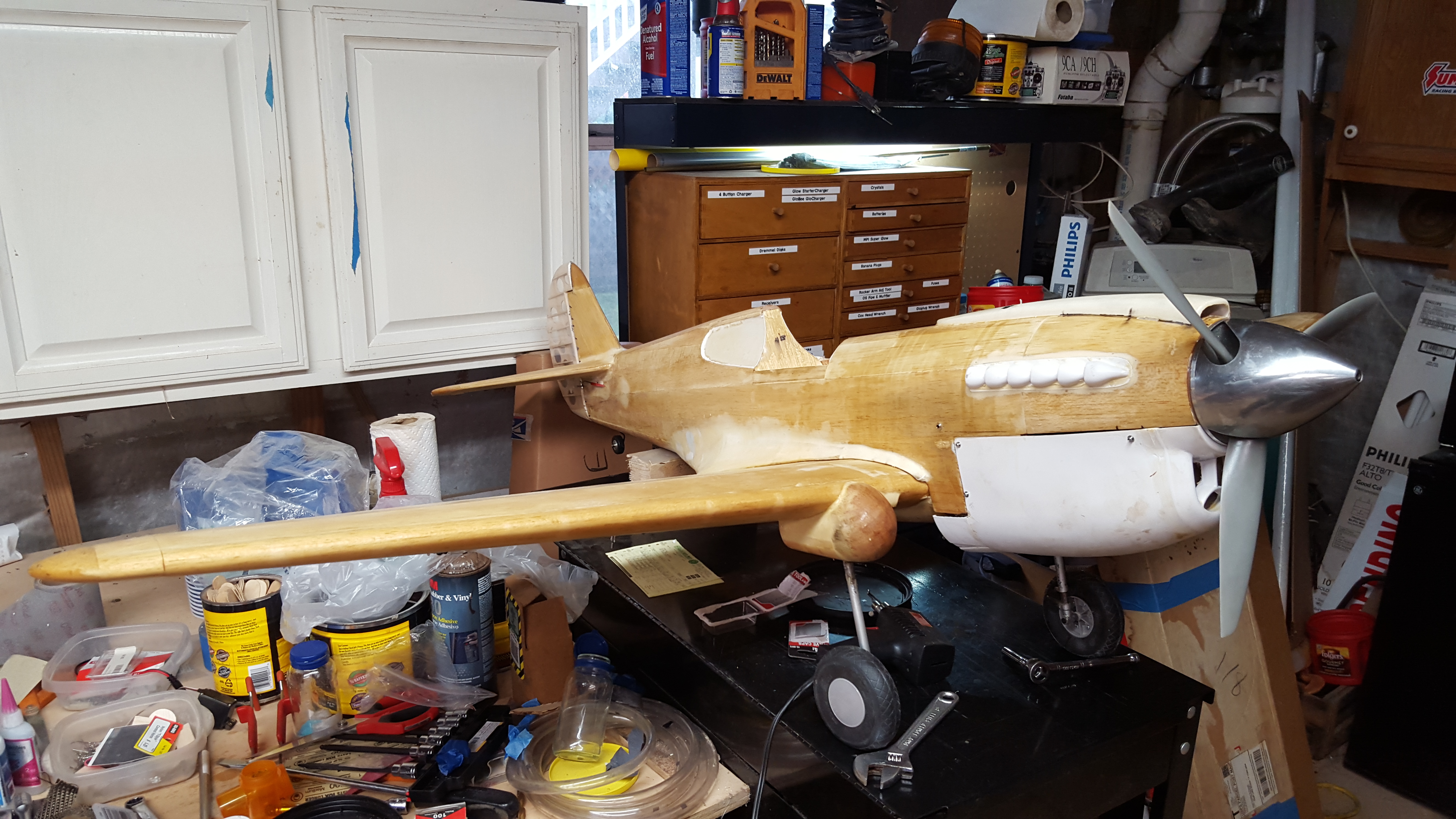

Working on getting the motor correctly installed and all the servos and linkage hooked up. 20151010_205205.jpg

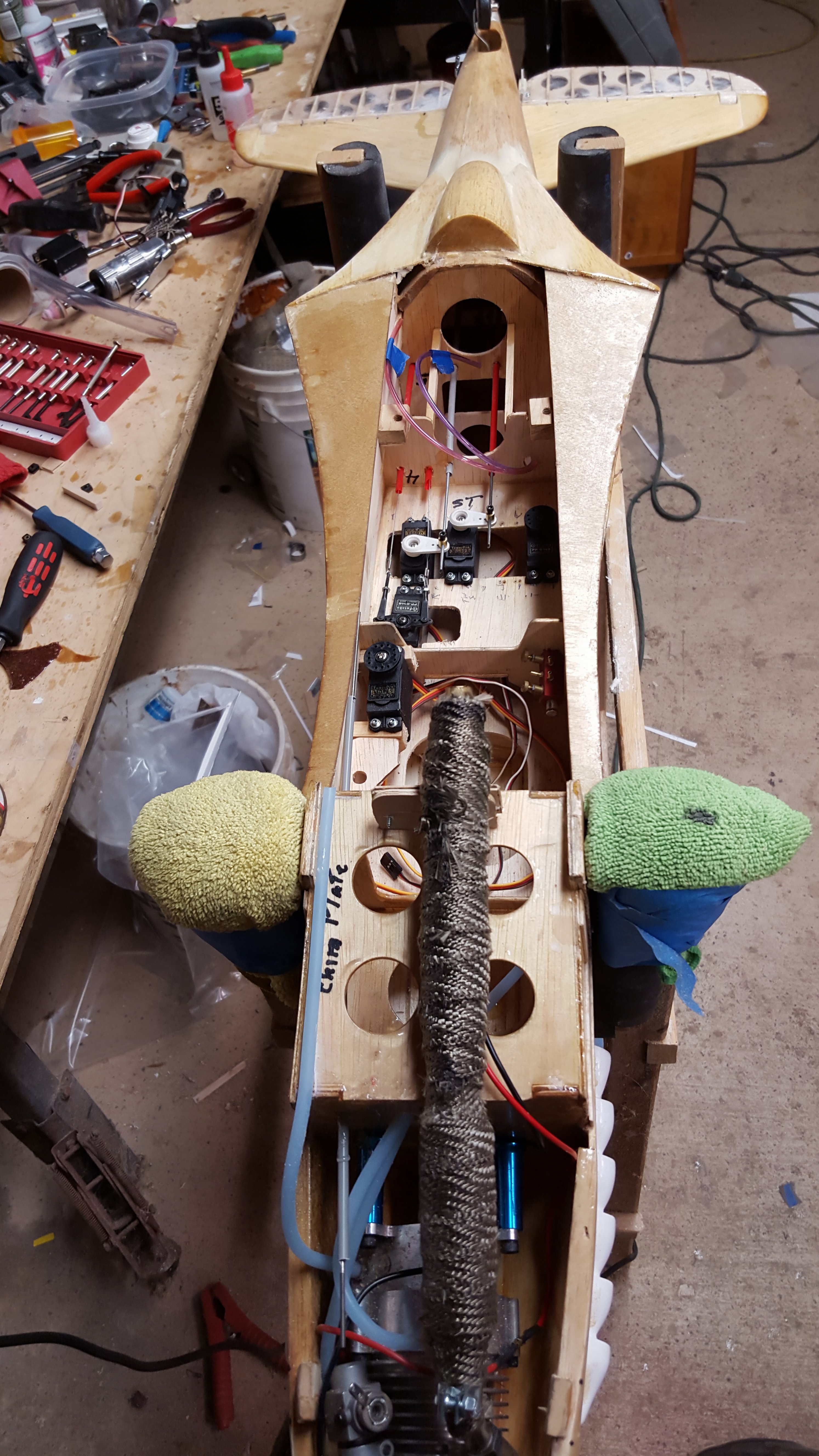

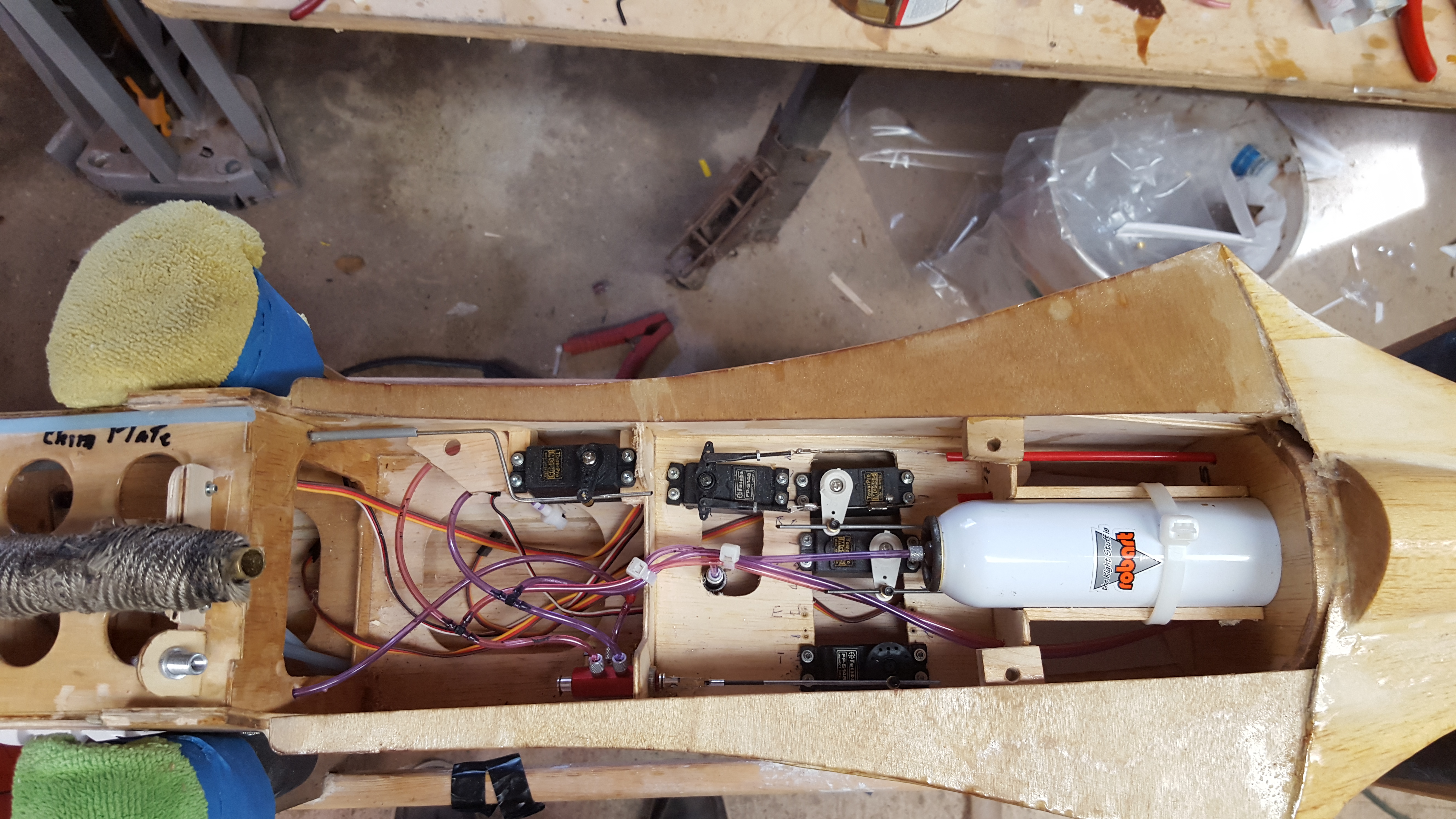

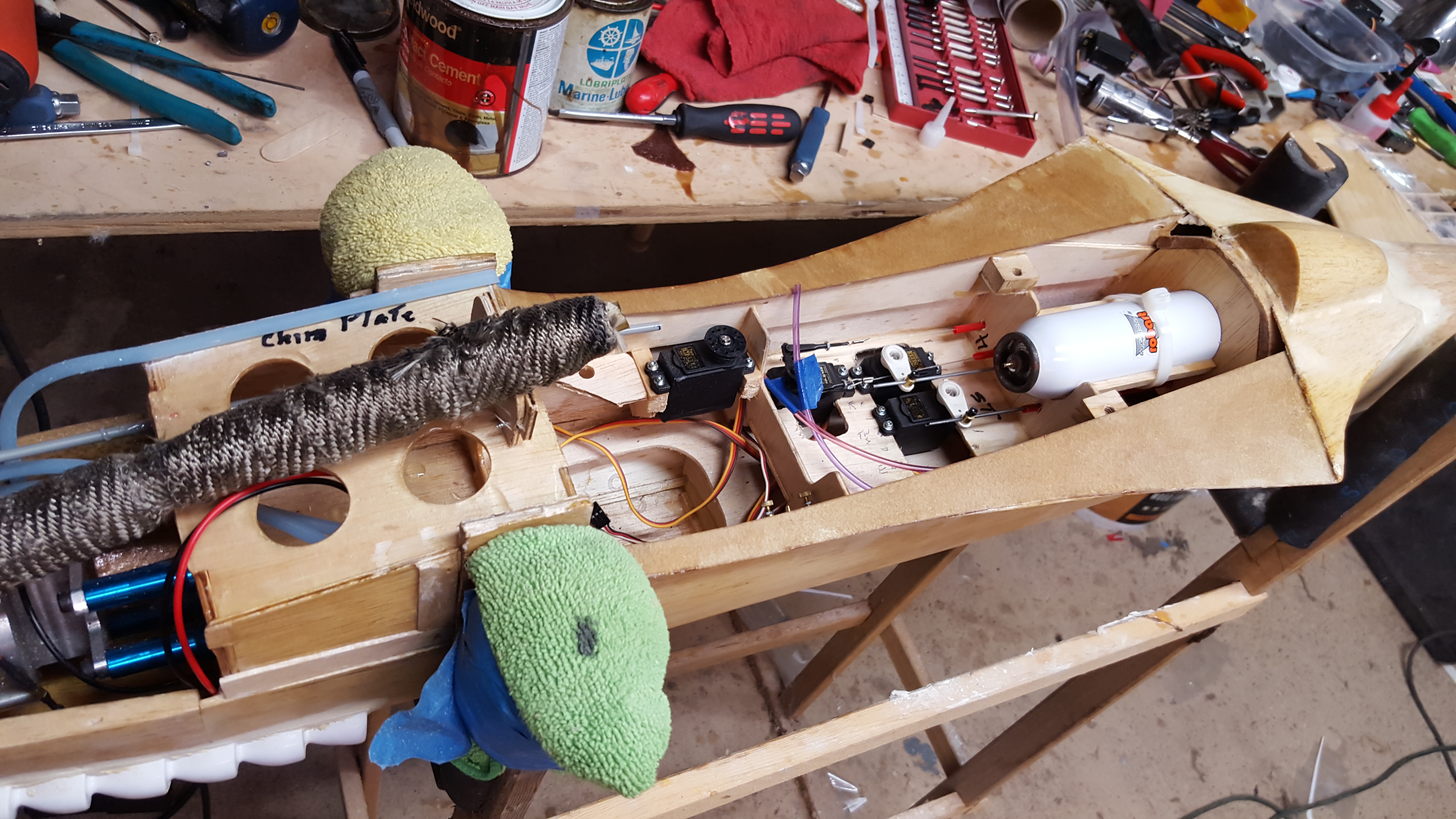

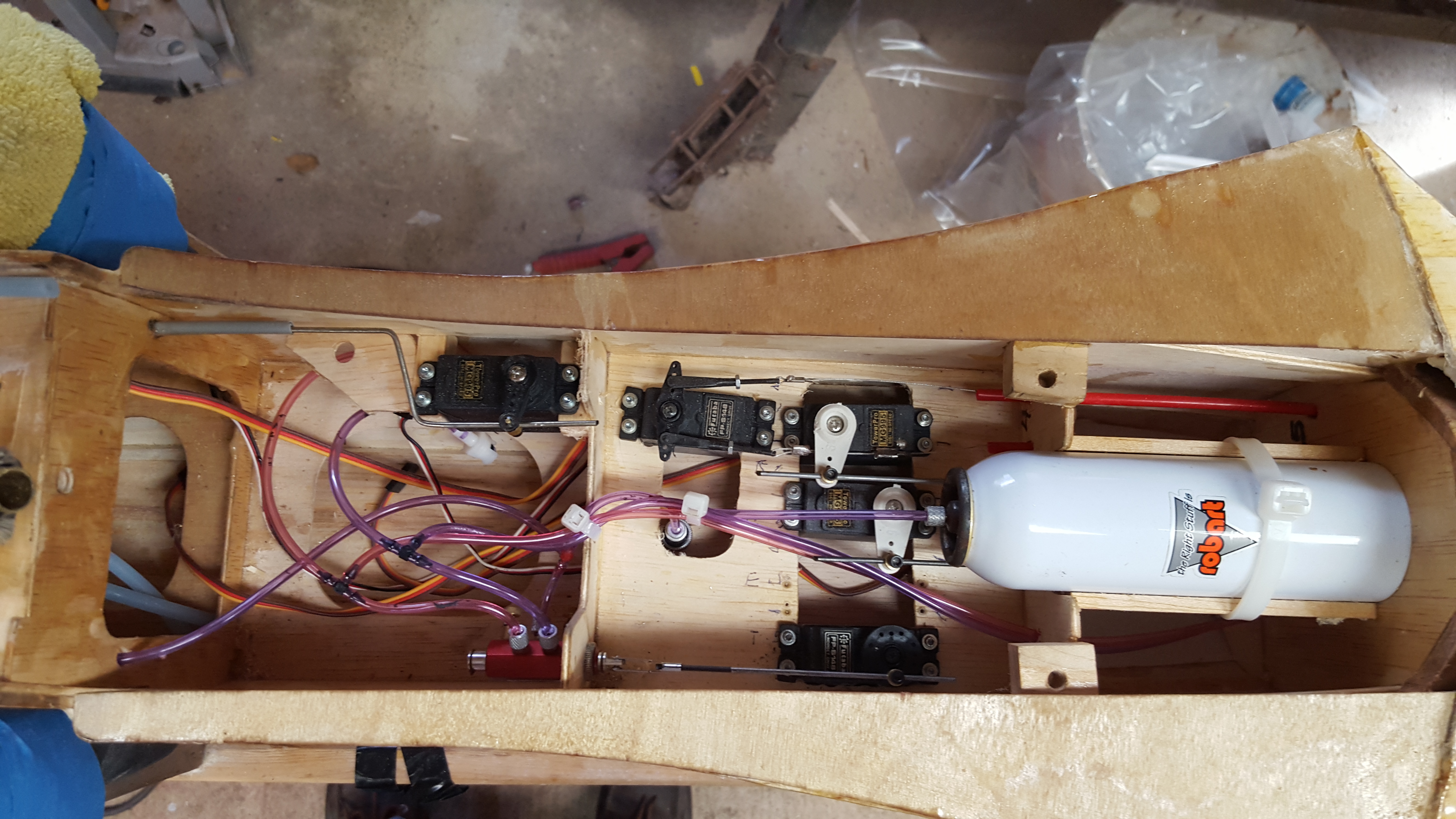

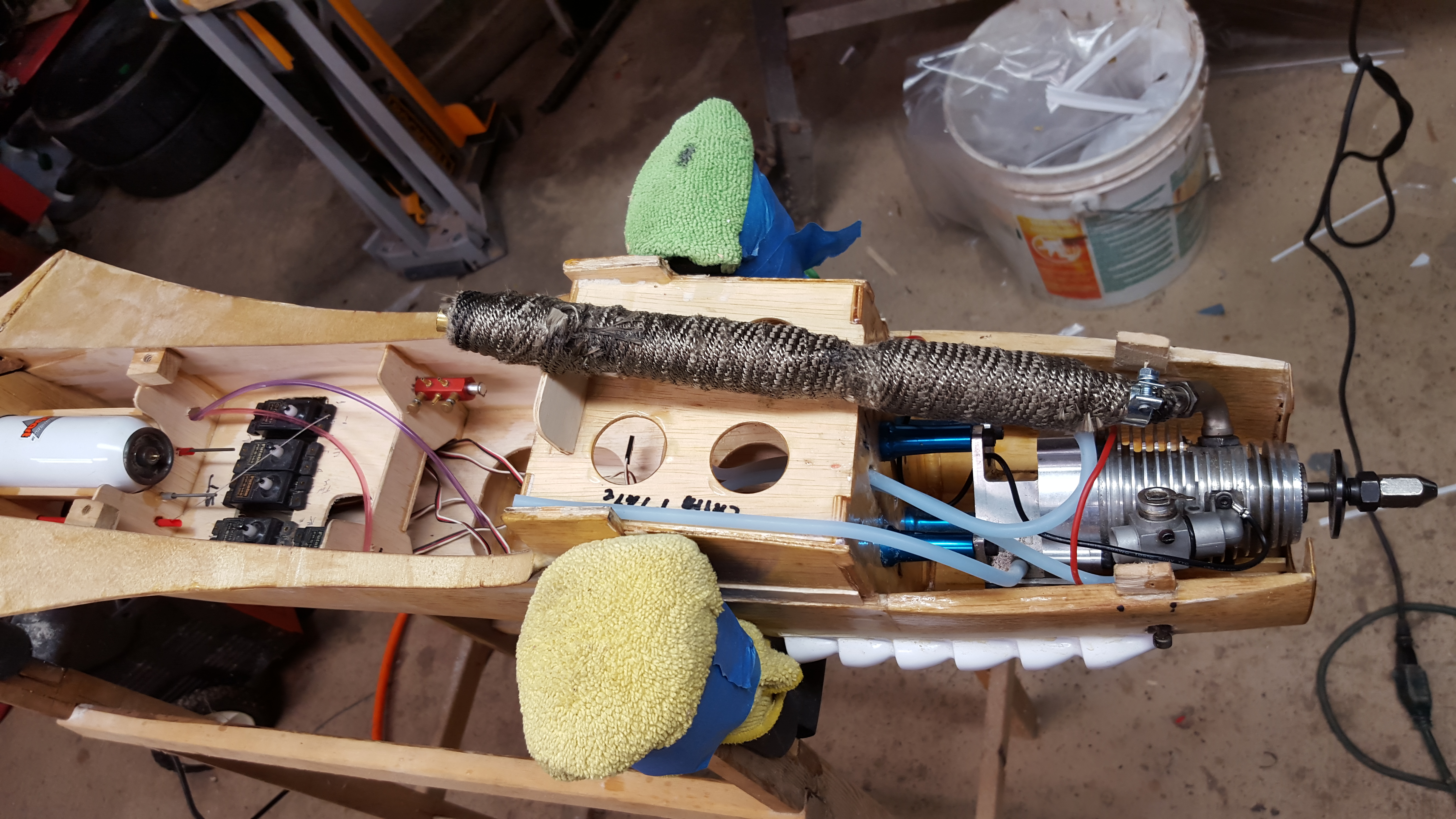

Worked a little more on it I got the servos mounted and the russed , tail wheel and the elevator working. anf the throttle control rod installed.20151018_201531.jpg20151018_202424.jpg20151018_202436.jpg20151018_202455.jpg

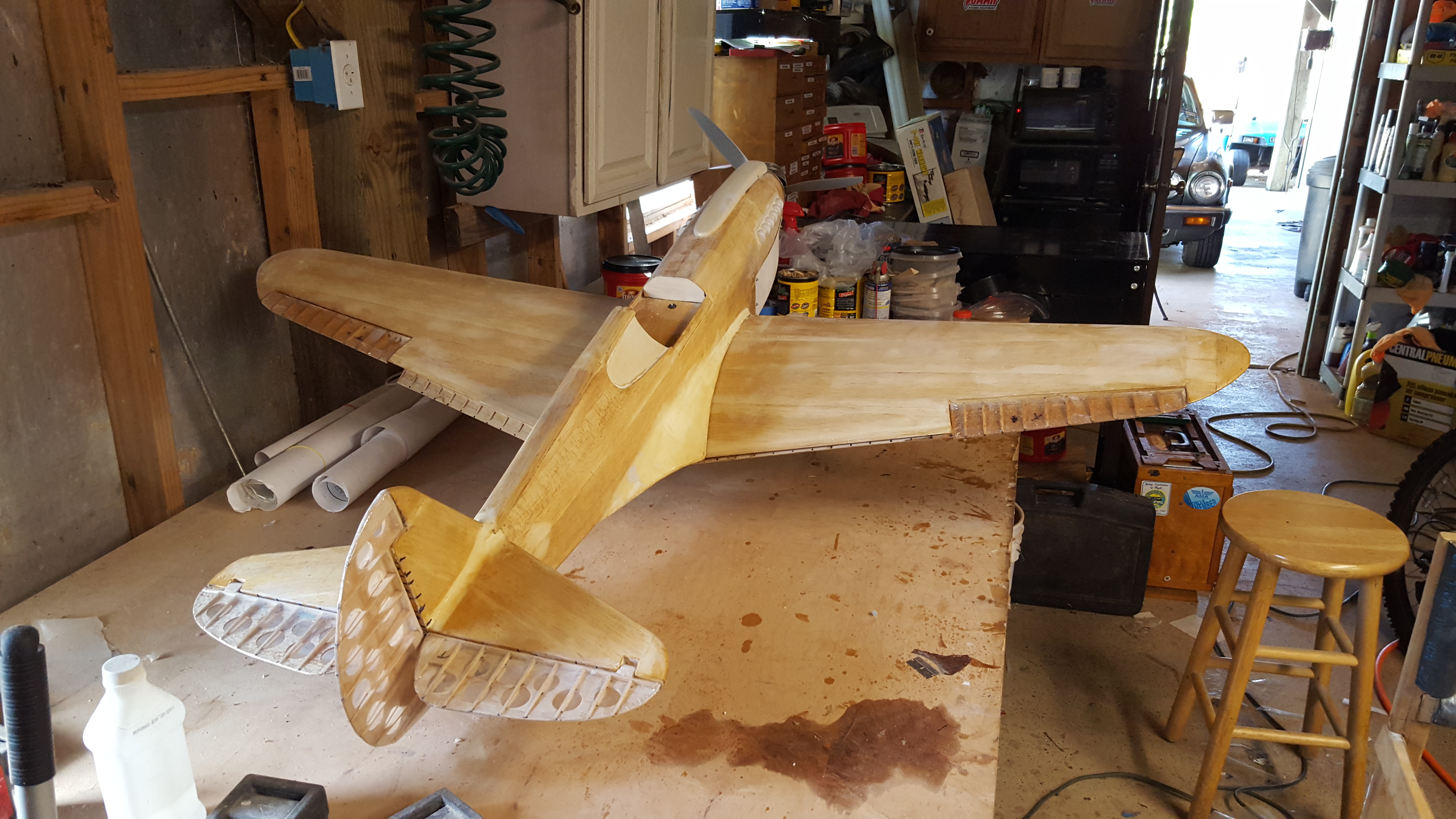

During the next week I'm going to finish installing the gear pneumatics and the aileron and flap controls and this plane will be ready to paint.
Charles

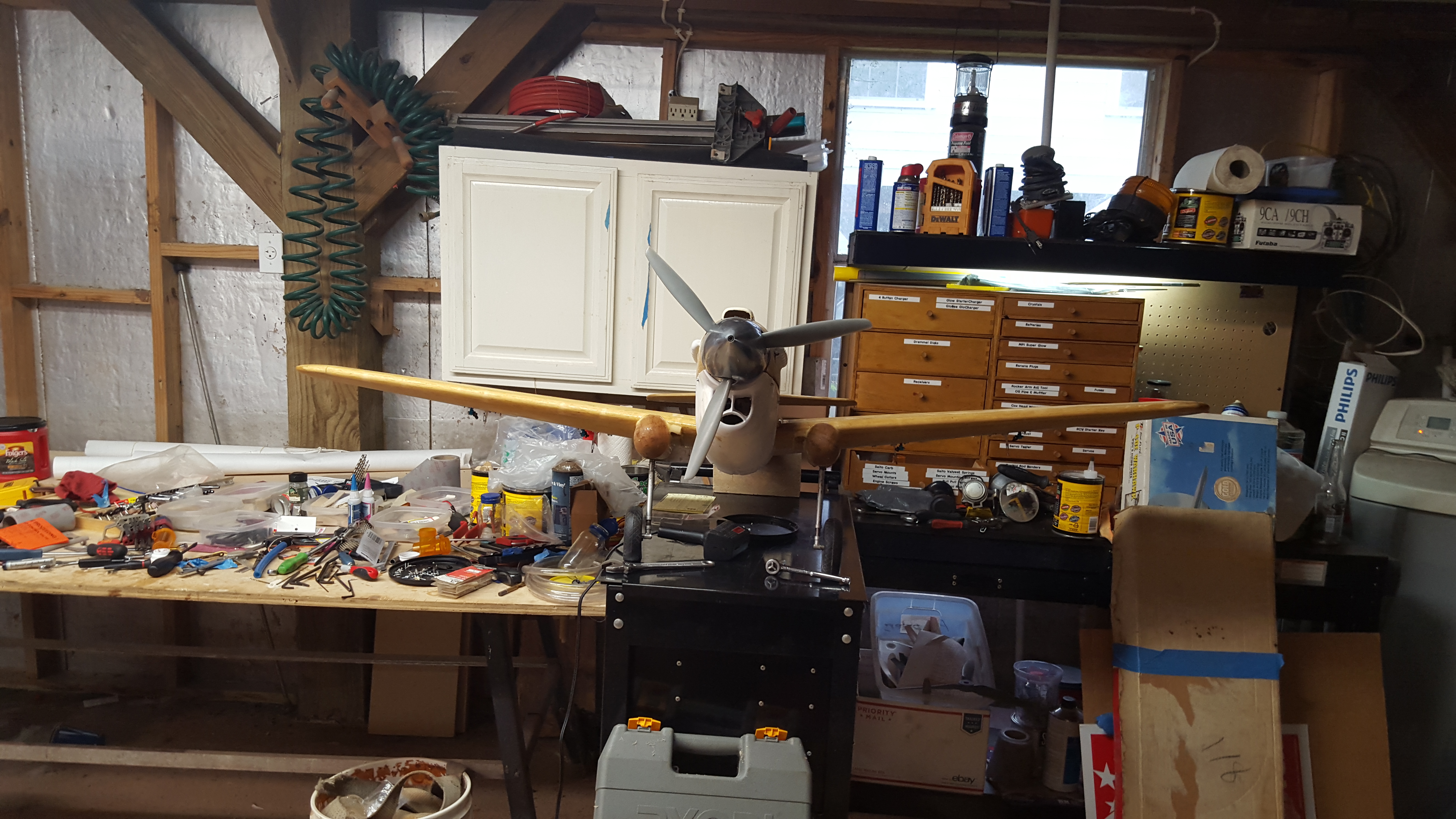

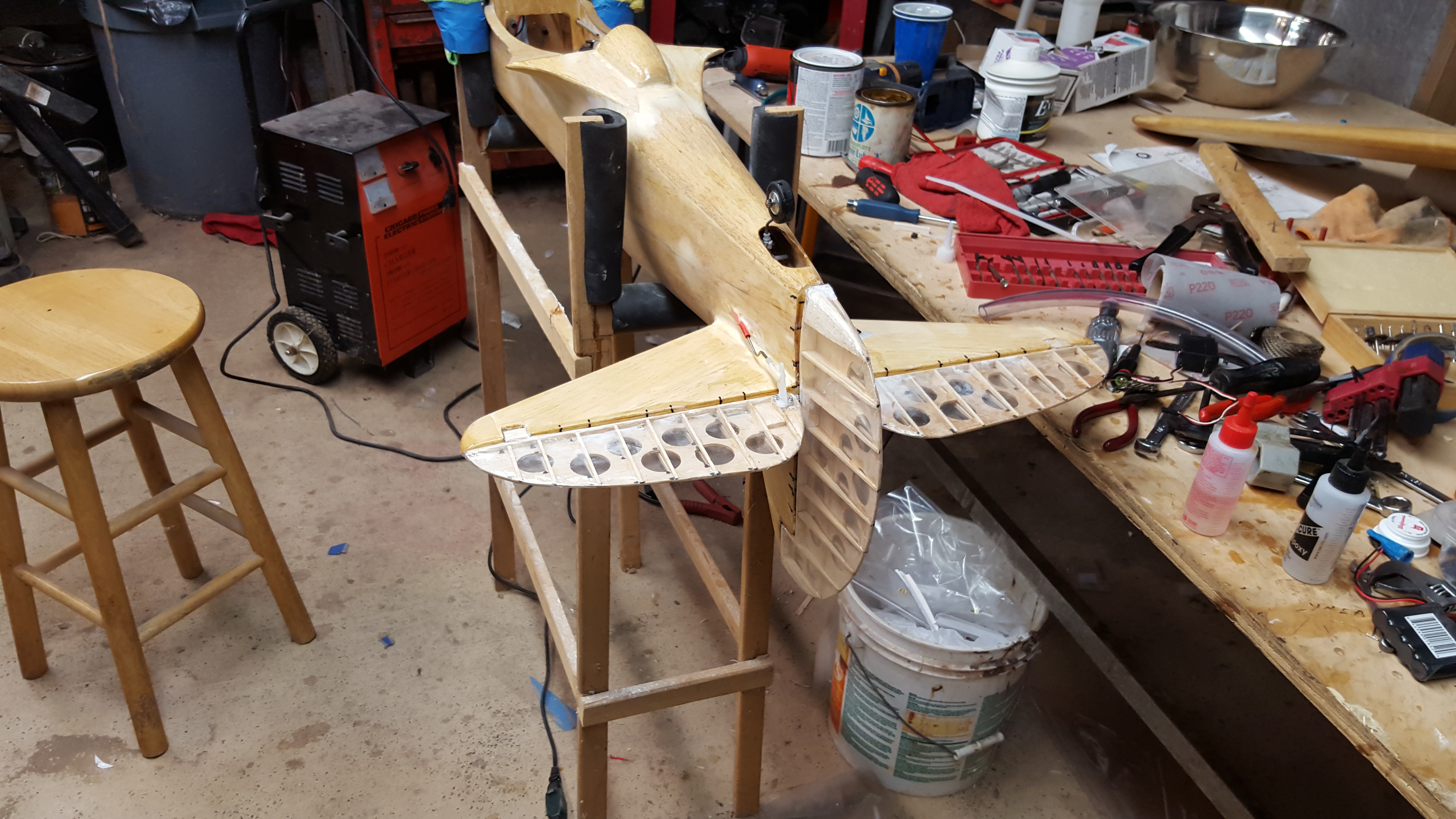

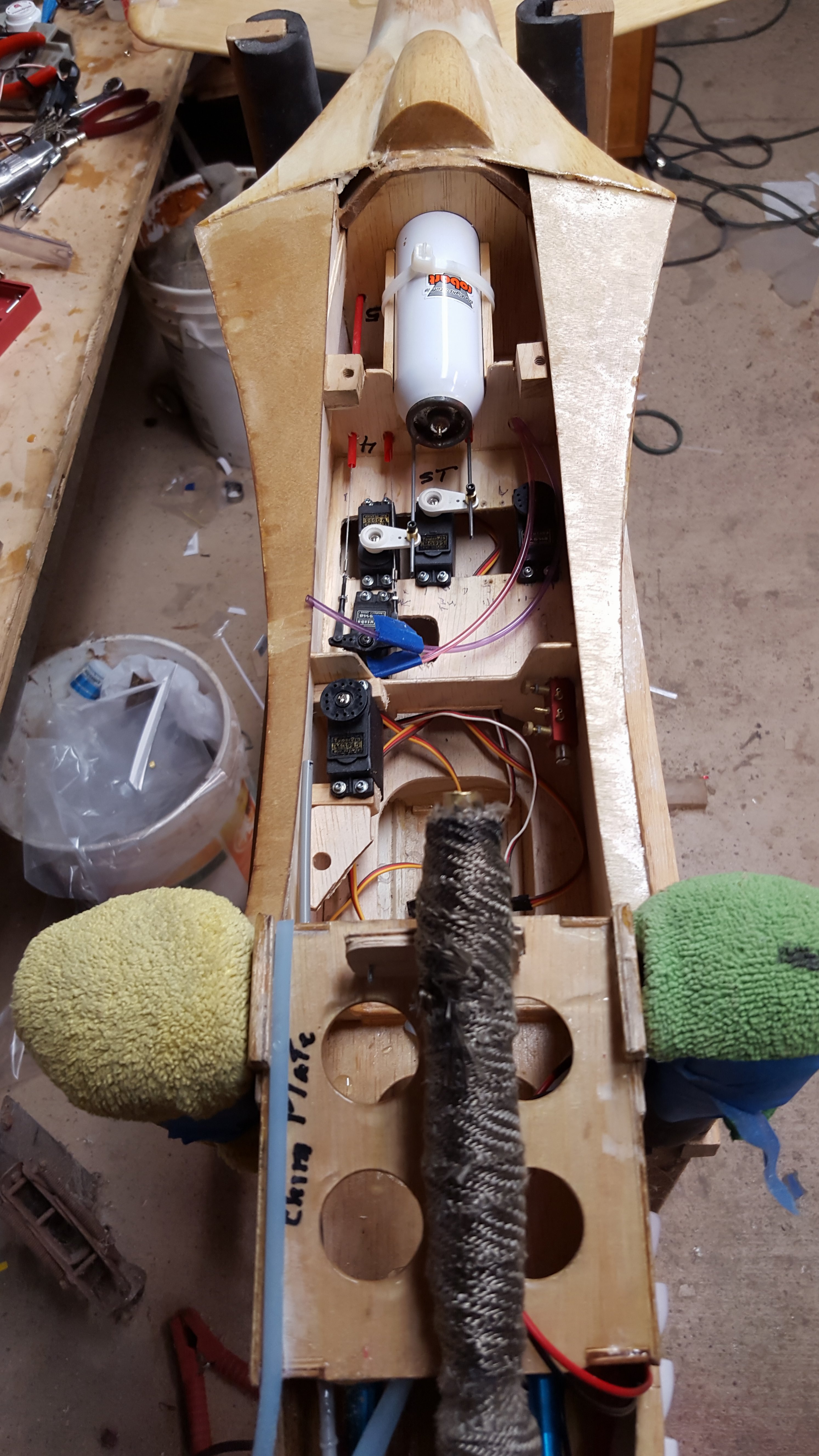

Finished the last phase and got the air system installed and working. I had a little problem with the air retract when I first installed them they were leaking everytime I operated them I checked for leaks and there were none so cleaned the operating rods and continued to operate and they got better and I am getting around seven cycles now before having to add air so hoped they get better with more operation.. All that is left now is paint and put the pilot in and install the canopy.20151022_163835.jpg20151022_163839.jpg20151024_163821.jpg20151024_163909 (3).jpg20151024_163909 (3).jpg
