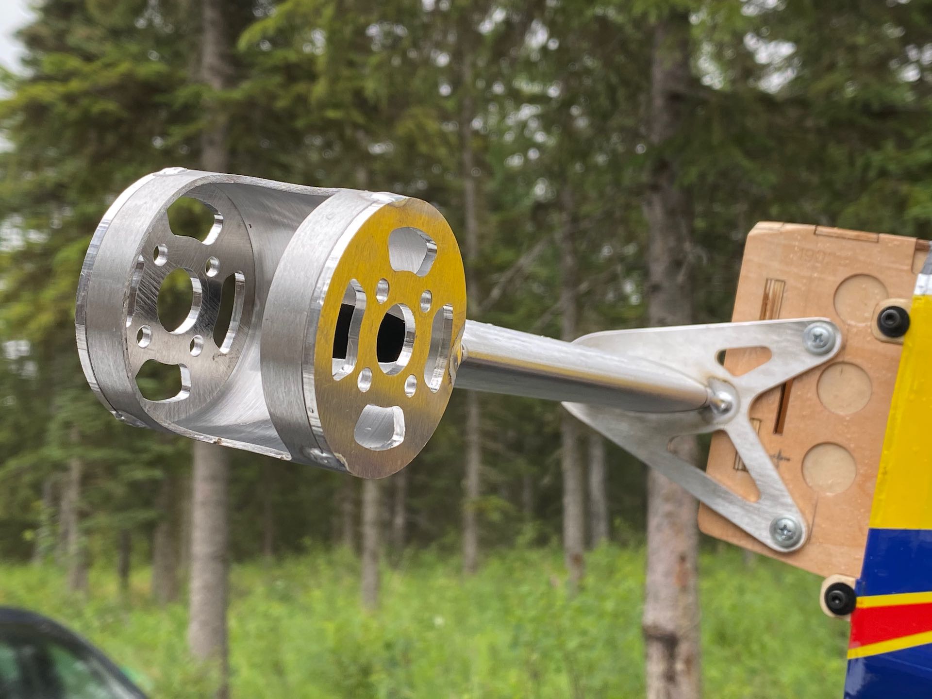

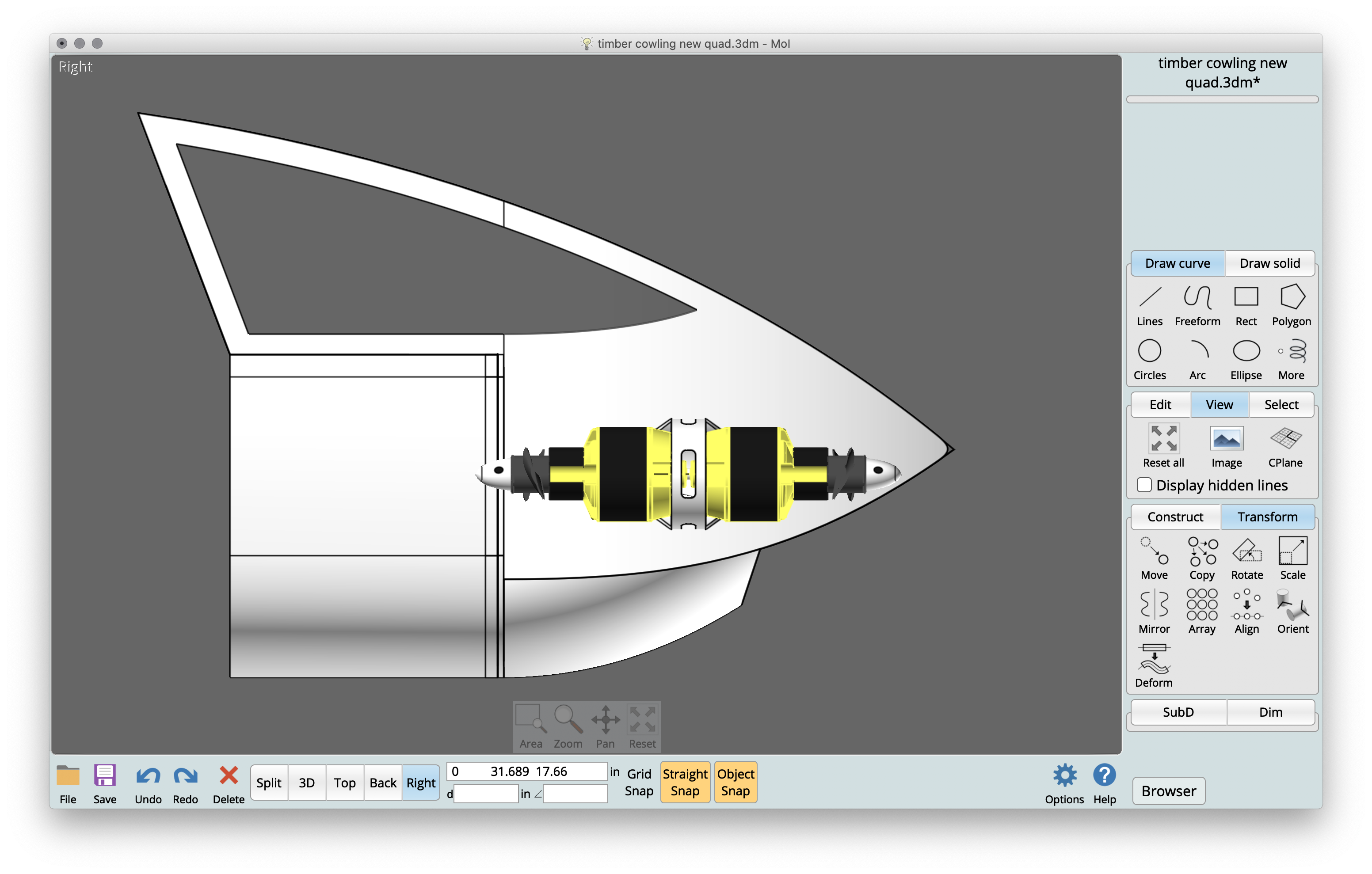

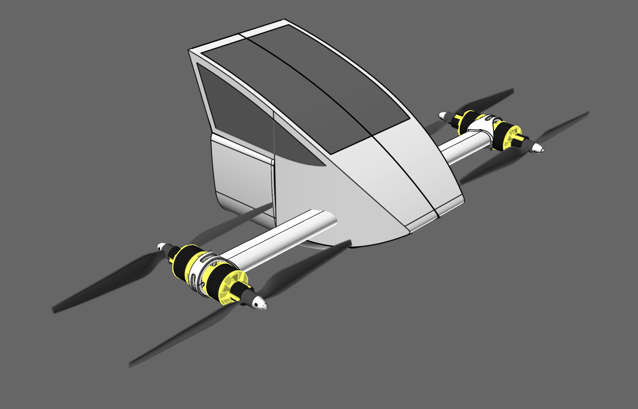

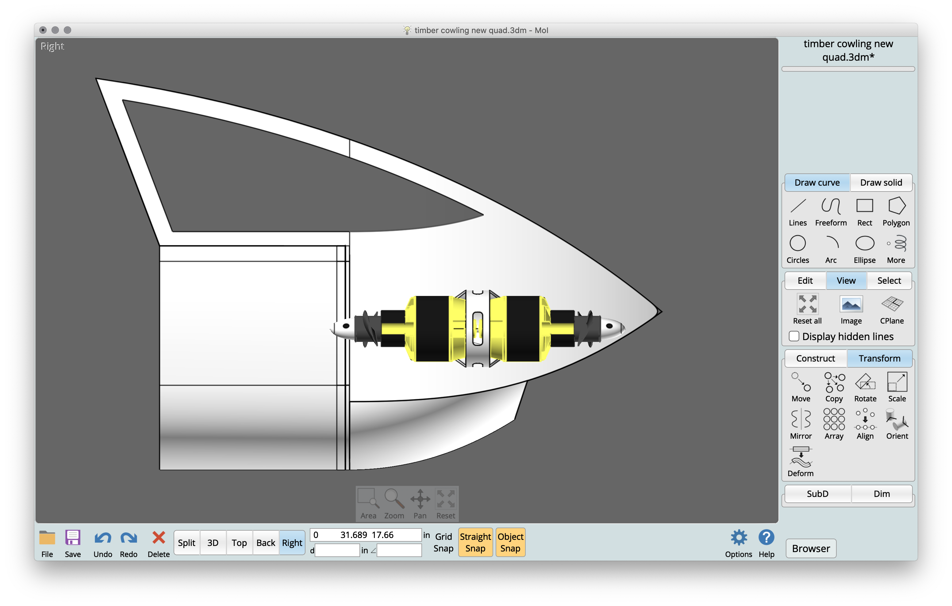

I'll do a little more testing, but I'm considering going with four 4020-630. I have a lot of experience with this little motor and an interest in exploring the push/pull configuration with brushless motors. You lose some efficiency but it is a setup that is used in the heavy lift drones to achieve redundancy with minimal structure.

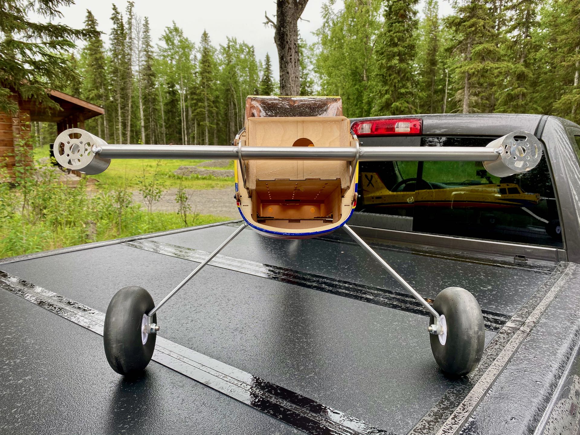

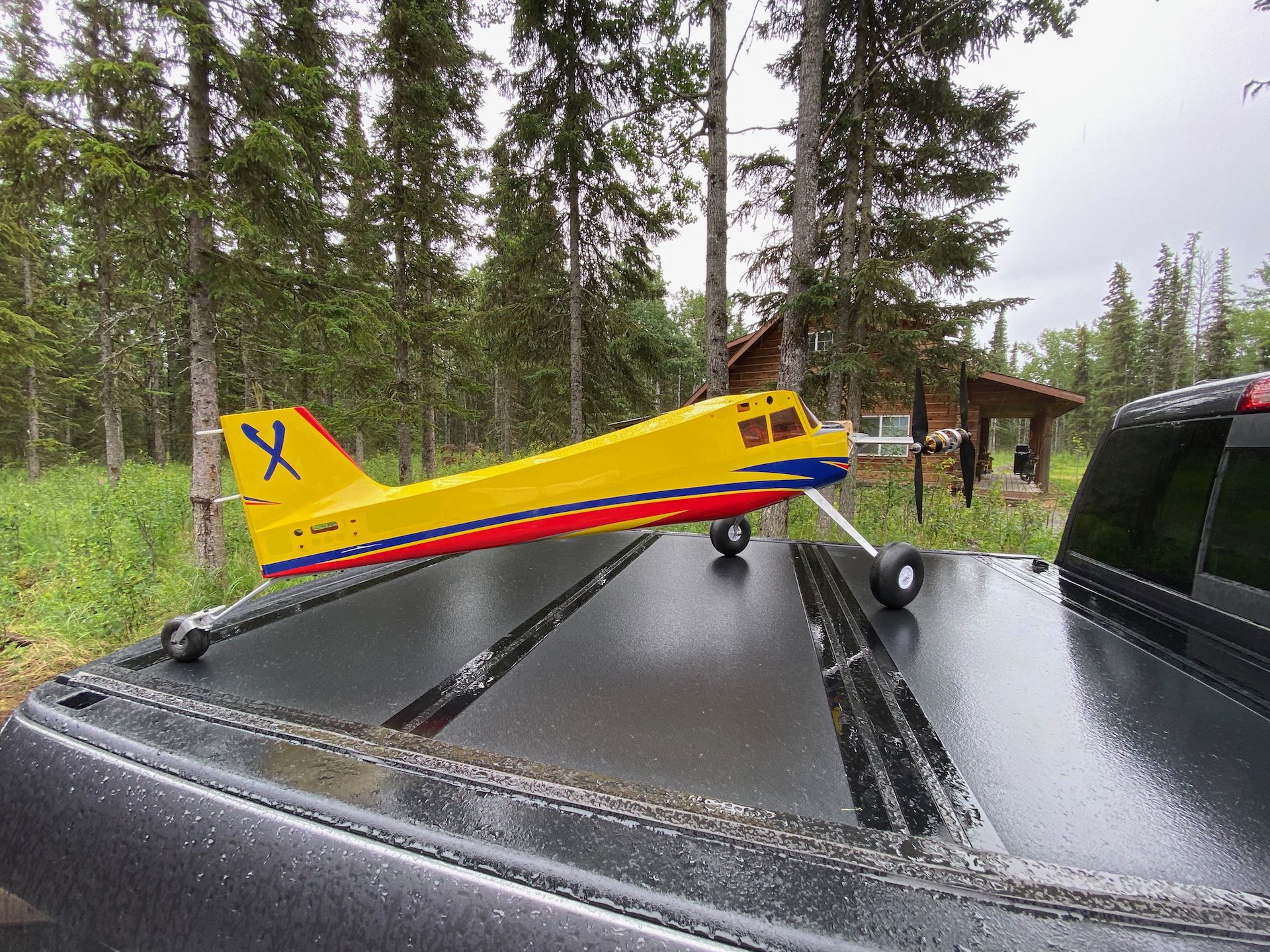

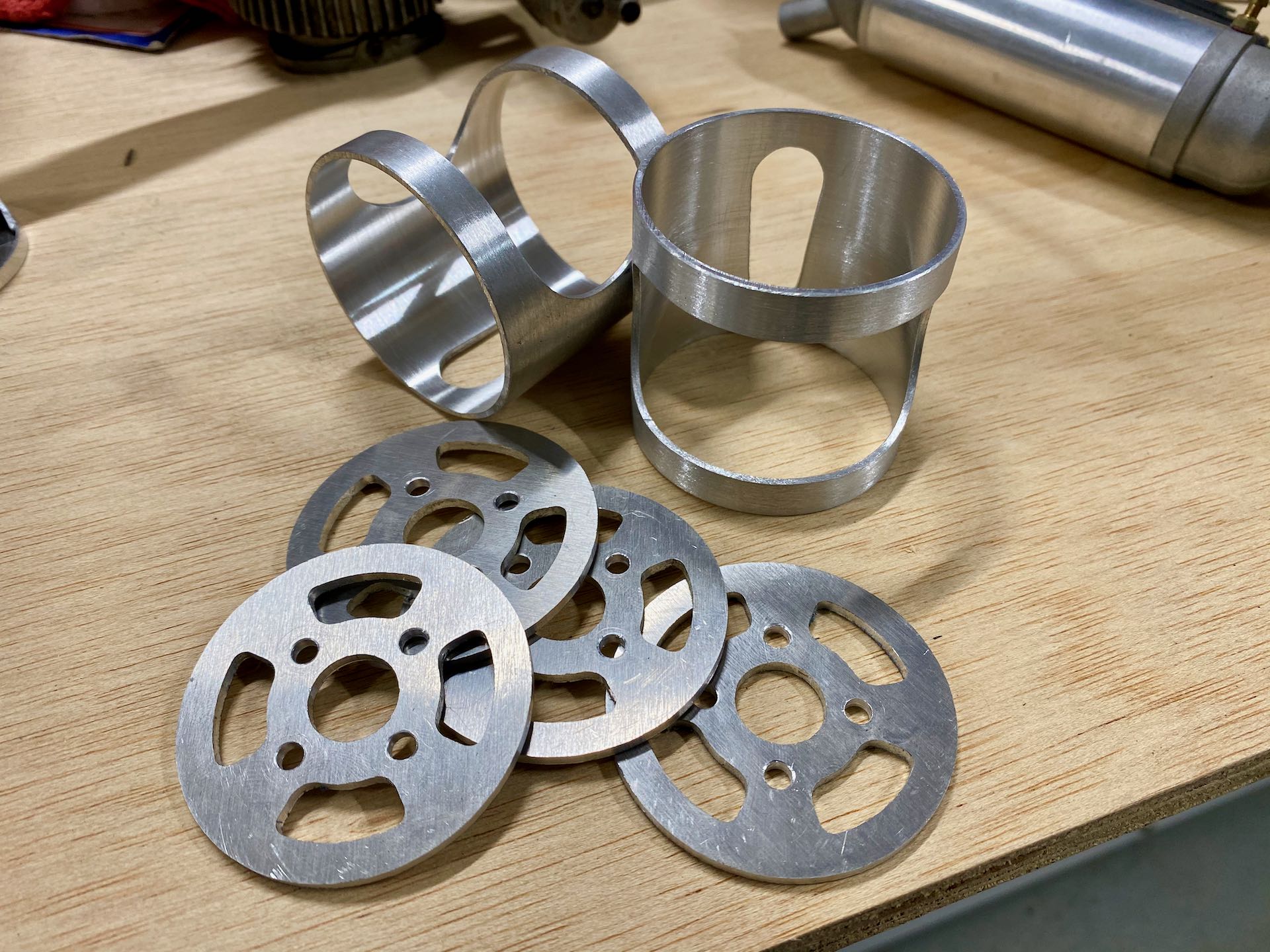

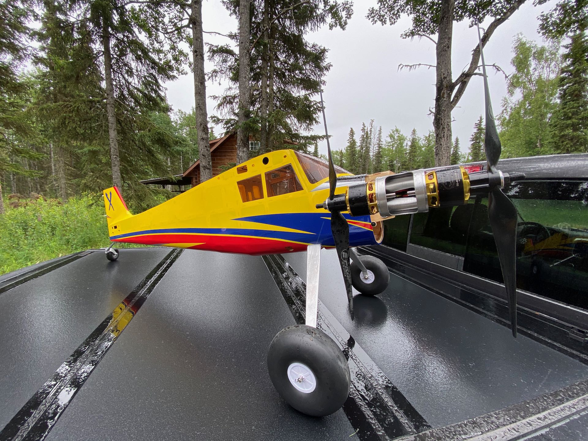

Success! I threw together a quick test stand out of some wood scraps, door hinge, and a luggage scale. The setup runs smooth. I'm getting around 13lbs static on a single motor, 23-24lbs on the pair inline. The Twinber is now Timber XL-4!I'll start building the quad motor mount tomorrow.
