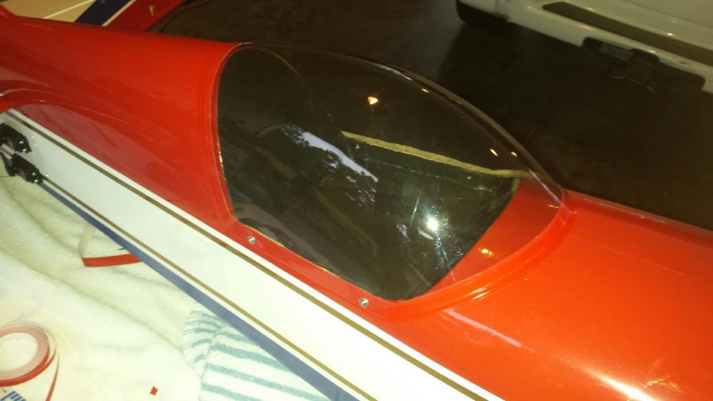

Doing some finishing touches on my Ultimate. Working on the canopy and since I like to have access to the cockpit I decided to use the supplied screw set and use automotive pin striping to seal up the canopy. Never have been a fan of using canopy glue.:p Was lucky to fine some red striping that matches real close.:)

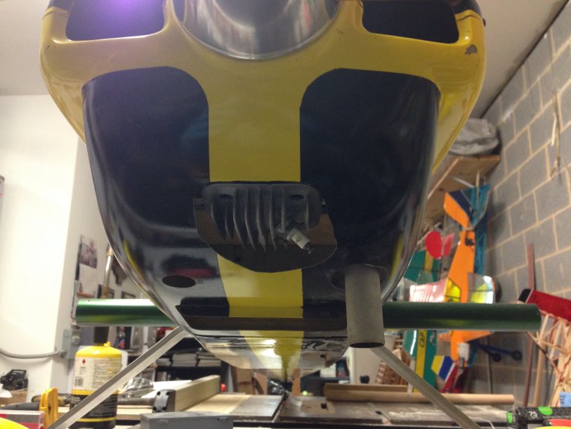

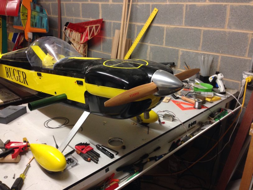

Cowl cut and fit around the engine and it fits pretty damn good. Nice gap between the spinner back plate and the cowl. I'm happy. Now I got it all pulled off and a layer of epoxy has been spread onto the firewall to protect it from fuel. Tomorrow morning I should be able to permantely install the motor and start figuring out ignition and battery placement.
