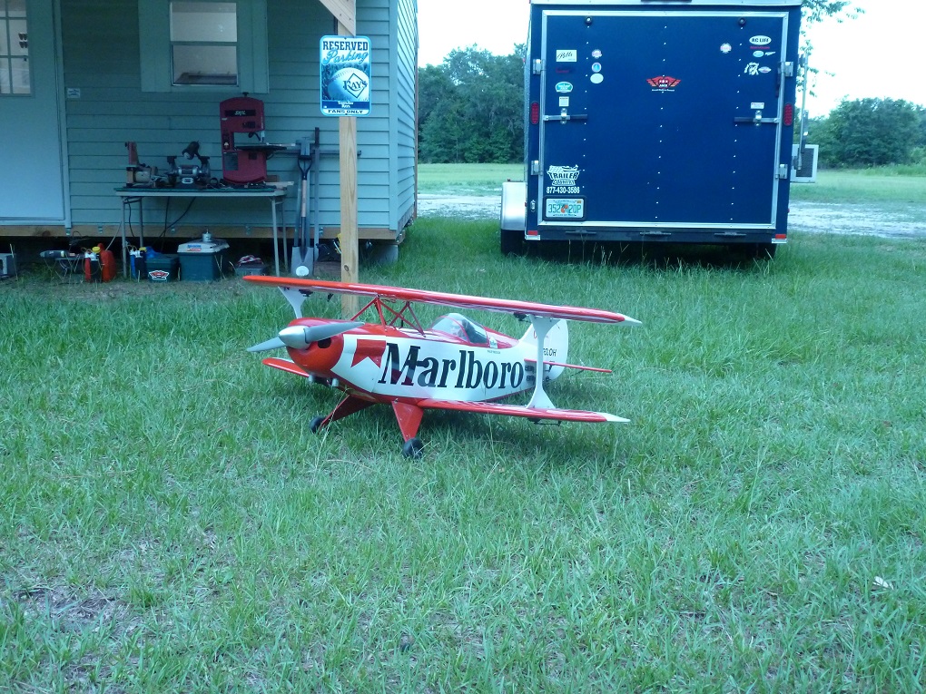

Today I replaced the motor mounts and prop hub on the Marlboro Pitts, the bolts were loose and the hub had a hair line crack.
The prop hub what made you look at it and why would it crack , never seen that happen, loose bolts all to often.
acerc
The bolts were a local purchase and apparently not a high grade. I have no idea why the hub cracked, maybe to tight on the prop bolt. I catch these issues because I go through everything on each airframe every January but I also give things a good look and tug before packing up nearly every time out, have saved many airframes by catching things early.

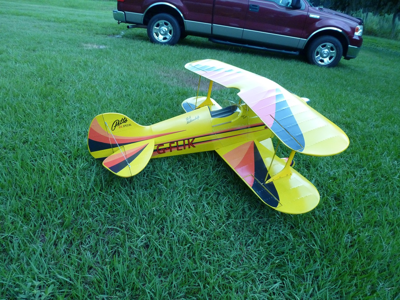

This evening I will be installing a new 60cc twin on the yellow Pitts. The previous one got pulled quite some time ago to go into a Yak.
