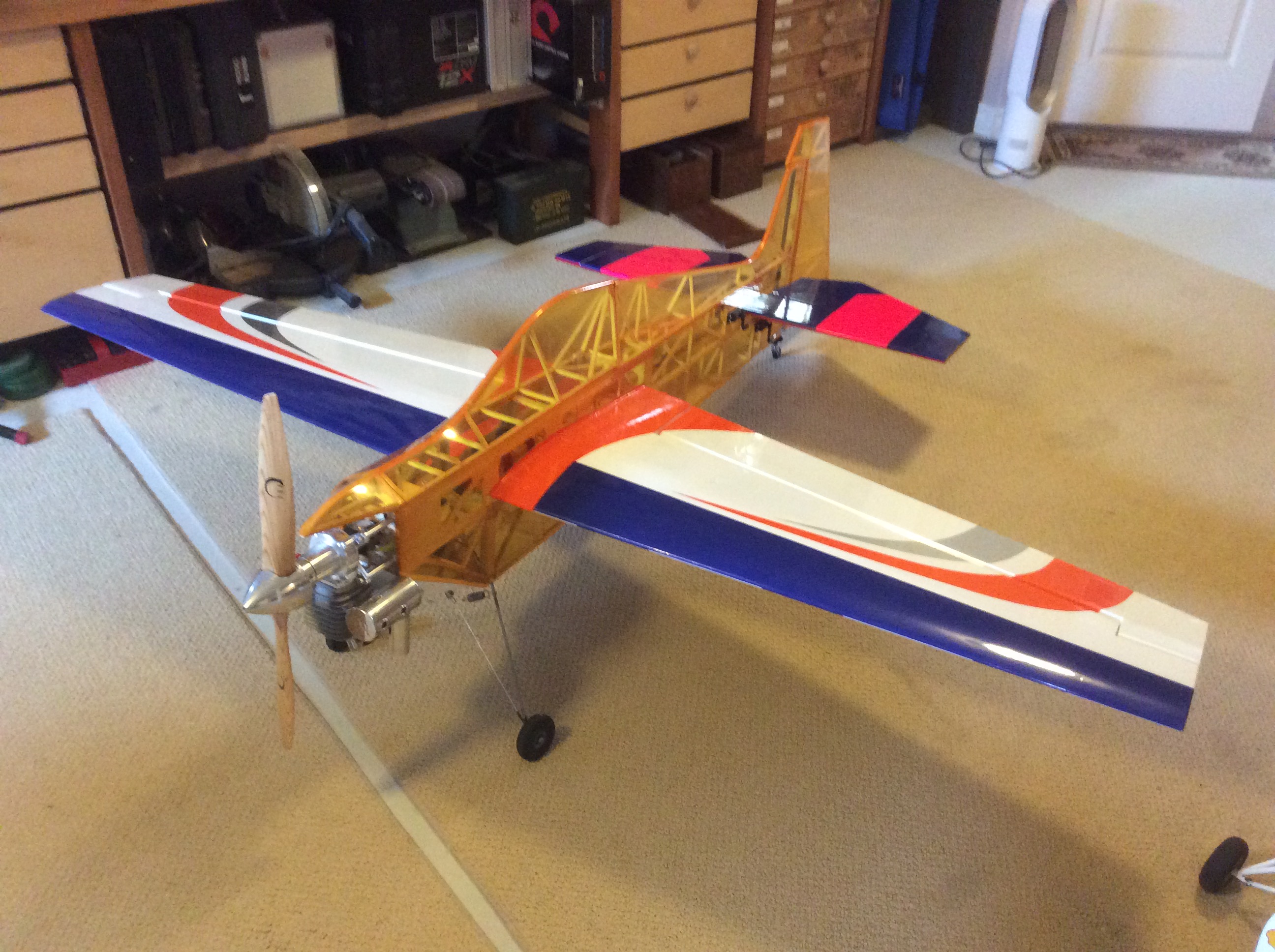

OOk it is almost done just some minor cleanup and a lot of blue loctite. The radio needs to be set up and need to buy a reviewer or just wait awhile for a new radio will see what happens.
And the wheels have been enlarged  to 3 inch diameter thanks for the help on finding the light wheels.
Ok when I started out I had some goals for the plane and it was to build a pure 3D machine to help teach me to do 3D.
So the end result is as follows which I am pleased about.
1. 50cc 3D machine that comes close to the performance of a profile plane.
2. Wing span 83 inches
3. Long 79 inches
4. Weight 12 lbs 5 oz  no fuel
5. Wing cube loading 7.25
6. Power ratio 326 watts per pound.
Must thanks all the people at GSN for all their support on the build and suggestions.
