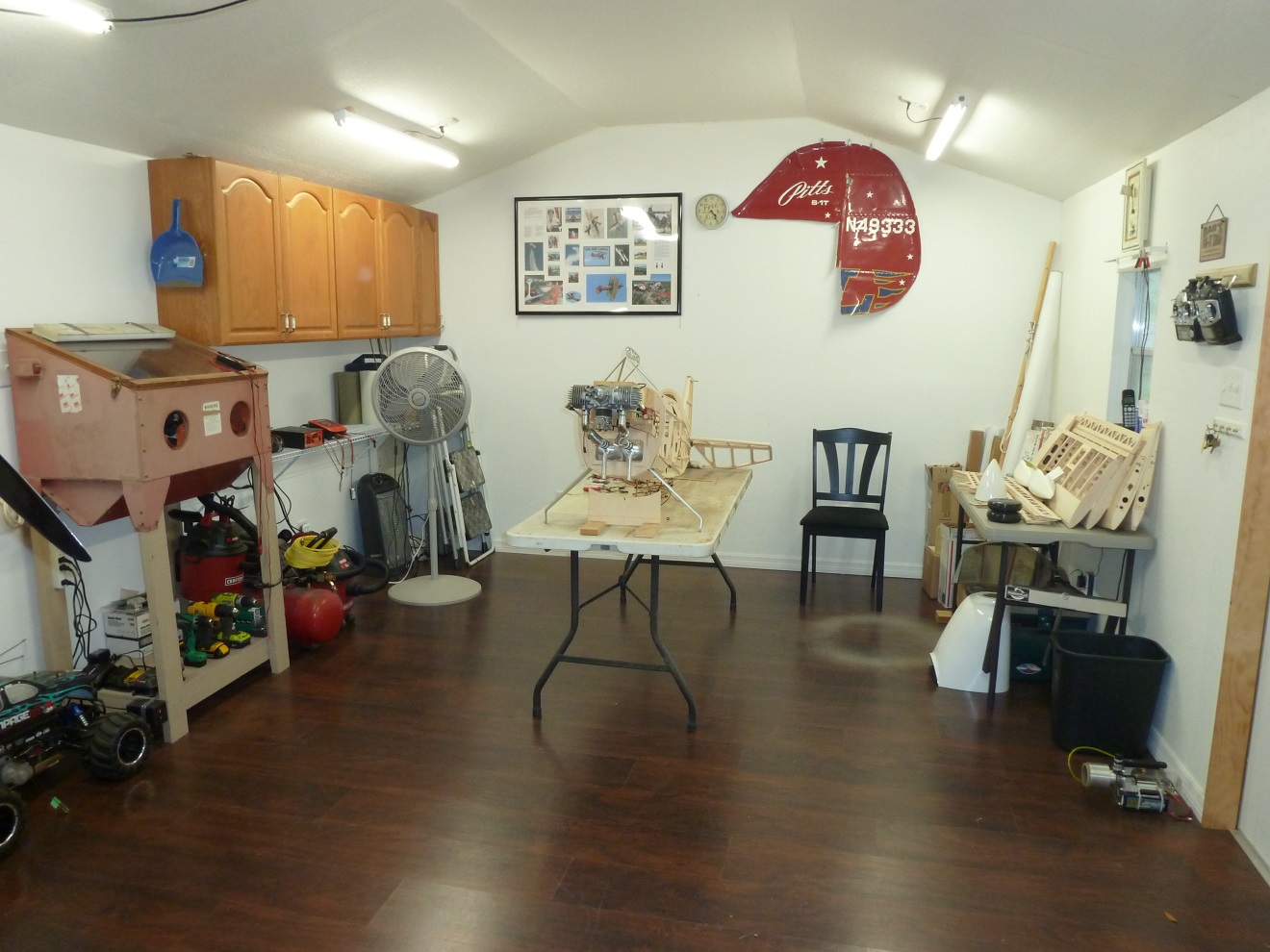

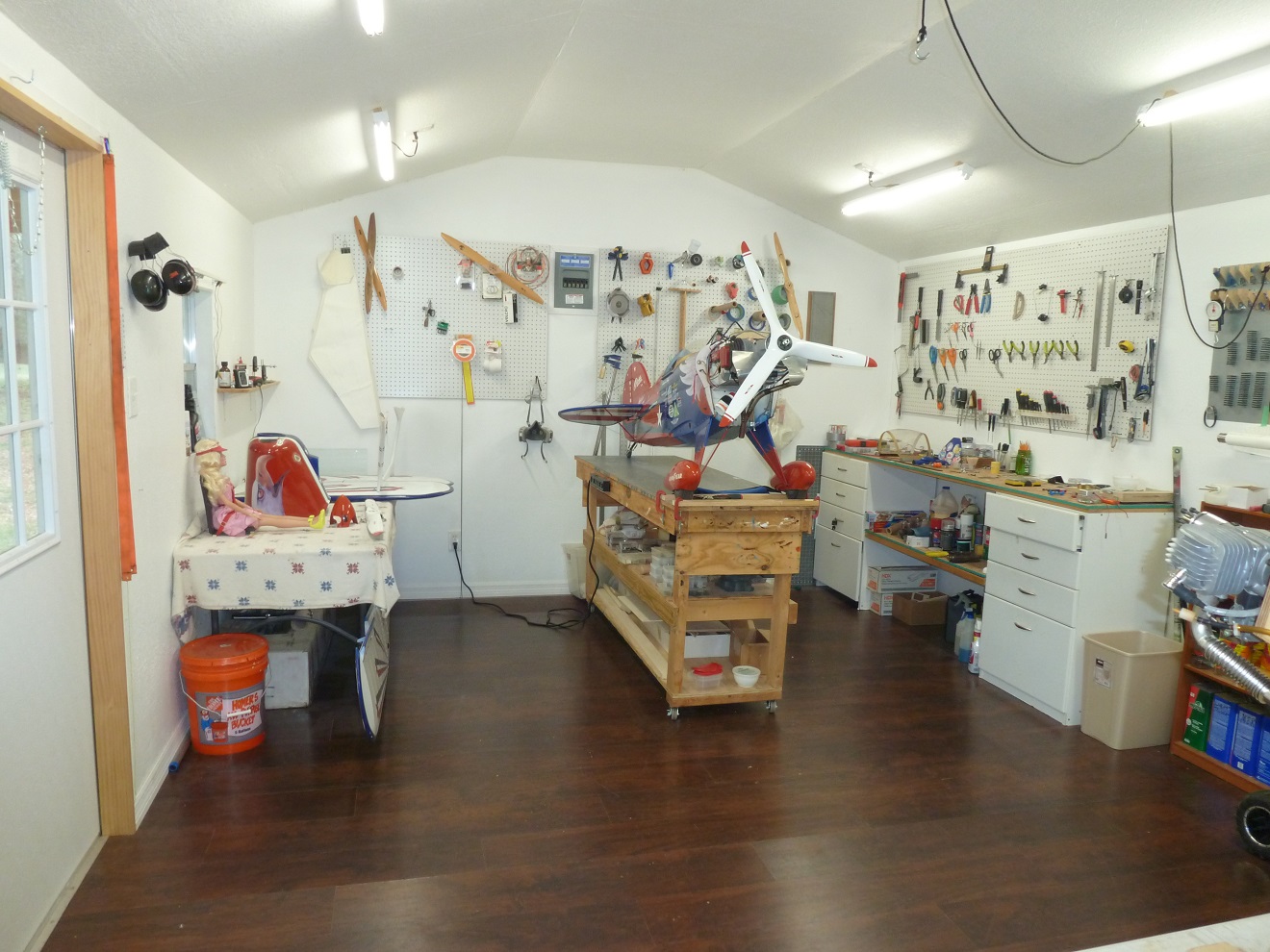

After some coaxing from the wife I decided to clear the shop of my desk, and associated items, and move them into one of the extra bedrooms of the house. I have actually thinking about doing this for some time but been to bloody busy. So here is a before and after of that end of the shop. Really opened it up for building!
When I do things like and it is all done I always stand back a say to myself I should have done this ages ago.

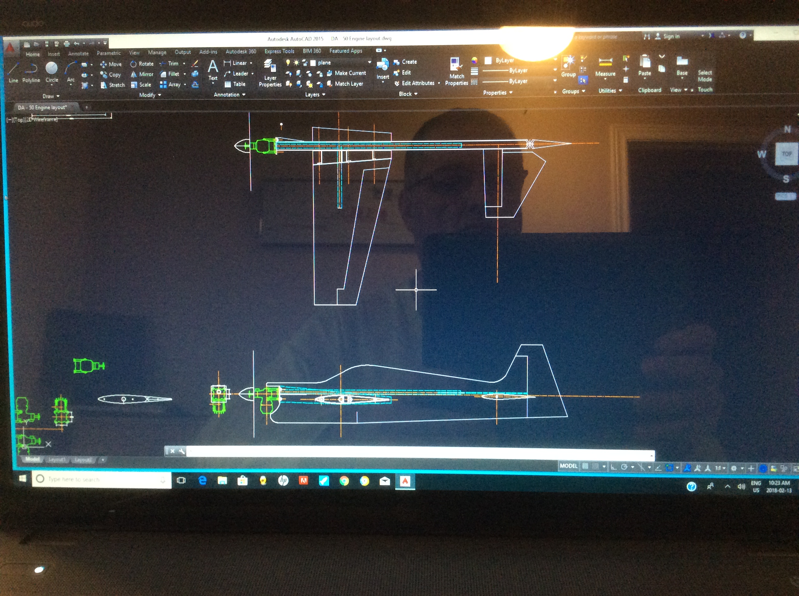

Well boys started something and just trying to build a 50 cc profile. This is what happens when all your projects are done and you are sitting in your work shop looking around. Well this started about a year ago. Bought a 50cc ARF started to look at it and did some minor assembly, it just looked to big and heavy. So I put everything together and put it on a scale and that was with all the little stuff and came in at 17 lbs 10 oz. then measured up the wing and came to 1345 square inches. So from there did some number crunching and WCL came out 9.8 so with few bits and pieces it would pass a WCL OF 10. So at that point I just put it away and never looked at it again. But this week I pulled out the wings and thought that I would see if I can draw up profile plane around the wings. My goal is to have WCL of 8.5 and weight of less than 14 lbs sitting on the runway ready to take off. The engine will be a DA50 with a stock muffler.
This what I have up to now. Any help and assistance will be greatly appreciate. By the way the wing is 10 % aerofoil and max thickness is at 30%.

Look's as if you are on your way to a great profile. Git-er-Done!!!

I have done all I wanted with the shop. I think it is far better and much more organized now. I emptied the cabinets, 90% went into the dumpster, and used them more appropriately for tools and the such. Hung the radio rack, hung the original full scale tail covering. Can everyone tell I am a Pitts fan boy!!! LOL...

You sure did a lot! That plane went a long ways in the building ;)
You a Pitts Guy!? .......:yesss:.
Shop looks great. Nice and bright and plenty of elbow room :attaboy:.
