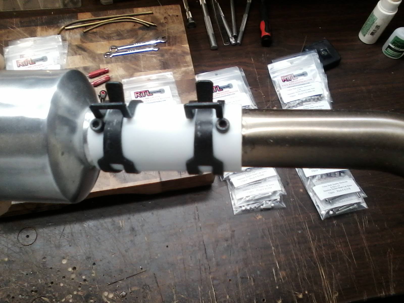

Nicely done. BTW, those of you that run canisters, do you put screws in to keep them on? I can heat the plastic piece, put the clamp on and still comes loose. I put a screw in one of my DA 120 cans and now I think I am going to do the same with a proflow can. What is the best way?
I run a short socket head servo screw right in the gap in the middle of the clamp. Works like a charm.

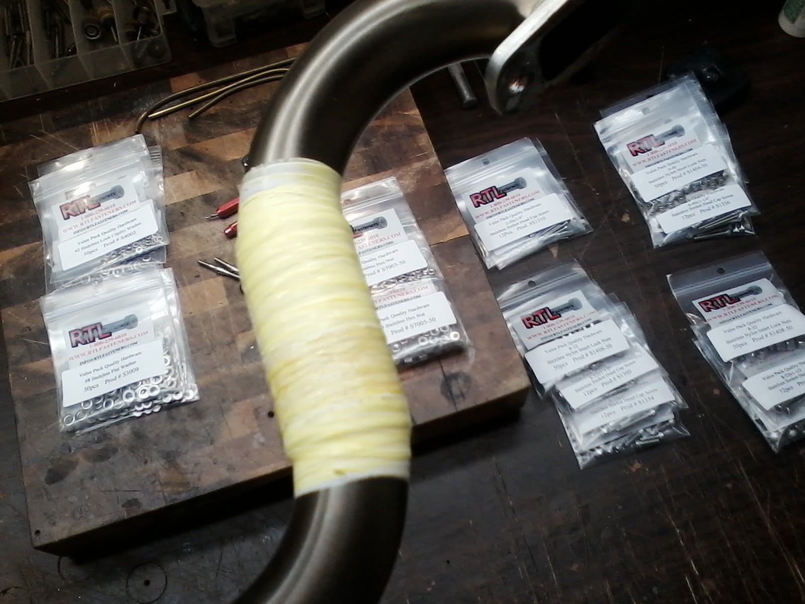

I sorta do the same thing ;). But I drilled and tapped 4-40 socket head. I also put a light coat of shellac to seal the Teflon coupler to the header and canister. On the MTW flex headers I also give it 4 good wraps of yellow Teflon tape. Zero leakage. This one shown has had about 20 flights before I pulled it off the "old" DL50. It is going back on the "new" DL50 :).

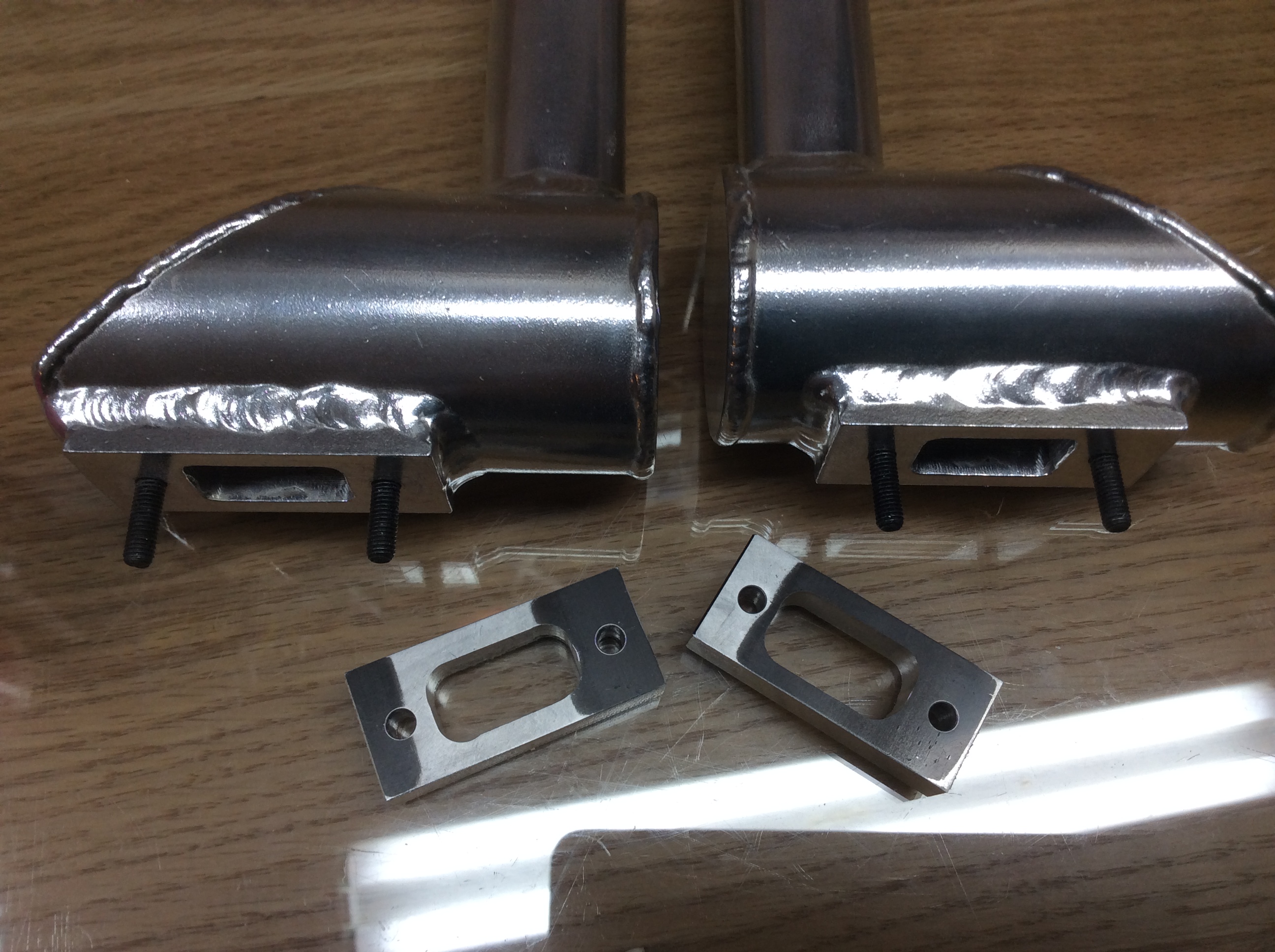

Got the second 1/2 inch spacer made and it took quite a bit less time always with the second one but it looks good fitted the exhausts on with the spacers and it works cleares the motor box by at least 3/32. Just have to make a hole for the throttle servo and get it mounted in the motor box.
