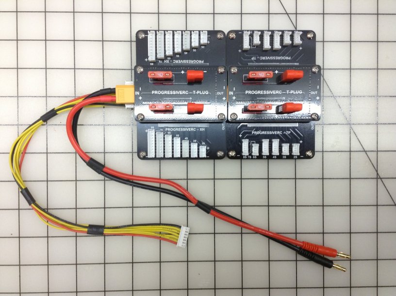

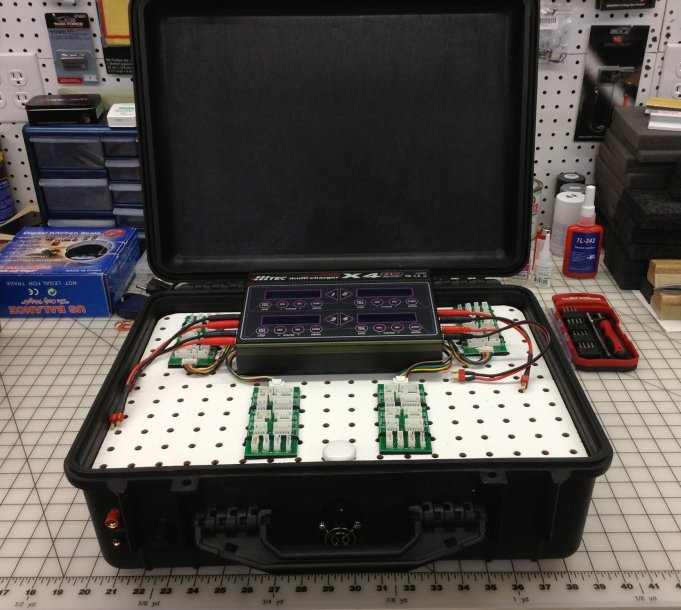

Got started on my charge case upgrade today. Didn't make as much progress as I hoped. Took a little longer to install the new power supply than I had planned. But that's okay because I'm still thinking on how I want to arrange the chargers, balance boards and parallel boards.

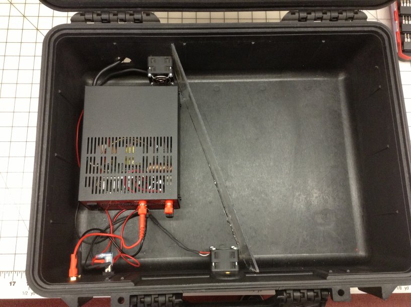

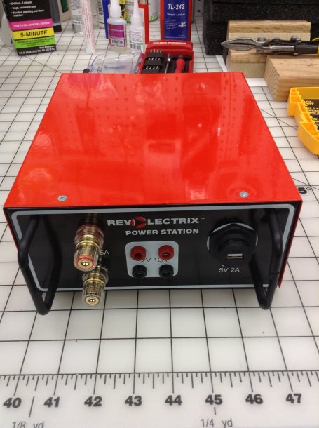

Here's my old setup before I got started.

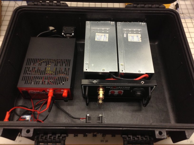

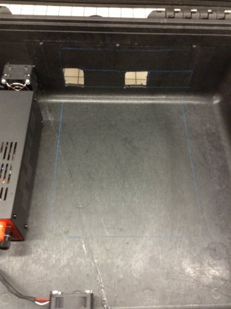

First thing I had to do was remove the divider in the bottom of the case. It was separating the old power supply from the storage area.

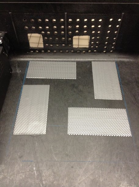

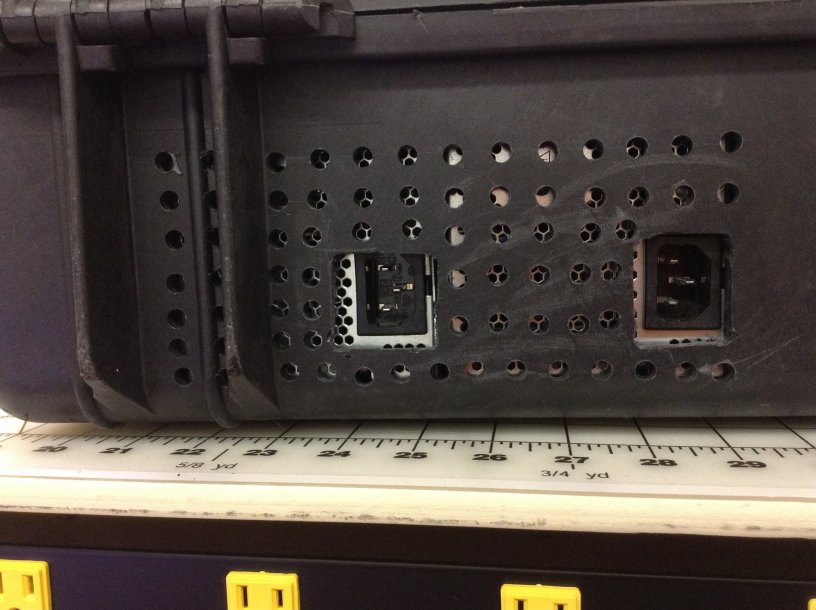

Then I laid out the area for the new 24V power supply and cut a couple holes for the power plugs.
Then I drilled a bunch of holes for ventilation. And applied some Velcro Industrial Extreme to hold the power supply in place.
