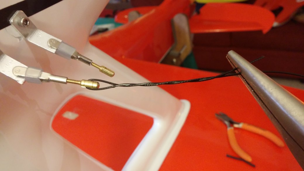

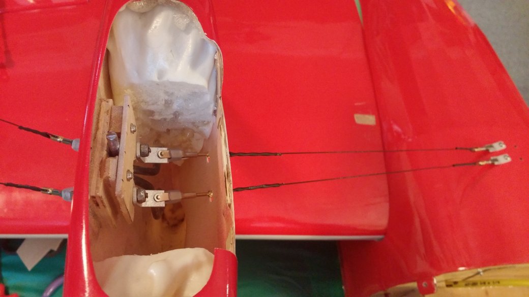

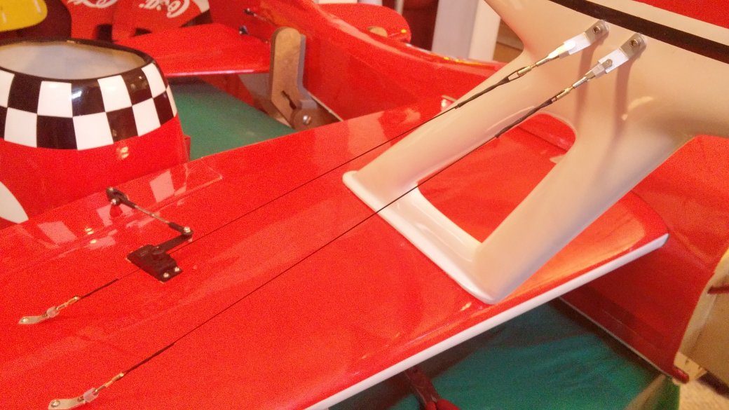

Landing gear & pants mounted. Flying wires done. Almost done!
Learned a new trick for pull-pull/flying wires. If using nylon coated wire, loop it thru, twist it a few times and hold a lighter under it. The nylon melts and fuses together. Then you just put heat-shrink over it. Jesky said he's done that for a long time and it's never slipped. Heck of a lot easier & faster than using crimps!

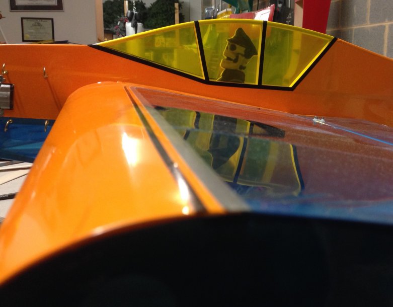

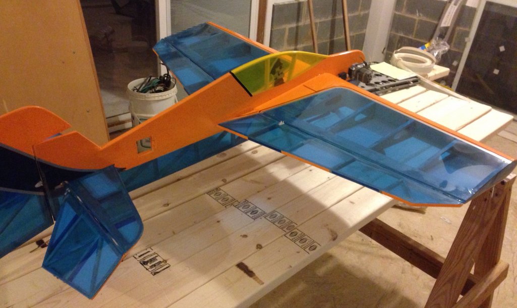

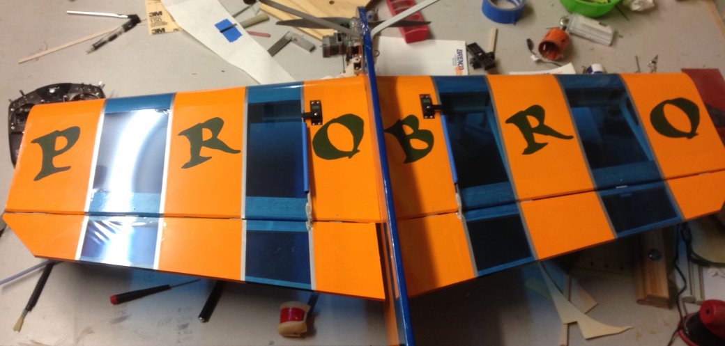

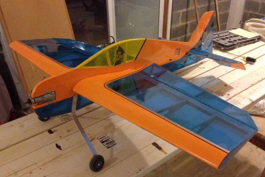

Finally rebuilt my sbach45 after its dreadful mainden flight. Just need to make up extensions for the new tail servos, install the tank, and get a new pressure tap for the header (I kinda sorta broke the other one installing it in the new header).
