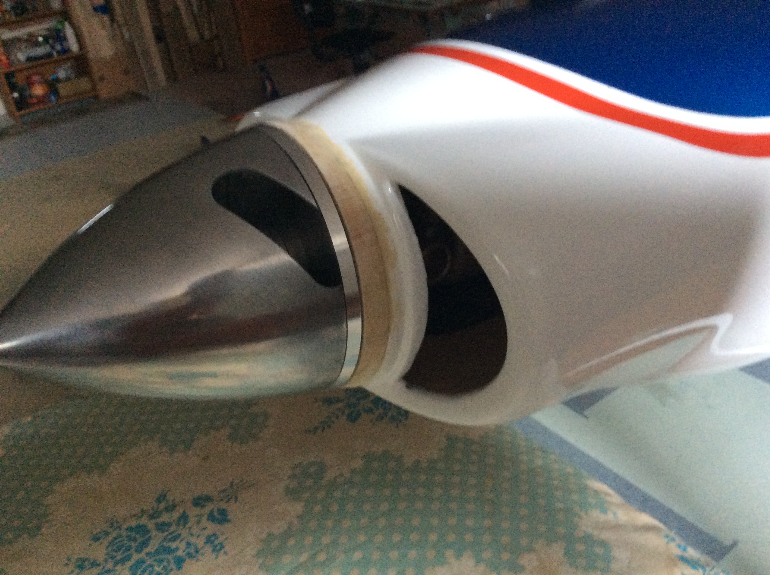

Got rid of the gap took it took a bit of work but I just cannot stand big or angled gaps between the spinner and cowl. So added 6 mm of balsa to the cowl and then sanded it parallel to the spinner. It will look okay once it is finish sanded and painted.

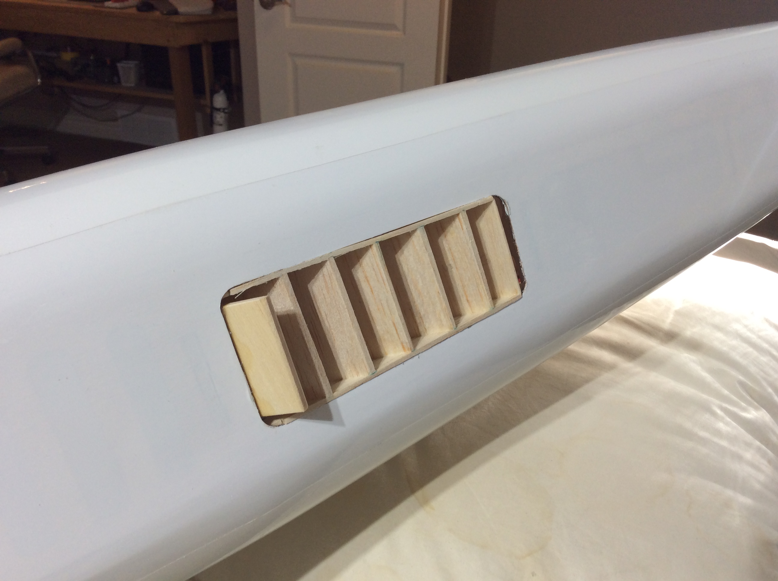

Cut a hole into the bottom of the fuselage so that I can add in some louvers to extract the hot air from the engine out through the bottom of the fuselage. Hopefully this will be good enough so that I do not need to cut an opening in the cowl. Just need to clean it up and do a little painting and it should look ok.

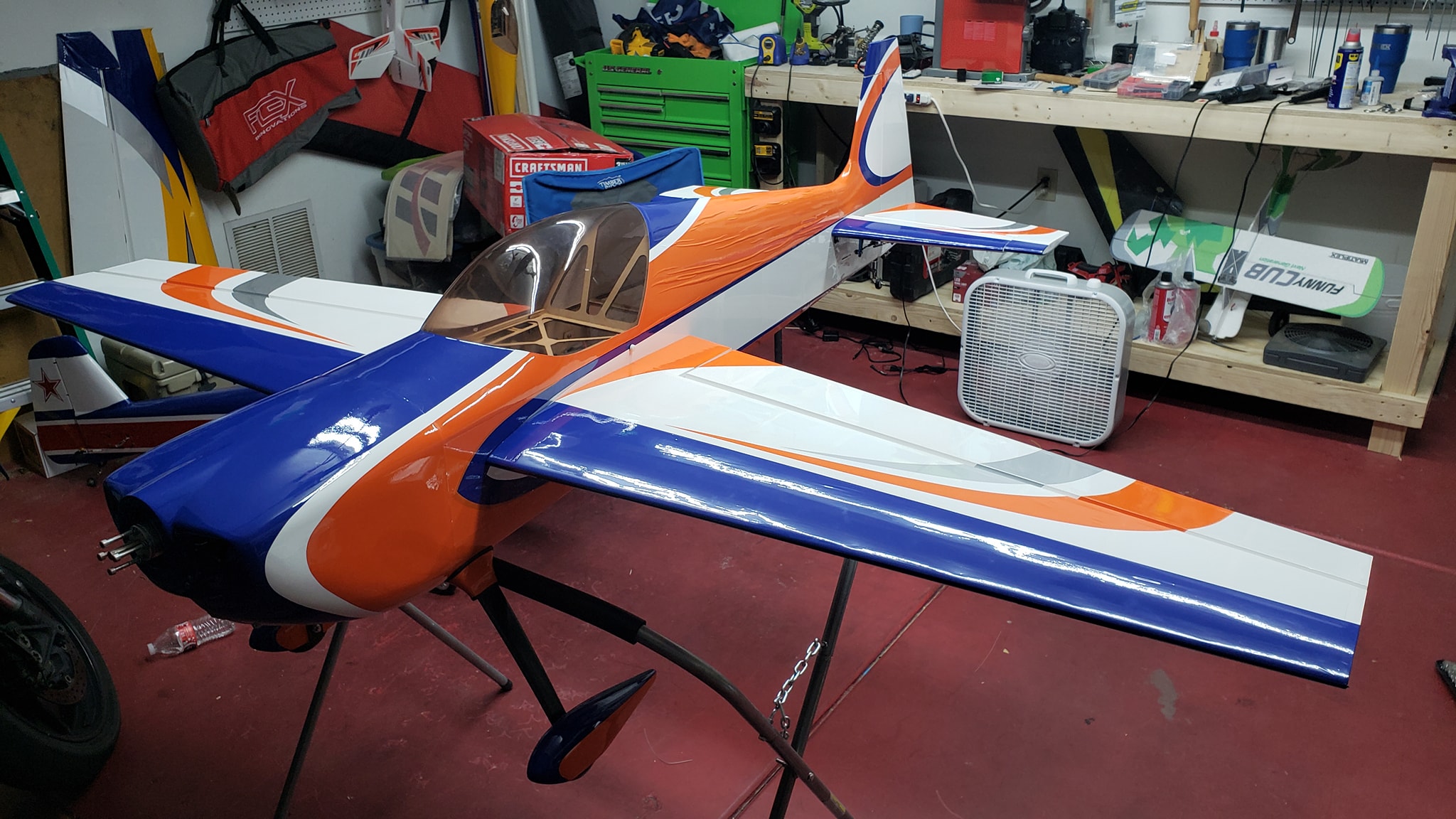

Finishing up an AJ ARS 300 86" . DLE55 on tap with a 23x8 Falcon, Hitec HSB-9381TH servos.
View attachment 115907 View attachment 115908
Few more odds and ends to complete, but we're almost there. Waiting on a nice JTEC wrap around muffler.
Almost pulled the trigger on this guy a year ago, decided to go a bit bigger. Holy wrinkles batman on the turtle deck! Got a bit of ironing to do. They sure do make a good airframe over at AJ.

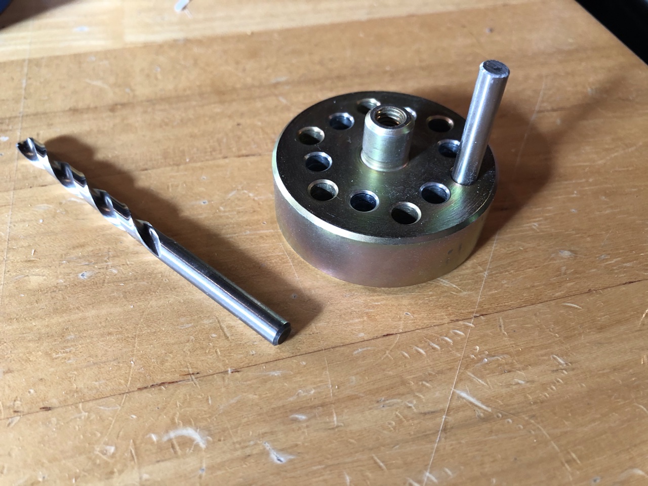

Played with a few recently acquired tools. Amazing how the right one makes the job so much easier!

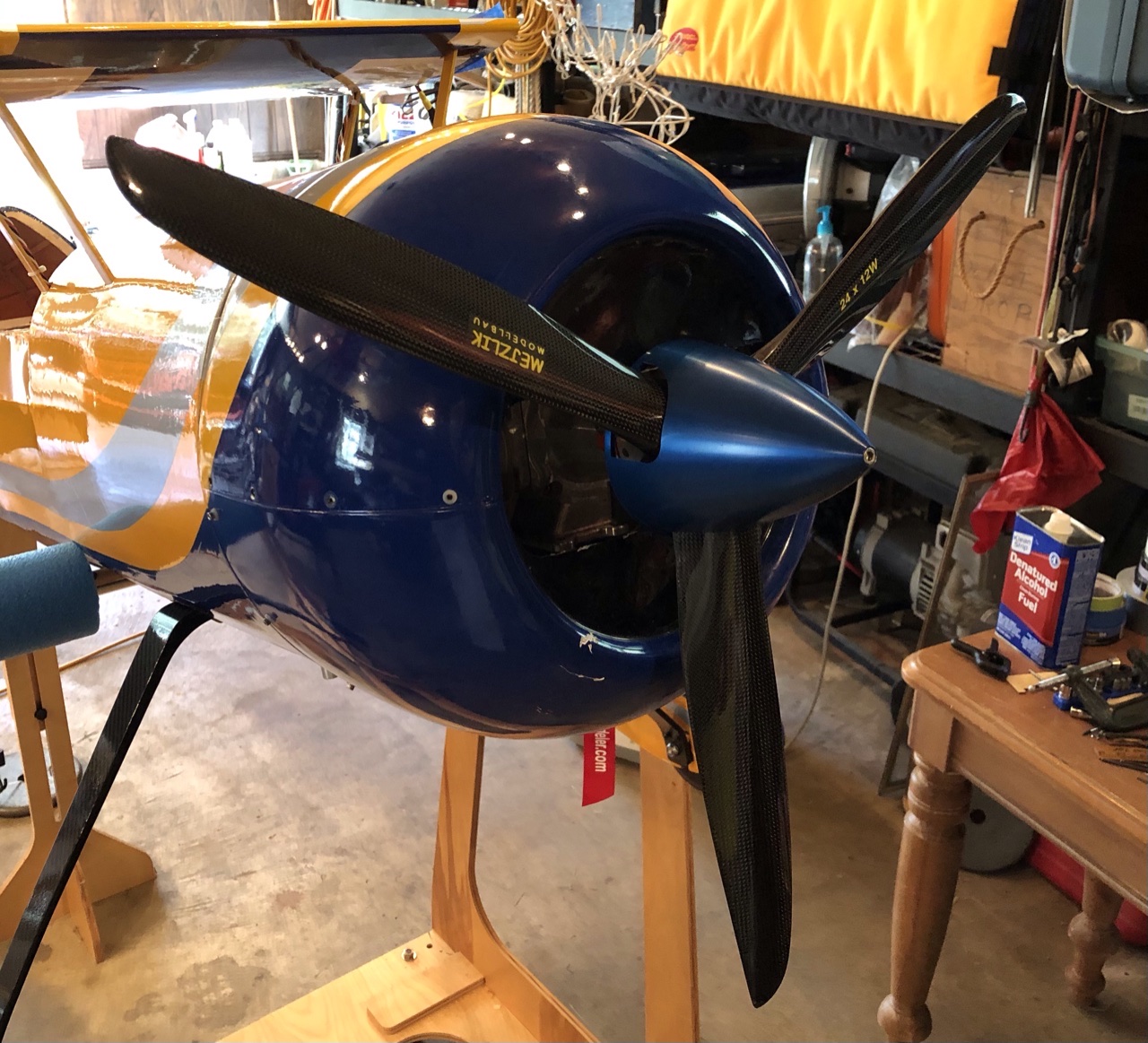

With the high quality jig from Desert Aircraft, I finally drilled the propeller and spinner which came from @stangflyer a while ago.
