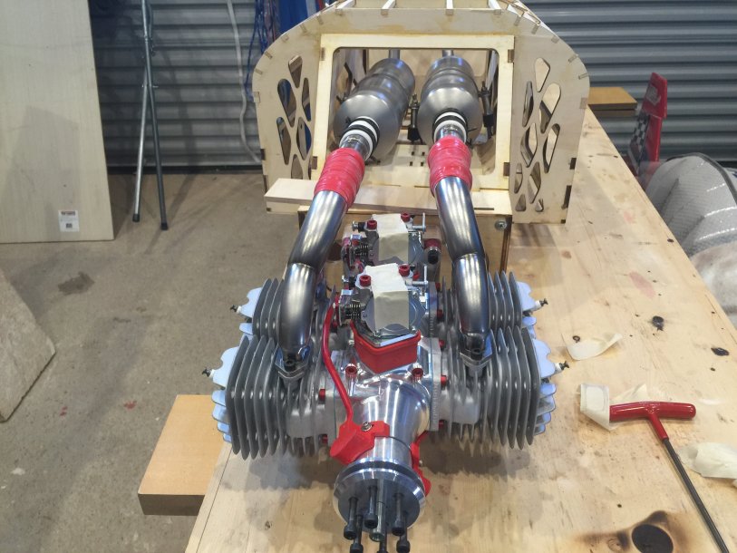

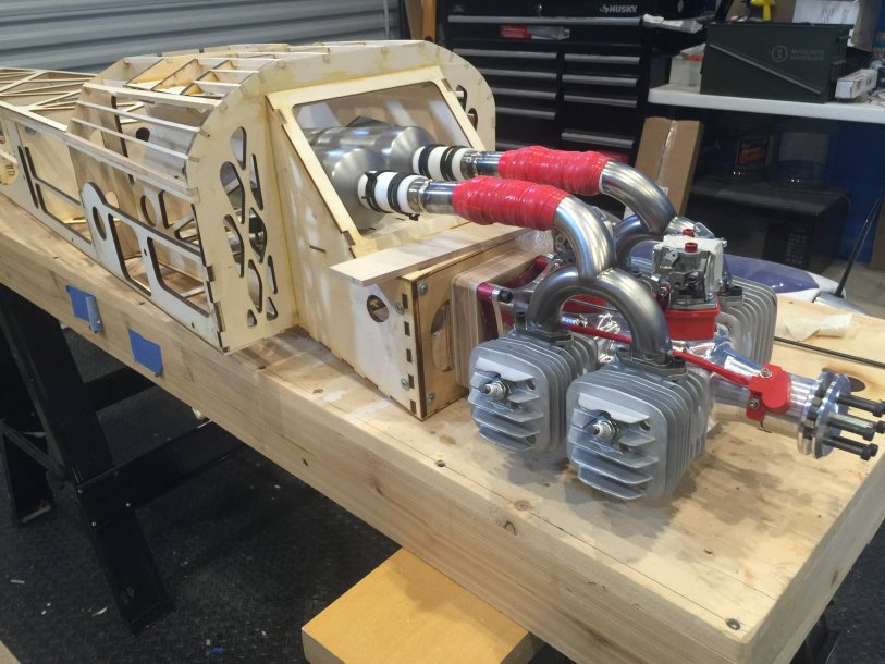

Thank you Primo.  I got the canisters mounted in.  All i need to do is install the FSS, landing gear blind nuts, and a radio tray/battery tray, and then I will be able to sheet the fuselage sides.  I will also start working on the tail wheel installation tomorrow.

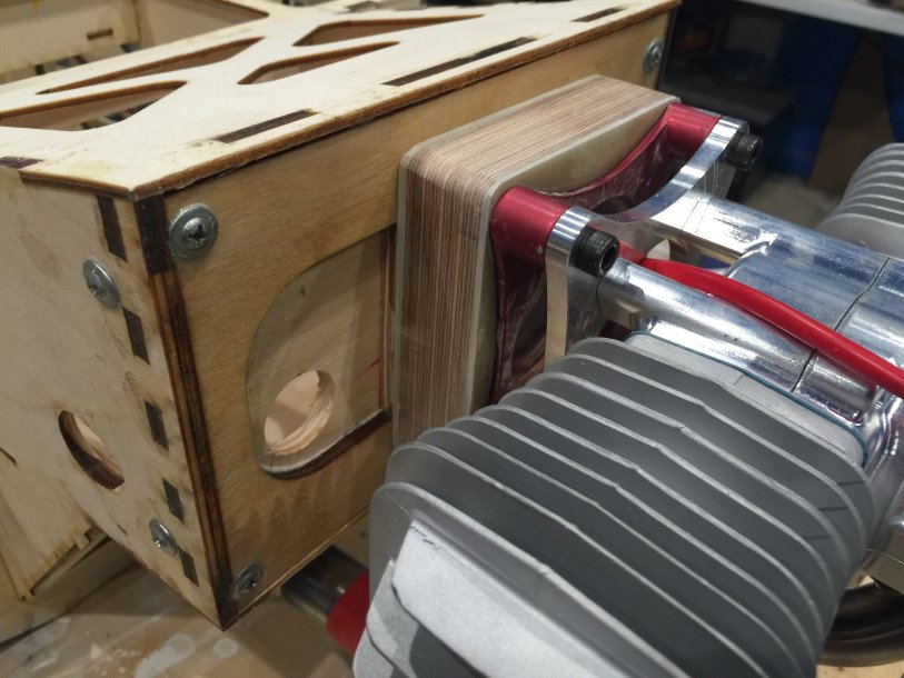

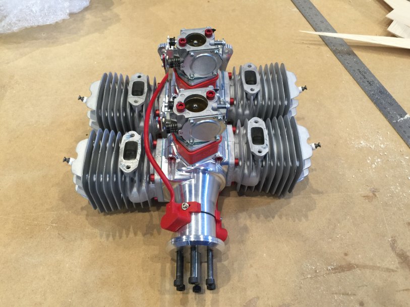

I will drill some holes on the motor mount, to help reduce the weight.  Hoping to get one to two ounces out.

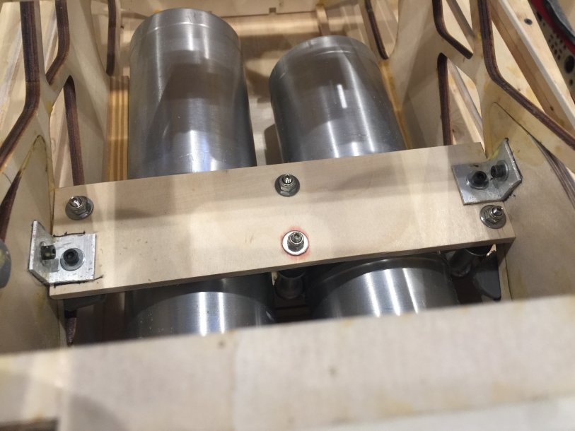

Plenty of room around the canisters for air to circulate thru.  The biggest advantage of using the Comfort mounts.  However, a real PITA to install.

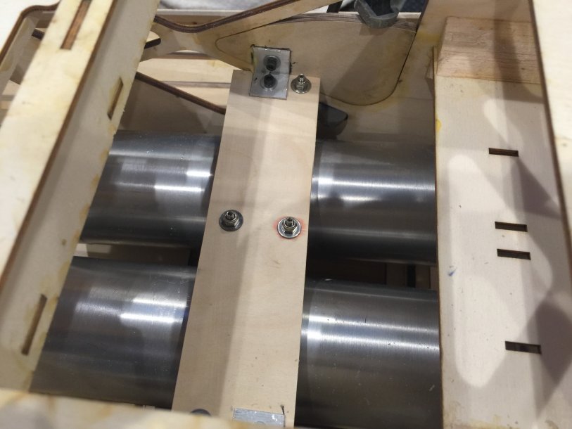

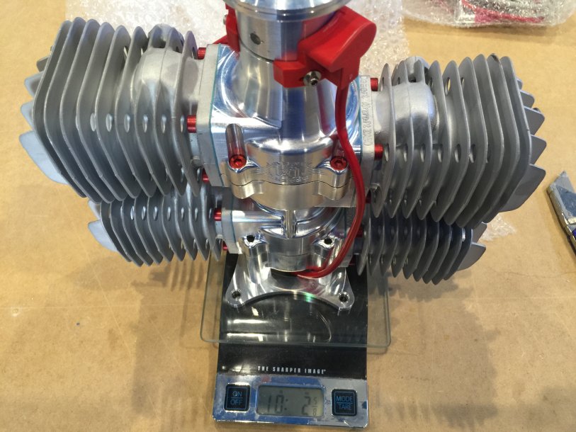

This was by far the easiest installation for me yet. This is the 5th time I install canisters with comfort mounts, and this was the easiest way.  Especially since the fuselage sides are not sheeted yet.  I made these "fillers" out of the 1/4" thick Finnish plywood, and this will provide support for the canister mounting plate.

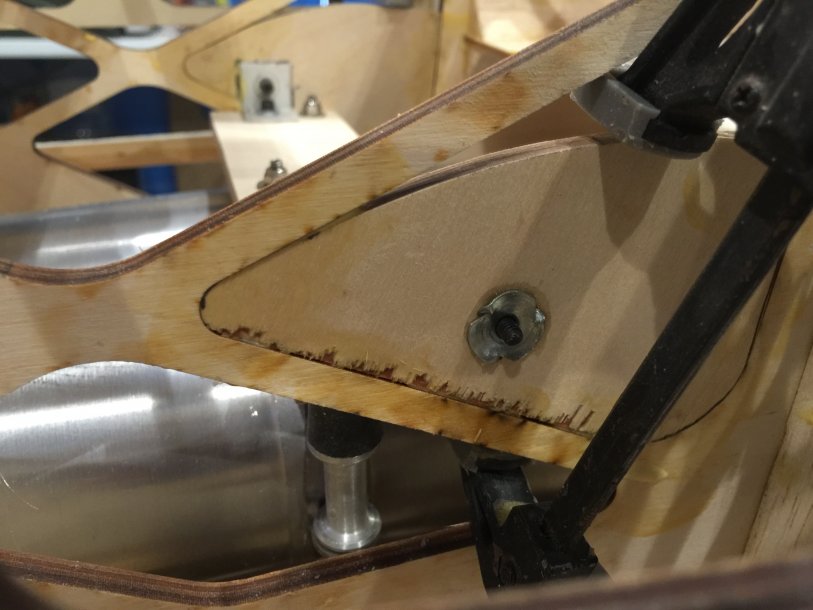

Here is the blind nut on the opposite side.  This will make for easy removal, if maintenance is required.

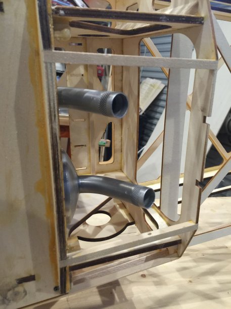

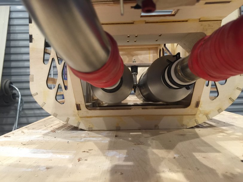

Here is my favorite, plenty of room for air to escape around the canisters.  Tony did Good with this new design.  Very canister friendly.
