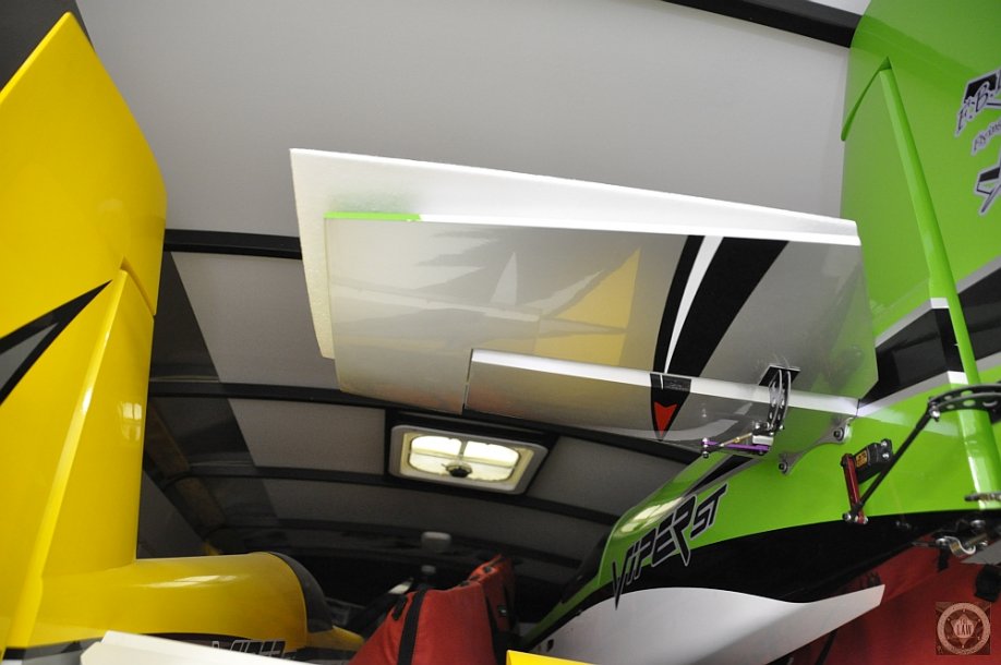

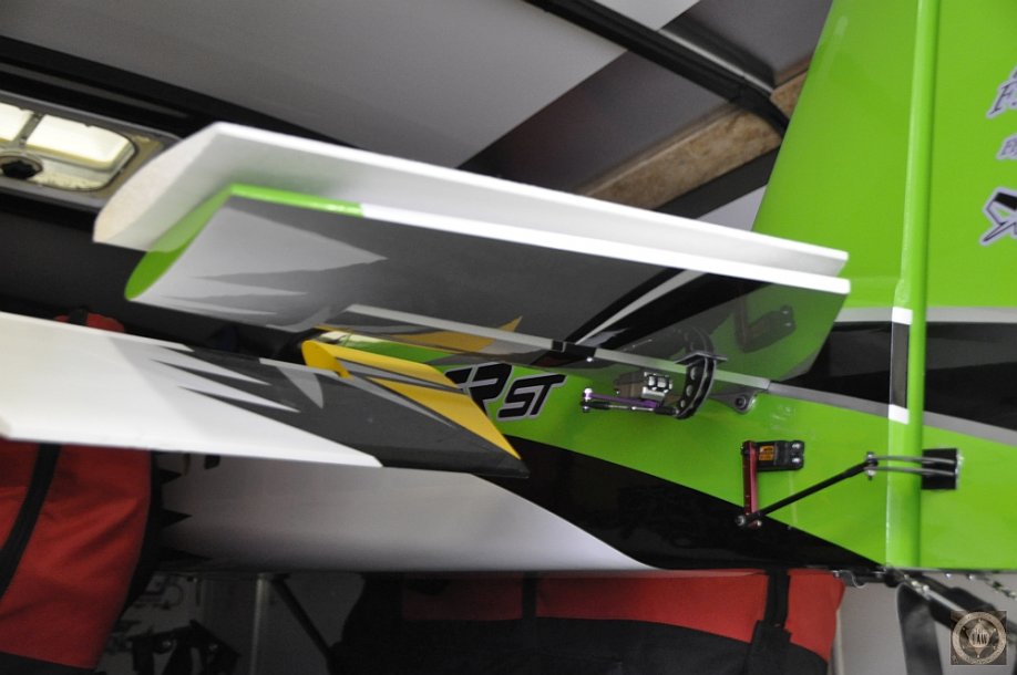

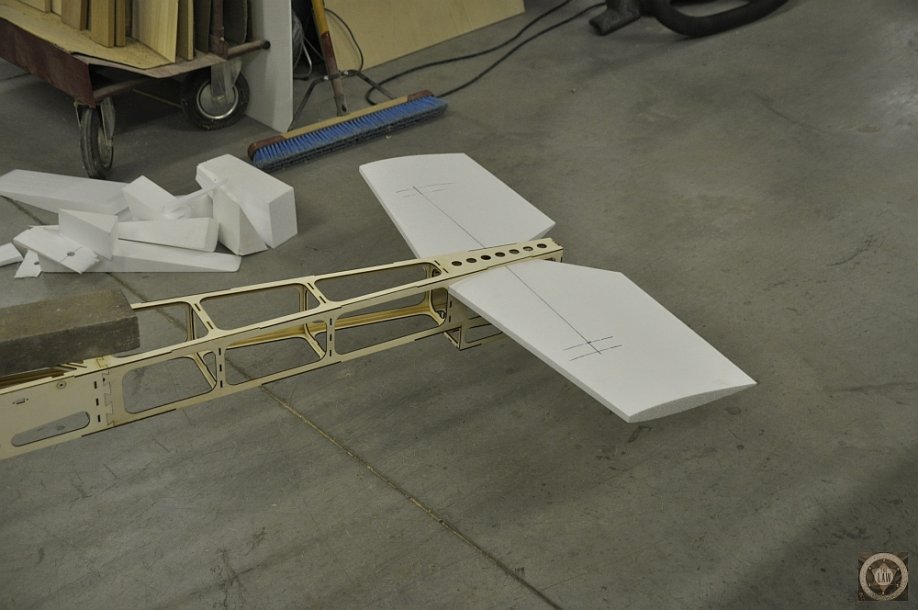

Not much done today. We cut some foam for the first test run of the stabs and they look fantastic. This plane will be IMAC legal but you have to remember that I'm a 3D guy so they are sized and placed for a good mix. These stabs are actually 1" wider than the Viper and with the straight trailing edge they are VERY effective. I am obviously going to do mine set up for 50 degrees of throw.

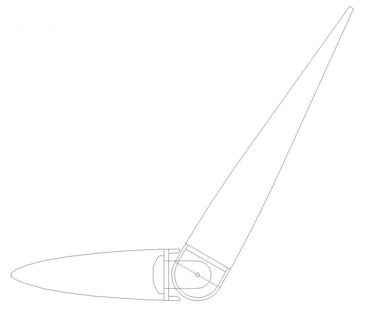

Well I've been playing with this idea for a while and this morning I was doing some sketching on a way to do pocket style hinging. The kits for the MX will obviously be laid out for standard hinging but I want to do a full working test of the pocket hinging as well. There are obviously the guy's that will come in and say "they get sloppy" and "they are less effective". There is also some theory that the air separates from the top side of the downward facing aileron in high rates roll creating an adverse yaw effect.
All those things can be addressed with the proper design (even the parts that are not really true);)
So, we cut an extra stab, and it's going in the vacuum bag in a very short while to build a construction, function and destruction test model.
