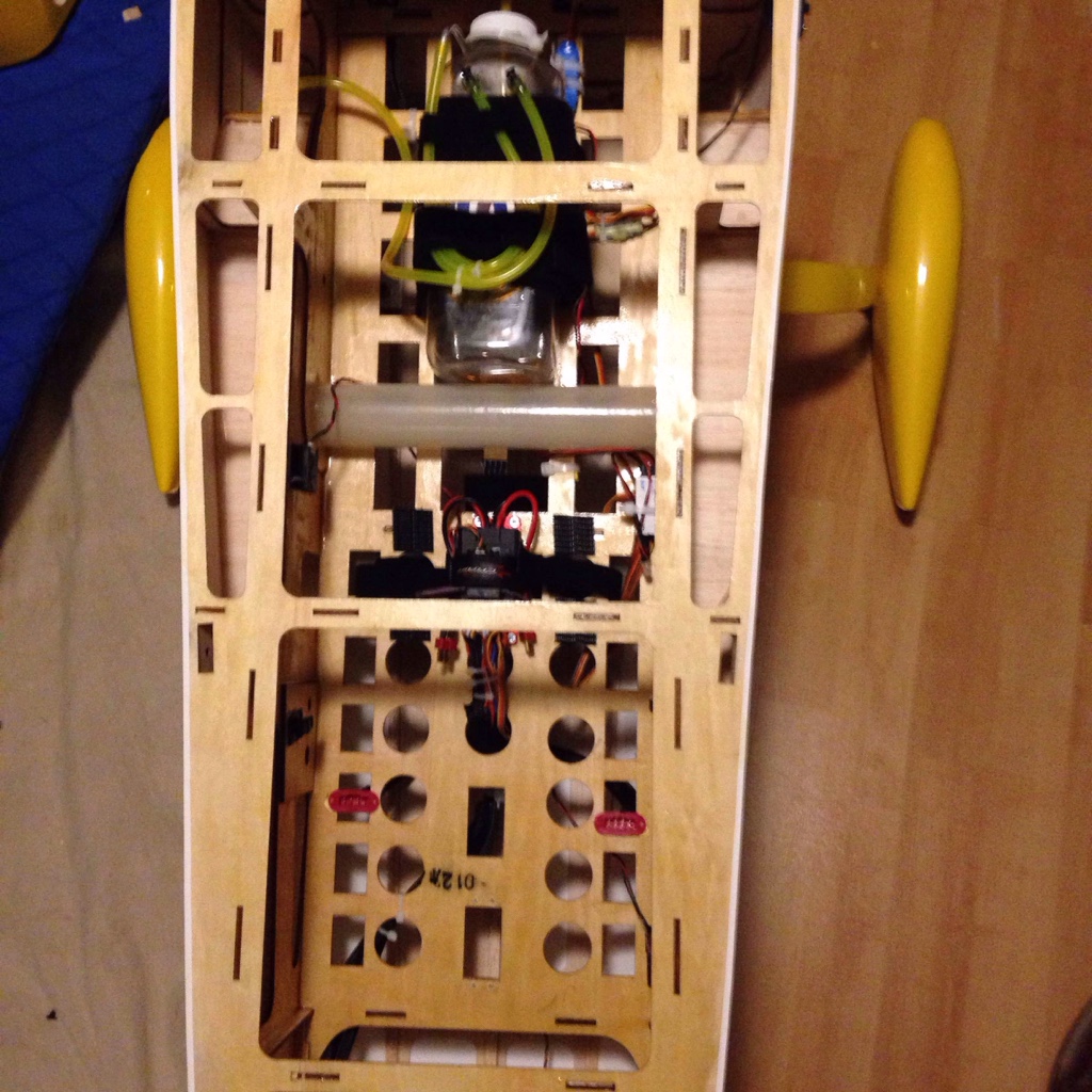

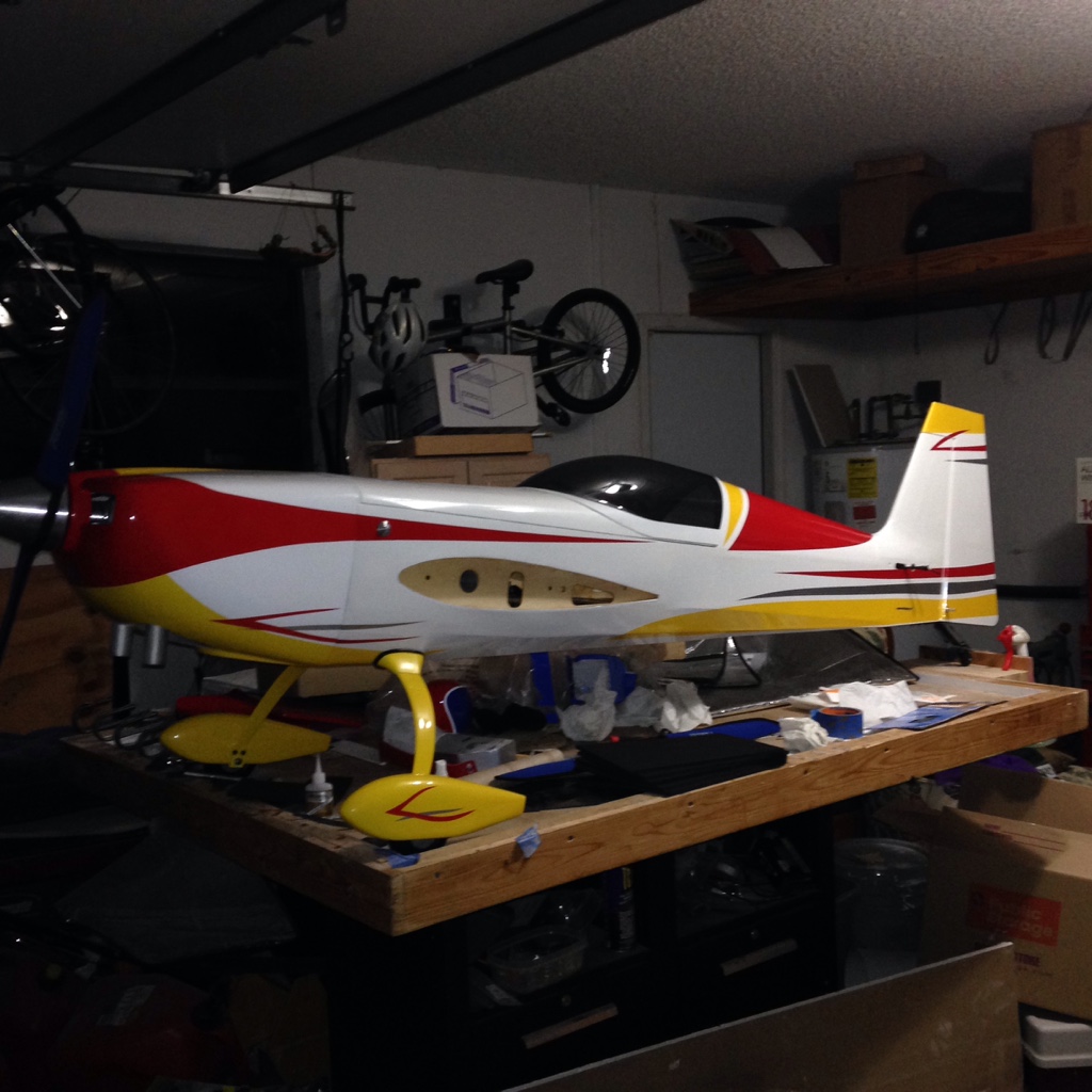

Just finished building this...
Can't wait to get some flights in!
AKfreak
That baby is Nice, and after seeing Spencer and Gabby wring it out, I know it is a great flying plane. I hope she serves you well bro. Dont forget to post some videos of that girl.

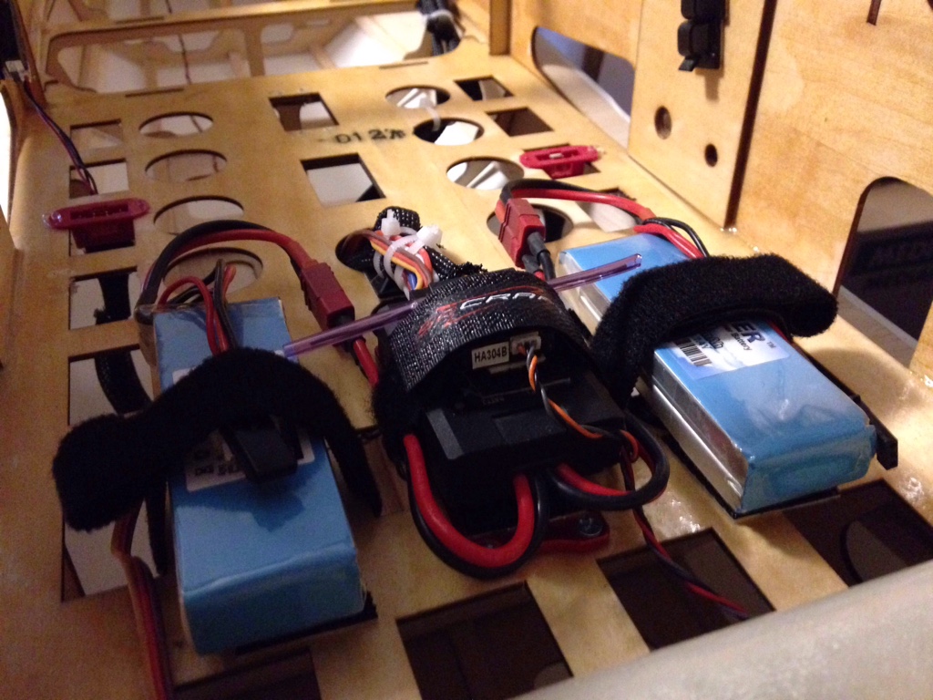

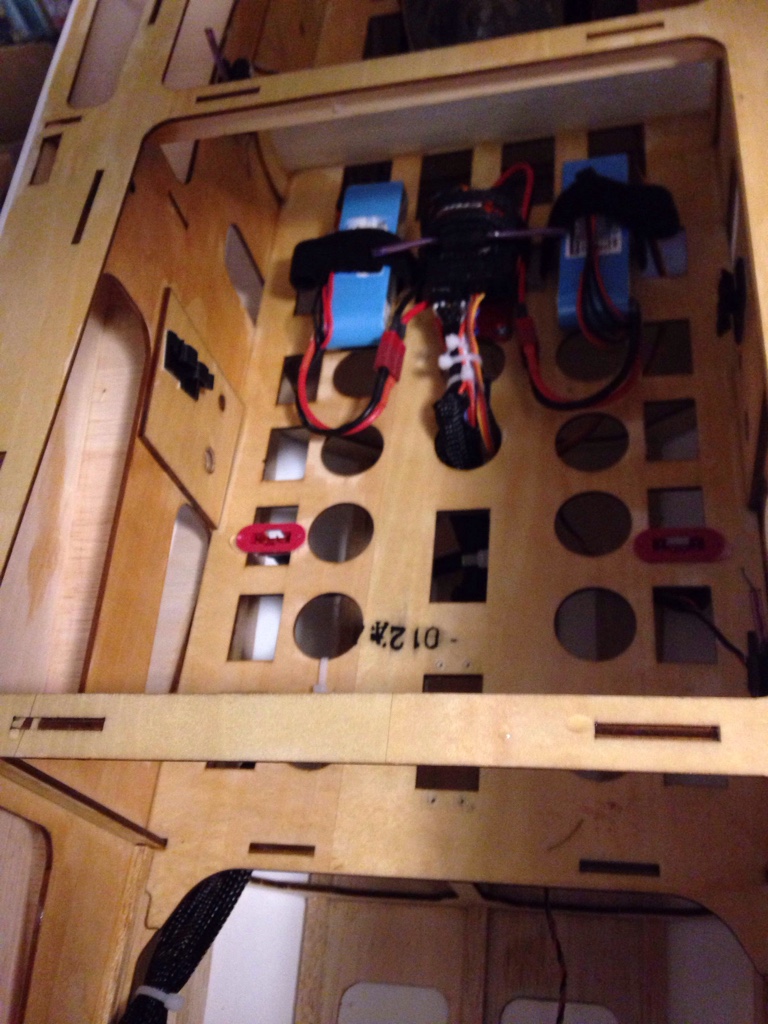

It was really easy to keep the wires lean in this plane. I'm now considering carbon vinyl or a thin carbon sheet to lay across the tray.

3dbandit
Thats a 35% plane right? Did you use an I-bec or a Opti-Kill setup. Please do explain your setup. AKf
I am using an opti-kill from horizon/evolution.
I first have the unit plugged into my receiver, then I have a 2s 450mah lipo connected to it. Inline between the kill switch and the ignition I have a castle BEC to regulate down to 5.9v for continuous voltage.
As for overall setup of the plane: I'm using savox 2231's on all the surfaces and a HS-7950 on the throttle. I am using 1.5 inch arms on the ailerons and elevators, 2 inch on the rudder.
I'm running a DA-120, spinning a mejzlik 27x12th.
I am using glacier 2600 mah 2s packs for the RX.
AKfreak
Thanks for the info. The HS-7950 is 450 oz of torque, a little overkill for a throttle right :)
