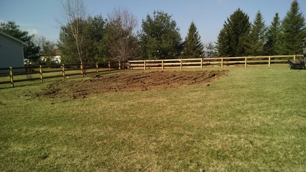

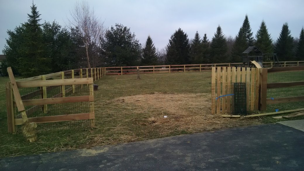

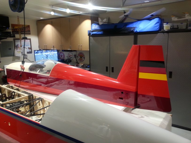

So far.......spent 3 months pricing. Paid for bldg. upfront and it was ordered. Concrete was paid for and he exacavated the land, removed 2 tree stumps. Bldg was delivered today and I'm waiting on the foreman to let me know his schedule. He has 2 weeks to complete per the contract.
Of course I'll take feedback and suggestions along the way. I do plan to a lot of the inside work myself and chose not to do water/sewer as its a pain in this county with septic systems.
sweetpea
Before
After excavation of the site
