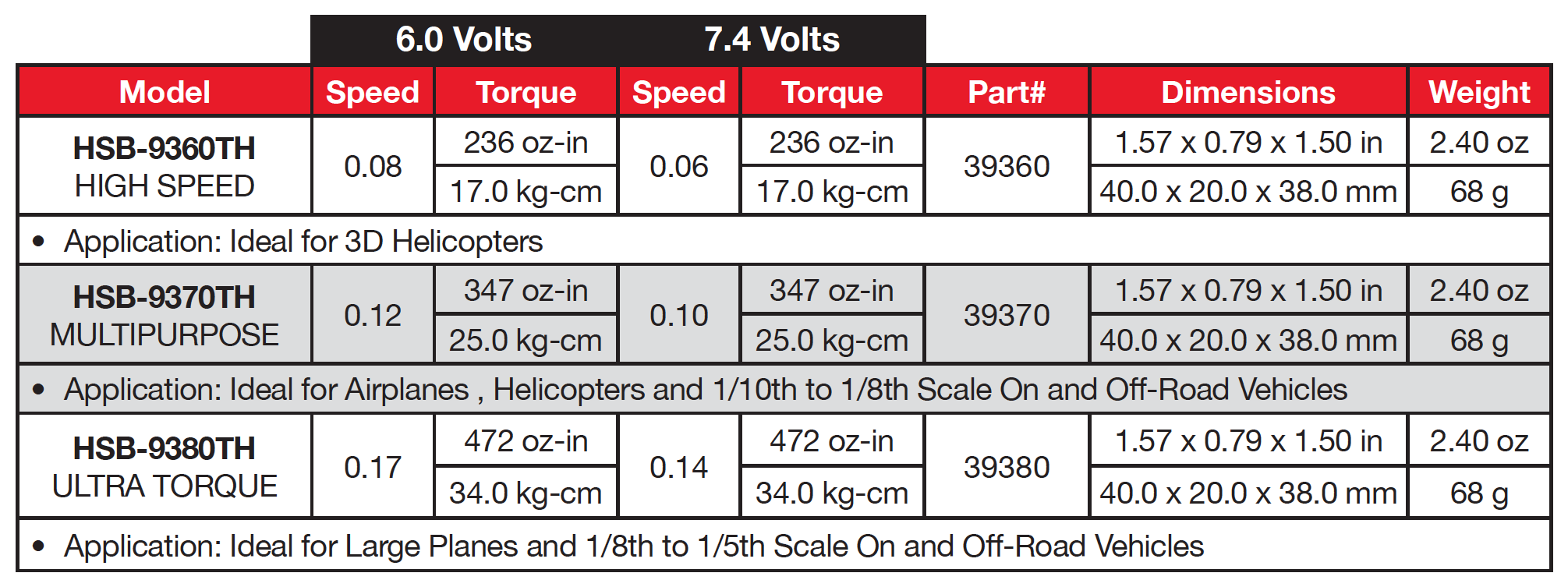

Nice test results! What battery selection/voltage did you use for the test? Maybe I missed that.
Xpress
Whether you operate them at 6.0v or 7.4v won't really matter because the servo will generate the same amount of torque on either voltage. The speed will be altered slightly but the torque won't be affected.
3dNater
3DRCF Regional Ambassador
Why won't torque be affected by higher voltage? That doesn't make sense to me at the moment.
3dmike
You're right and I must say I am surprised!
Constant Torque Output:
Thanks to our revolutionary circuit and motor designs, the HSB-9XXX Series maintain their speed in a more consistent manner, regardless of load.
