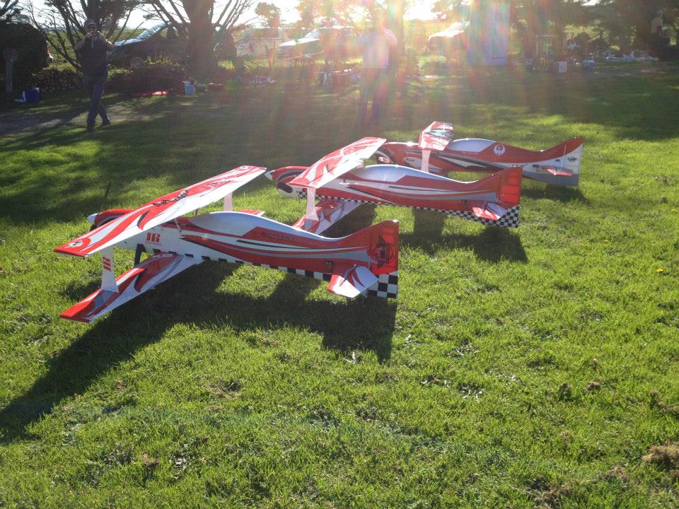

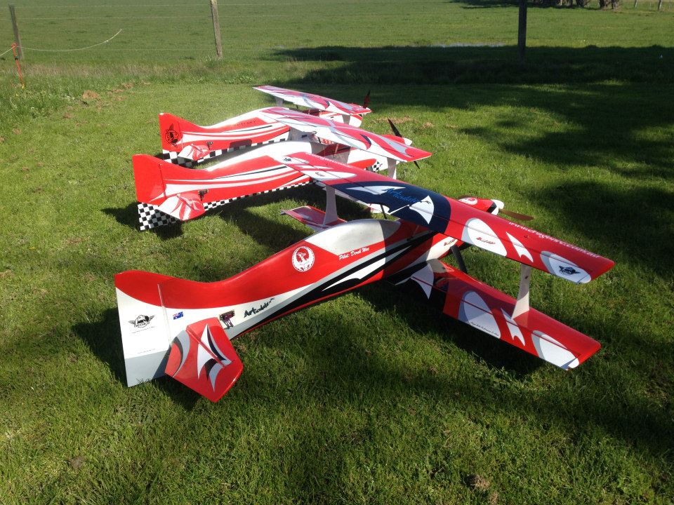

21kg titanium gear powerhd servos all round. No regs just high voltage on 2s lipos. DLA32 with jtec wrap around pitt muffler. xoar 19x8 prop. 330ml fiji water fuel tank.
There's 3 ARTiculates in our local field including mine. The other is OS33 and the third is 10S dualsky electric
