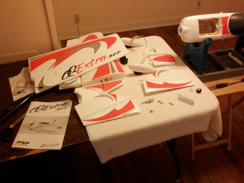

I did not mean to disappear but I budget myself to a 5GB data card each month for my hot spot. This month I budgeted only 2 gigs for I just had to get myself some RC goodies for Christmas!:). Got to get my Hexcop and QQ Extra 300 foamy built!

I'm not cheating, HONEST . . . :roflmao: All I did last night was pulled the instruction booklet, if you can call it that, and read through them. Doing that quenched ANY desire I may have had to build the plane myself. I'm going to leave it to someone who won't screw it up.:yesss:
But building is so much fun. I say build it but if not there are plenty of people who will build for you. Speaking of building I need to get in the shop and finish covering these two planes so I can ship them to their owners and get back to my own stuff.
