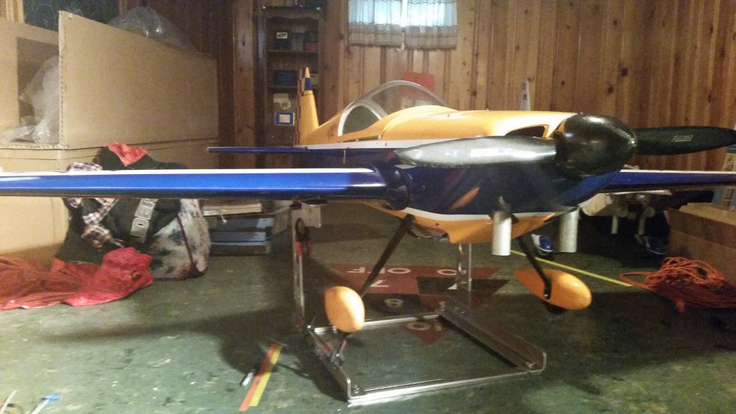

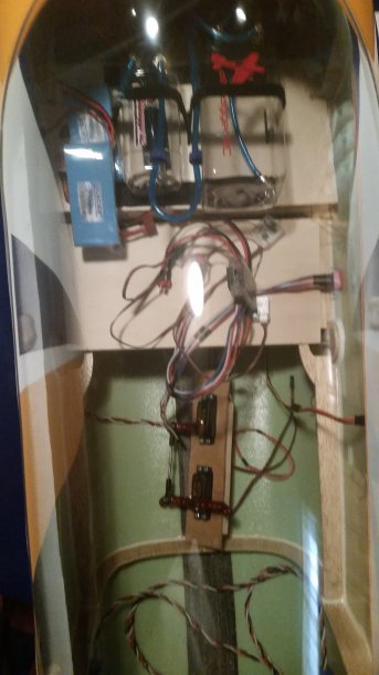

So much for having tail mounted push pull servos...... Set the MX2 up on this balancer I have. Gotta have the servos mounted under the canopy/pilot.
What you see here is the airplane balanced, but with a 1/2" AFT CG. Only other option would be to have an aluminum motor mount made approx 1/8" longer than my standoffs currently. I think Im 1" or 1 1/4" standoff.... That will help with moving the CG fwd.
It was just WAAAAAAAY too tail heavy with servos in the tail. So, Im gonna see if my bud Hahn has the OEM Comp ARF MX2 rudder servo mounts. Im sure I tossed the originals from my first one......

I just scrapped the original rudder mounts and built mounts for the SWB self adjusting tray. Weighs a few ounces, but avoids a lot of headaches.
