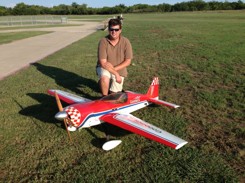

So I flew my first 2 IMAC competitions this year with my trusty Great Planes 1/4 scale Patty Wagstaff Extra 300. It's powered by a DLE 55. After the contests ended and I realized I was hooked, it was time to aim for a 100cc bird. I bought this 50cc bird used at a hobby shop here in DFW and it was my first large aerobatic plane. It flies amazing, will go vertical all day, and slows way down for landing. If you can find one out there I suggest buying it because they're really fun and docile planes. Anyway, after my last competition, this plane had taped up holes, covering coming off... I could feel cracked balsa under the covering, and the fiberglass cloth hinges were brittle and broken. I thought about selling this plane, but it's so easy to put in the truck and be flying at the field really quickly, plus a great flyer that I decided to keep it and just give it an update.
Here's the before picture of the plane:

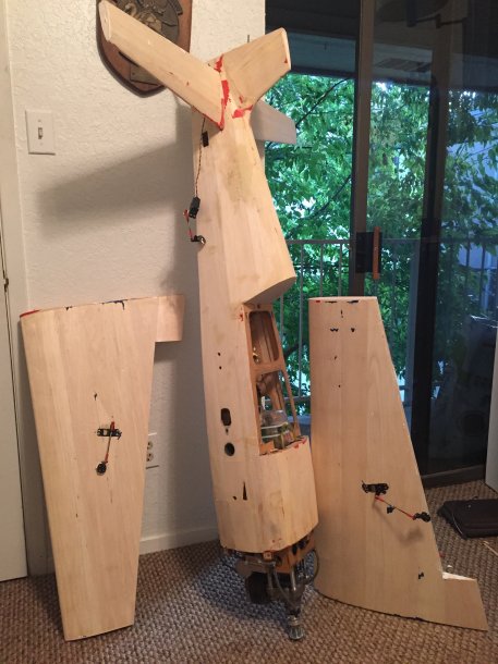

So the afternoon I got home from competition I began stripping the covering off the plane and removing some of the electronics, hardware, landing gear, etc. Here she is basically stripped down and ready for repairs. I also began to use balsa filler and go back over the plane and fill in knicks and holes. It's not perfect, but I spent a lot of time working on it.

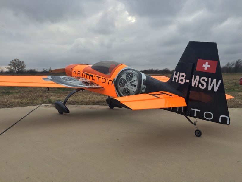

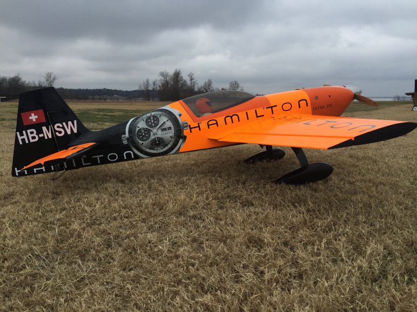

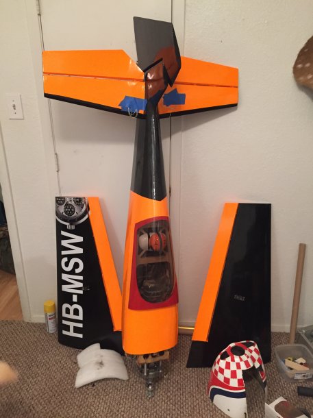

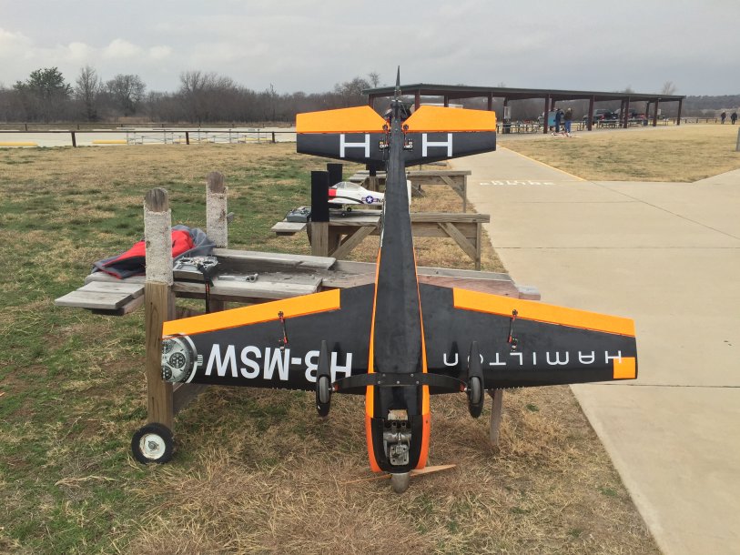

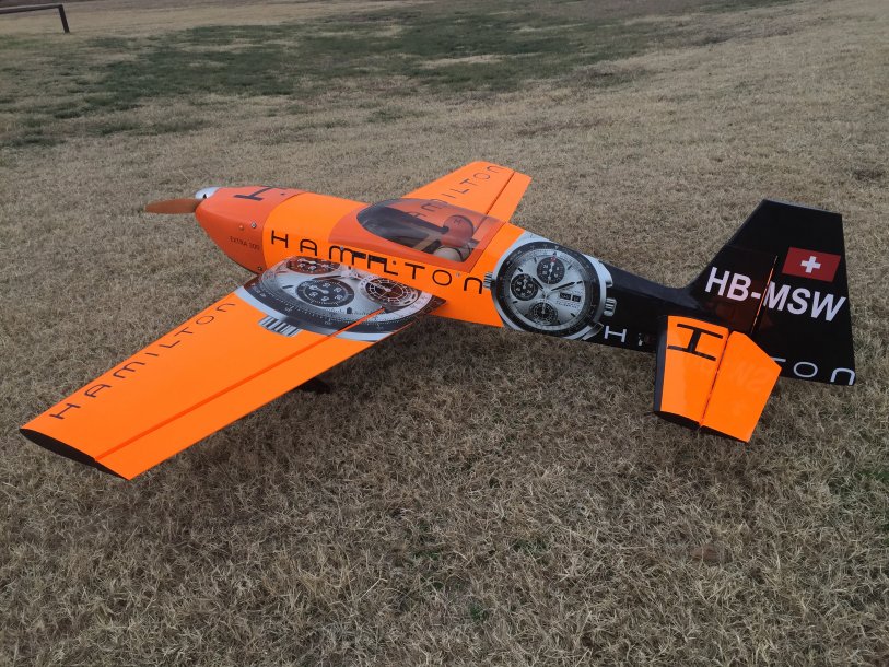

So, for updating my GP Extra 300. I replaced all the hinges that were the fiberglass tape with Robart Pins. I used Ultracoat covering throughout. I used one of the rolls as a conduit inside to run my servo wires to the tail. I did some nit picky stuff with my electronics, and redid my servo connections to make sure everything was 90 degrees. So here are a few shots of the finished plane. The one thing that's not quite right is the paint on the canopy and cowling, which I may try to repaint, or order a new cowling from Fiberglass Specialties and try again. I thought I had a match on the paint... I'm not sure what ga what happened. Here's a shot with the covering before the graphics and paint.
fencelake
Here are some photos of the completed plane. I flew it on Sunday and it's like a whole different plane. So much tighter with the new hinges and improvements. I'm really happy with it!

fencelake
So now, a plane that was flying loose, and was sort of in shabby shape is now like a brand new bird.
