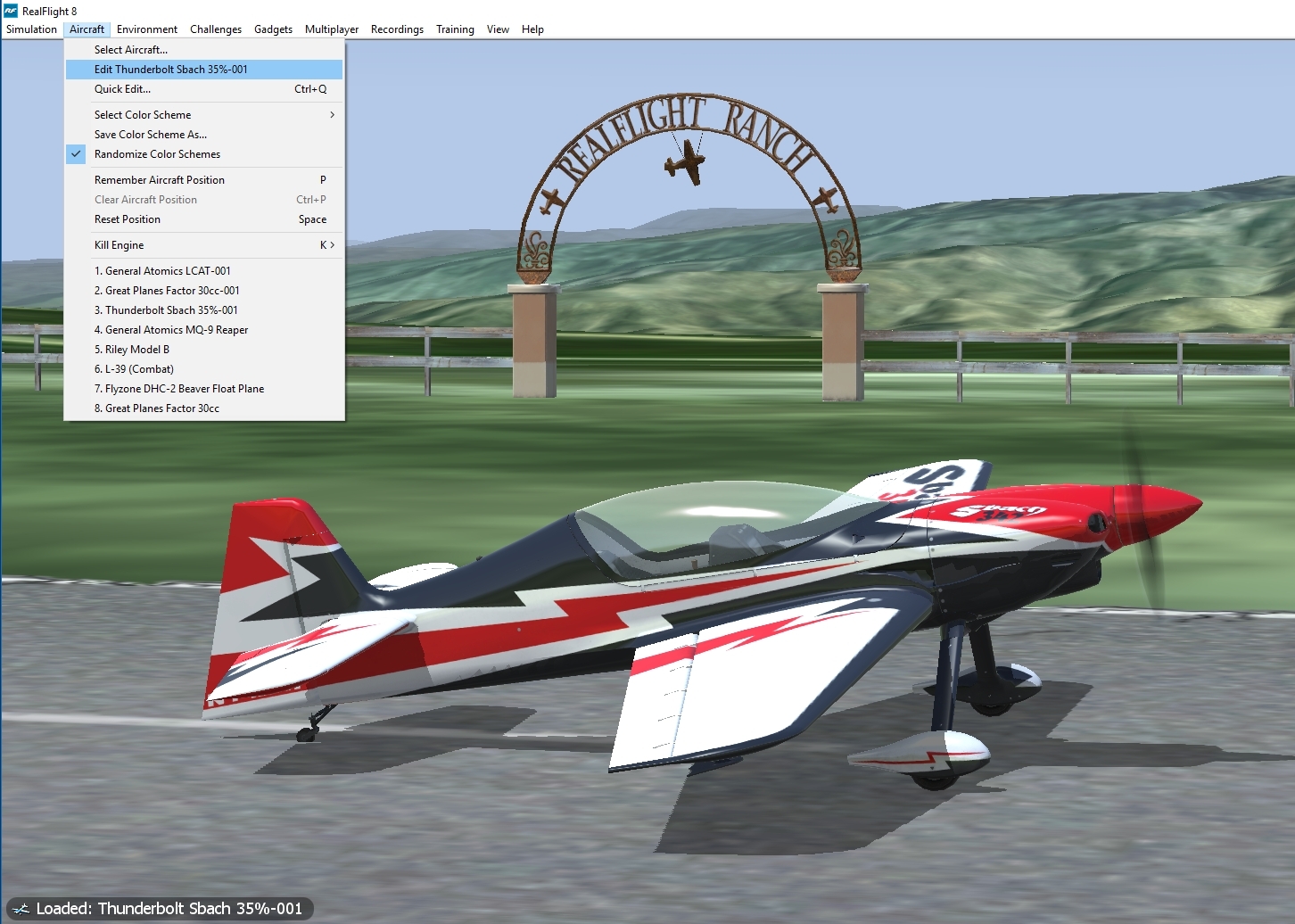

Real Flight makes it super easy to tweak and modify the default planes.....
Click "Aircraft"... click "EDIT (Name of Active Model Here)" and you can get right into tweaking to your personal preference!!
I moved the CG back an inch, changed the "Vehicle Graphical Scale (%)" to 185 and increased the Elevator deflection to 45 degrees.... (Oh yeah... change the Prop Graphical scale too if you want it to look right!!)
That right there makes the default Sbach pretty dang good!!

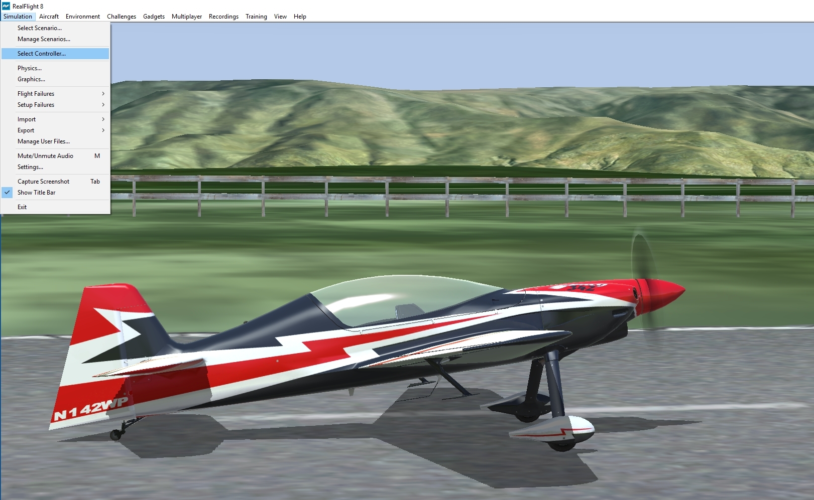

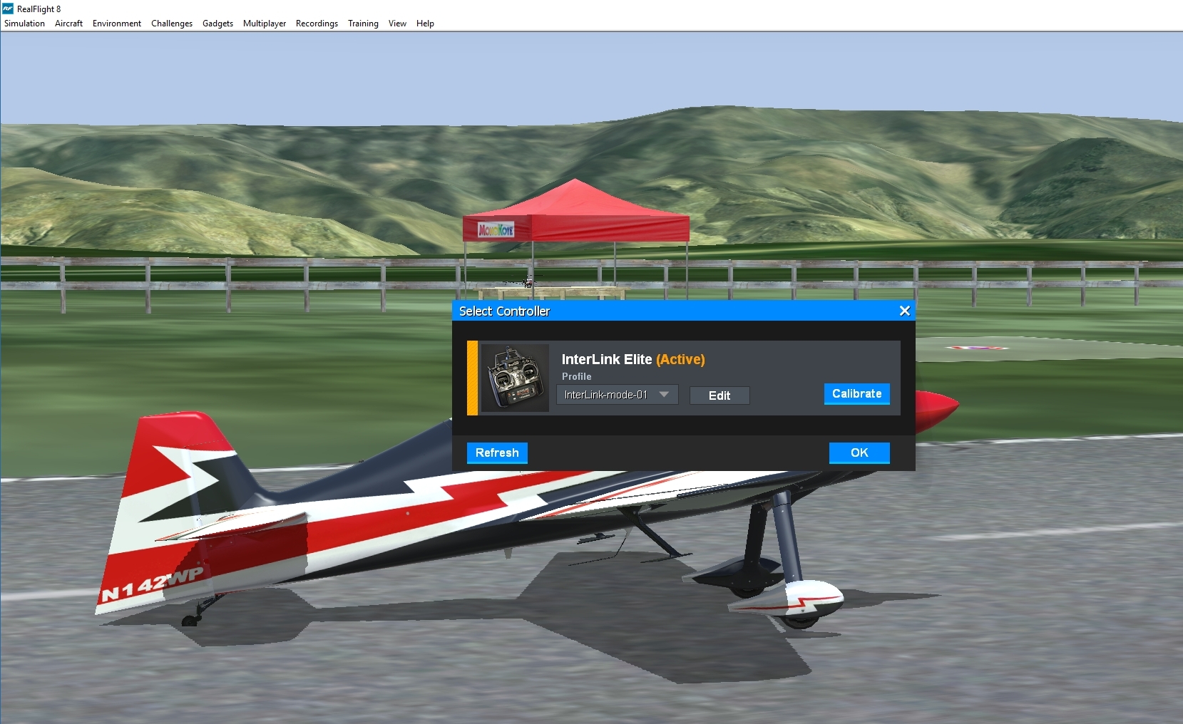

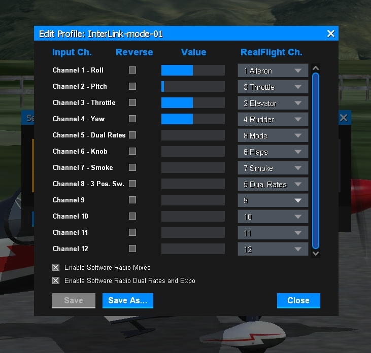

And for those who fly Mode 1, Like me, QQ, Hanno, (or any other Mode for that matter)... it is really easy to move the Ratchet, Lever and Spring in the controller, and in the software, you can select under the "Simulation" option, "Select Controller" and then choose "Edit".... a small window pops up and you can assign controls to the various sticks and switches... sort of like the "Function" menu on Futaba radios....
