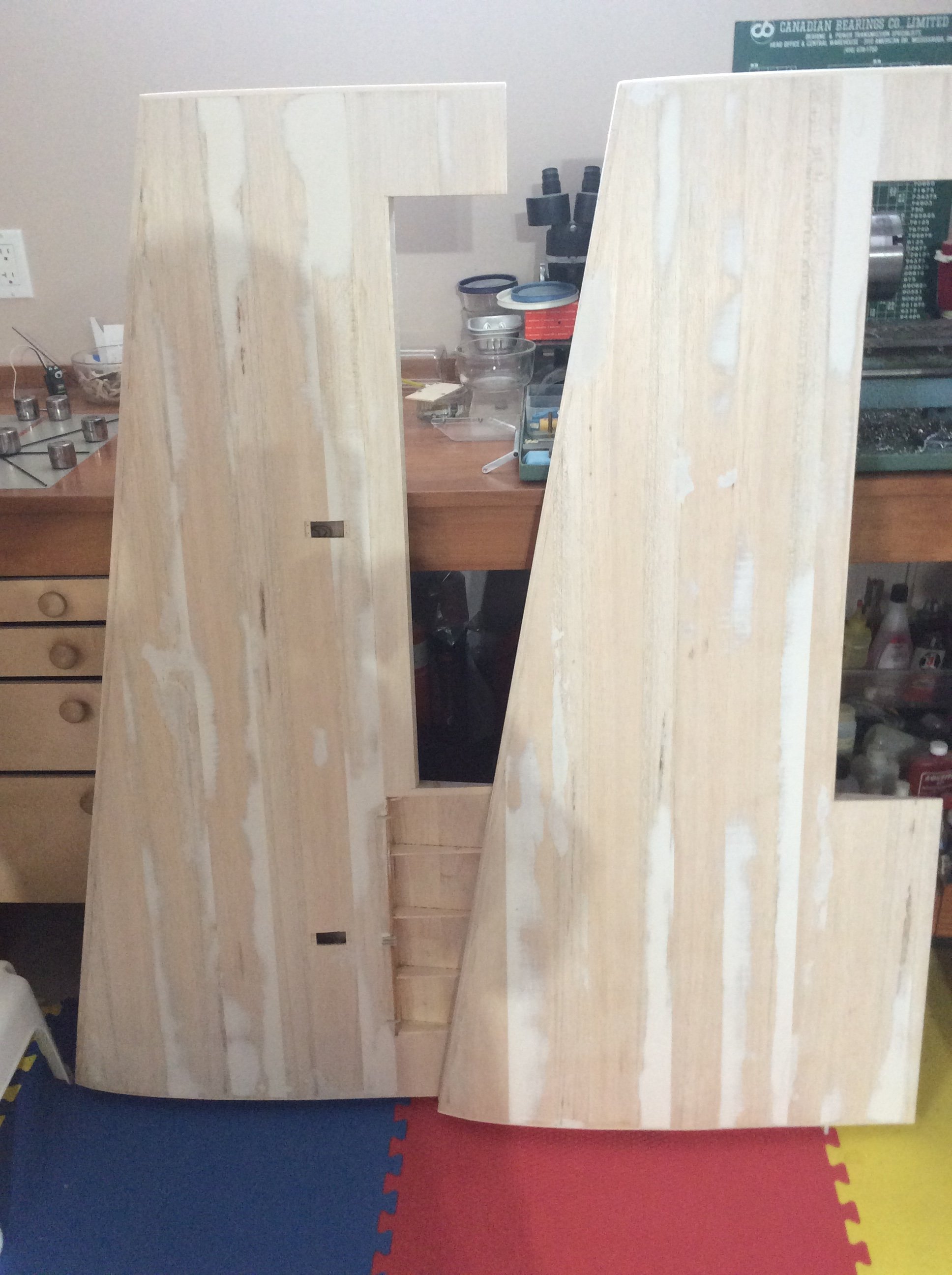

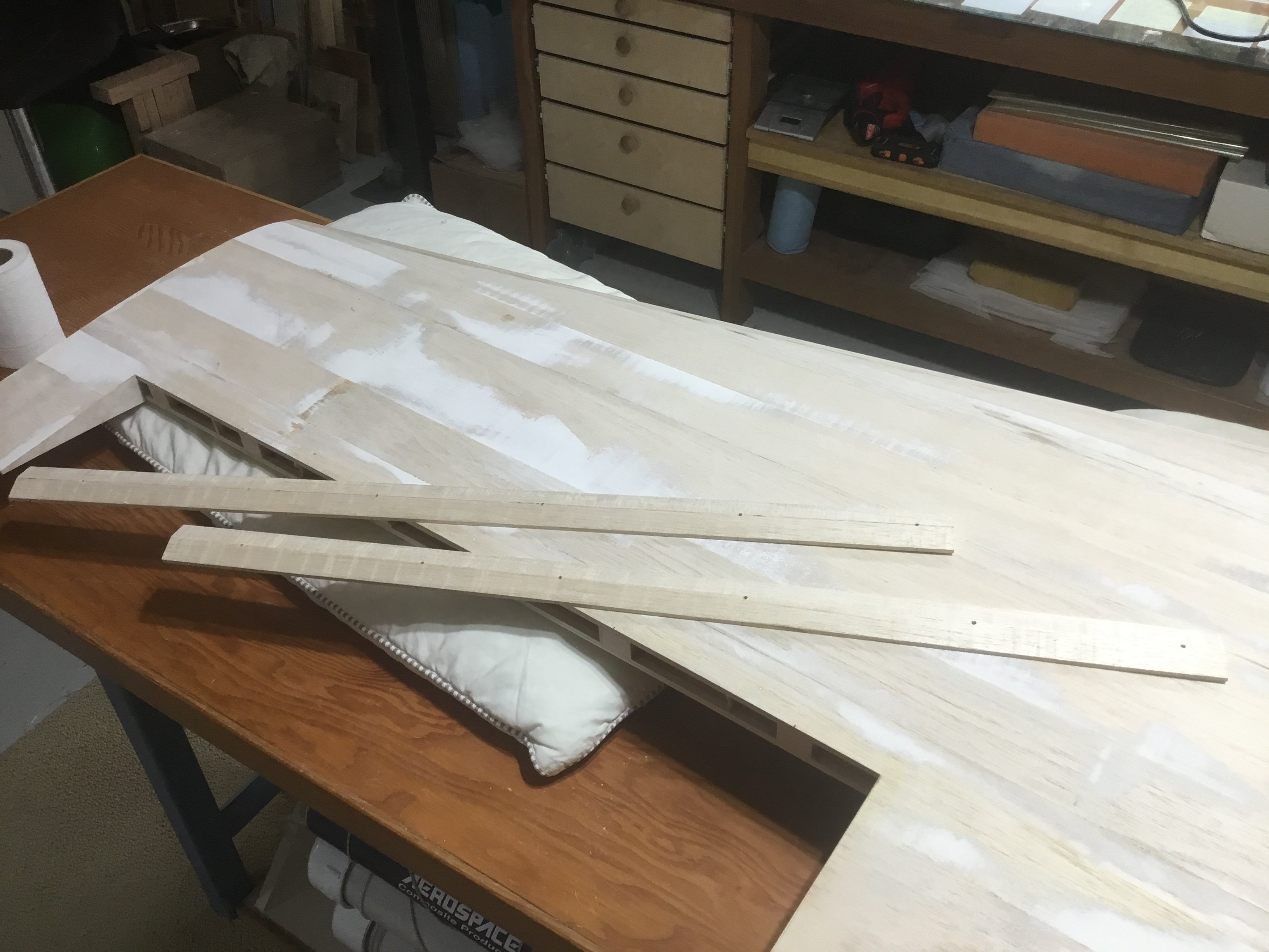

Back onto the wings, they need to be finished off. Cut the ailerons out and finished all the edges and marked the hinge locations. Cut the 4 bevel edges to be glued into the wing and onto the ailerons. Drilled the holes for the hinges into the beveled balsa edging. Just need to glue them all in and finish the edges. That’s it done enough damage for today , will start again tomorrow.

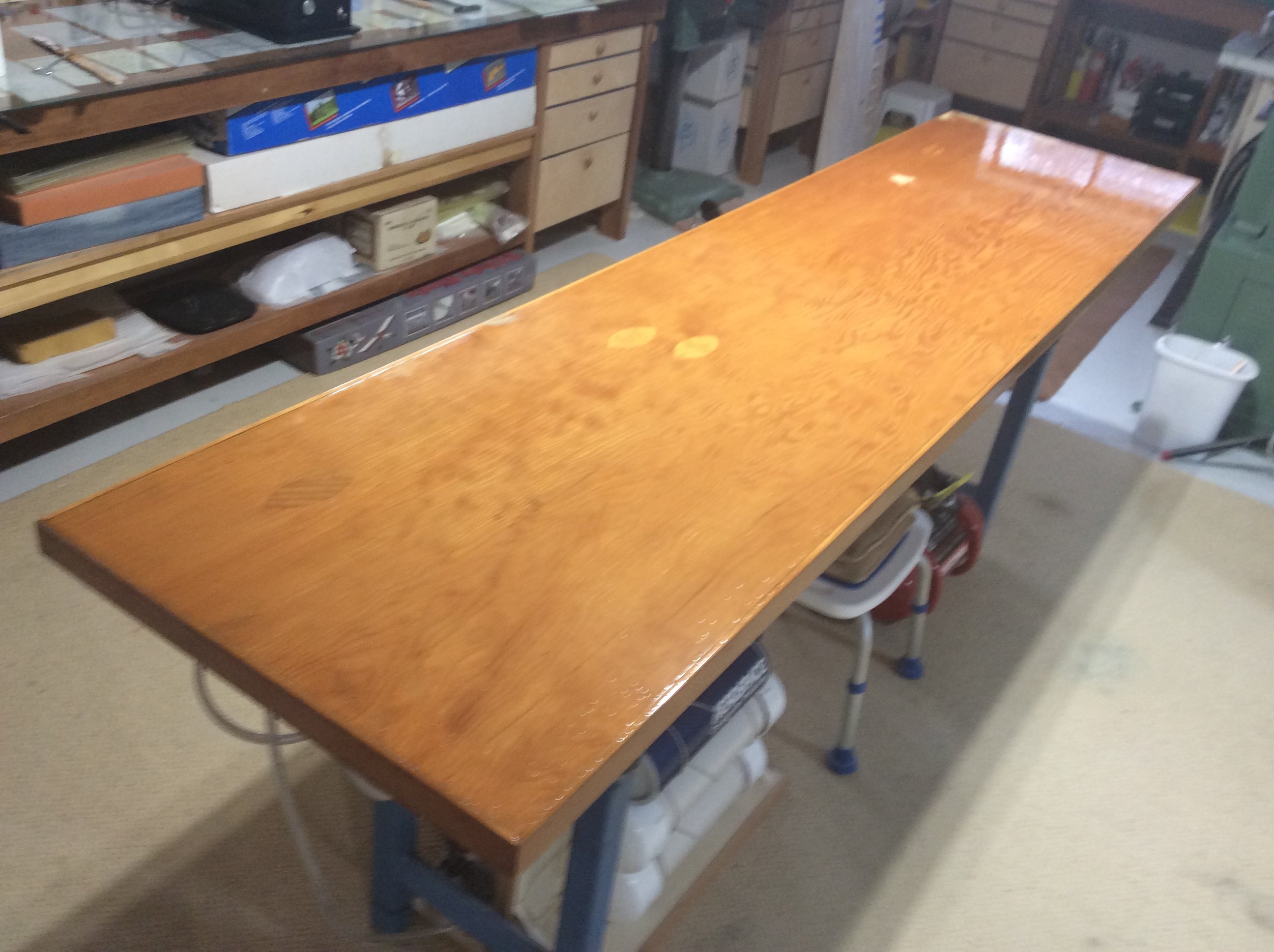

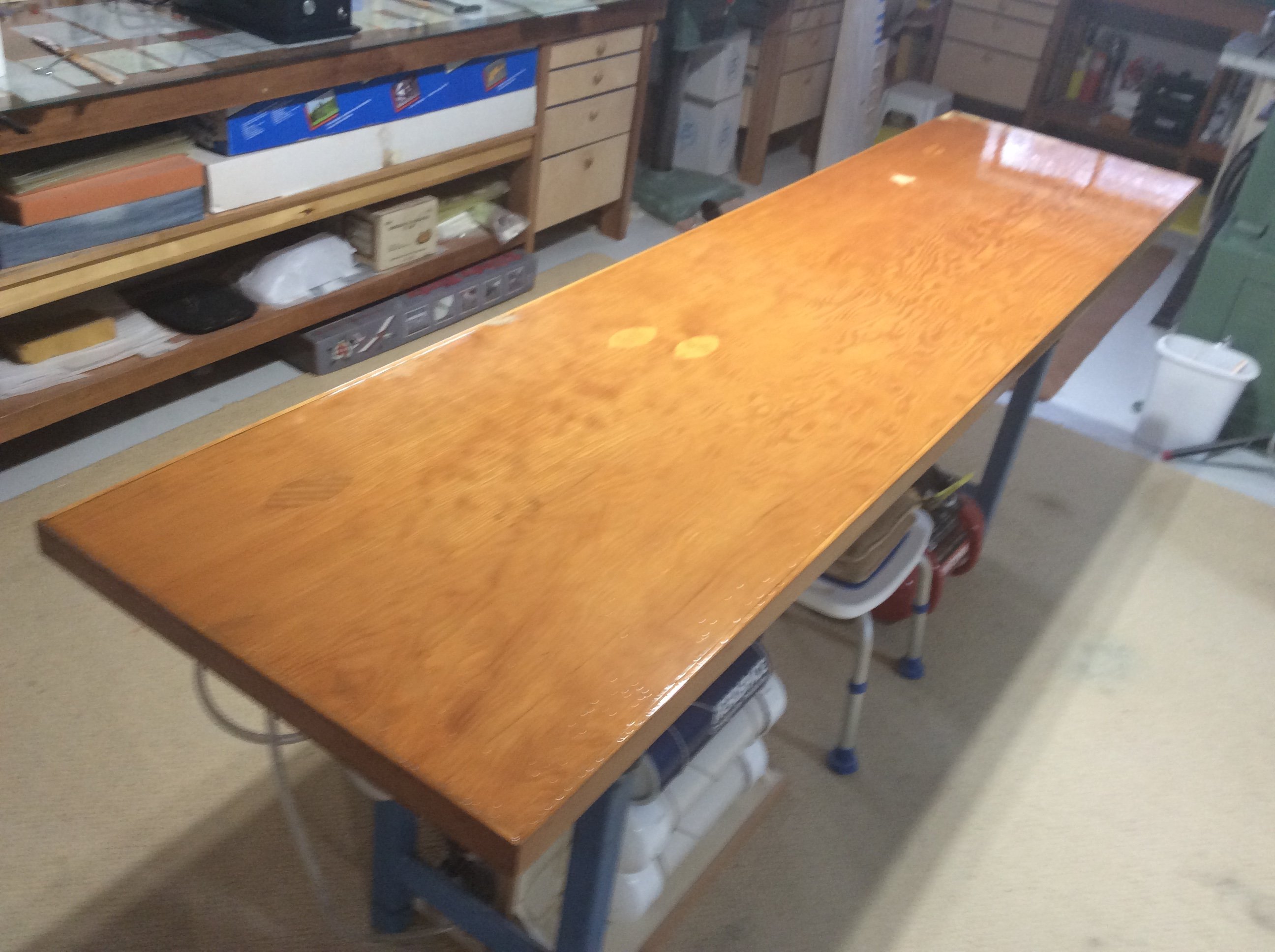

Ok it is and it isn’t part of the hobby , broke the glass plate on my work bench. The surface was rough and not workable. So cleaned up the bench and put a coat of clear on it now just have to wait for it to dry so that I can continue to build.
I have no knowledge on glass on what to get. If someone knows something about glass on what I should buy and thickness your help will be appreciated. The table is 2ft by 8ft.
I’m about ready to order a bigger piece of glass for my primary table. It’s a 8x4’ table. Tempered 1/4” glass, slight bevel around the edges. Delivered (it will be heavy), about $550.
Thanks can I ask why tempered. Ok I looked it up the glass I had was just regular glass because it broke up in to huge pieces, and was difficult to deal with. Yes I will look at getting tempered glass.
