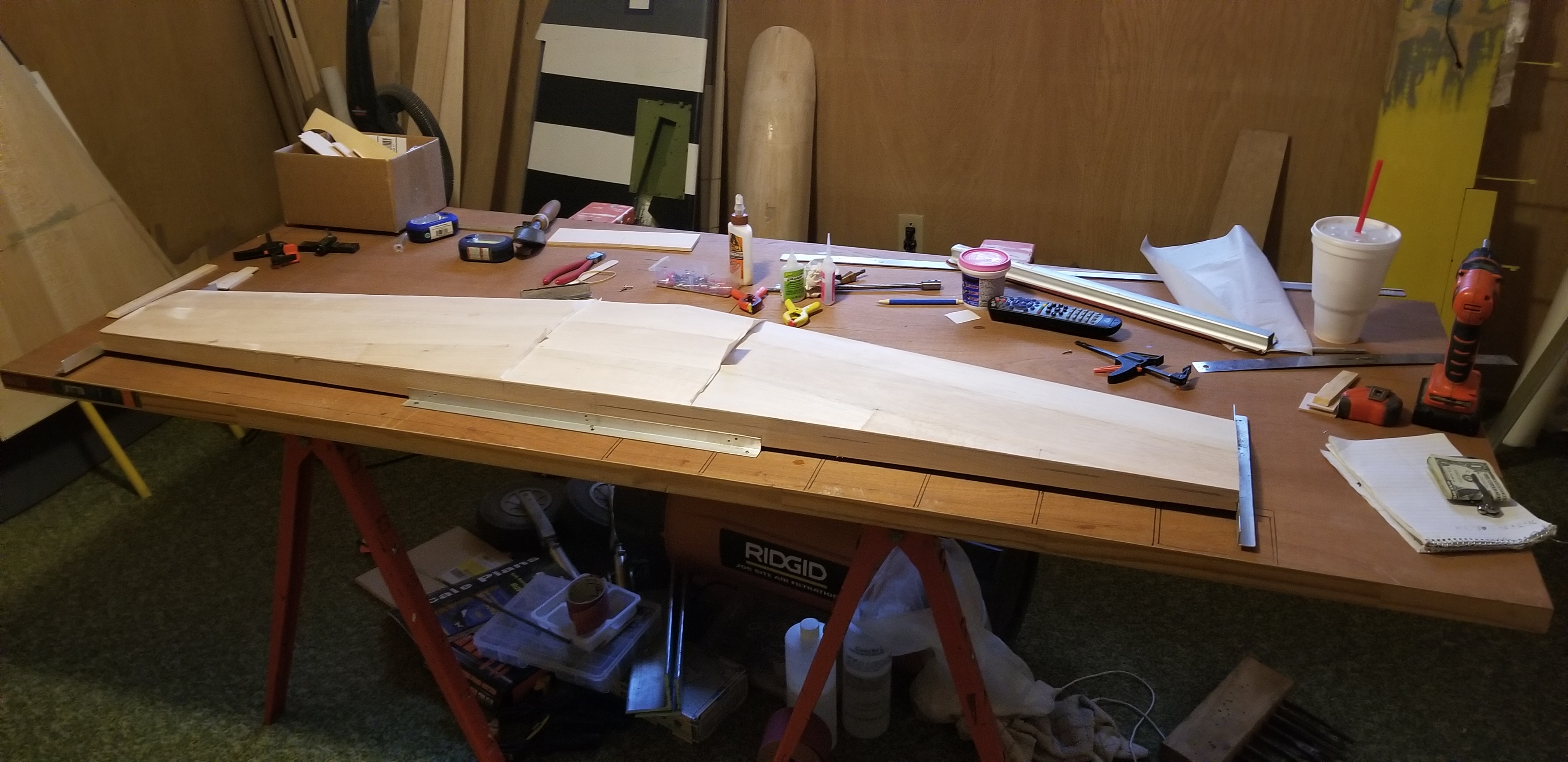

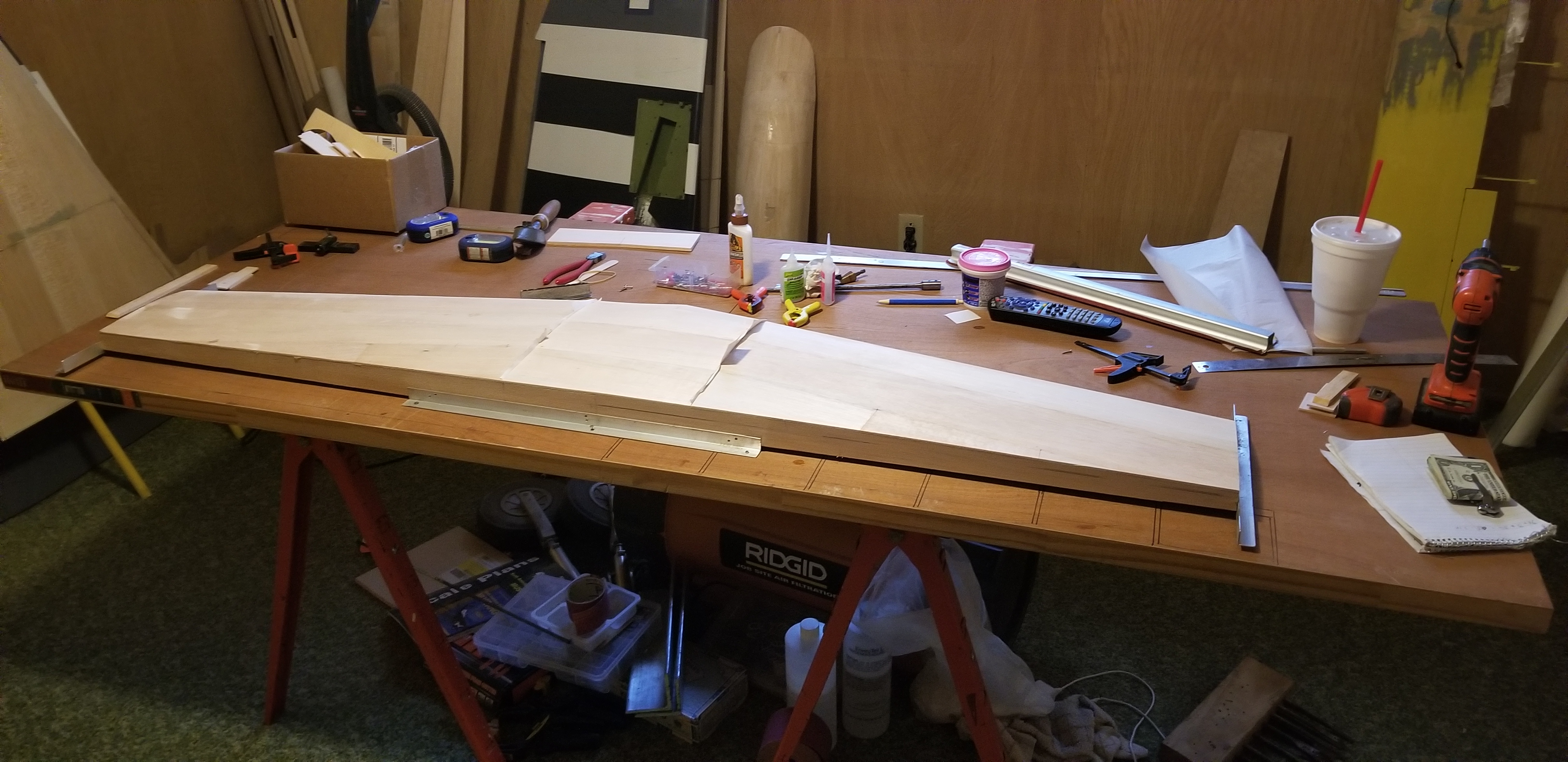

After i sketch it out on a pad i drew it out on the table. Im thinking white batroom board topped table for the wings. Hopefully a sharpie will stick and not wipe off without thinner. Then i can doodle on the table and wipe off later...

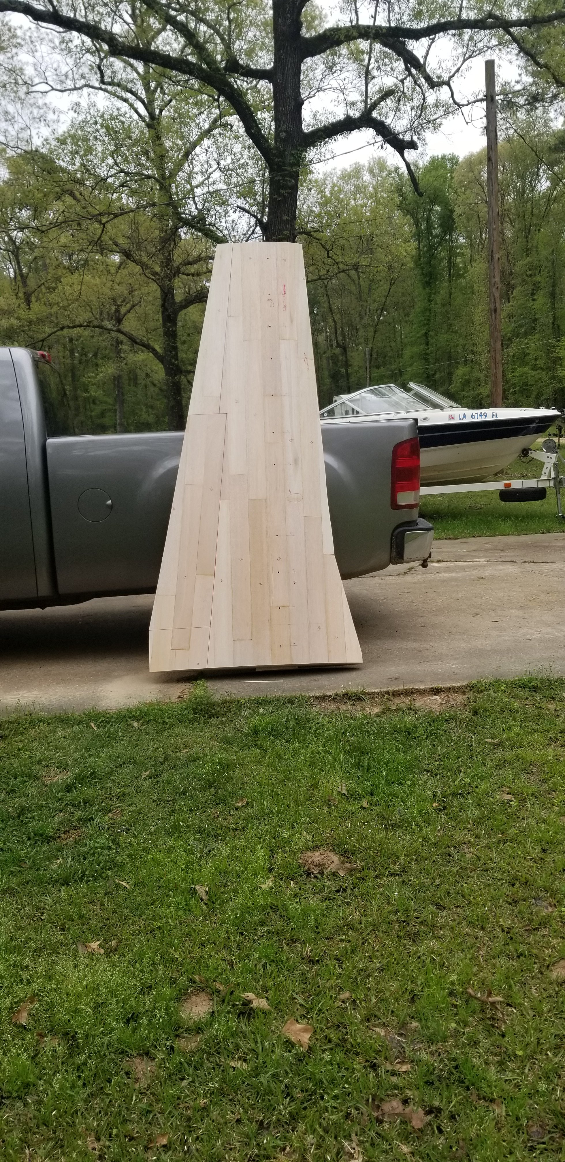

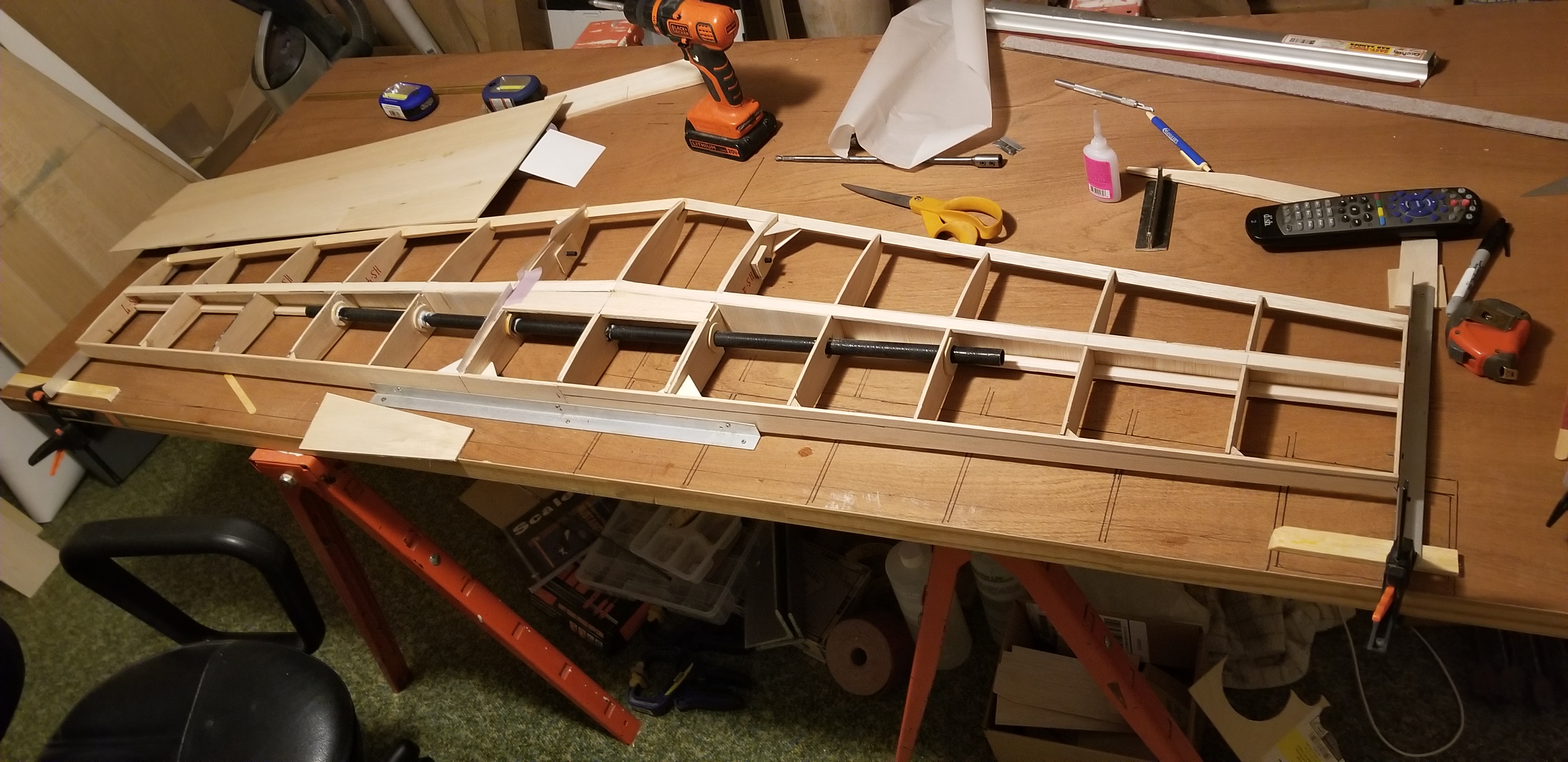

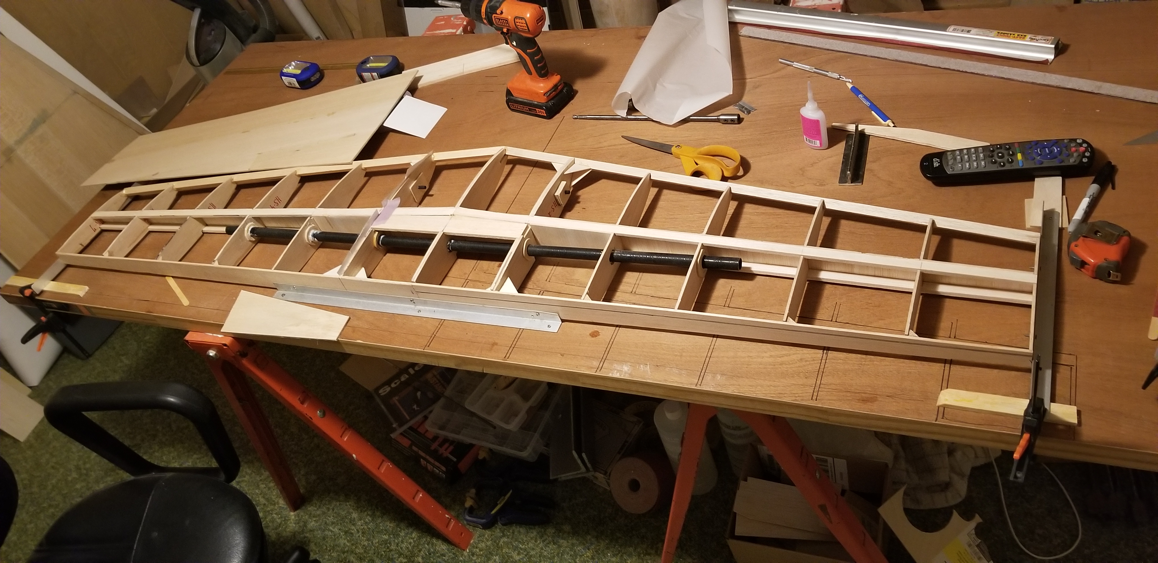

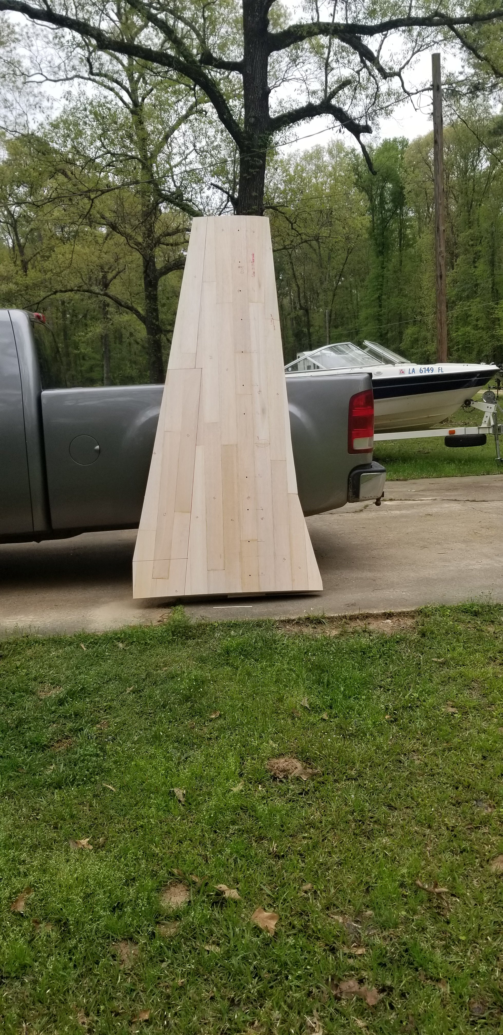

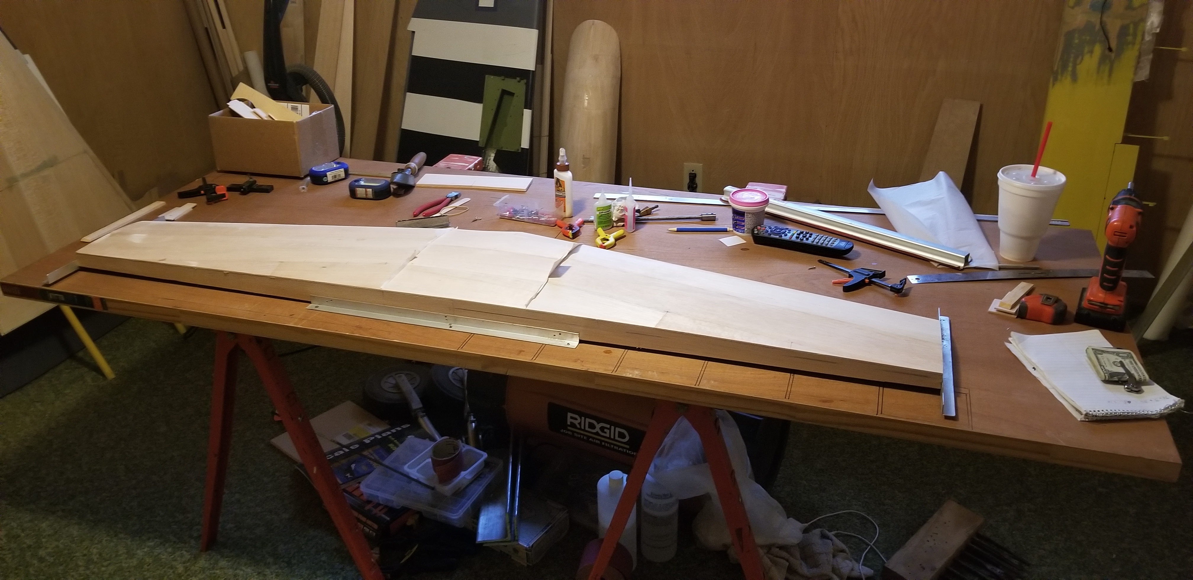

Im still refusing to do a build thread because i just cant take good pics.. too big... but finally removed left wing half. I have decided on building as a "B".. has been alot of fun so far... next hurdle is I need to be able to build the right half against the left to keep everything straight...
