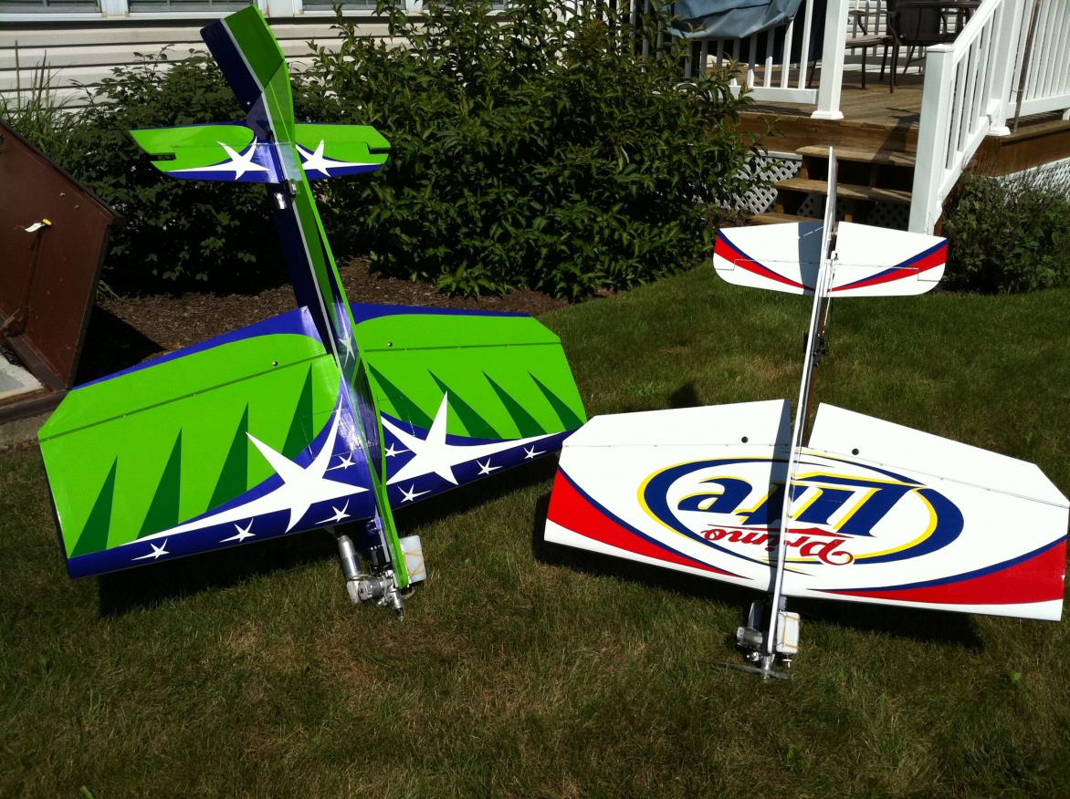

That sucks that you're turned off to the Primo because of the misprint. I'm sure once you fly it, that bad taste in your mouth will go away. My first build was a Swanyshouse Mojo 40 kit. I've since built another 4 of his kits and think they're great, but my Dad built a primo 15 and screwed his up to because of the instructions like yours. Frustrating for sure, but they do fly nice and since you built it, you know it and can repair it easily. Here's a pic of my two primos, the 40 I covered in a Miller ("primo") Lite scheme. The 60 size I based on Gary Ward's MX full scale plane.

Nice looking birds you have there. Can't say I have seen too many covering jobs nicer than that.
