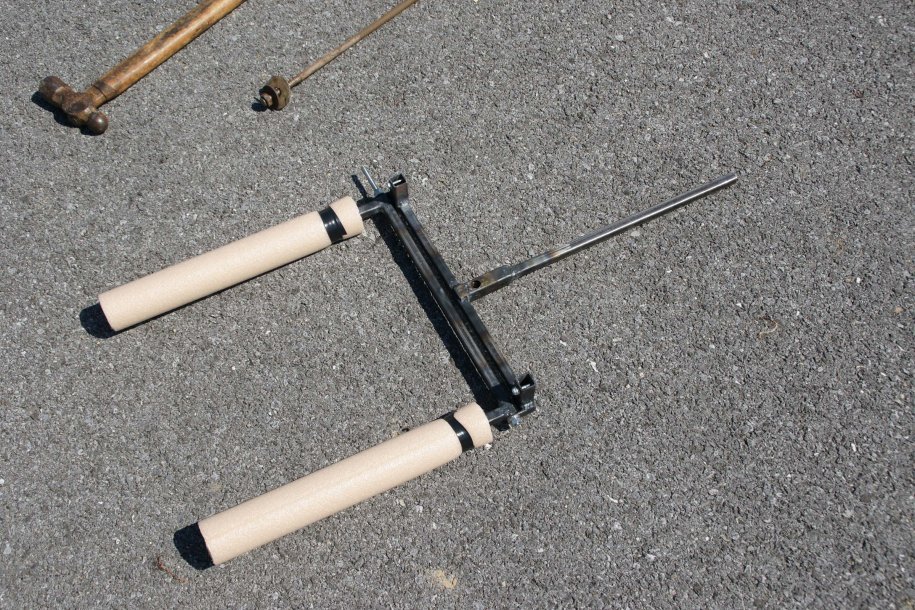

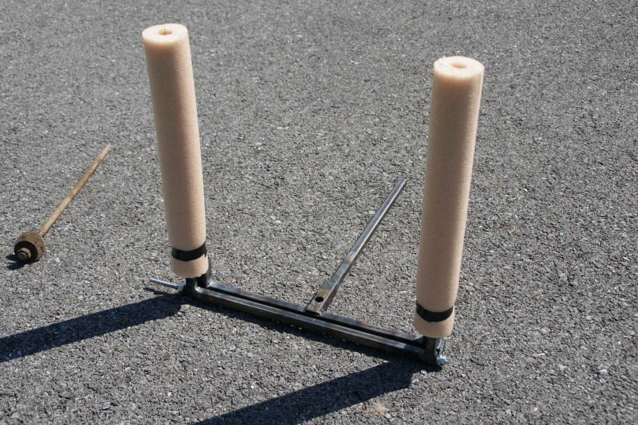

Pistolera
HEY!..GET OUTTA MY TREE!
I built one of these. Works great for starting, although I don't do run-ups against it. For that I stand in front of the stabs. This thing has served me well for a few years now. the center leg goes toward the front of the plane. Big-assed pin driven through the hole in the middle.

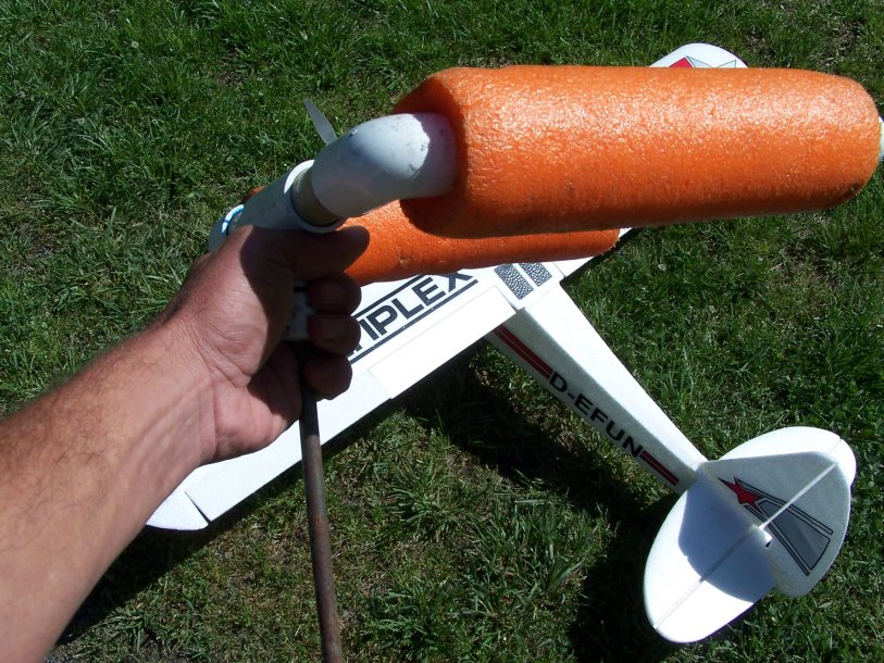

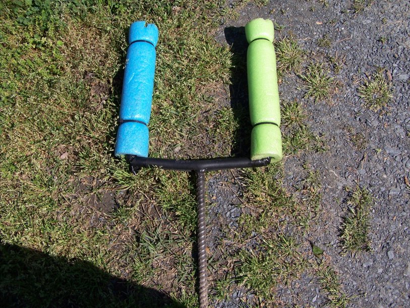

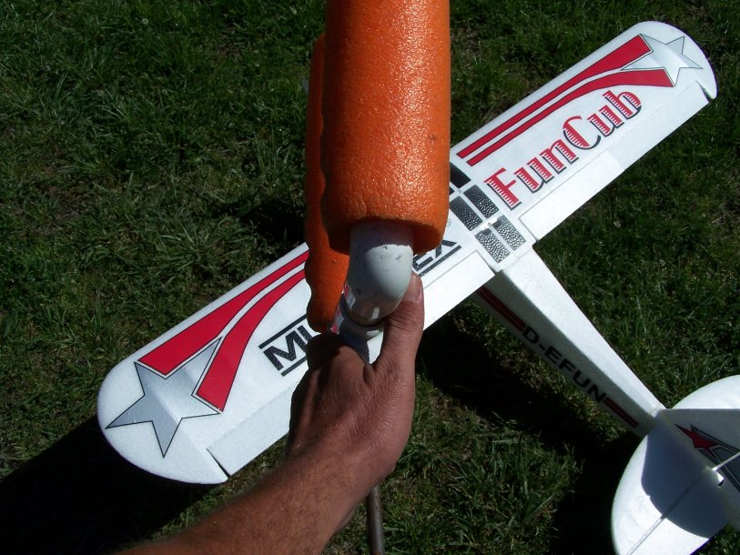

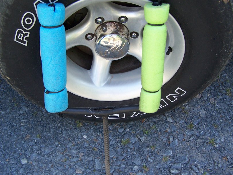

ChickenBalls
"Cool Guy"

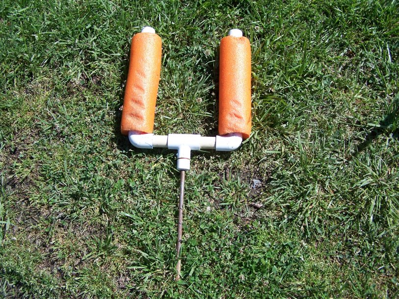

I think I have posted these on here, but this is what I use. THe pvc one is good for Glow and electric to 30cc gasser. The rebar one will hold 100cc easily. 50cc I'll leave in restraint and run it up, just going larger now 85cc, and I start it in restraint, and then step over it, and run it up. THere are a few that fold down like the pvc one, on the market, as @IKE mentioned above. Then there is some serious restraints out there
http://hobbyking.com/hobbyking/stor...Airopult_Model_Airplane_Restraint_Device.html
I don't promote them (above link) or the distributor, others reselling the above link as there own also. I think restraints are a must, but there is a video out there suggesting you start your engine at half throttle (Yes the dummies are using a restraint), but that is not only unsafe but STUPID. Yep I said said it STUPID, sadly I think the video is still floating around out there. I'll let you google it to find, or convo me and I'll shoot you link to video. I don't claim to know very much, but if your engine will not pop with choke on, and then start at idle, you have other issues.
