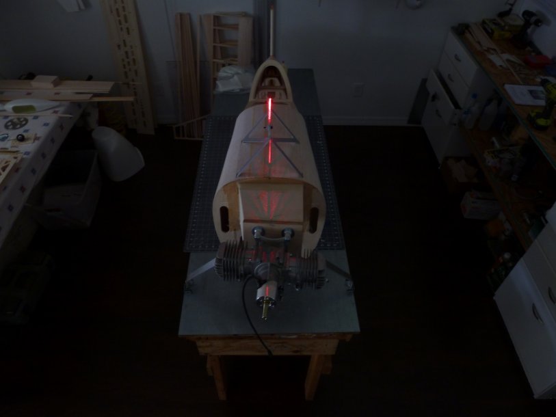

One last check on the bench before epoxying the box to the fuse. Everything look's good so, hi ho, hi ho.

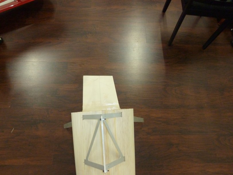

Unbelievable, just absolutely unbelievable. I went through all these check's and double check's and did not notice until after epoxying and glassing the box to the fuse. I glued the box to the firewall in the wrong direction. So, I am currently working on cutting off the front ply. Then I will change the angle and put the front back on. I will have to double the front ply to keep the engine spacing right. On a positive note the double ply will accommodate the blind nuts more appropriately.

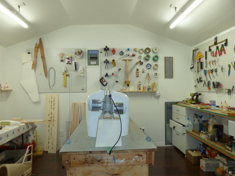

The box was cut and assembled correctly up to my attaching it to the firewall. Why in the hell I rotated it 180° is beyond me, but, the box now has 3° right thrust. Working on the cover piece now.

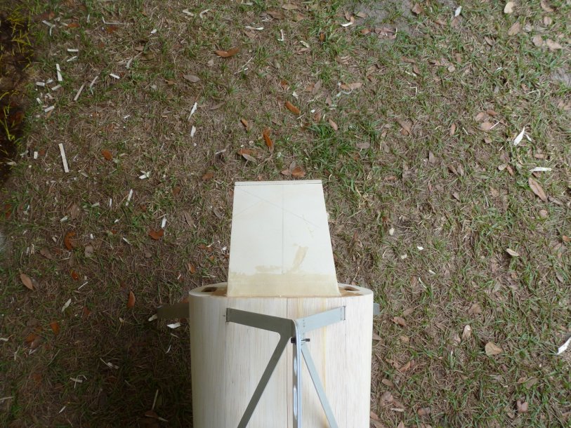

Woo Hoo! The engine is in the right place according to the laser. That is it for the fuse with exception to the canopy but I want to wait until after sanding and shaping to fit it to it's frame. So!!! On to the top wing....
