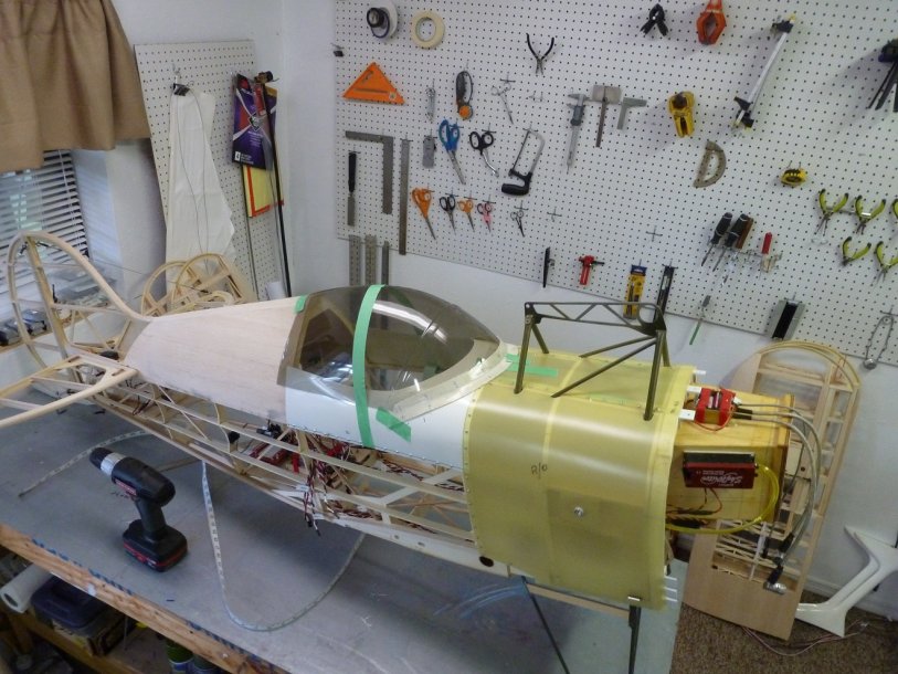

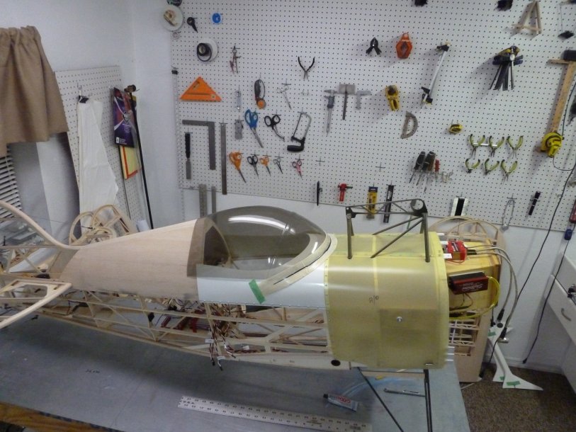

The frame set up enough I could remove it and trim it a little, will finish it up in the morning.

acerc
That frame did not look quite like I wanted after trimming so today I made another one.

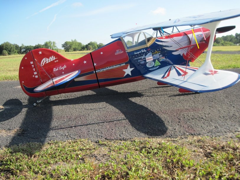

acerc
I received an email from a fella with Model Airplane news, they want to do an article on my Pitts. So I put the current build aside and began working on mine. First thing, yesterday, was to run the engine with the new 3 blade to see if I wanted to go with it. Not happening, no where near the pull of the 2 blade, guess I should have went a little bigger. With propping set aside for now, today I removed the batteries and moved them forward as well as removed the 2lbs of dead lead from the nose. The pic depicts where things were and where they are.

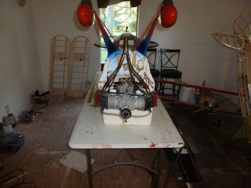

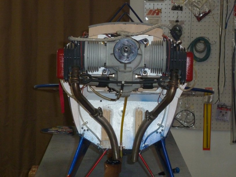

acerc
The gear has been tightened up and the intake tube installed. If I like the tube the next one will definitely be added before the engine has been installed, what a PITA it was. Here shortly I will braze up the exhaust and I think that will do it.
acerc
The exhaust is done. It is buttoned back up with exception of the cowl being left off. Last time out it sounded as if it needed a bit more tune, break-in happening, I will tune it and then reassemble it. Should be good to go and maybe even back in the air Wednesday, Friday at the latest.
The pics show the different from dual to single.

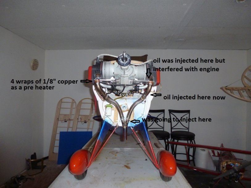

I can't take it out for a few days with a storm system coming in, the winds started picking up today and will probably last through the weekend. I did go back and move the injection point back closer to the header.
And during this process on another forum there has been a lot of discussion about how much can the oil be pre heated. So, being the ever so want to know that I am I emailed Super Dri. According to a fella there named Bill, for our application we can't really pre heat to much. He also asked I call him tomorrow and we would discus it in depth.
acerc
I just got off the phone with Bill of Super Dri and he says with our temps we can do as many wraps as we want, his words were "The hotter the better, your not going to over heat it". So I am going to go get some more copper and I think I will double up and do 8 wraps.
