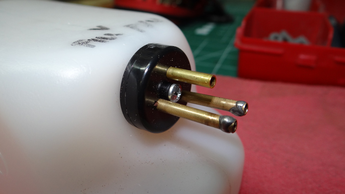

Another thing worth mentioning is that fuel lines get very slippery once they get wet with gasoline (I learned this the hard way). So it may be a good idea to either solder on a fuel line barb or just solder on a blob of solder like I did. That will give the zip tie something to grab.

Hey, thanks for reading Marc and thank you for another great tip/trick to help with fuel line slippage.
